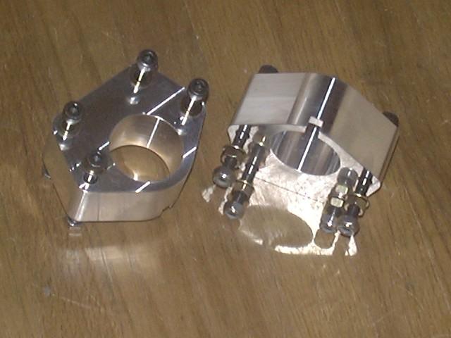

You really can't go more than about 1-1/2" to maybe 2", then the ride will get really harsh and you'll be bouncing against the upper bump stops. You're better off doing something like ball joint spacers, then getting longer shocks.
I doubt I can find spacers here in Costa Rica.
Will ask around.
Any link on making your own?
I have access to a full machine shop.
Can buy the billet to machine out.
