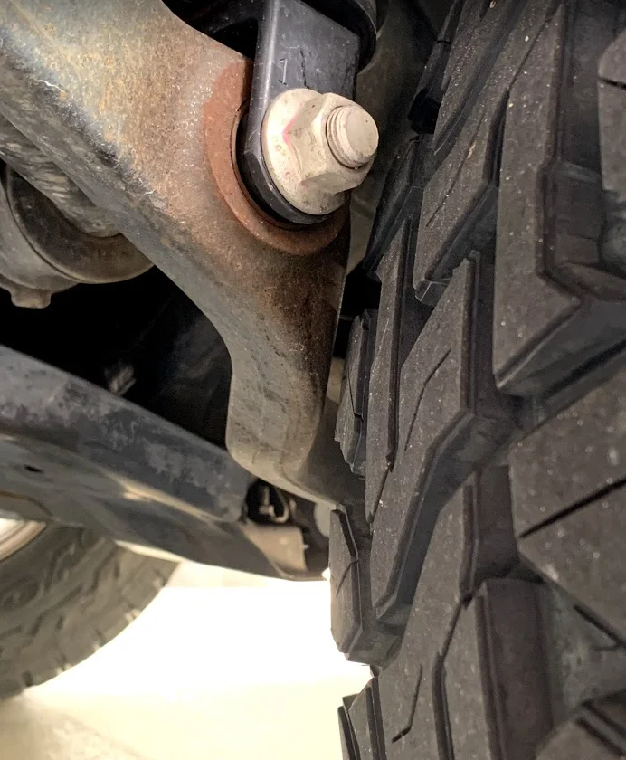

Need some advice on tires!
Spacers will help with that. I'm on 1.25" spacer and 35s and don't rub where you do. But I do get into the bolt for kdss on driver side sway bar near full lock.
Bora .75" spacer would be more ideal for as that will be closer to the correct offset for 34s
Any tips on measuring for a spacer?
seems like .75’s are hard to get. Do you think 1.25 would work?
Plenty of us run Rock Warriors 1.25 Spidertrax spacers and 285/75/17 size tires. 👍 👍 👍 👍
Might see if an alignment will help. I heard reducing caster helps
Do the alignment. I have zero rub on KDSS and clear the rear wheel well with my Toyo RT's in 285/75/17's.

Any chance you have you numbers?
Ha, you are the 2nd person that has asked. I just put new rims/tires on mine and the previous alignment was spot on except the old tires wore unevenly. Lots of members talk about alignment specs but no one posts them. I plan to and will send you the specs once complete. I agree with @terdrocket ; have to run 1.25 spacers with the RW due to the offset of the rims and feel that will solve your issue.
Not for 1.25”
Possible trim depending on wheels for 1” in back (longer lugs)
Both front and back for 0.75”
Of course some wheels have holes where the bolts go and no trimming is required for the spacer
