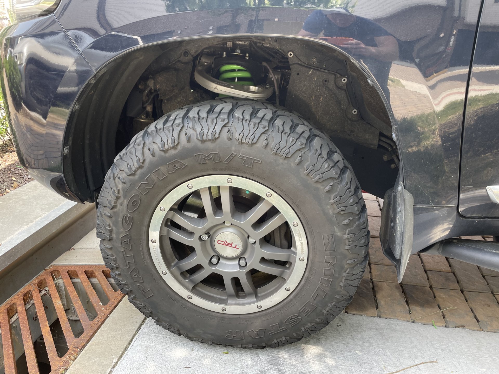

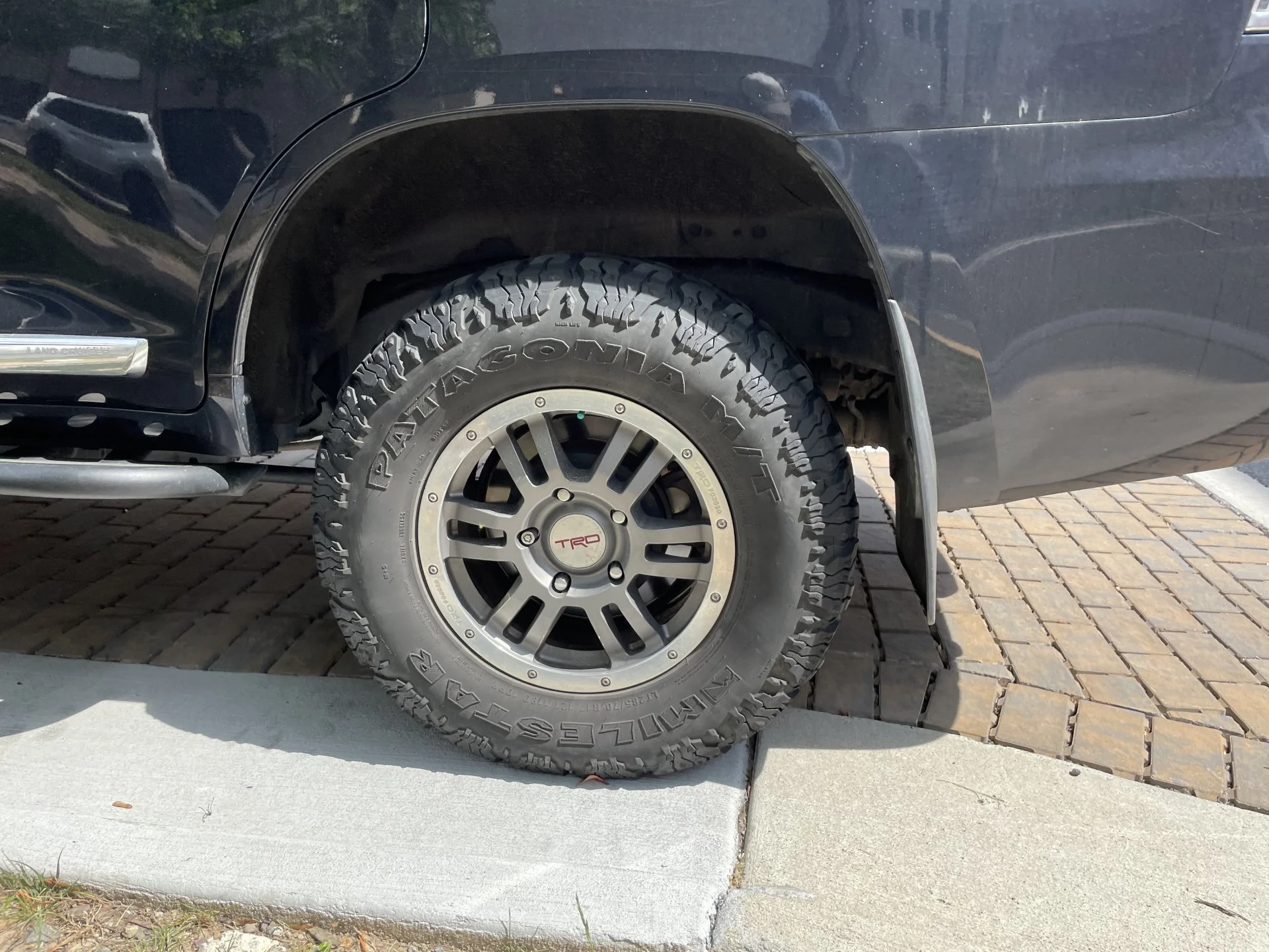

The tires shown are 285/70r17 and are Milstar Patagonia MT… they are too loud and now with the lift they look a bit tame… thought about 285/75 KO2 or Falkens but can’t seem to find a consensus on what it takes to fit them…. Anyway… any recommendations on rubber? Looking to make use of that wheel well space! Oh I have a 2 inch front/rear with their UCAs. Nittos are also on the table!

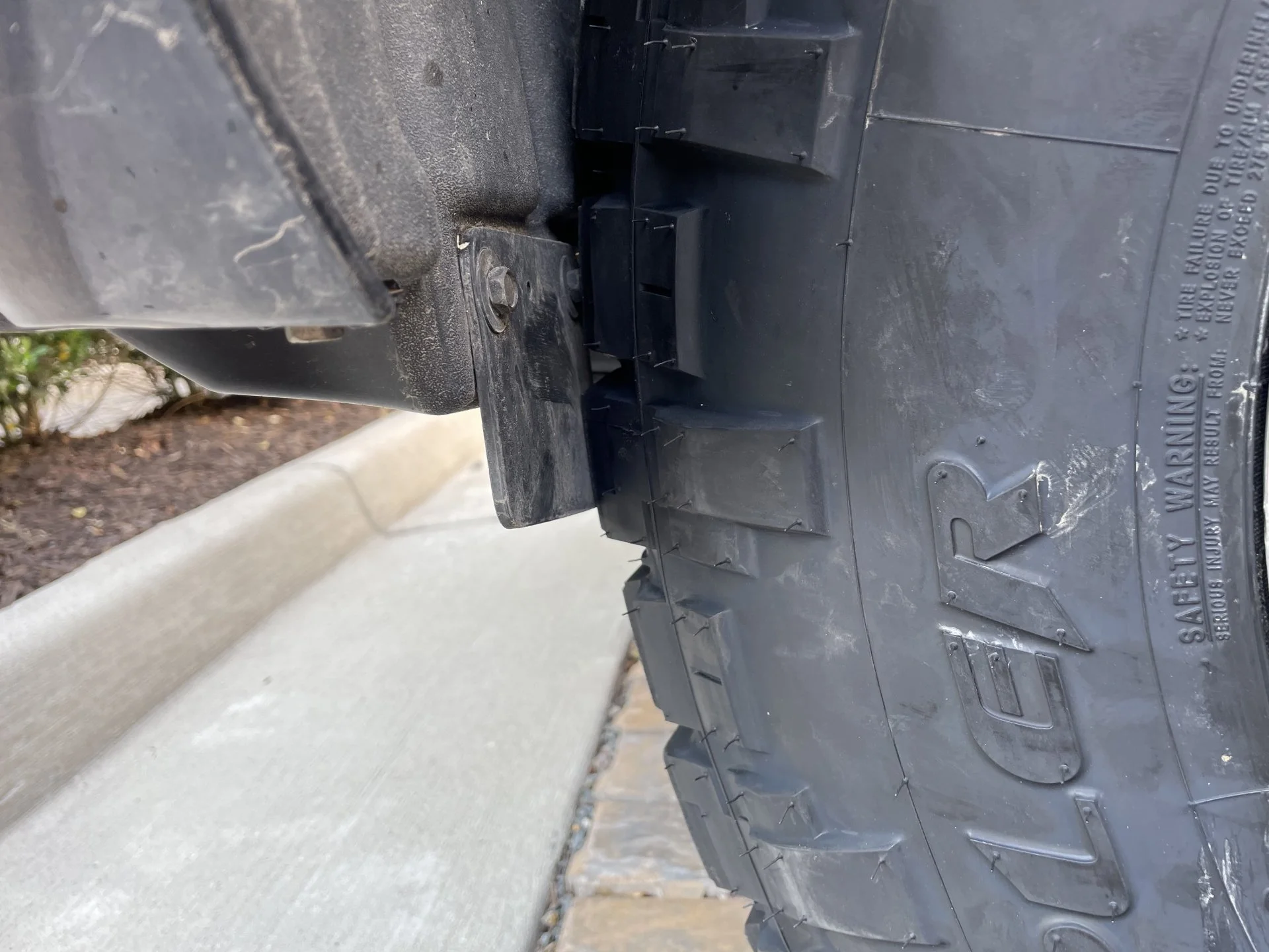

33x12.50 won't be any taller than your current tires, and only a hair wider. Of the sizes listed for the Baja Boss, the 295/70/17 would be your best bet but you might have some minor trimming or mud flap removal to fit them.

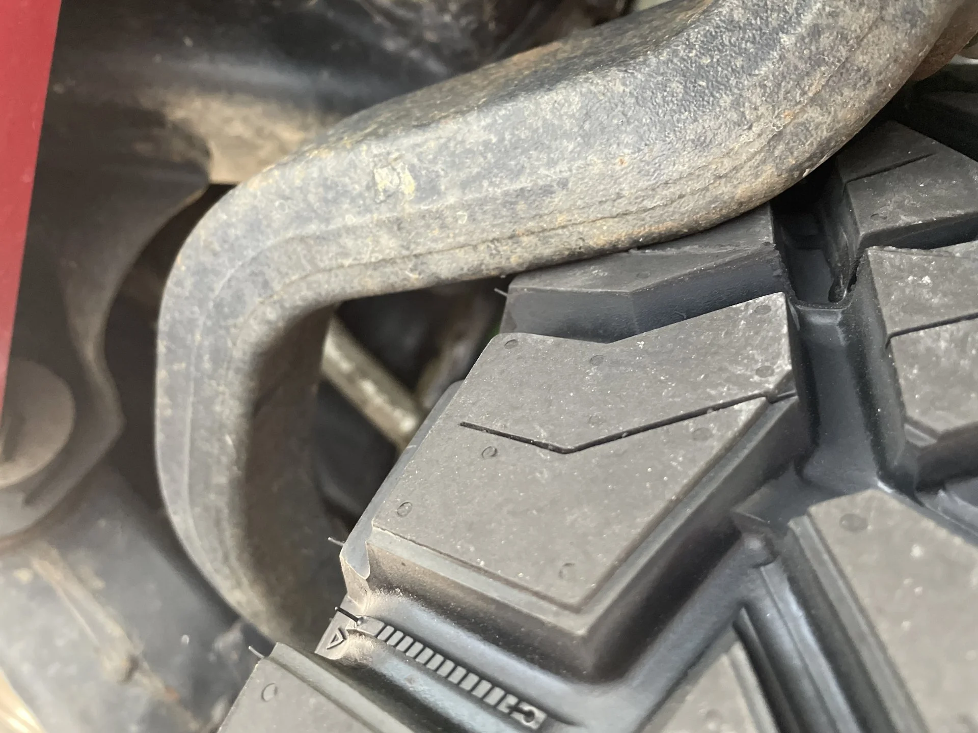

You can remove that front flap for sure. Unless the lift is helping (looks like it does), you are probably rubbing on the rear (of front tire) flap as well. I can’t help with KDSS, I don’t have one of those. Basically for front and rear flaps, you should be able to follow what LX guys are doing for 34-35” tires, then just figure out your kdss.
