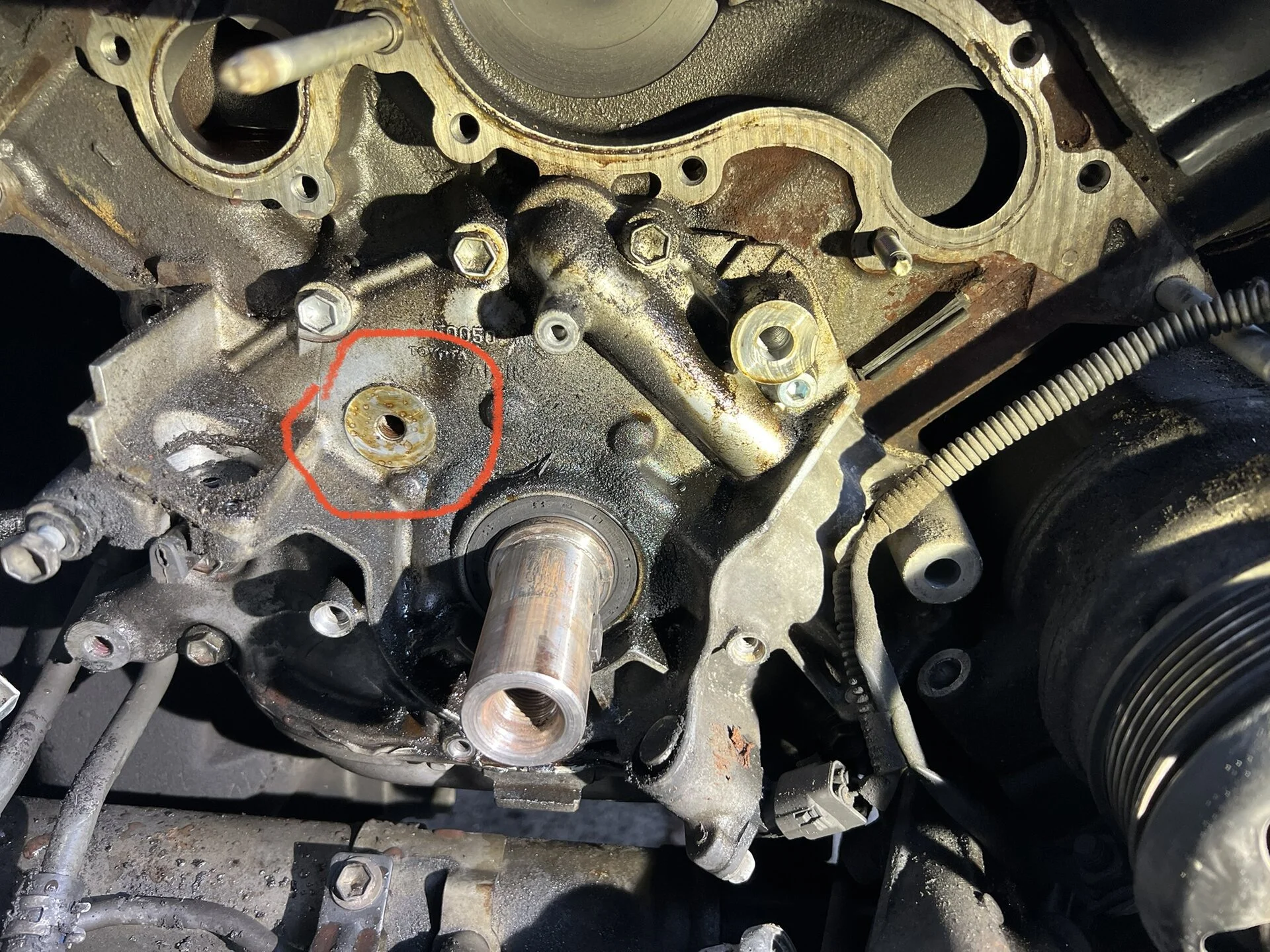

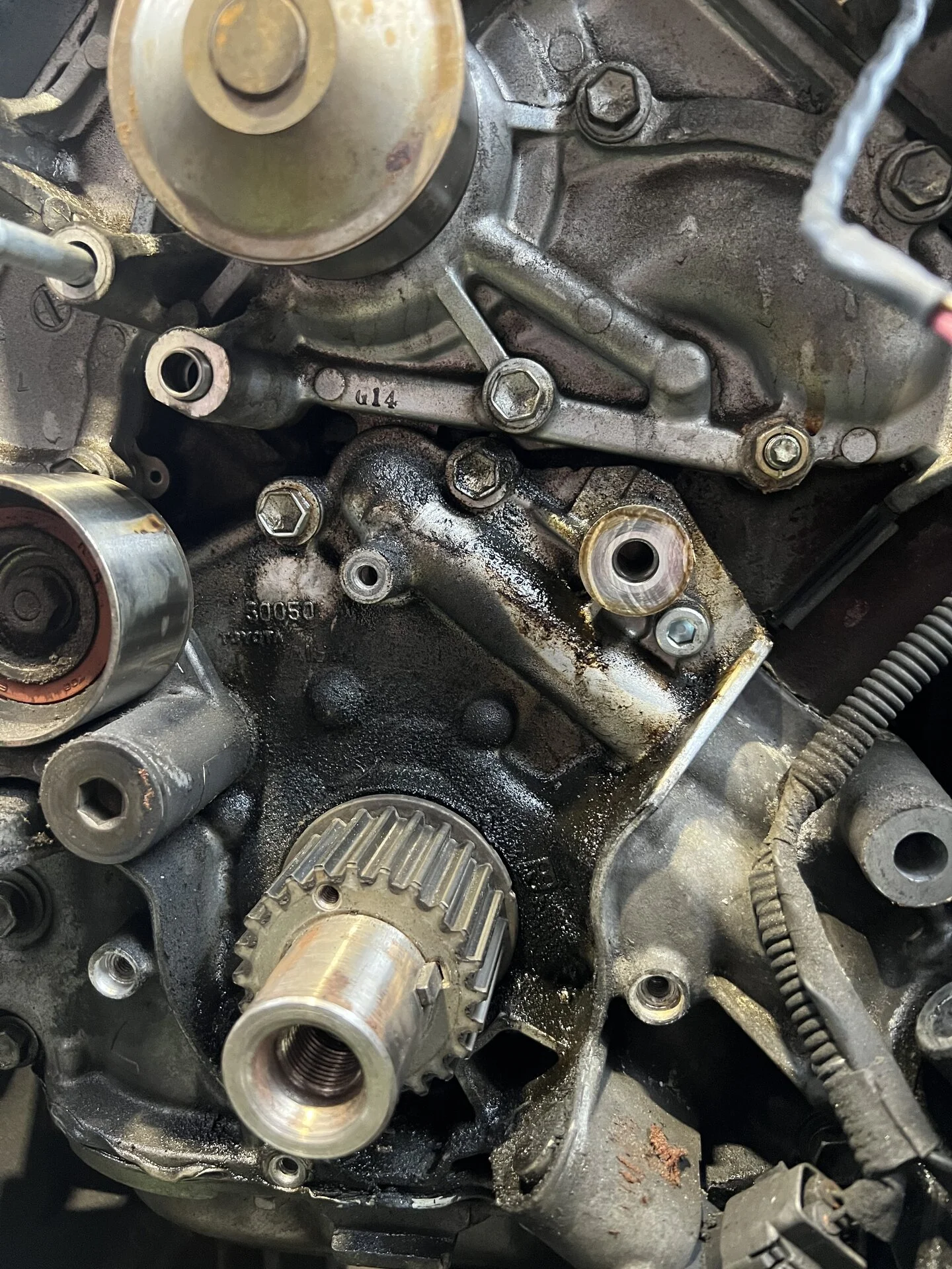

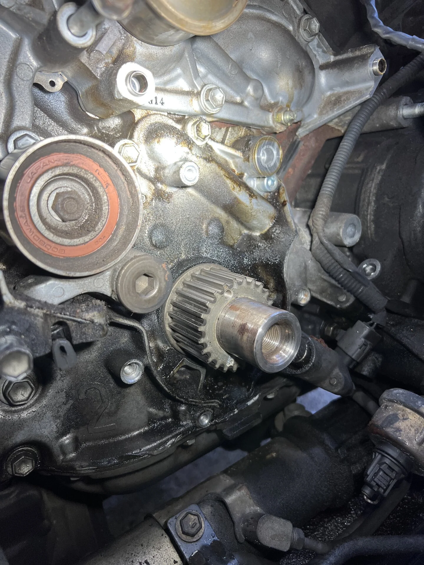

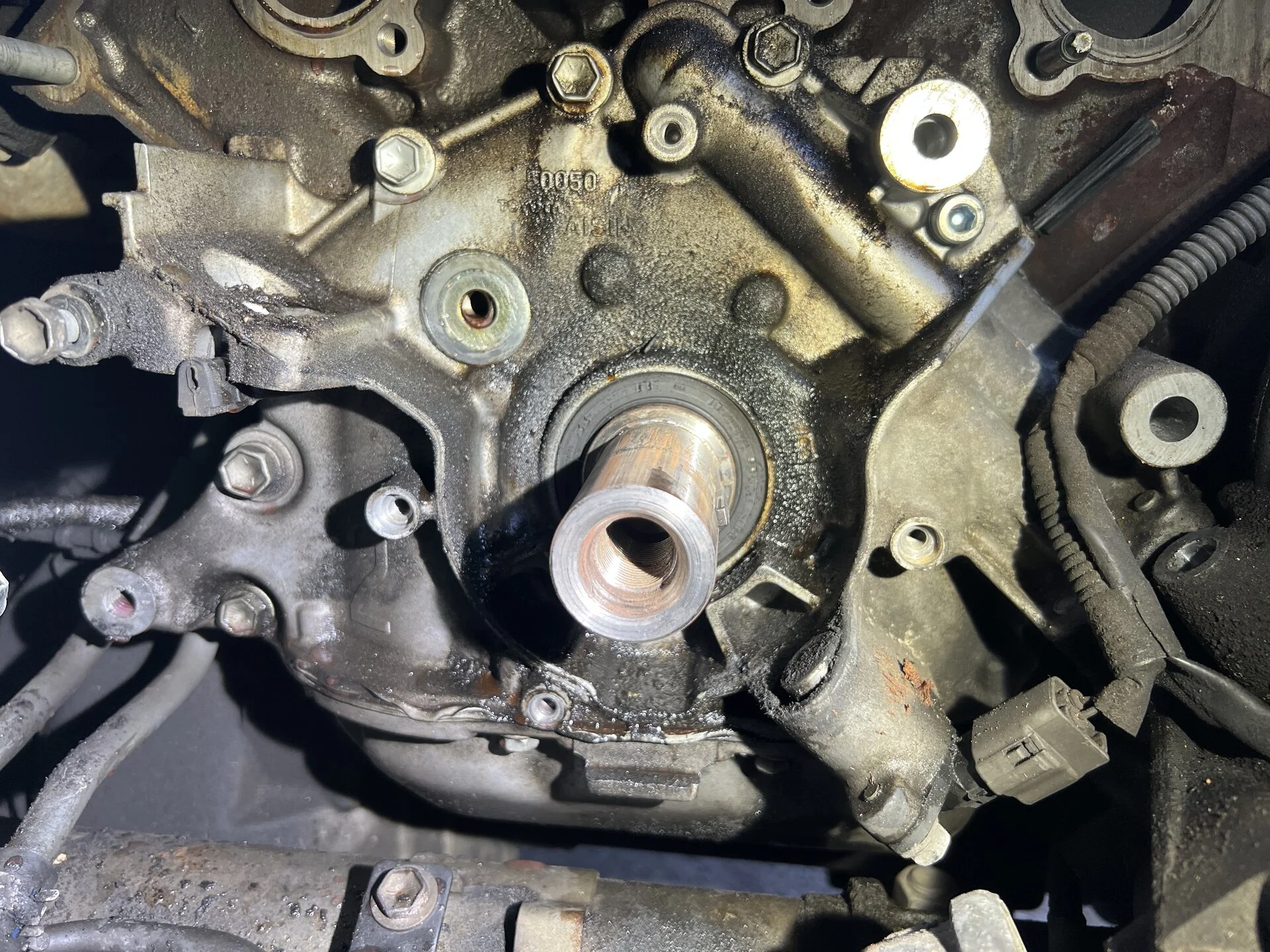

Hello friends, what started off as a simple TB/WP service appears to have gotten more complicated as I’ve discovered an excessive amount of oil around the oil pump area. Adding a few pictures for opinions before I move forward. The last pic shows the crank seal which appears dry. Truck is a 99 LX with 270k miles. Thanks for any opinions/advice!
P.S. I should add that the timing belt and water pump didn't appear to be very old despite the sticker saying it was last done at 107k and 15 years ago. So perhaps this is residue from a previous leak that has been resolved. Also, I noticed one of the TB idler bolts had fresh oil on it when it was removed (can't remember which side).
1 of those bolts needs sealer on the threads, I can't recall which one without looking at the FSM
it very well could be that bolt and that is your issue.

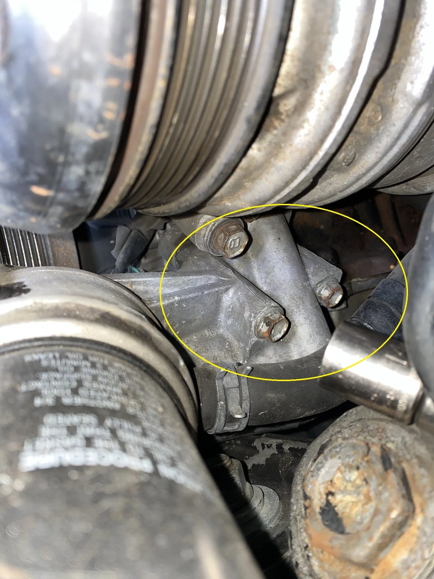

I have a similar leak and I think it’s coming from the oil pump or engine oil cooler?
This is where the weep starts at this highest point. Higher part than than is bone dry.
Oil pressure thread is bone dry.
The two inlet and outlet hoses and their clamps are bone dry.
Has anyone tackled this before? How do I remove the assembly and any special tool to use?
260k miles on the clock and I believe this has never been serviced/replaced before. Would appreciate any inputs at all.
View attachment 3253734View attachment 3253733

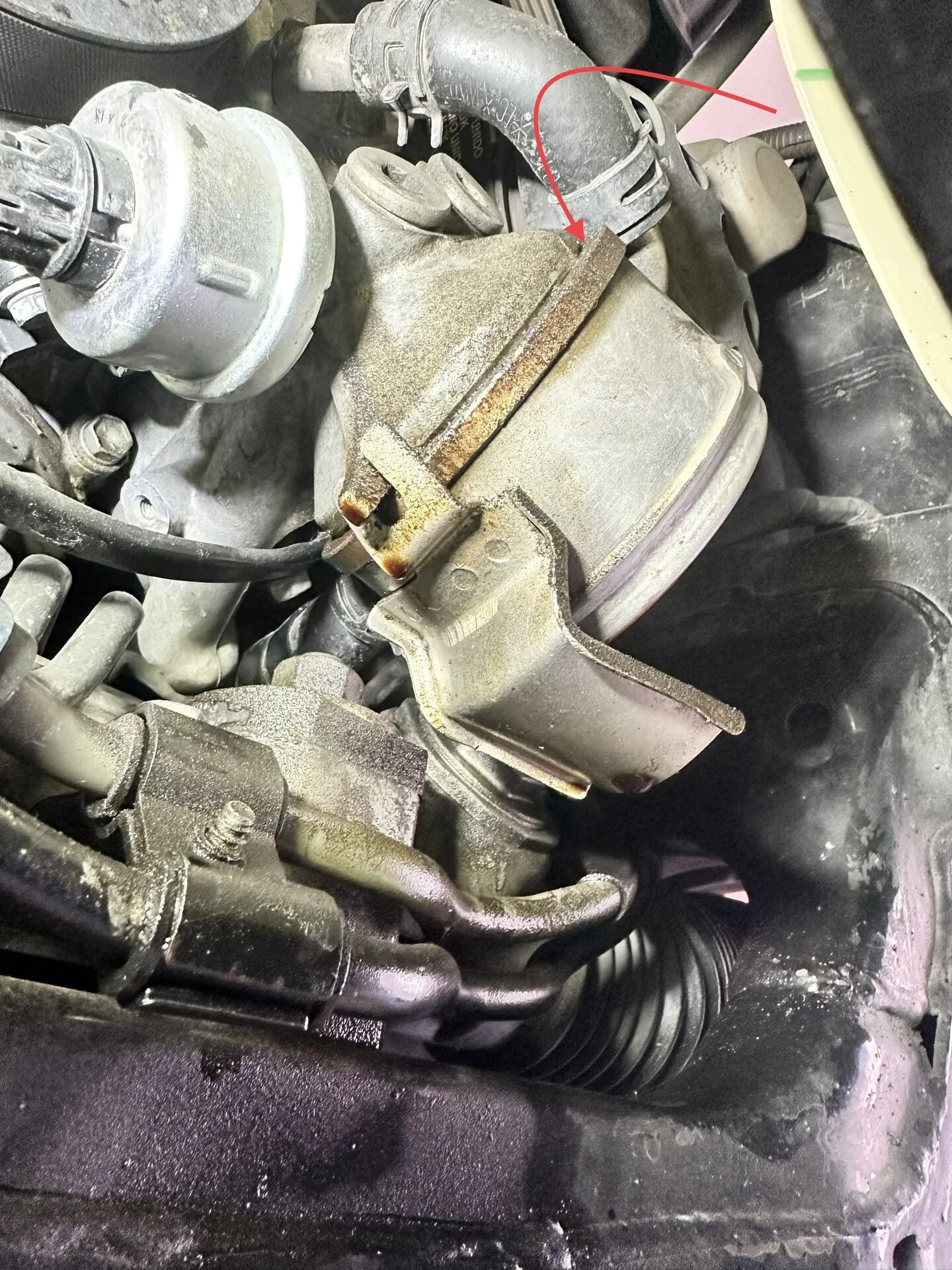

I replaced that o-ring when I replaced the oil cooler hoses. It’s easy.

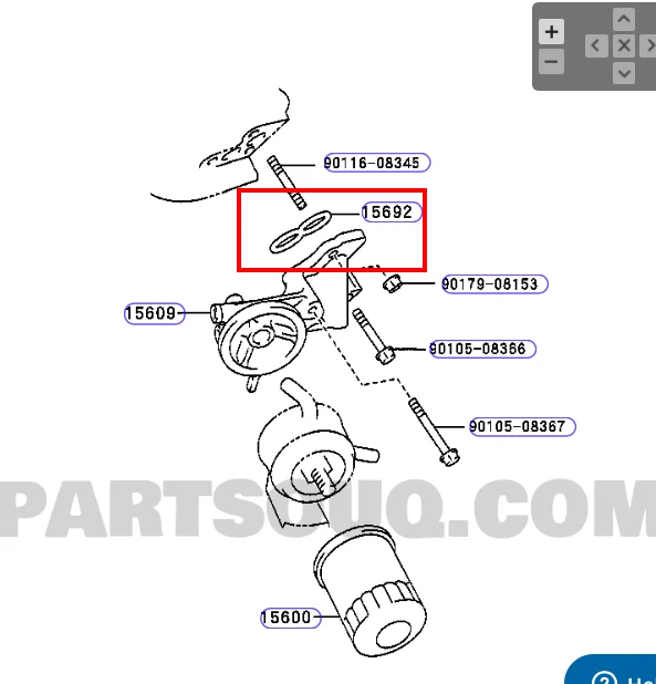

if you go in that far to replace that larger o-ring take the extra step and replace the figure 8 ring behind the oifilter mount. That usually leaks before the larger Oring. Also replace the cooler lines too-(#mission creep)

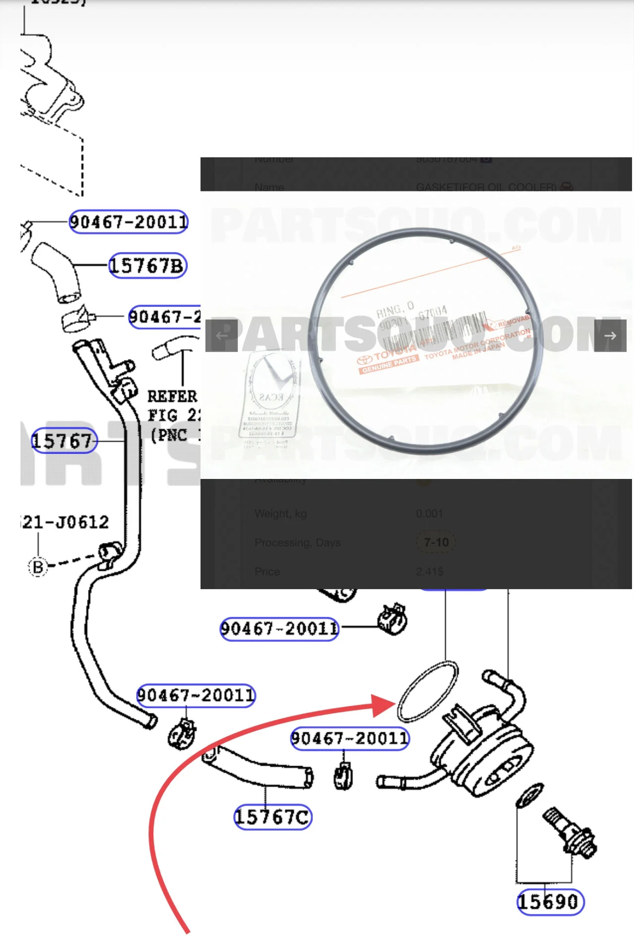

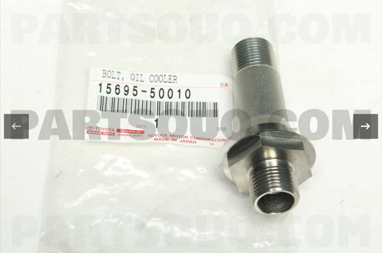

How easy is easy? I saw a video but its for a 96-02 4Runner and he removed the middle 24mm bolt.
is that the same with our 2UZ so I can separate the housing and access the oil cooler O-ring gasket (part #90301-67004) ?

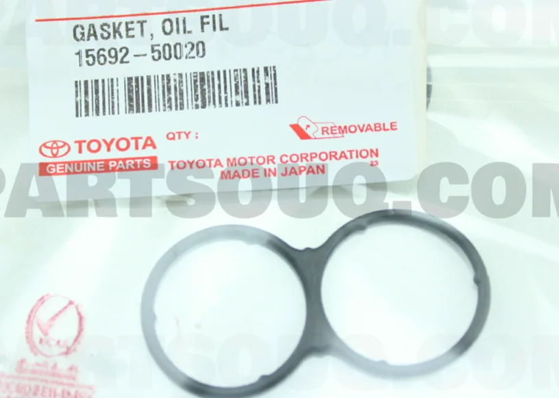

View attachment 3253852View attachment 3253854
Thanks for this I saw one a youtube video with the same engine but in a Sequoia:
However on this video he only illustrated how to replace the figure-8 gasket part # 15692-50020 but not the main oil cooler O-ring part number 90301-67004.

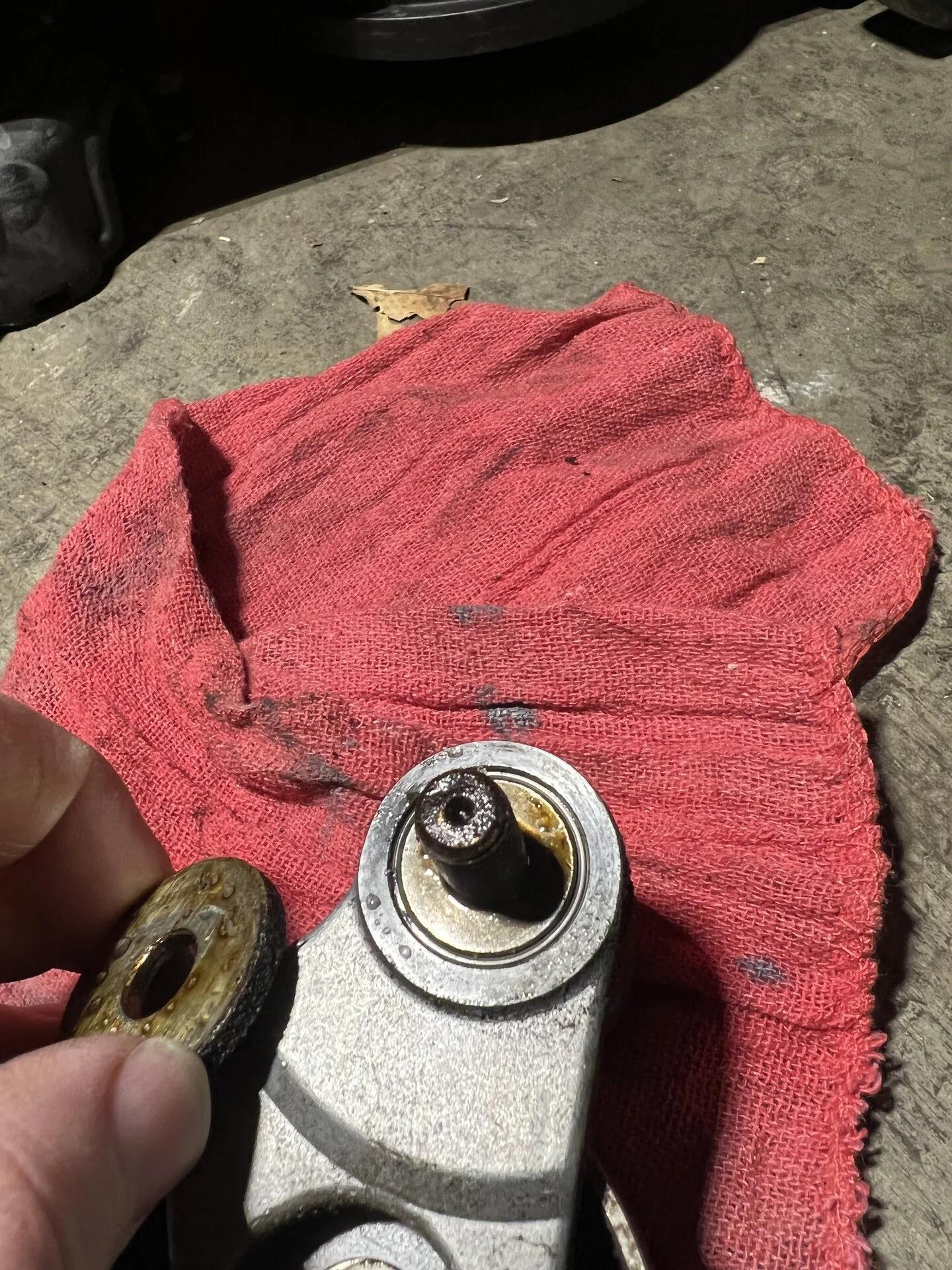

Put a little bit of silicone-based grease on that o-ring so it stays in place when you’re putting it back together. IIRC, I used a dab of dielectric grease.
Also, as I noted above, I replaced that o-ring when I was replacing the oil cooler hoses. If your hoses are fine, they should have enough flexibility to leave them attached to the cooler housing while you remove and install the o-ring, thereby preventing coolant loss.
I've done a lot of 4.7 2UZ timing belt services, on 98-07. From 80K mile up to near 400K miles. Most services, I'm coming in behind someone else T-belt service.
In most cases, where I'm coming behind someone. The bolt threads of tensioner 10mm hex head bolt, have not be sealed. This bolt's hole penetrates the oil pump housing, into crank case area. Which they always leak oil if threads not sealed. It is number one leak seen at front of engine weep hole and right side after a Timing Belt service.
I rarely see crank or cam seal leaks, unless those seals replace before.
I see some signs of oil pump O-ring weepage, in all these days. Which as rubber ages, it shrinks and hardens.
As much as I hate any leak. Which with most oil pump O-ring, will not be measurable on dip-stick in 5K miles. We can live with.

Oil filter housing & bracket O-ring and figure 8 O-ring.
My first reseal of figure 8 O-ring. Was because figure 8 O-ring, slipped during install. I've use a sticky/thick assemble lube, to hold them in place every since.

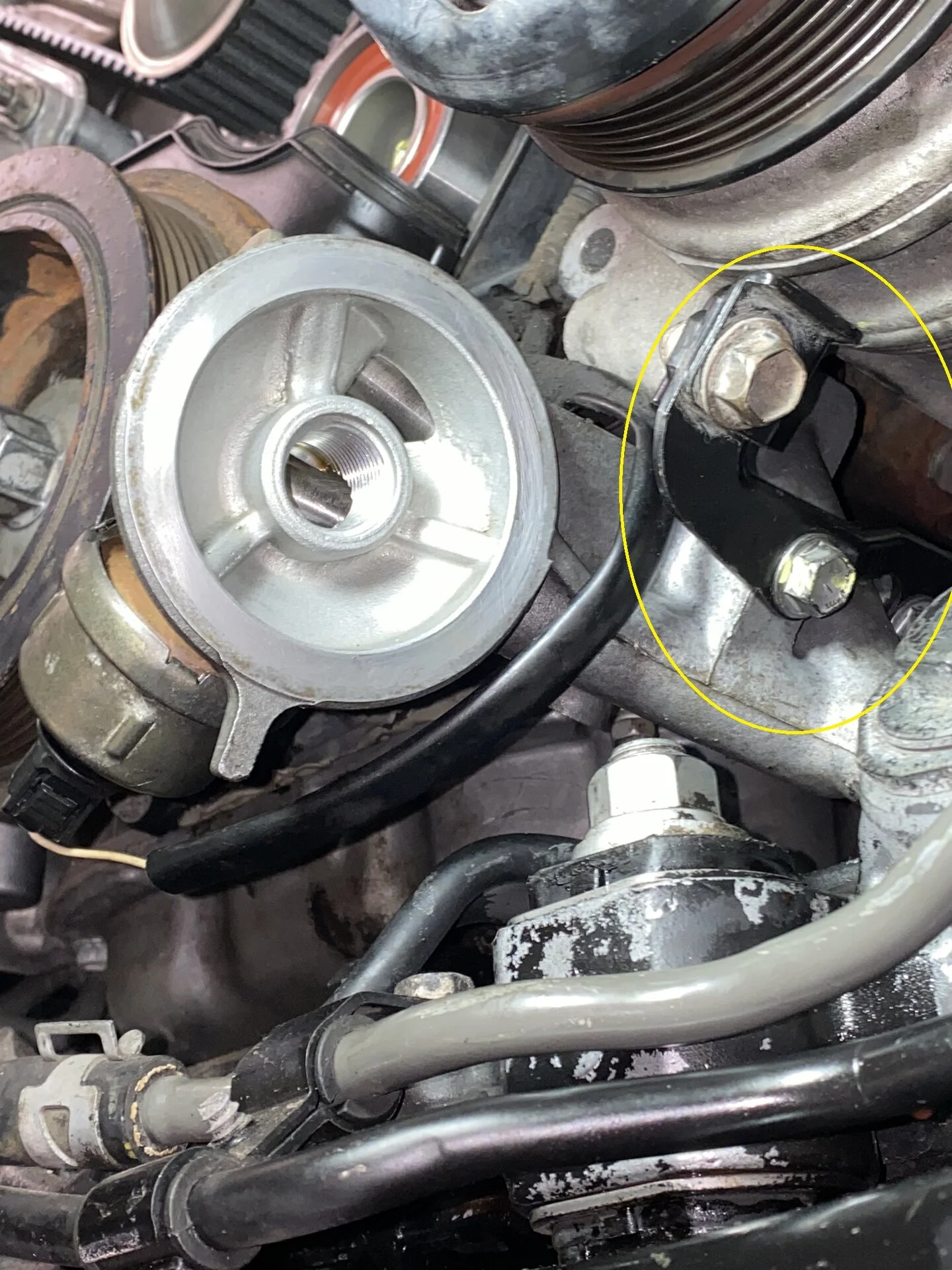

The most common reseal I do. Is after a steering Rack & Pinion replacement. Most shop use the FSM method and pull the oil filter housing & bracket during the R&P R&R. Resulting in leak.
Interestingly:
Two in a row last month during timing belt service, and reseal of oil filter housing & bracket. I found they did not replace the "stays".
The Stay(s) on the 100 series, are two parts (brackets) plus a bolt joining the two stays. One is on the oil filter bracket, w/two bolts passing through. The other is on the AC compressor, w/one bolt passing through to fan bracket. They're joint by one bolt.
In one I just replaced both missing stays, which I also had to reseal oil filter housing and bracket. The upper bolt passing through AC into and securing Fan bracket, was also missing.
In video above 4.7L Sequoia, the stay is different. But notice in the end during assemble, he too did not put the stay back in. Which stay can be seen in beginning of his video.
Toyota engineers had their reason for these stays. So I do install them!
Why are they're being left out. I suspect, most are just forgetting to place back on. Some shop have learned, assembly is easier without stays.
Missing stays
Stays in place
Yes I see that “stay” metal bracket @2001LC in my LX that definitely is going back in. I like everything oem and totally understand why the Toyota engineers put it there.

When doing the timing belt on mine with 450k these were the only two places where mine was leaking. The figure 8 gasket and the big o-ring. When I pulled them off it was evident that more than likely they had never been changed. I put a little bit of silicone grease on them to hold them in place when reassembling.
