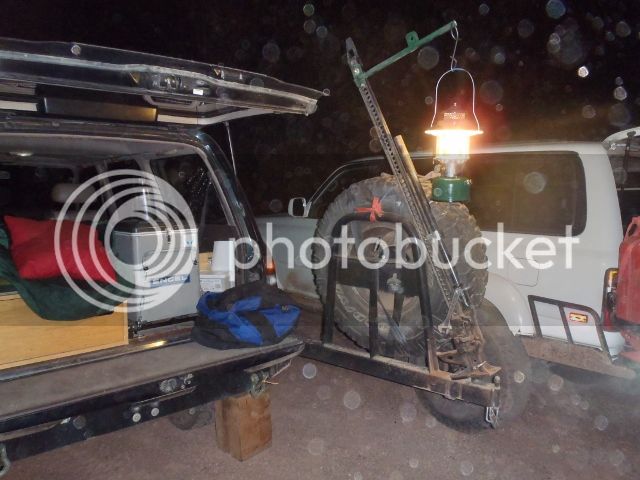

But generally I agree, the hi-lift is only occasionally useful. I have used mine most often to level my truck to sleep inside. Really, this works insanely well if flat ground or the right sized tire rock cannot be found. Also, the upper end of the high lift is a great place to hang a camping lantern.

LOL, that's true, very handy for the lantern. :hillbilly:
