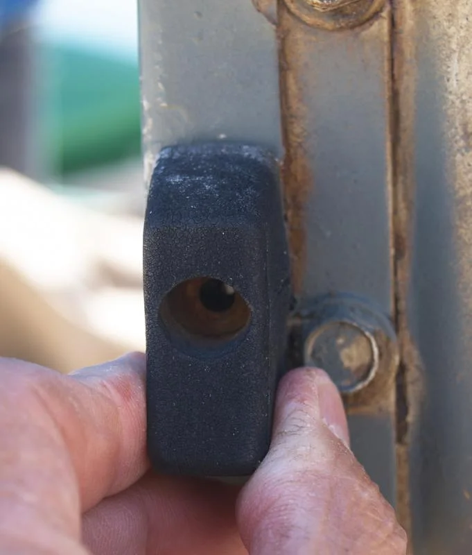

Bumper
Few more of the bumper. Originally I did not see the rotation hole as it was full of muck and flush with the surface, once cleaned out it shows in lower left corner.

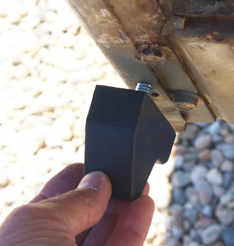

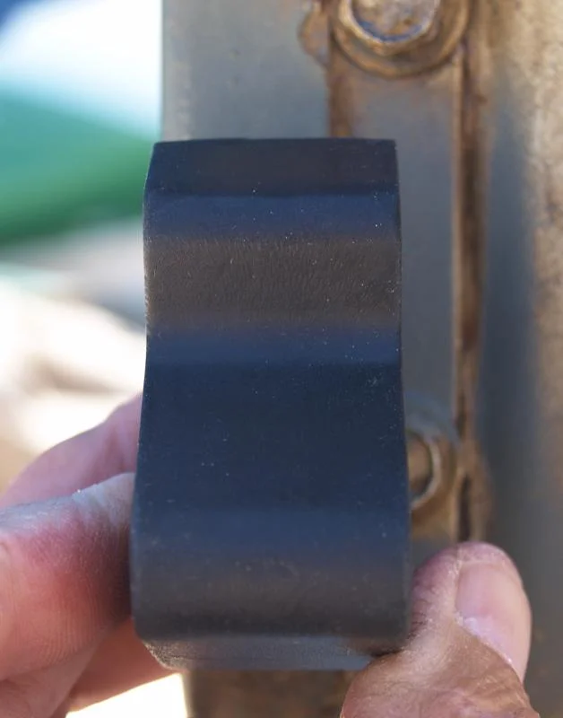

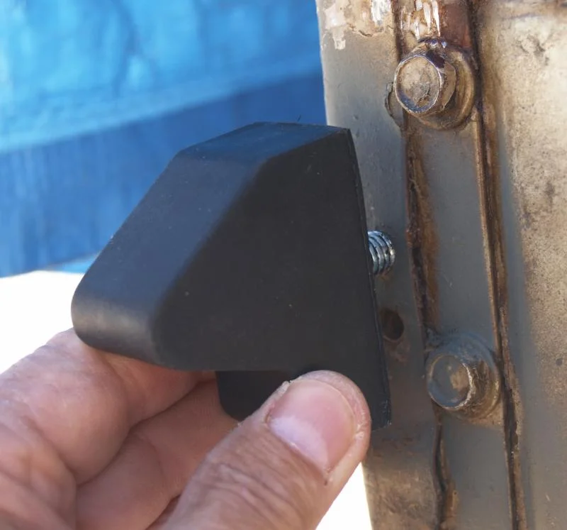

I received the test replacement Dorman control arm bushing to see if it is a good candidate for a tail gate bumper.
As you can see from the photos it is a large bumper that will over lap the original install area and one of the mount holes needs to be enlarged and moved for the stop plug.
You can see the size difference and shape difference.
I had my helper hold up the tailgate to see what angle it sits when rested on the bumper and it actually is pretty decant. Sorry no photo. It is a pretty solid piece of rubber so shaving it would not be impossible but as from what I can see it is a very good candidate just as it is. Yes holes will have to be drilled but that's minor compared to not having any bumper at all.
