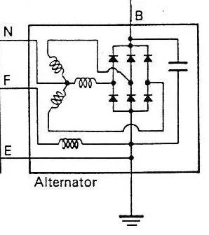

I slowly begin to understand what your problem is (I think).
That alternator that you have there.... is it with a internal (build in) voltage regulator or is it one that needs an external voltage regulator?
Both systems were used on trucks with a 3B engine.
If it's with an internal IC voltage regulator the wires are:
S (sense wire connected to B lug)
IG (from ignition switch)
Lamp (to the charge warning light on the dash)
If it's for an external regulator the wires are:
Null (to the external VR to activate the charge warning light)
Field (from the external VR)
Earth / Ground
Let us know what alternator you have. Maybe you have to open it up to see the internals. As usual...... pics please.
