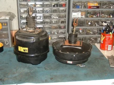

When I was researching replacement boosters for the leaky one on my '80 40, everything I read said that there aren't any rebuild kits left out there for the 40 series boosters. I ended up replacing my booster & master with a setup directly out of a '91 4-Runner. Paid $70 for the pair, trimmed ~1/2" off the threaded rod from the booster to the brake pedal arm, and works perfect! Just an FYI, I also used the front calipers off of the same vehicle. The V6 calipers have larger diameter pistons and also larger pads than the 40 calipers.

I fit a Lexus 450/80-series booster on my Marlin MC. The 450/80 booster was about 2" bigger in dia and considerably thinner than the dual-diaphragm 40-series I removed. Other than the aforementioned mods, I had to persuade the brake lines a little and mount the booster upside down so the vac port was oriented towards the intake.

Fits great, bolted right up with the pushrod trimming. My steup looks pretty much identical to the first photo posted by dgangle. The 4runner booster is a little larger in diameter than the stock 40 unit and much thinner. Looks just like the one that dgangle posted up.
