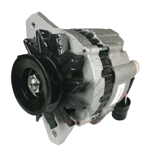

This one fits all landcruiser with 3F from 85-92. Note dimensions at the bottom
TOYOTA LANDCRUISER FJ62 3F OHV 12v CARB 6cyl 4.0L 4sp Auto 4D Wagon 4WD [01/85 - 12/90]
TOYOTA LANDCRUISER FJ62 3F OHV 12v CARB 6cyl 4.0L 5sp Man 4D Wagon 4WD [01/85 - 12/90]
TOYOTA LANDCRUISER FJ70 3F OHV 12v CARB 6cyl 4.0L 4sp Auto 2D Hard Top 4WD [01/85 - 09/92]
TOYOTA LANDCRUISER FJ70 3F OHV 12v CARB 6cyl 4.0L Man 2D Hard Top 4WD [01/85 - 09/92]
TOYOTA LANDCRUISER FJ73LX 3F OHV 12v CARB 6cyl 4.0L Man 2D Wagon 4WD [01/85 - 11/92]
TOYOTA LANDCRUISER FJ75 3F OHV 12v CARB 6cyl 4.0L Man 2D Wagon 4WD [01/85 - 11/92]
TOYOTA LANDCRUISER FJ75 3F OHV 12v CARB 6cyl 4.0L Man Cab Chassis 4WD [01/85 - 11/92]
TOYOTA LANDCRUISER FJ80 3F OHV 12v CARB 6cyl 4.0L 4sp Auto 4D Wagon 4WD [12/89 - 08/92]
TOYOTA LANDCRUISER FJ80 3F OHV 12v CARB 6cyl 4.0L 5sp Man 4D Wagon 4WD [12/89 - 08/92]
TOYOTA LANDCRUISER FJ80 3F-E SOHC 12v MPFI 6cyl 4.0L 4sp Auto 4D Wagon 4WD [12/89 - 08/92]
TOYOTA LANDCRUISER FJ80 3F-E SOHC 12v MPFI 6cyl 4.0L 5sp Man 4D Wagon 4WD [12/89 - 08/92]
Adjusting Hole Diameter M8 x 1.25
Inside Mounting Legs 80mm
Pin Code IR7
Pivot Hole Diameter 10
Power Rating (Amp) 80
Pulley Outside Diameter 82mm
Pulley Section B
Regulator Type Internal
Suits Unit Make Denso
Voltage 12
Alternator Mount Twin Leg
Mount Cnt to Cnt 168mm
