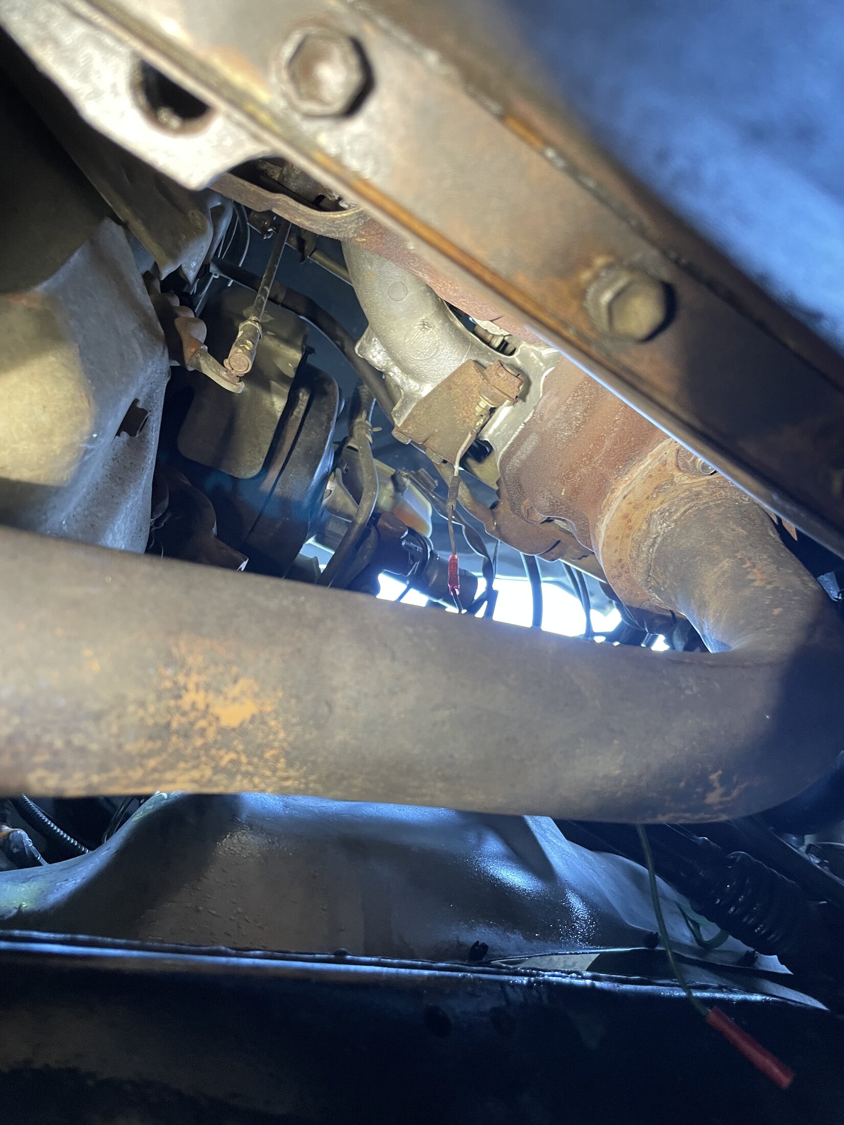

Trying to track down why carb fan not coming on and see this wire…no obvious place I can see it goes. Ideas? Coming off manifold?
That wire goes to a temp sensor in a small bracket hanging down off the exhaust manifold near cylinder 4 or 5, which I can see is present in the last photo. The carb fan is only supposed to come on after you turn the truck off and only if the engine bay temp is high enough.

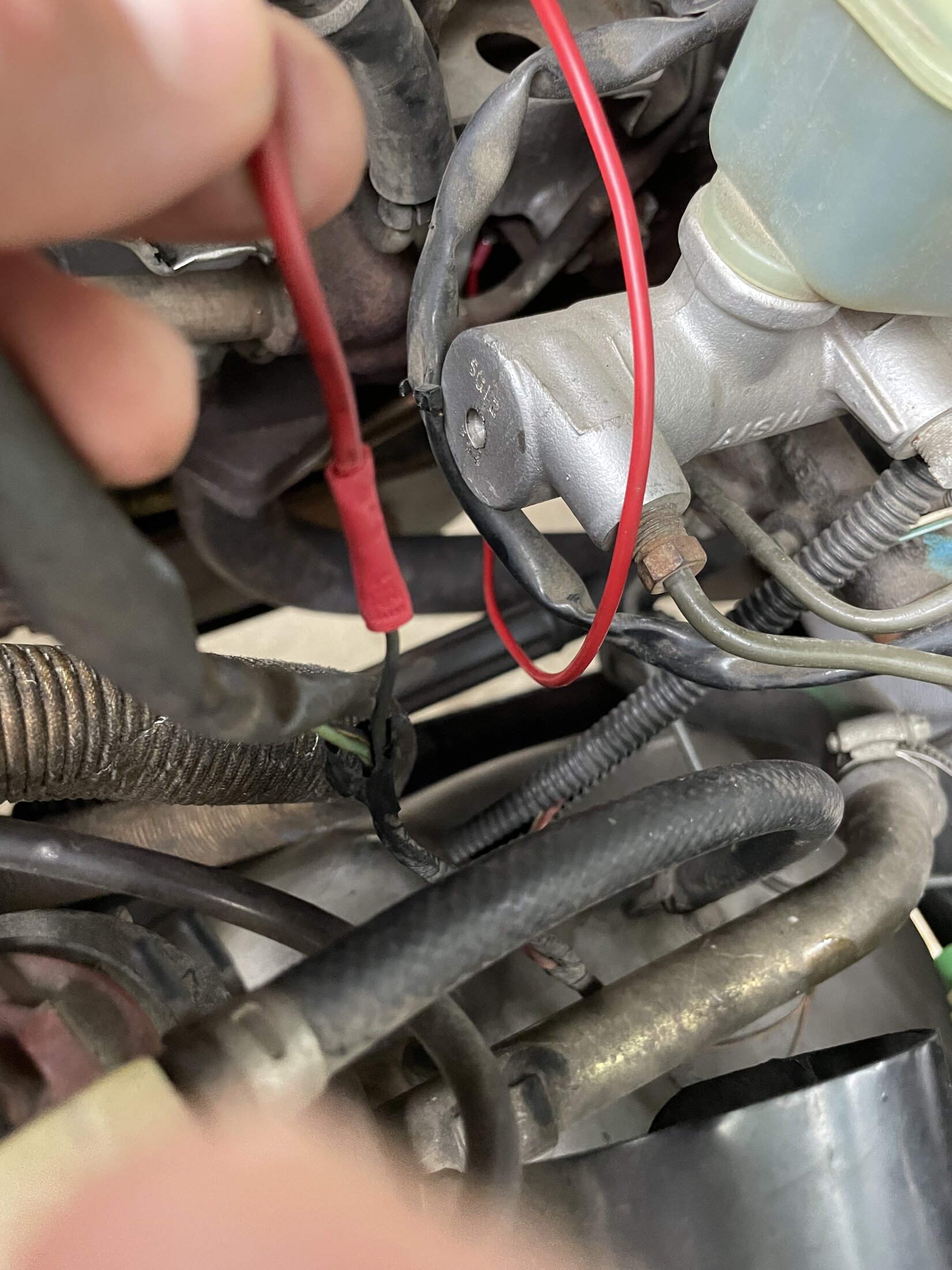

A quick test is to ground that wire to the body, turn the key to “on”, then to “off”. Carb fan should come
On if the motor brushes are good and it has 12V. Check for 12V at the electrical connector to the fan - one probe from your meter to a clean unpainted part of the body (or a bolt head) and then test the contacts in the connector with the other probe. Maybe that connector only has one contact, I can’t recall.

Thanks! So that temp sensor is connected in some way/communicates with the carb fan? Carb fan definitely not coming on. Just not sure if this wire is related or not.

The temp sensor is a thermistor: a simple temperature-dependent resistor. The bracket is grounded through the engine to the body (or should be), so the thermistor is the ground path. As it heats up the resistance goes low and provides a path to ground for the 12V that’s present at the fan - the fan comes on. As things cool down the resistance rises and eventually the fan turns off because the electricity isn’t able to flow to ground.

Yes the wire is just dangling off the temp sensor…

Ok…just watched a video and figured out the ground wire situation. The plug the ground wire is green up top by the carb. I thought it was the plug coming off the fan. Anyways …I touched the broken wire coming out of the green plug by the carb to ground and viola…fan runs!

Ok…thermocouple wire is just dangling. I’m assuming it goes to the broken ground wire but not sure as it’s been repaired before and is different color wire …I’ll try tomorrow
Ok ..all fixed. The ground wire is coming off the green plug up by the carburetor. It’s not coming directly off the fan plug. When I touch that ground wire to frame fan came on I splice a new wire onto that and attached it to the thermal coupler on the manifold. Drove around for a while to get the truck up the temperature and Walla the fan comes on thanks for all your help everybody. I tried to upload a video of all this, but apparently mud doesn’t allow videos.
I just looked at my 60 and yes, the thermistor wire comes into the harness at the same place the fuel control solenoid wires do. That’s the green plug on the carb, so I followed those wires back to the inner fender and that’s right where the thermistor wire joins. It must feed through the harness for a couple inches and then go to the plug at the fan. Nice work.
