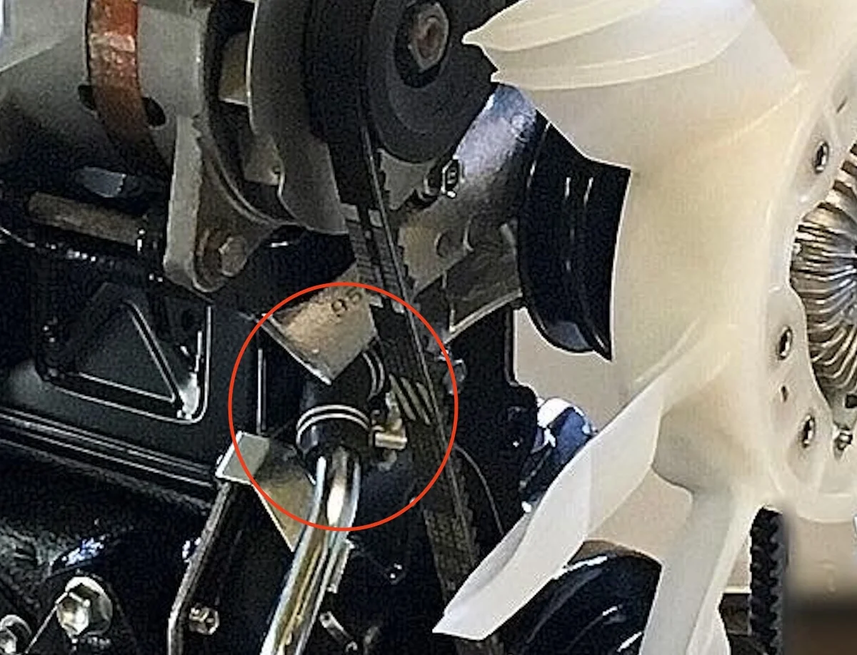

There is a "hose from hell" under the water pump - like a 2" hose - hard to see from the top but it is there. If you are getting coolant and not from the big hoses, see if you can see the hose clamps on that little hose and tighten it down. You may have to pull the fan off or remove the alternator to get to it. Note that replacing that hose pretty much means you have to pull the water pump.

Ok dang…I’m not familiar with this hose but it sounds like a good candidate. Thanks for the picture too! Very helpful!

This was the culprit. “Hose from hell” is no joke. I was able to get to it with a socket on a swivel/extension…easy fix until that thing needs to be replaced !
Glad it worked out! Hence my comment on water pump replacement - I did it once without removing the water pump and do not recommend it...
