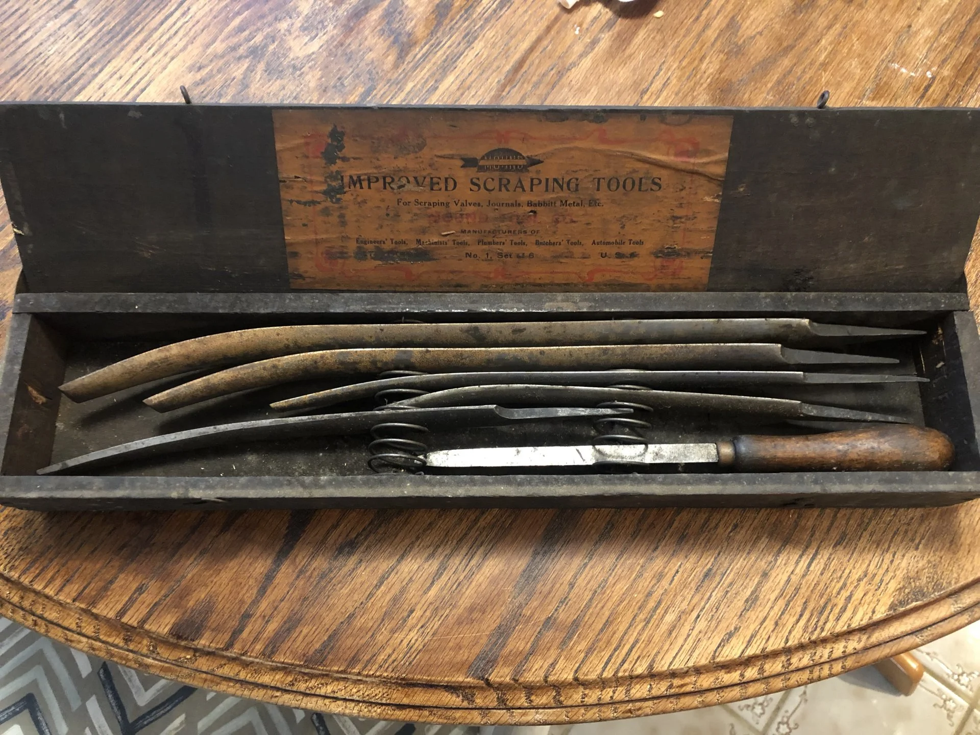

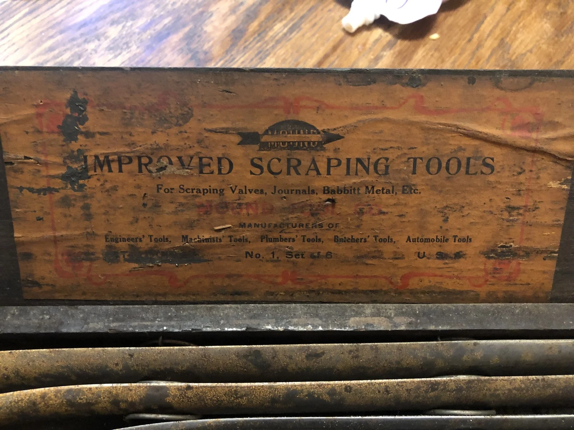

Finishing up sorting through some tools and boxes and came across this very old box of "Mound" scrapers. Kind of cool and they look like they belong in a museum. The label says for scraping valves and journals, but they look like wood working tools to me. I would assume someone here knows the history and how they were used?
Very nice. Never seen those actually, but why would you think they are not what the box says? Looks legit to me, I can see that babbit bushings may need scraping.
I have no doubt the label doesn't lie, but my knowledge is clearly lacking as I have never heard of scraping valves, or for that matter, a babbitt bushing until I opened this box. Down the rabbit hole I go.
Those are really neat.
Those are hand scraping tools for metal. Hand scraping is used for metal. It's a fitting/alignment process. It's a highly skilled process that few people understand
If you want to know exactly what those tools are reach out to Rich King @ http://www.handscraping.com/
Years ago I hosted one of Rich's scraping classes in my machine shop. It was a great learning experience.

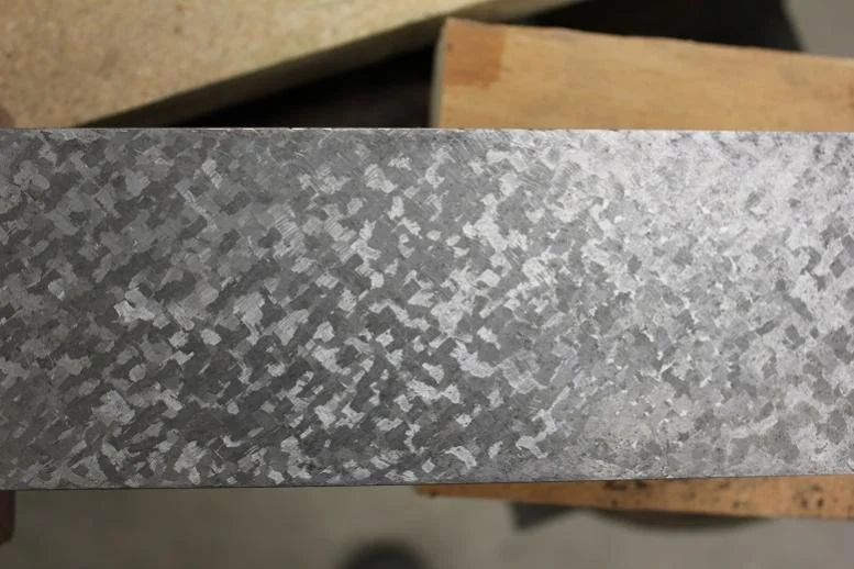

This is what a scraped iron surface looks like.
There is also power scraping with a special tool called a Biax.

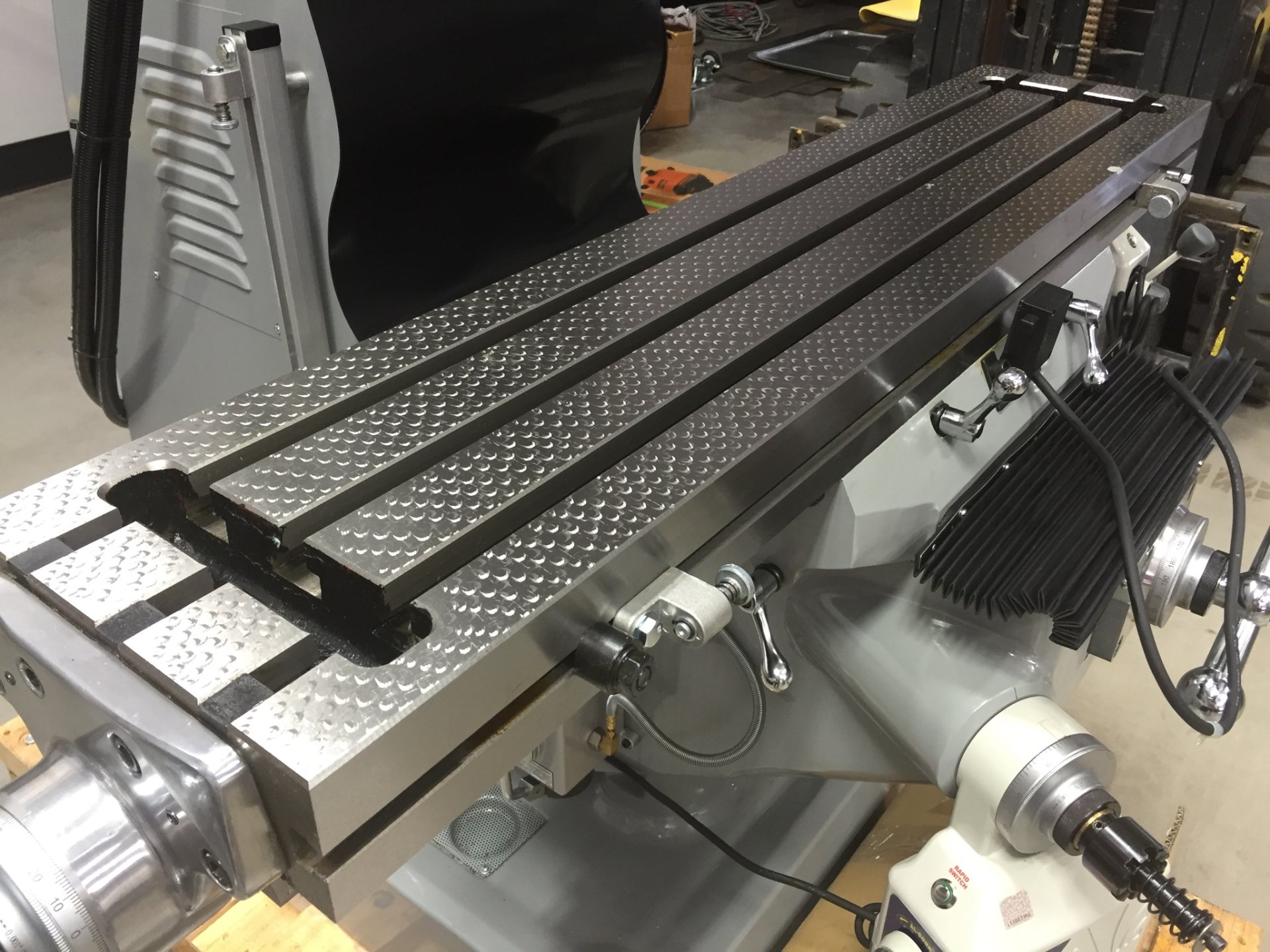

Here’s some sexy scraping on a mill table.
It's not easy to tell the difference, but that mill table is ground with decorative flaking for looks.
Flaking can be used for oil retention in a way system, but its a bit of a different concept compared to actual scraping.
Scraping is done for alignment and bearing. There's precisely defined standards for load bearing points per square inch so to allow a way system to move properly and minimize stick-slip conditions.
Check out Moor pattern scraping. It does retain oil like jewlling.
What you saw on the mill table is a crescent shape “Moor technique” scraping . Although it looks cool it’s actually flat as can be. Much harder to master than straight scraping.
