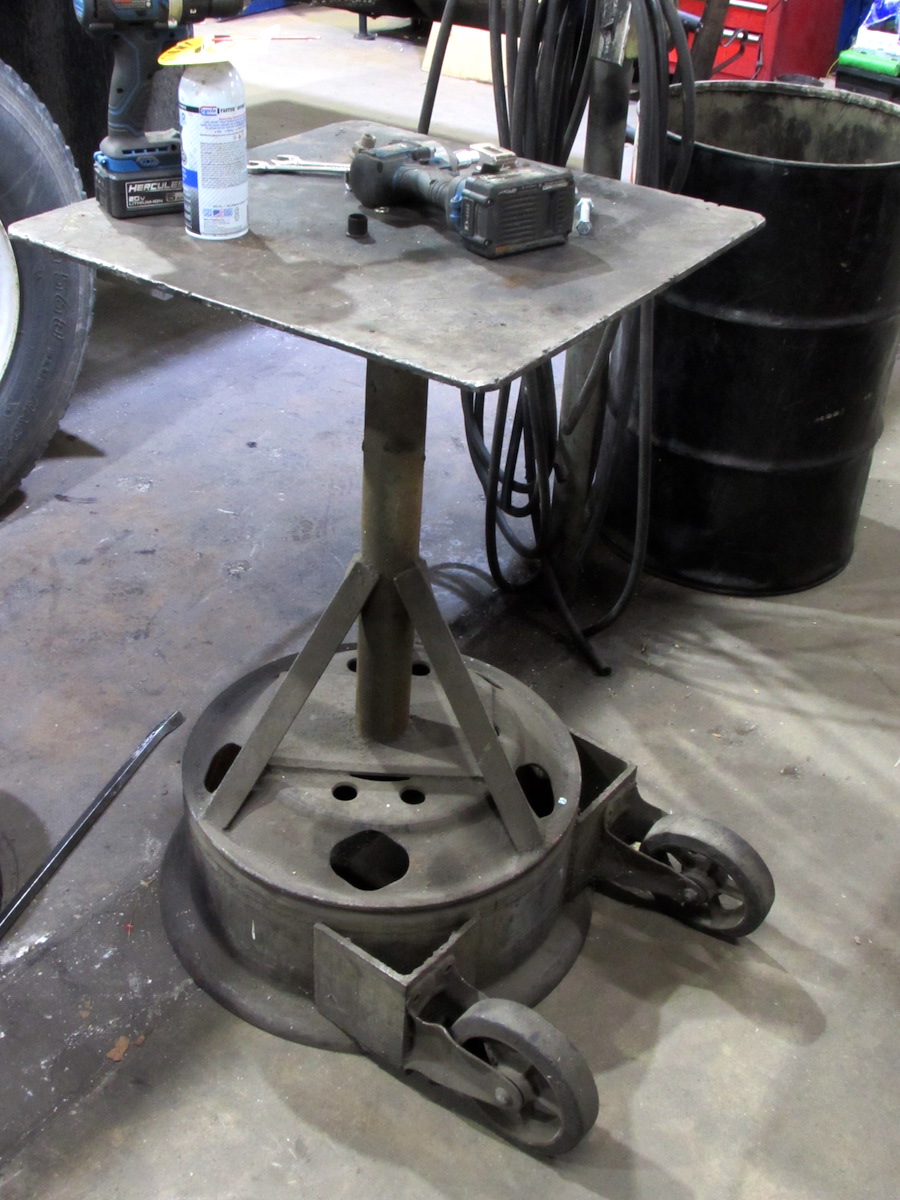

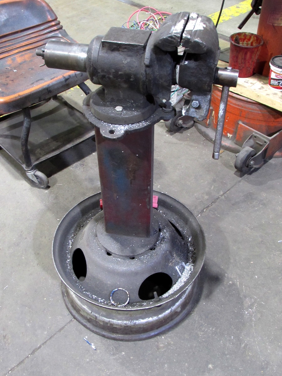

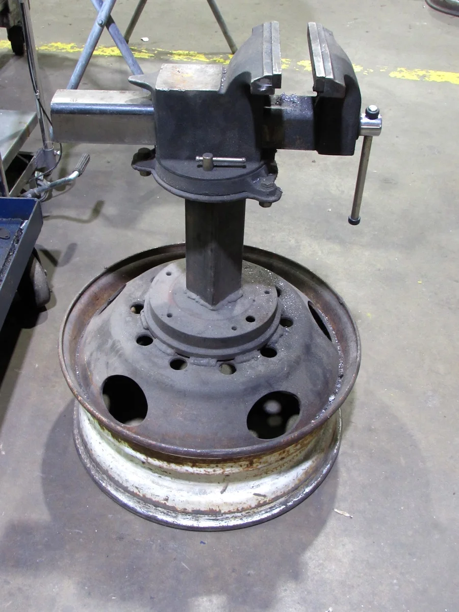

Yep. It's a vise stand. They welded a VW brake drum to a truck wheel. There is another stand that is similar to your right side drawing - the one with wheels on it. I can get a picture of that for you.
Along with other things, the Shop does work on MDT and HDT vehicles and trailers so there is a regular supply of used brake drums, rims, and other components available that find their way into other uses.

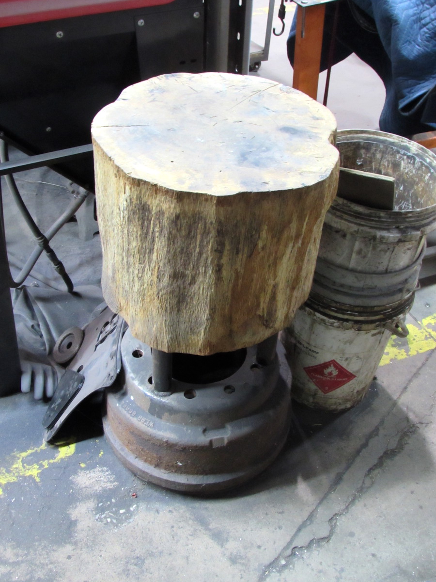

A drum base for "Stumpy" our metal shaping stump. I need to find a good stump to make one of my own.

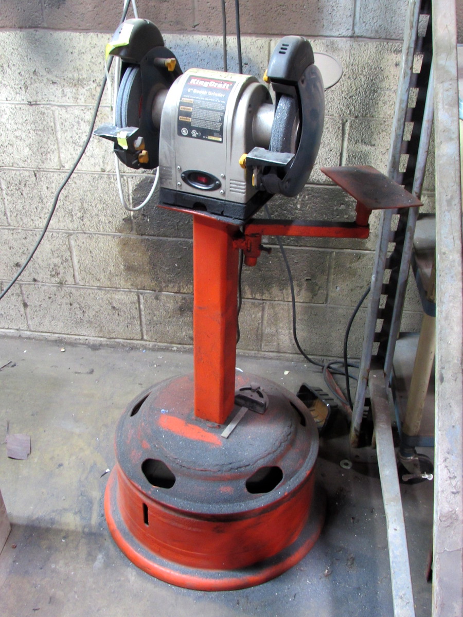

One for a grinder.
The shelf is just a tube and rod for the swivels - again, just scrap materials floating around.

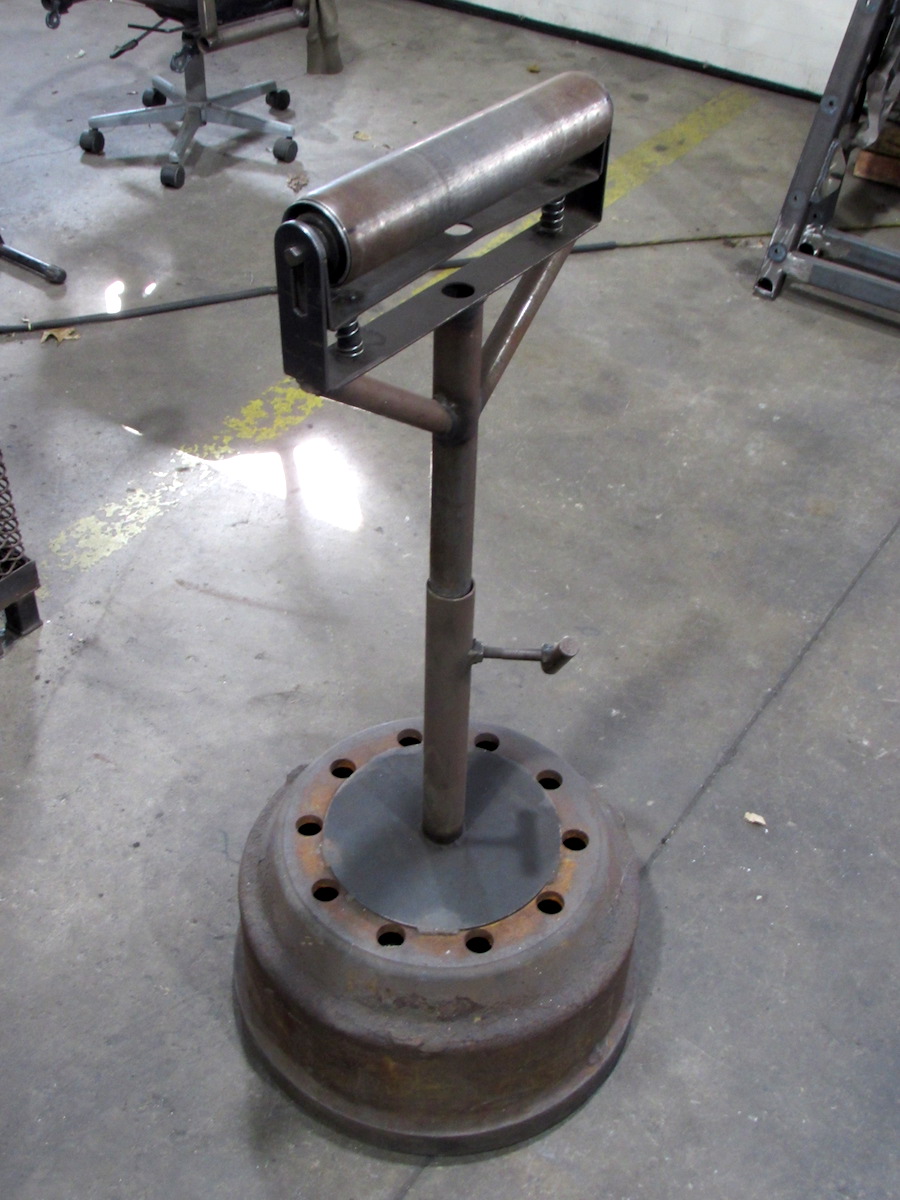

And a material roller support.
The adjustment on that is just a nut welded to the tube with a bolt and a piece of rod as a handle.
DIY at its best! Nice!
I have a grinder on a base built -did not build it myself- on some sort of huge truck brake drum as well. Surprisingly heavy and stable. I like it!

One for a grinder.

RE: stumpy... cool idea and maybe ya'lls need an anvil [too] ;)
I keep trying to convince them that it is of limited use being only semi-flat.
I also have a Gene Winfield style pipe anvil on my list. Just need to make the effort to acquire some drops of different sized pipe. I do have a gas cylinder that didn't pass inspection that I think would be a good part of it.

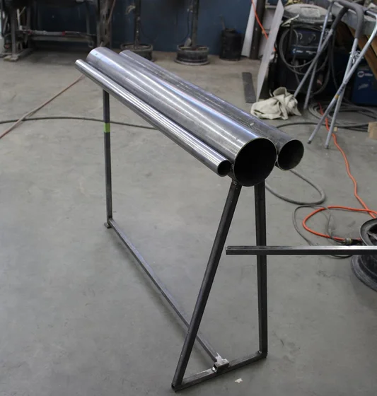

This was the coolest tool stand I've ever seen.
It was in a fab shop in Cheyenne, WY.
It's a drilling head for a well drill.
