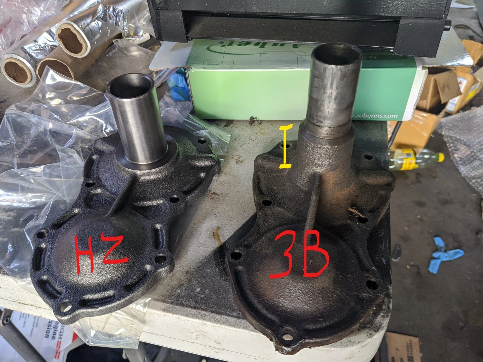

- I re-used the 3B bearing retainer (I think now I need to switch this part no matter what? I didn't initially see that these are different part numbers, if I need to do this the transmission has to come off anyway and this scenario will change) - there seems to be more than acceptable slop in the shift fork and throw out bearing riding on that shaft, but I can't work out how that could cause this issue. There is also no sound coming from the bell housing or any minor changes in rpm that could indicate some minor resistance at the clutch

I did just get my hands on this bearing retainer for a 1HZ H55F. Compared to an old 3B one I have laying around, it looks like the throw out bearing could be getting forced into the pressure plate since it wouldn't have nearly as much back travel. The shaft begins almost 2 inches further up on the 3B retainer. That could definitely cause a lack of a mechanical link.
Ugh, looks like the transmission is coming out again. The OD on this shaft is pretty different from the 3B as well, really screwed this part up. Hopefully nothing is destroyed. Going check 4wd on the t case too just to be thorough. Thanks

A lot of difference in those bearing retainers. I would have installed the 1HZ.

Yeah, rookie mistake. I really didn't know these parts were different, I should have questioned things when the throw out bearing had a loose fit on the retainer.
There's like maybe a millimeter of free play there, but I don't know if I would call it "free". Takes some effort to get that movement. It's all adding up now.
Definitely need the 1HZ/1HD retainer.

Thanks for the help everyone. Got the truck moving today. Other than the retainer being incorrect, the tip of it wrecked the clutch disc since it was pressed against the splined ring so I replaced that too. Just a warning to any other first timers taking on a project like this, make sure you have the correct retainer. I used information on mud for this part of the project and the thread I looked at did not mention this because the retainers were the same in that particular case. Check your part numbers, don't end up like me!
