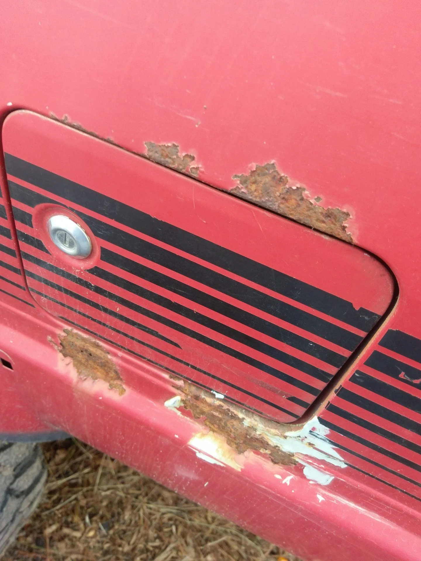

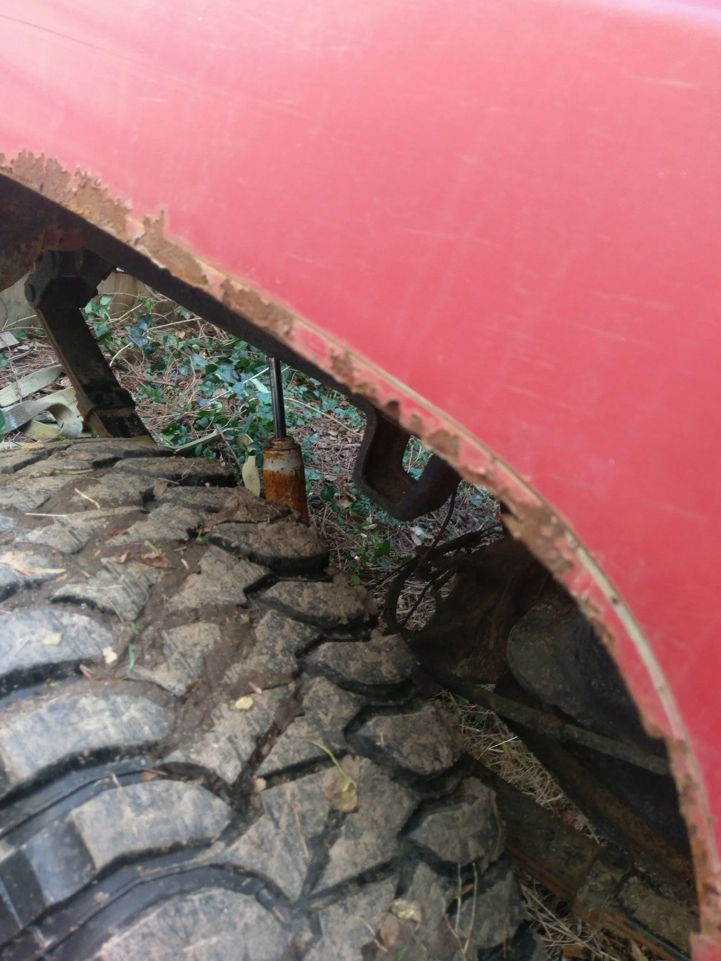

Typical rust from what I've researched
and the rear "bed" area had pin holes all over it and the tops of the wheel wells on the rear had some holes.

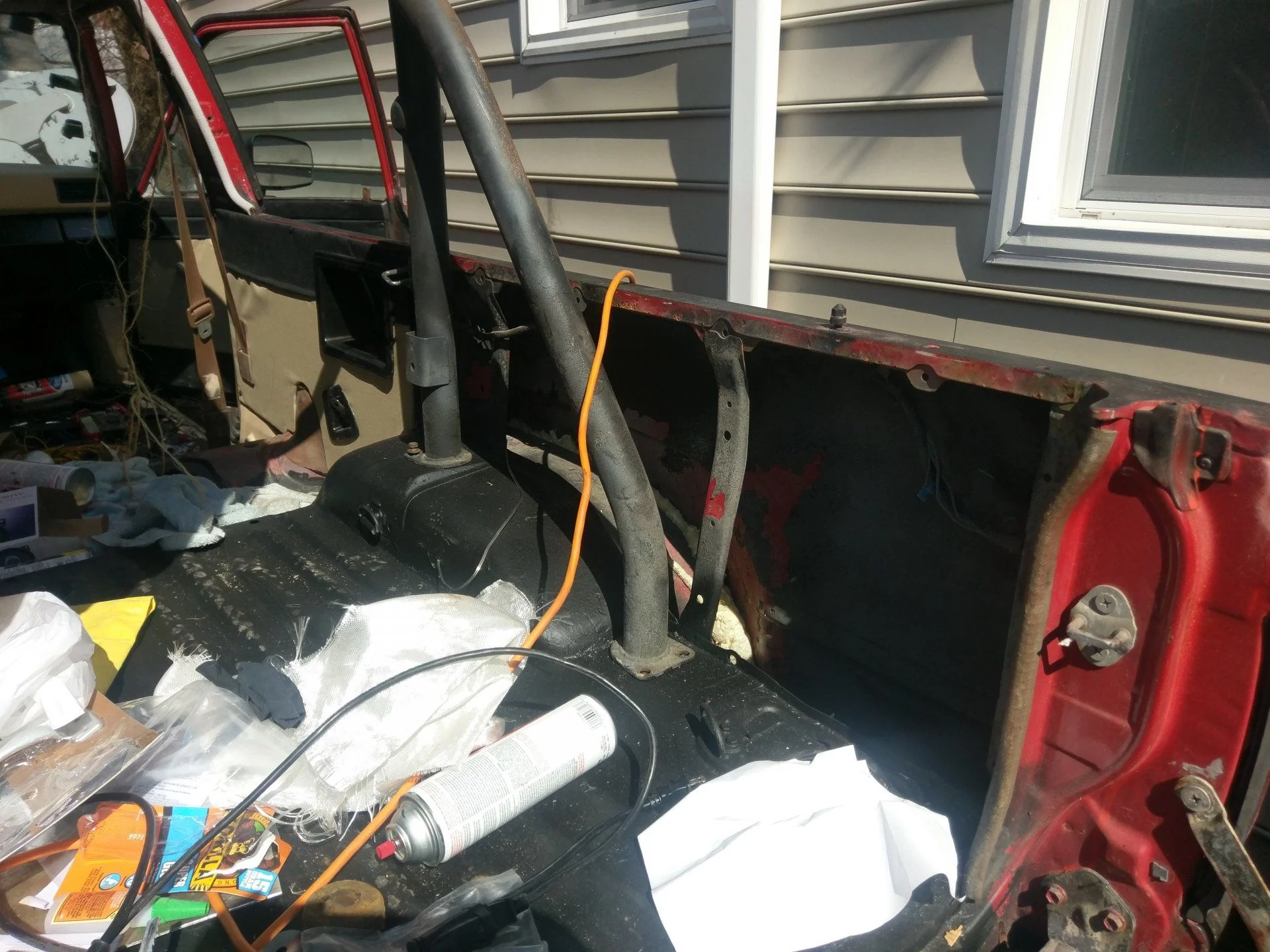

So I started by cutting all the rust out of the rear fenders
The I went absolutely crazy with POR-15 and a grinding wheel. That stuff is NAAAASSTY, but people swear by it. Knowing this isn't going to be a show car, I filled all the rust holes with fiberglass. There wasn't anything structural and no hole bigger than the one I showed on the floor board.

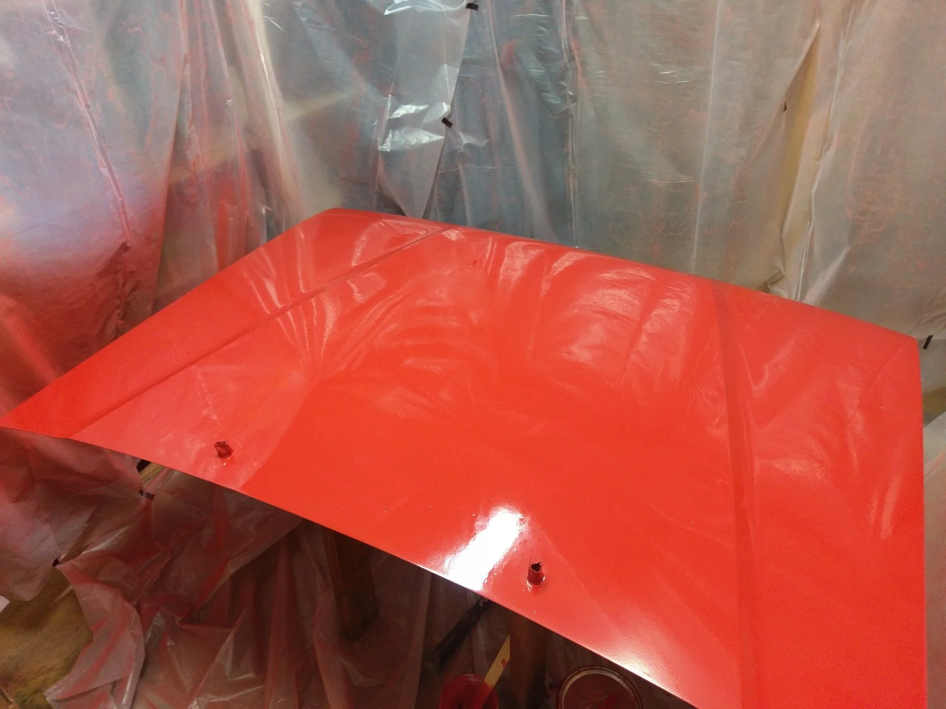

On to paint, I turned my shed into a paint booth with some plastic and box fans. Bought a harborfreight $10 paint gun, borrowed a big compressor from my pops and bought an acrylic enamel kit from PAINTFORCARS.COM. Started by removing panels and doing them daily rotating them in and out and on and off the truck. Decided to bed line the bottom sections of the panels to make them scratch resistant on the trail and to mask the uneven areas where I sanded and treated the rust.
Then waited for a nice warm day to do the parts I couldn't remove

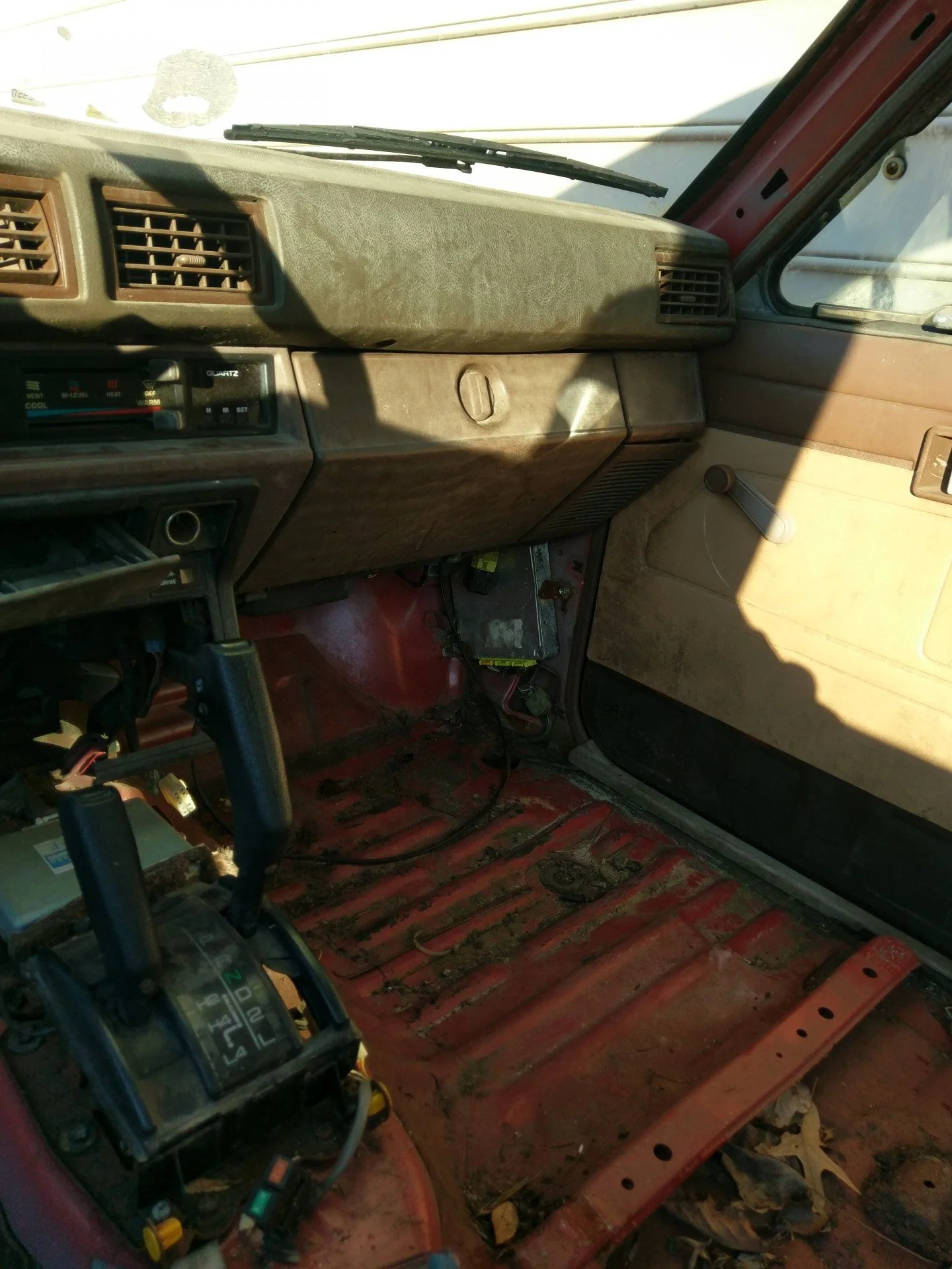

Now onto the interior... I WAS ROUGH!
Rusted out floor on both sides

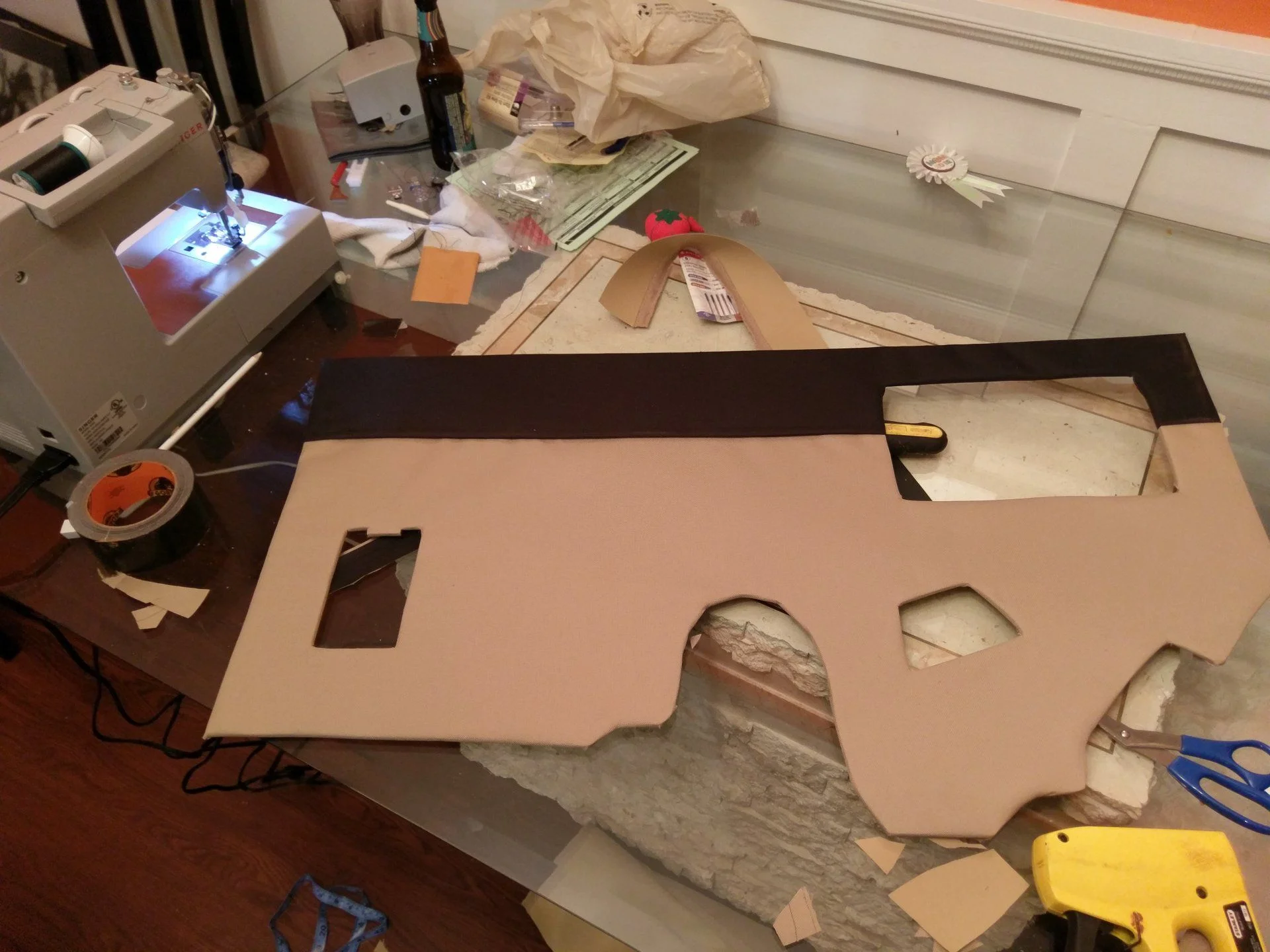

I have a little experience with upholstery and what better chance to give it a shot on a cheap truck. So I rewrapped the panels with grill cover waterproof canvas material

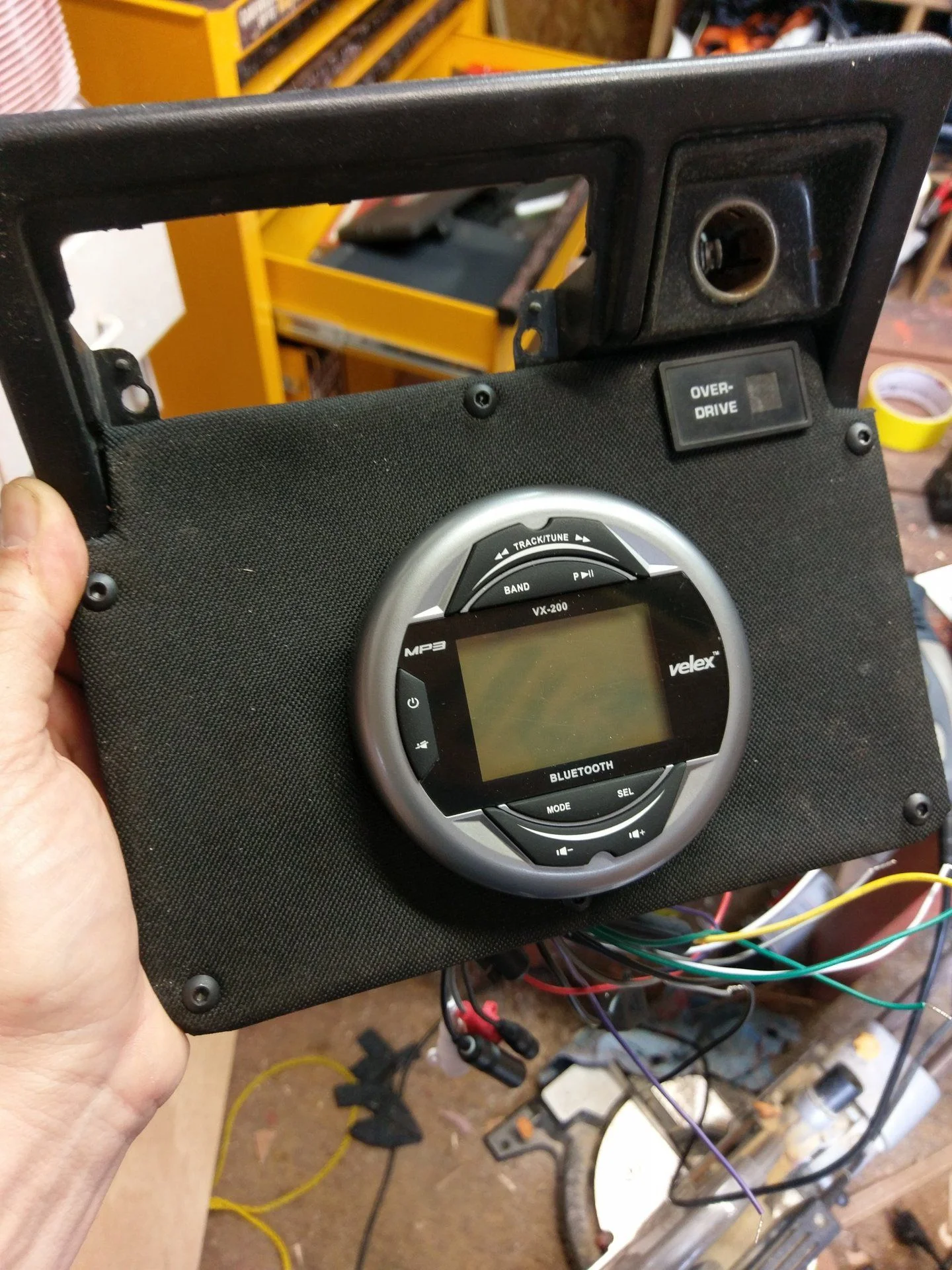

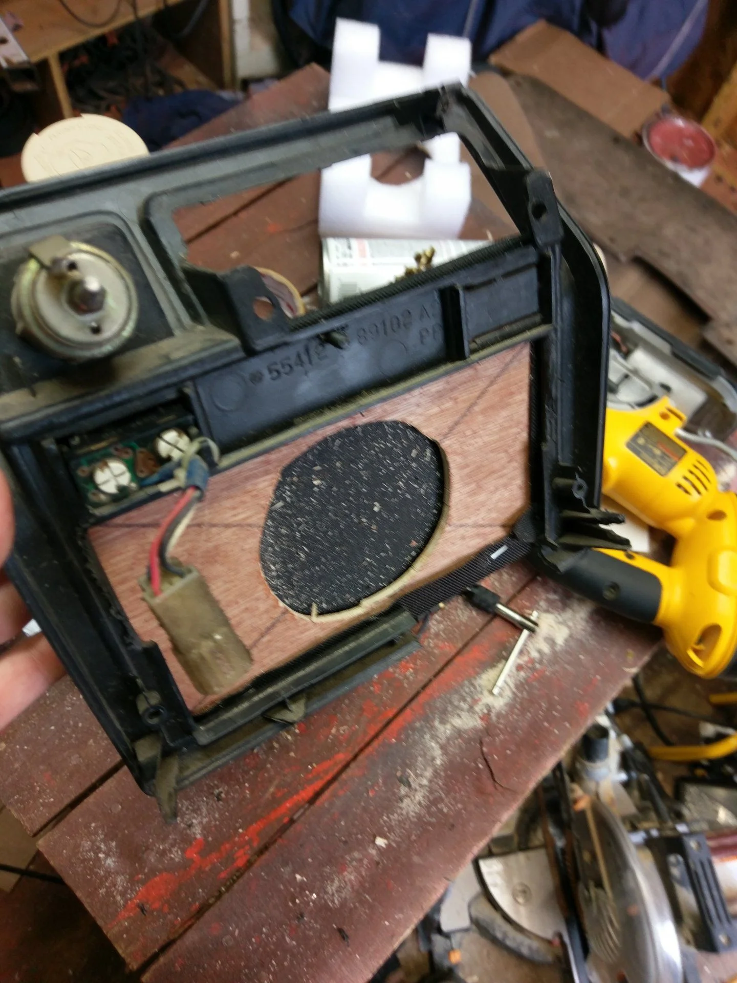

And I bought a gauge cutout form factor marine radio and made this panel for it

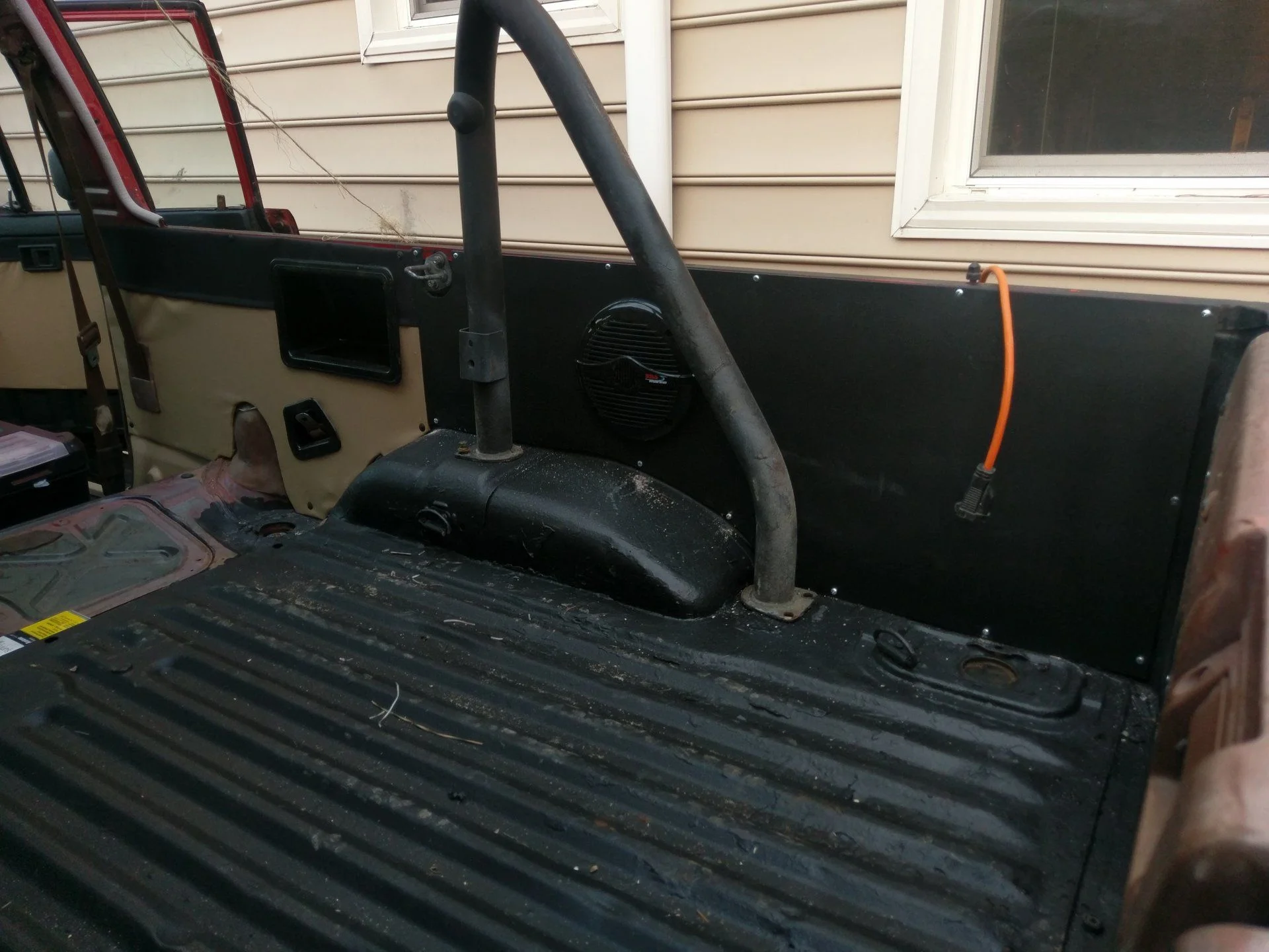

Built rear panels out of thin ply wood and bed lined over the wood and put in cheap marine speakers off amazon

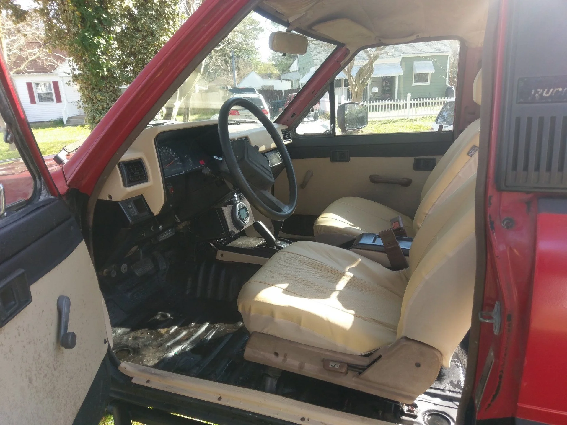

I removed the entire dash and painted it two tone, the tan is bed liner and the black is spray acrylic enamel from a can. Some cheap seat covers from amazon (not that good at upholstery) and the inside is done
