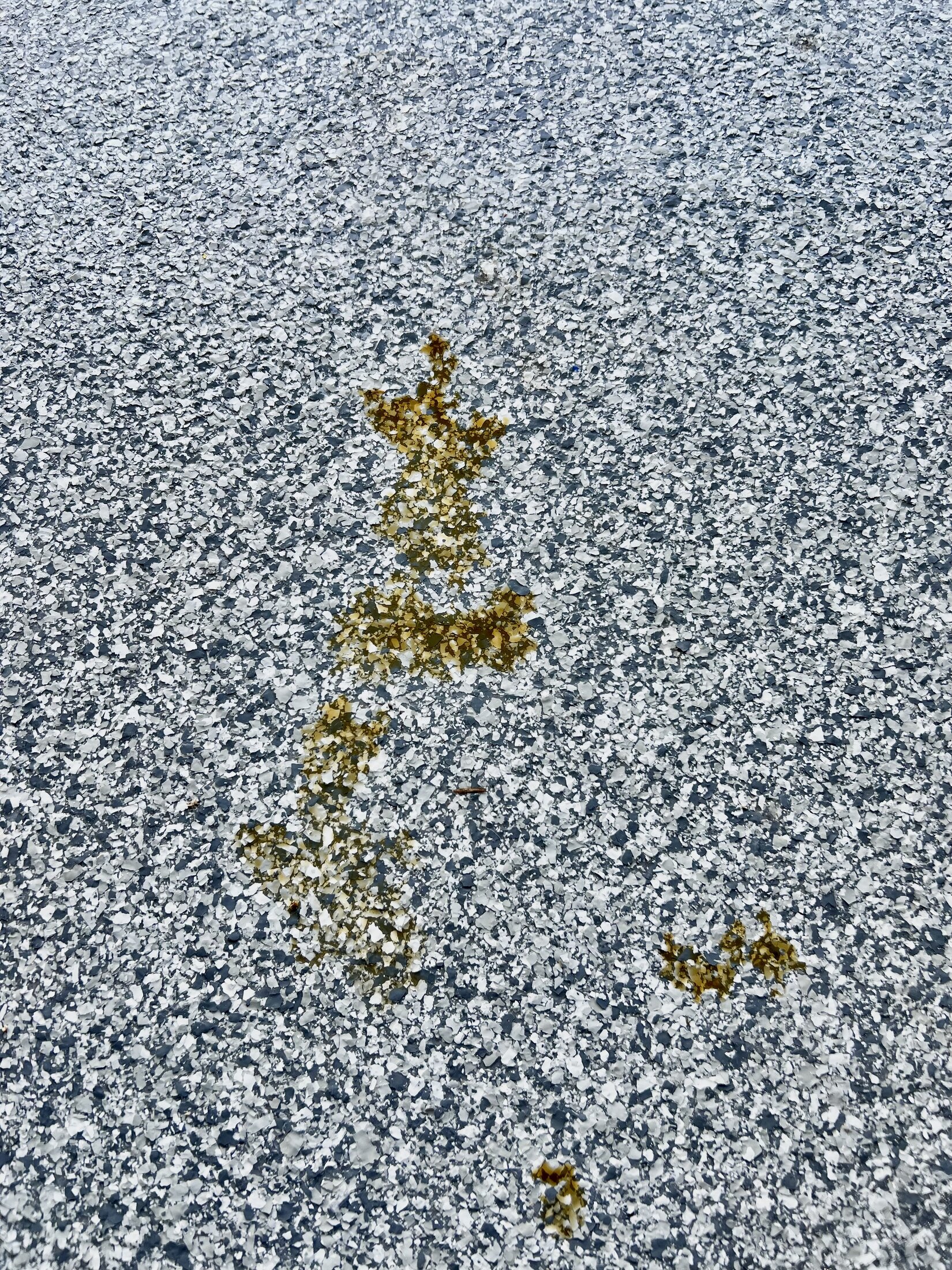

I noticed a colored liquid underneath the A/C drain when I got home from work today.
Car went in for an oil change and a brake flush on Monday. I haven’t driven it since then. First time this has happened since I brought the car home a few weeks ago.
Is this coolant? It was yellowish in appearance - wiped up very easily and did not leave a stain on the epoxy.

Coolant is pink.
Coolant is pink.
I know less than nothing about cars man (trying to learn as I go).
Google was telling me that green or yellow = coolant.
Any idea what it could be? Doesn’t seem like oil.

What did it smell like? Sorry I didn’t mean to be short. I’d be sus of it being a sloppy oil change given what they serviced and the picture you shared. What region was it from? Can you crawl under and inspect the skids?
0 need to apologize. I really appreciate the help and am trying to level set a bit so you know my competency level.
Was under the front of the vehicle. Definitely looked like the area where the A/C condensate drips out.
Skids look oily/slick around those holes for sure. Hard to see but here’s a picture.
Edit: did not get a chance to smell it. Cleaned it up before I realized that would have been a good idea.
