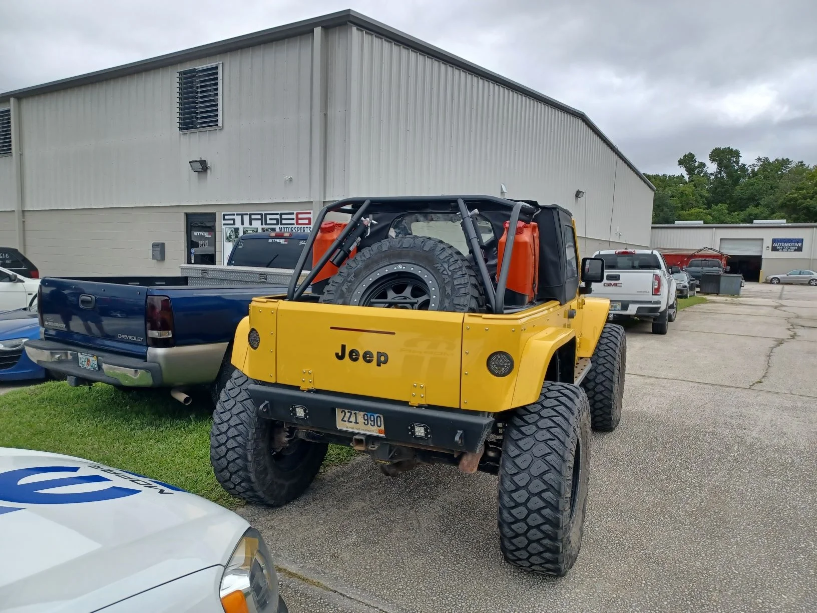

As a matter of fact ... I was. :smokin:

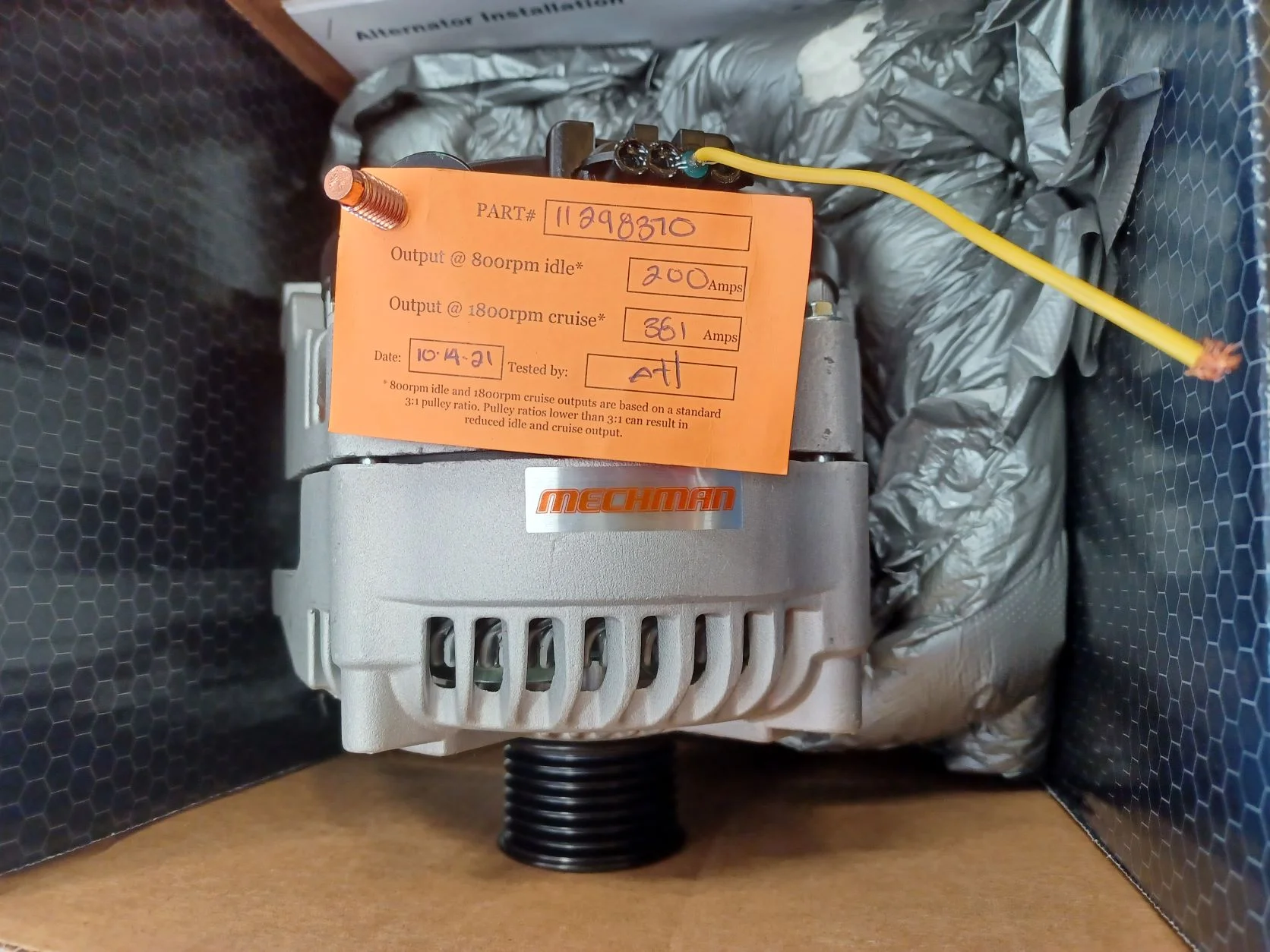

So we decided to go even further down the hole by orderin' a custom-made alternator and convertin' 'er over to a throttle cable. (Was actu'lly thrilled to hear we could go with a throttle cable so could get some finesse back in my drivin' style.)
Alternator took months to get. Fact'ry housin' but puts out 200 amps at idle and 360 at 1,800 rpm. Built in 1-wire GM regulator that is friendly with the new ECM. Mucho badass unit.

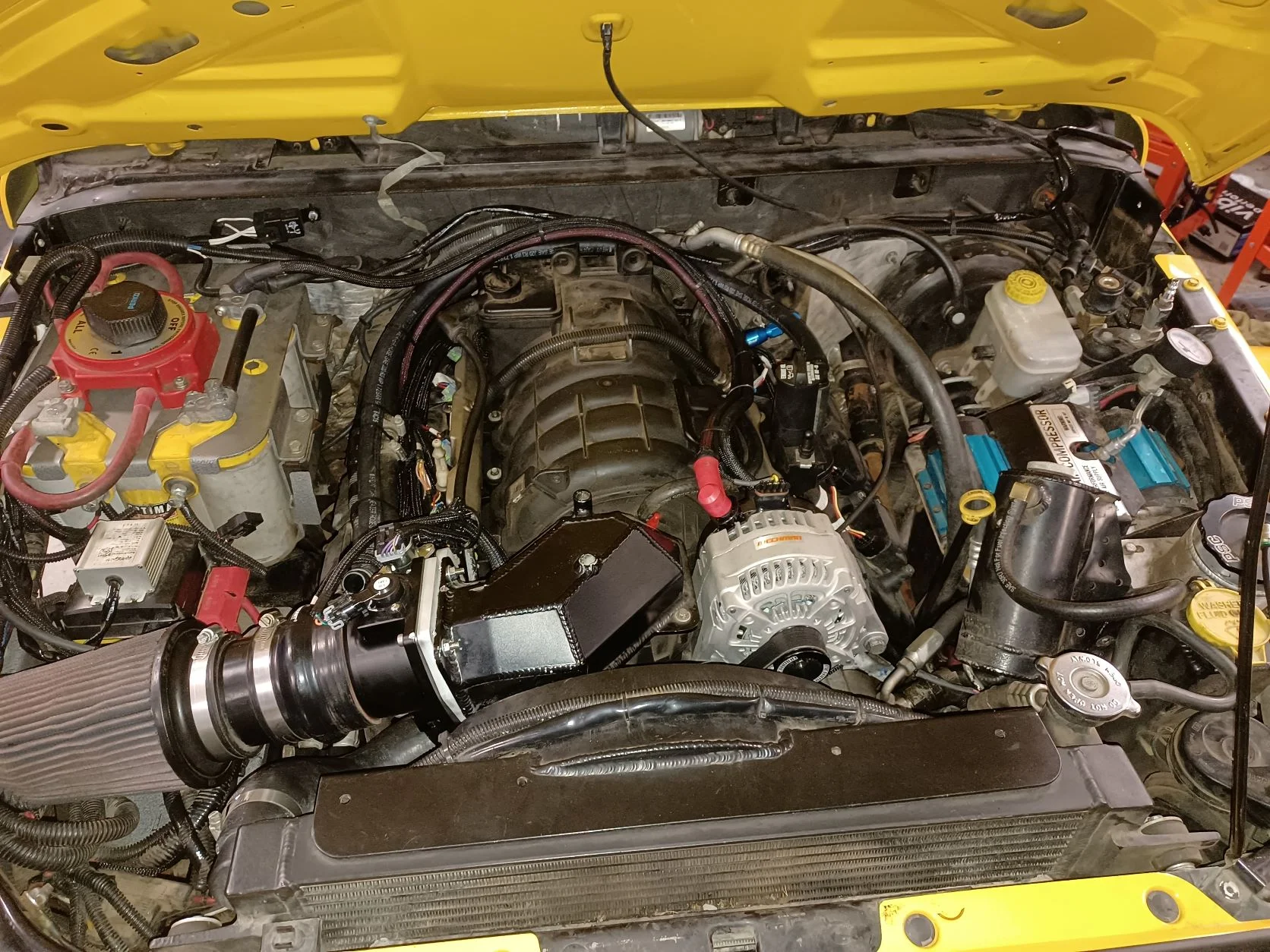

Had to do alot of modificatin' to make 'er fit under the hood. Cable actu'ly comes in on the bottom of the unit. Which made them have to modify the intake on the radiator. And now we needed a new gas pedal. s*** was just snow-ballin' down hill.

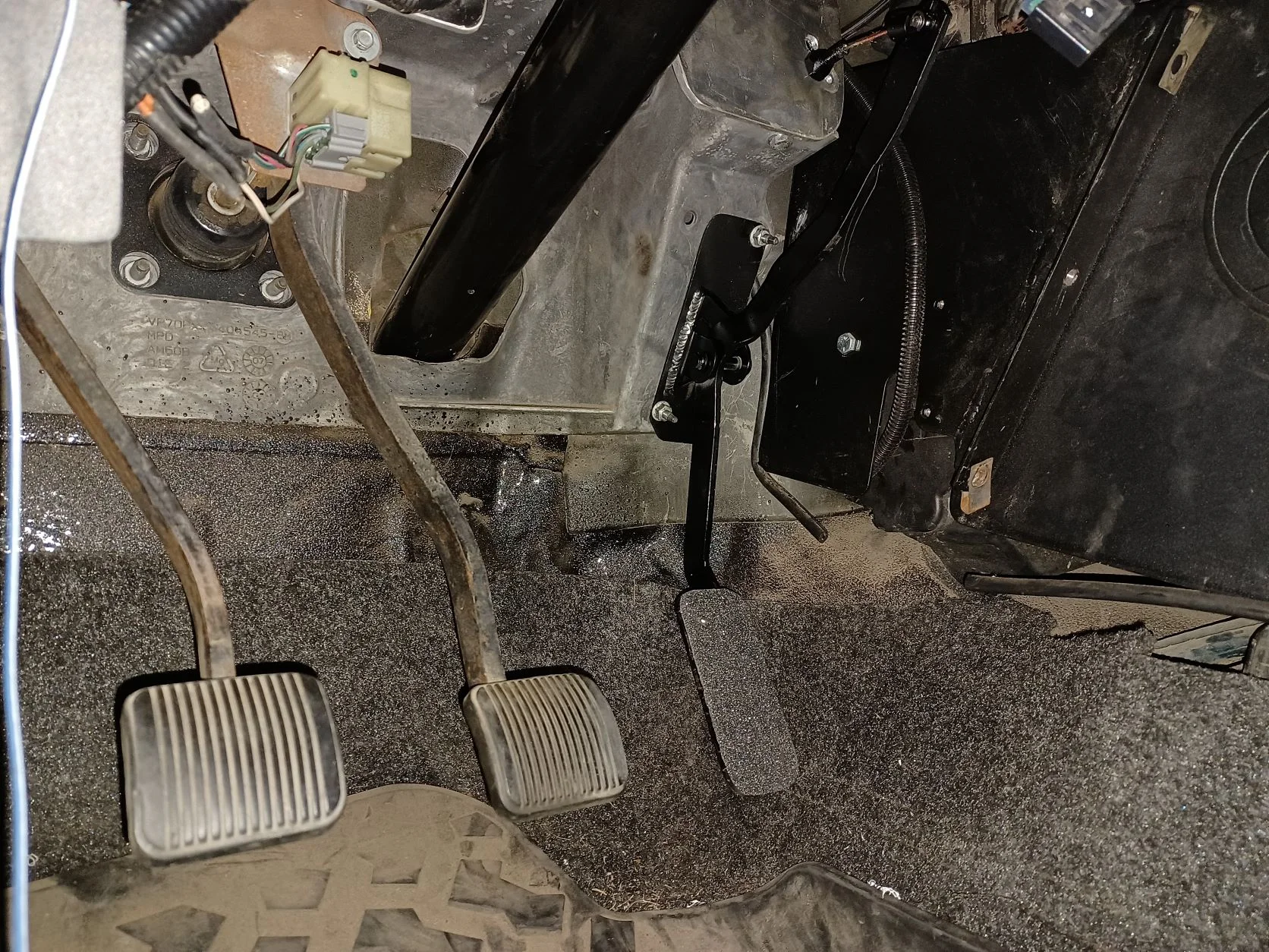

The gas pedal proved to be alot more of an issue than anybody wanted. After multiple failures, finally got the firewall modified and a pedal modifed out of a friggin' Chevy van. All good.

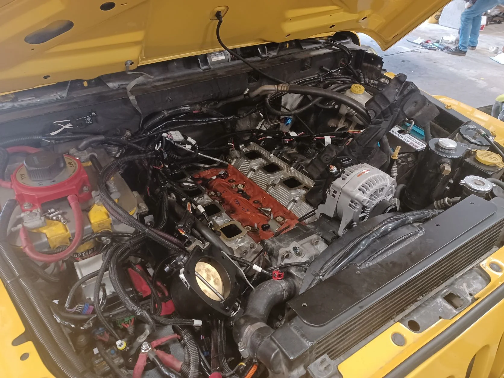

While they was at it, they did a phenomenal job of re-routin' wires, hoses, cables, and s*** under the hood. Really cleaned up nice.

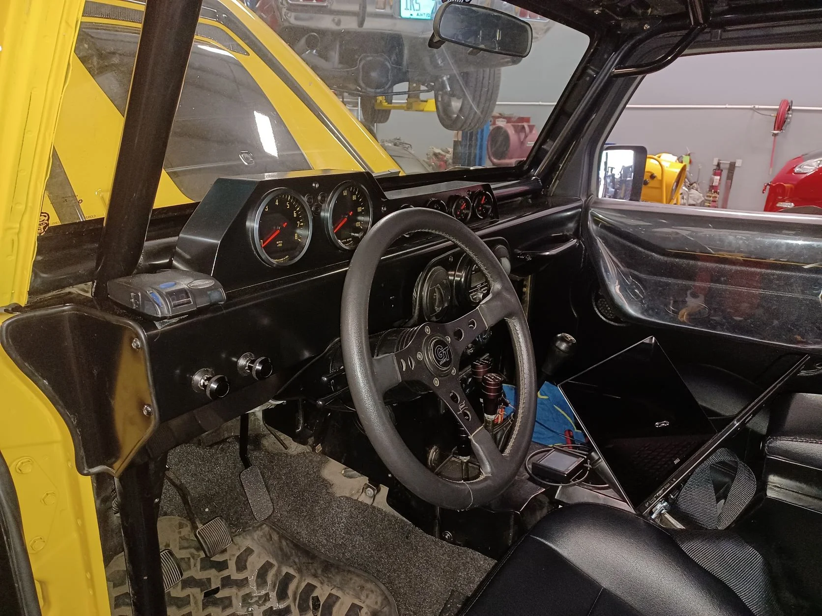

And the mother-****er actu'ly runs! Got the dash put back together and they started doin' the inital tunin' with the laptop plugged in ... (this was last Thursday)

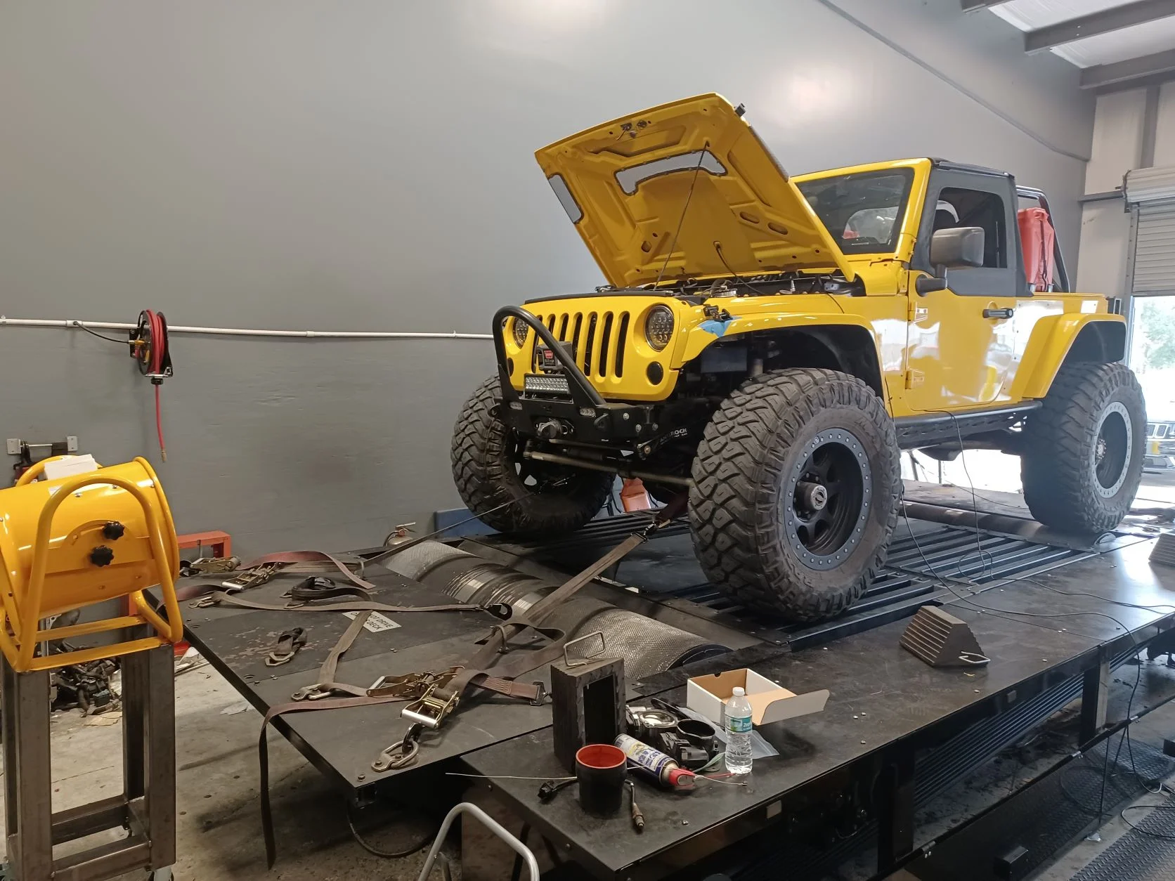

Hopefully she goes on the dyno Monday and I'm seriously hopin' to get 'er back for Christmas.

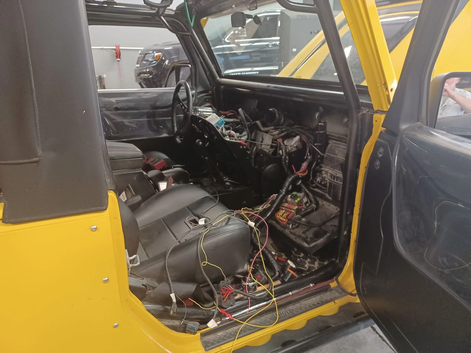

AC works great. Rewired lightbar so all wiring is internal. Dash all put back together. Ev'rythang works.

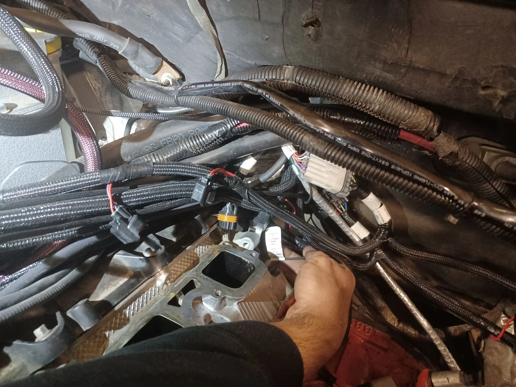

They found the Smokin' Gun. :smokin:
What your lookin' at is the ground wire for the coil packs on the back of the passenger side of the engine.
And it had a bad connection.
Simple as that.
Fellas in the shop claim it's the reason for ev'ry sorry-ass problem they've had since they been tryin' to tune 'er after the install.
Puttin' 'er back together this week and hopefully the long awaited visit by the Tuner Guru next week.
