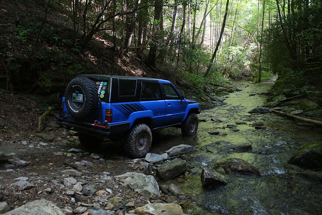

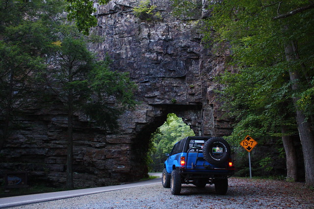

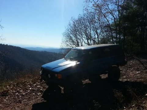

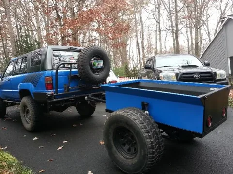

These pics were from NC, TN, and I'll add some VA in this post too. I spent just under $1000 in fuel, and averaged right at 19+ for the entire trip. I had planned on building a roof rack, but it has been placed on hold, and instead, I've started a trailer build. I think it will work out good for me.
Here are a couple pics from a wheeling and camping trip in VA last weekend.

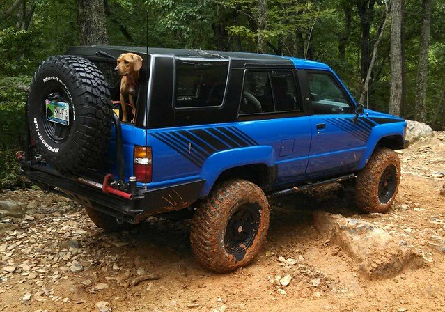

They are BFG KM2s. I've been very pleased with them.
I've had them in 265/75r16, 33.10.5r15 and nite 255/85r16. All have done great.
