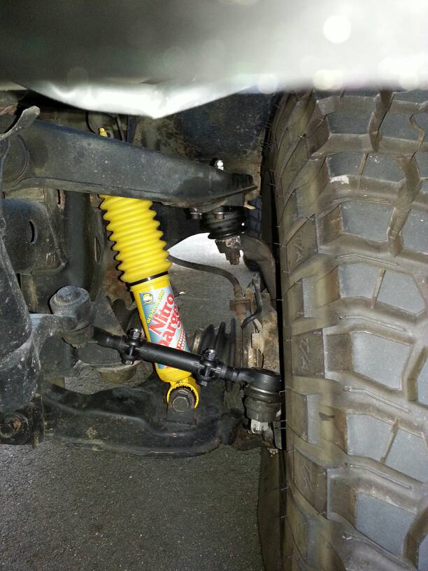

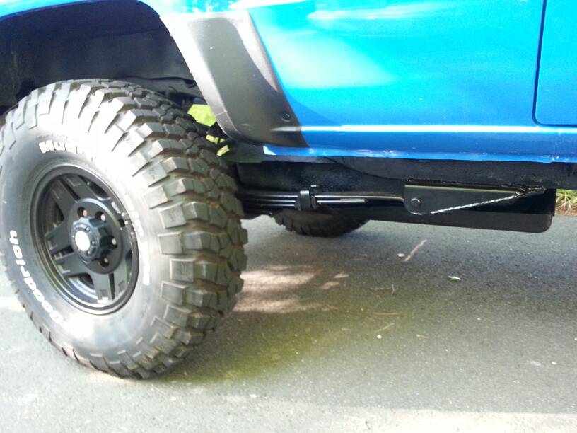

Added:
1" body lift1.5" ball joint spacers, then backed off torsion bars
OME Front shocks, and steering stabilizer
New OEM upper and lower ball joints, and tie rods
Chevy 63"s
Bilstein 5125s 12" travel (33-185569 part#)

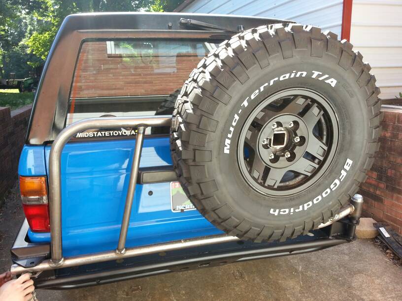

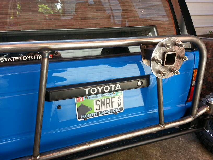

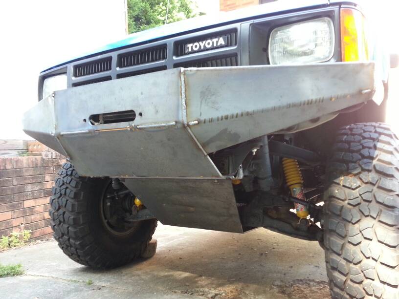

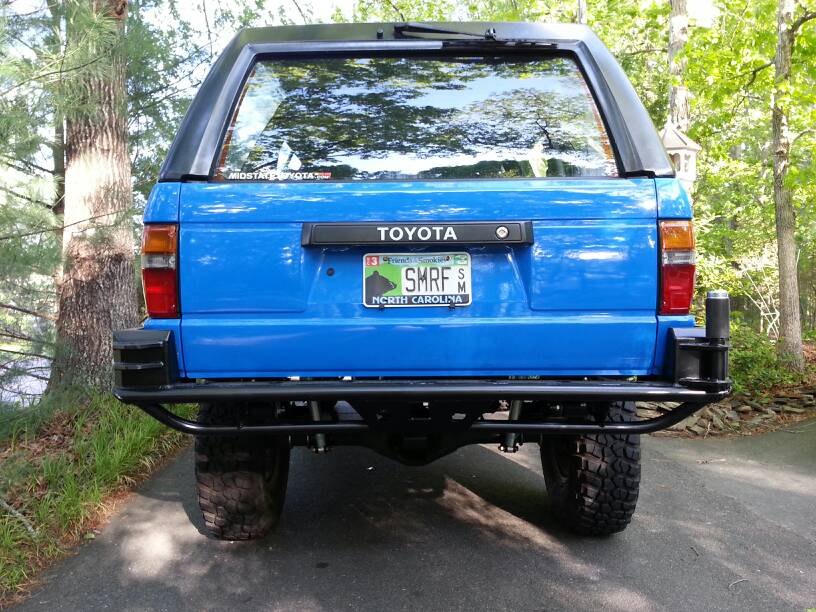

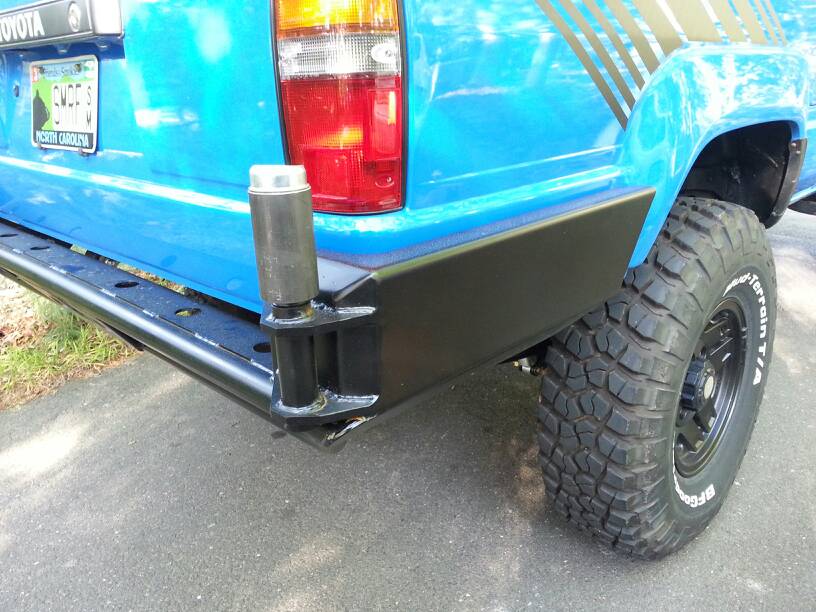

Rear bumper
Sent from my SPH-L710 2
Holy crap, dude... nice work. Sweet bumper!

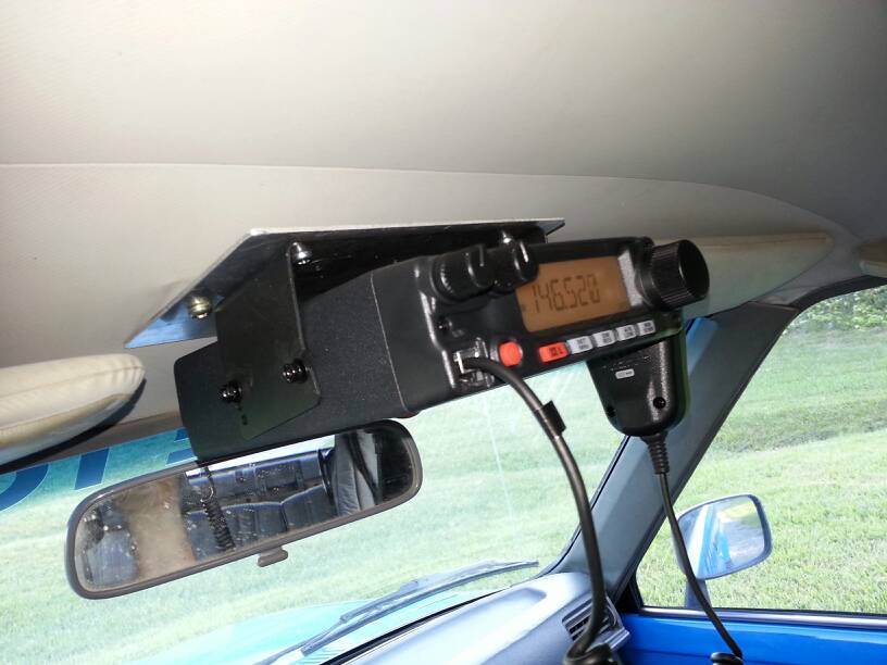

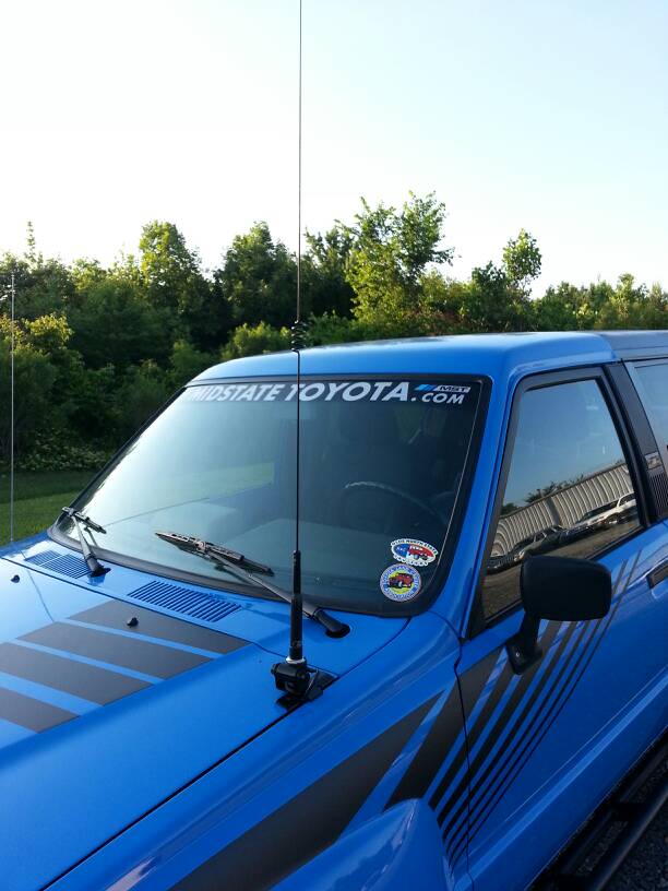

But, with all due respect, I highly recommend you find another location for that radio. I had a CB in that same spot in my last truck, and more than once I cracked my noggin on that thing, once I drew blood. It looks cool, but you're gonna hate it.

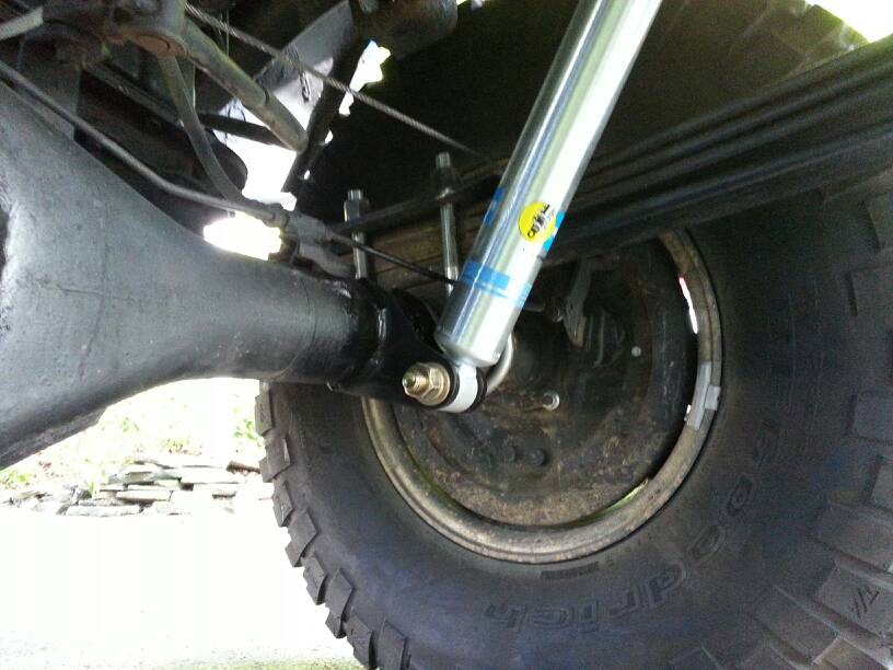

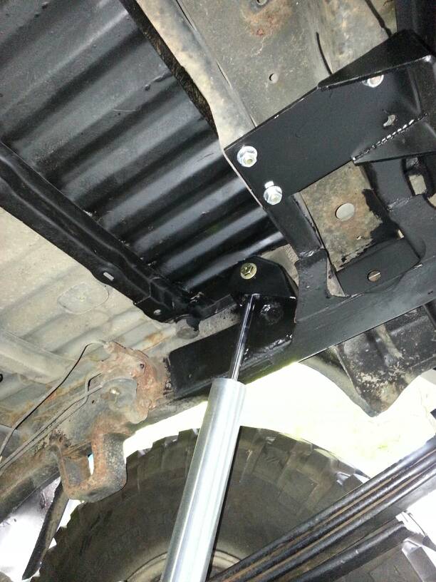

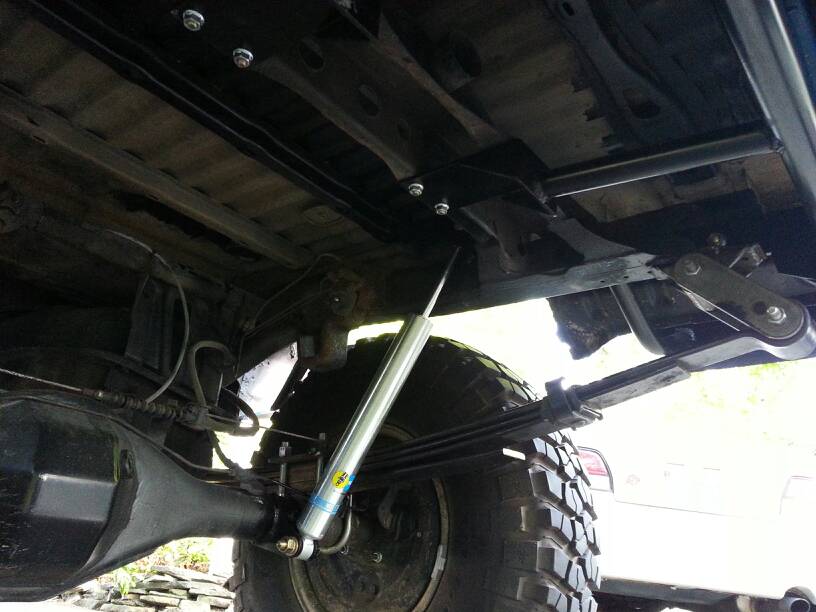

for those rear bilsteins did you move the mounts or anything? i thought those were for 3-4" lifts?

Upper and lower mounts are fab'd. The chevy springs added about 2" and the 1" body lift gave a tad more room up top, combined with the new lower mounts worked out well.

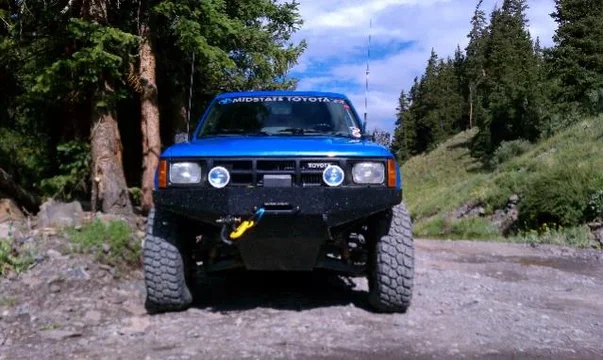

Made it to Ouray, Colorado then wheeled for a week and drove out back. Had a couple snags on the way out. Had to stop and put a fan clutch in while going through jackson tn, and a transmission clutch while in albuquerque nm.
2k miles there, 2k miles back and made new friends, and many memories. Mission Success.
They were not a bolt in operation. They fit good, but required fabriaction of new brackets for the rear, and little cutting on the fronts where they bolt to the floor.
