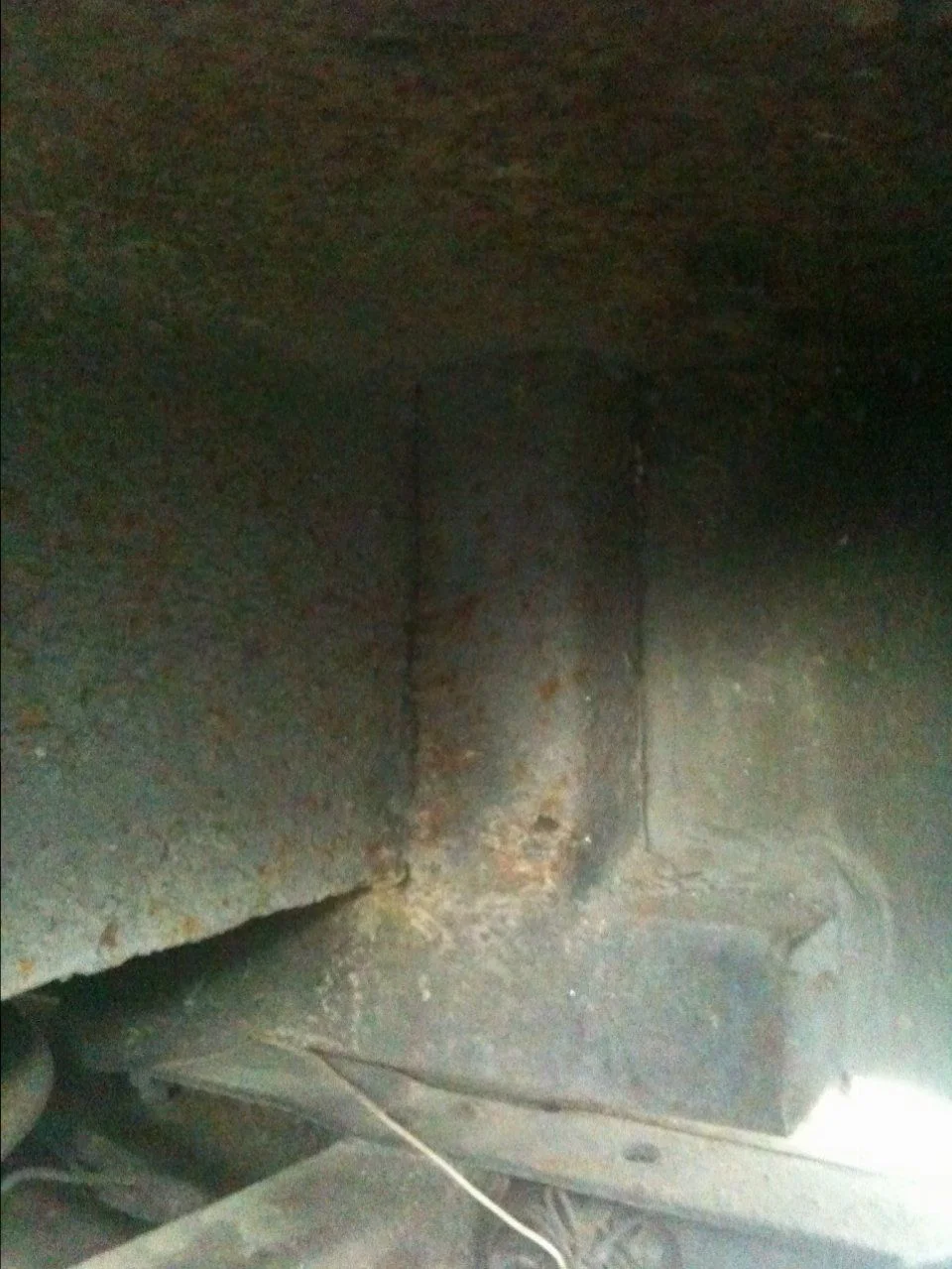

I agree that this corner looks bad, but here are some other areas previously shown in this thread…

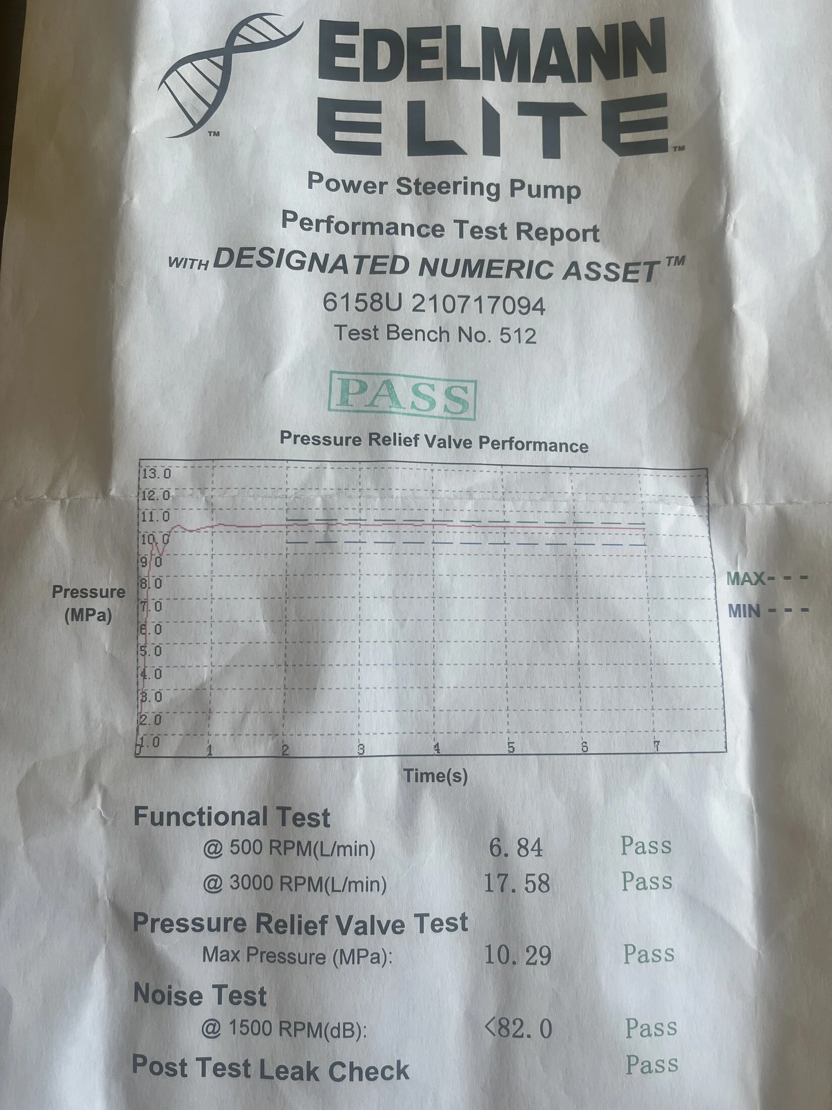

This is what I thought was cool about the new pump…
This pump came with a printout showing the test results for the new pump… and it was only about $10 more than I rebuilt pump.
The pressure relief valve tests at about 1297 PSI, which seems to be exactly where I want it. After installing it, it works perfectly. Not much noise and it turns my 33x10.50 A/T tires easily with one finger while stationary on dry pavement. I could increase the pressure and flow, but it’s more than enough for most people’s standards which makes it exactly what my angry nervous system needs. Also, if Edelman found that I modified the pump they sold me, they likely wouldn’t honour the lifetime warranty on the pump.
