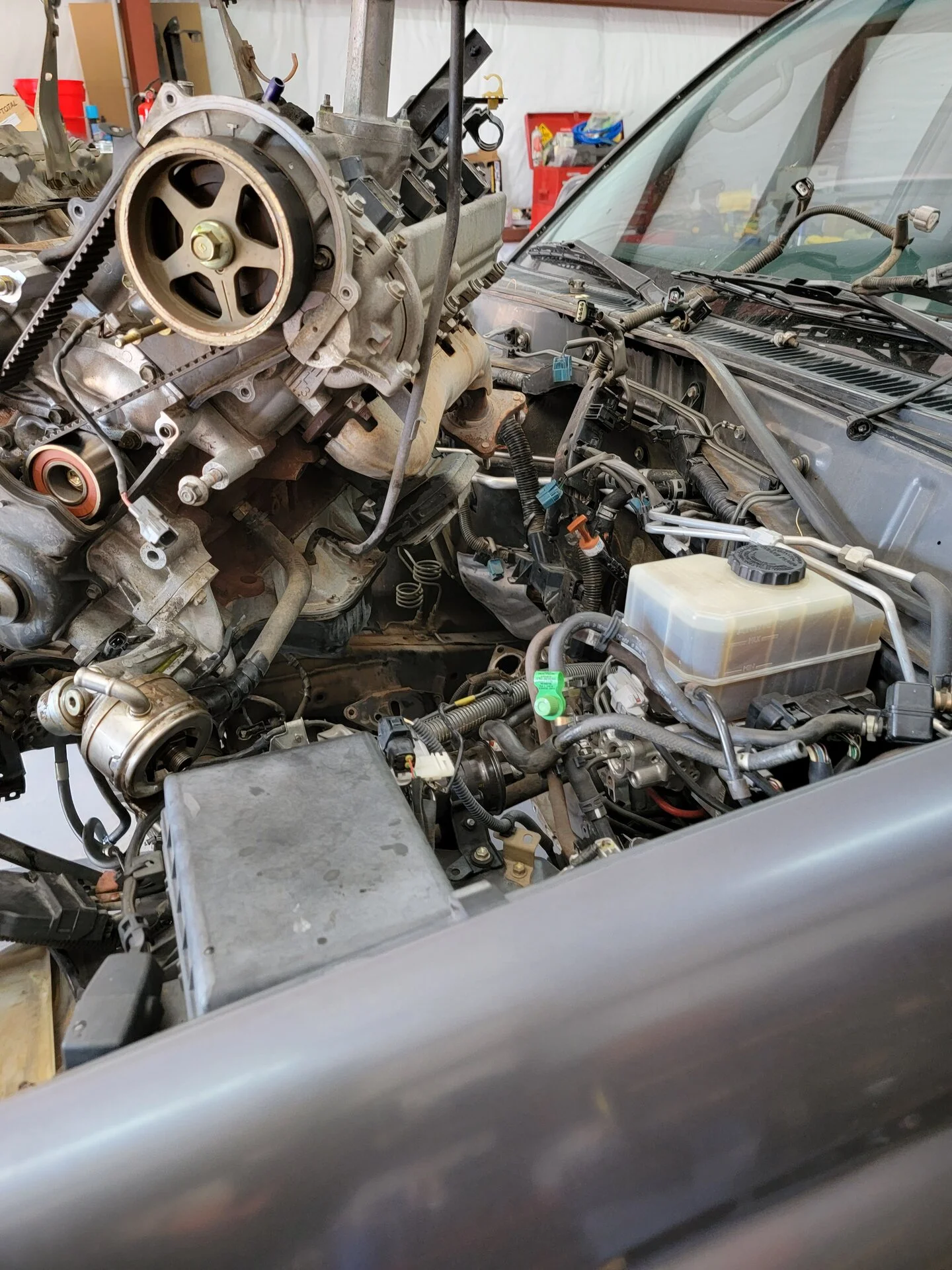

Took a full day to pull old engine out, no surprises. Just took engine out without transmission. Was pretty simple, nothing out of the ordinary. From what I had researched on the internet, the oil pan and exhaust manifolds are the only thing different from the LC100 and Sequoia/Tundra. I can confirm that is true. Other than that, everything else appears to be the same.
Took a full day to put in new donor engine and no surprises encountered. Put in a new starter from a local parts store. I got the starter in and buttoned up the loose ends in the morning of day three before I was ready to fire it. All in took me 18 hours of methodical careful work. Also before all this, I did put in a new timing belt. The timing belt on old engine, and bearings where replaced by previous owner only 23k miles before. I used the bearings from the old engine as they were still very smooth and in good shape. They were the good Japanese bearings, the kit put in appears to have been an Aisin kit. A new timing belt from Gates was only $20 so I put that in.
Hit the ignition switch and it fired up almost immediately! Success! I have driven 700 miles and the engine is smooth and very quite, like a sewing machine. I did it's first oil change at 50 miles, working out of a garage, it is hard to keep things clean so wanted to flush out any junk with a very short oil change interval.

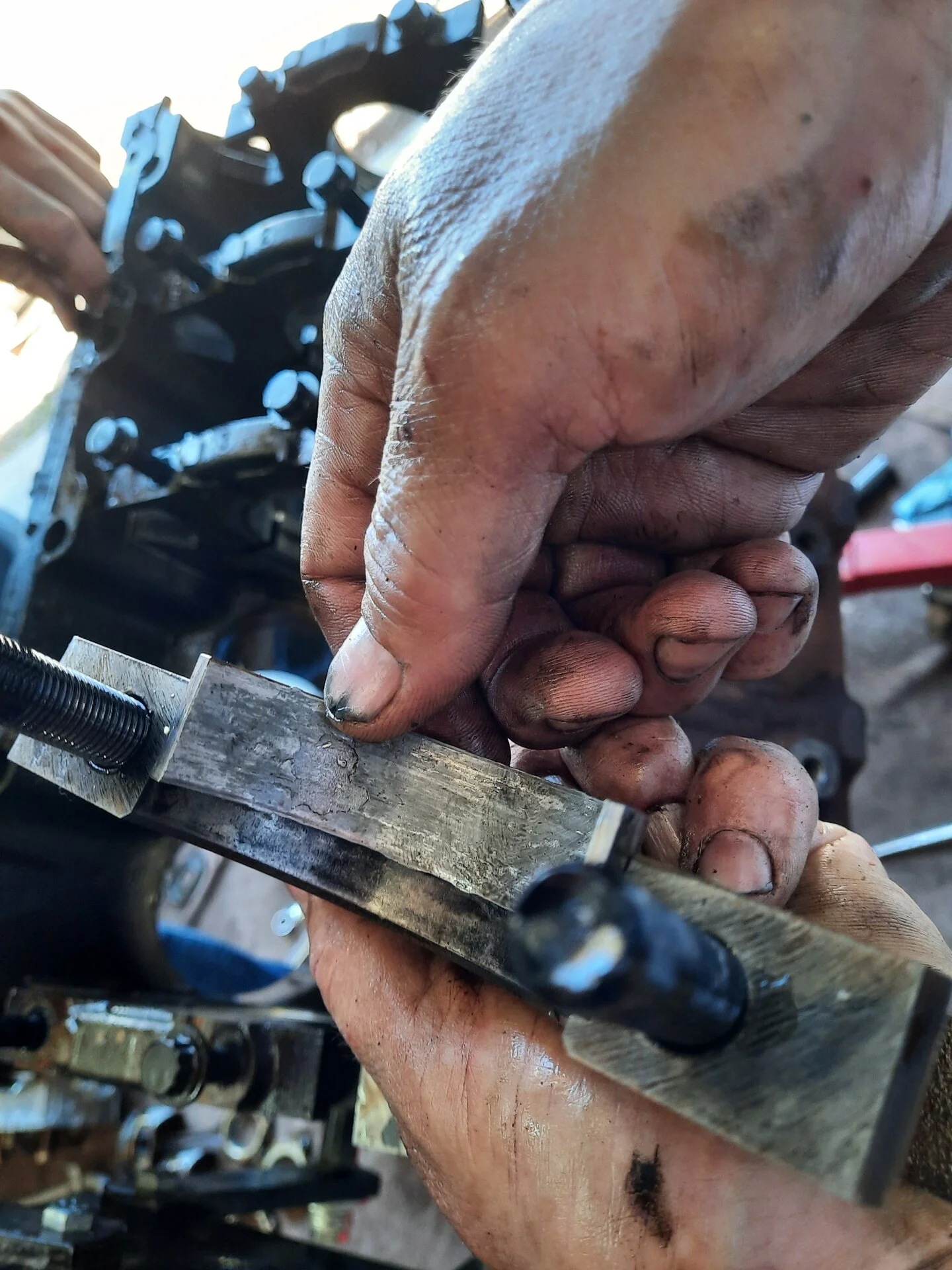

Since replacing the engine a week ago now, I took apart the old engine to see what went wrong. One of the main bearings ended up getting pretty hammered, looks like the engine got oil starved in the past and all the bottom end bearings were noticeable scarred. None of the bearings actually spun, but they were ugly looking for sure.
The number 4 main bearing was the worst on old engine...

This image would be an excellent ad campaign for "Dirty Hands Clean money".
