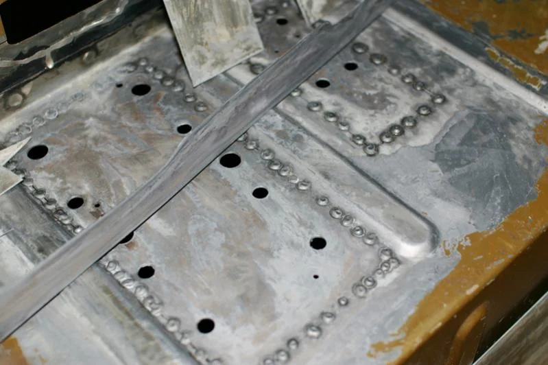

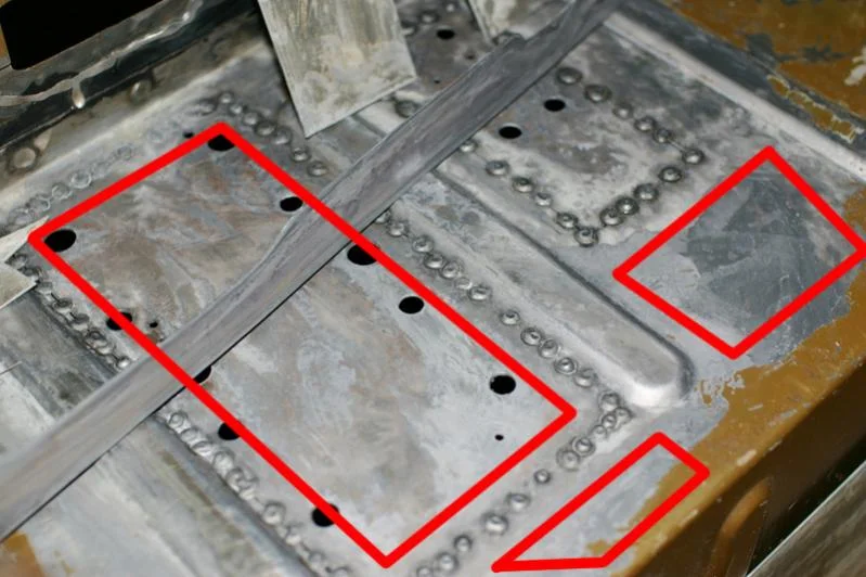

Nothing as massive as a 2x4 - kind of depends on the cut. I've been repairing my wheel well support brackets and those were some of my first cuts. See the attached photo of tacked patches, in the red outline areas I used double-back tape to attach small 1/8" plywood panels. The jig saw rested on the wood and the metal ribs on wheel cover and held the saw level at a good 90 degrees as the cuts were made. The weight of the saw (and the tape) helped to hold the plywood in place and it really kept the 18ga from vibrating too much. I'm also clamping 1/8" plywood backing on the quarters with the tape and deep vise grip clamps, etc.
