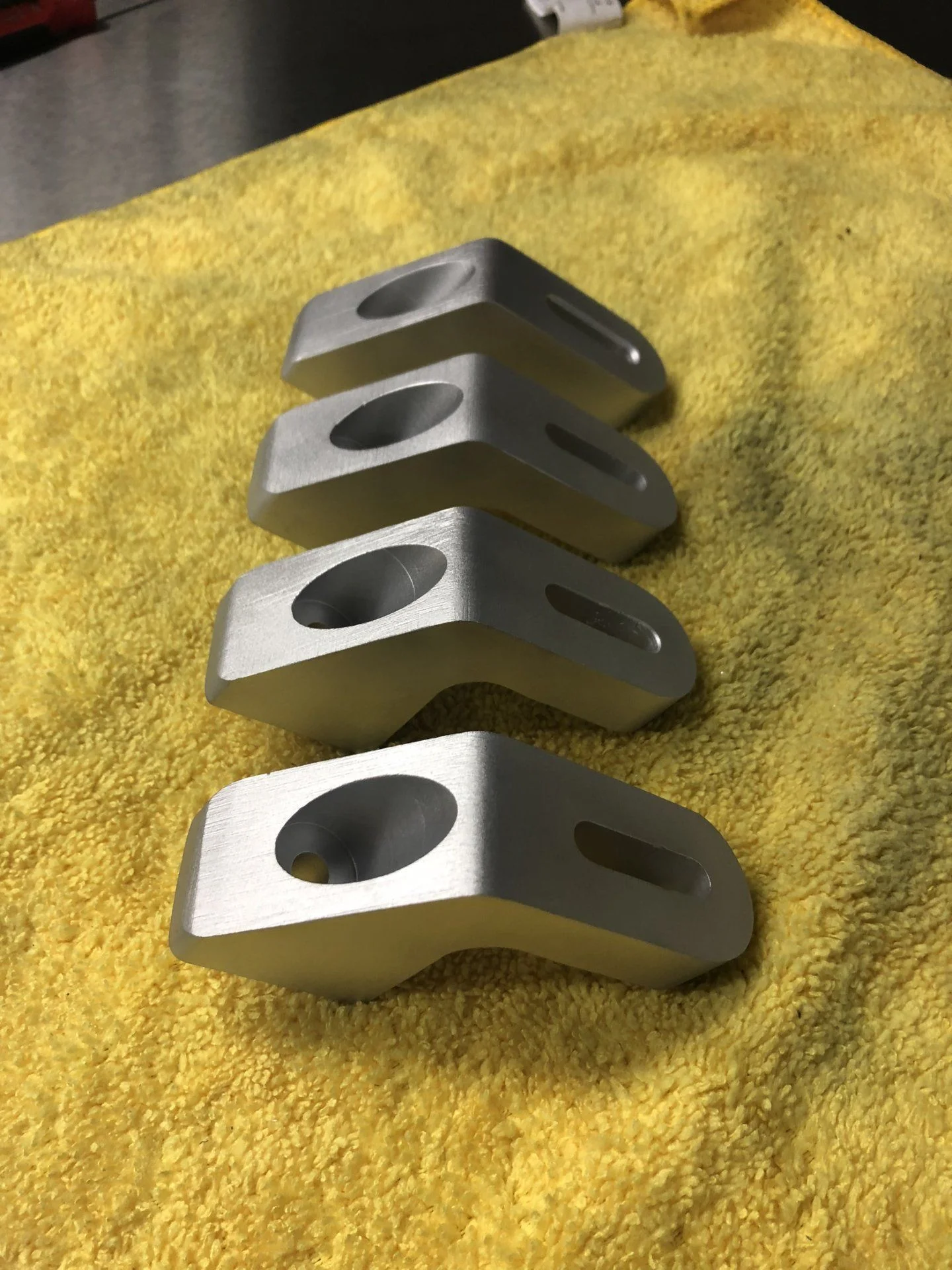

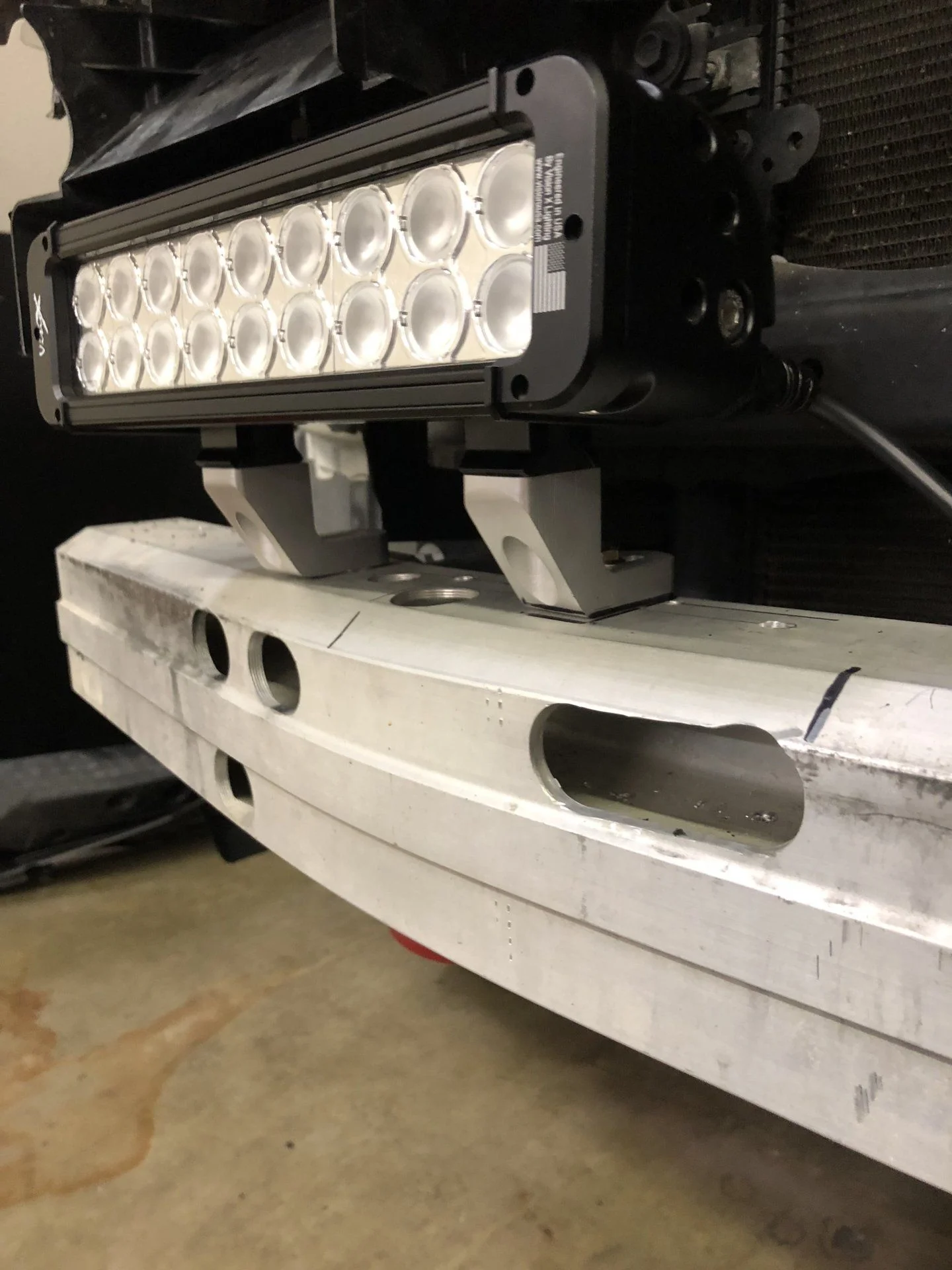

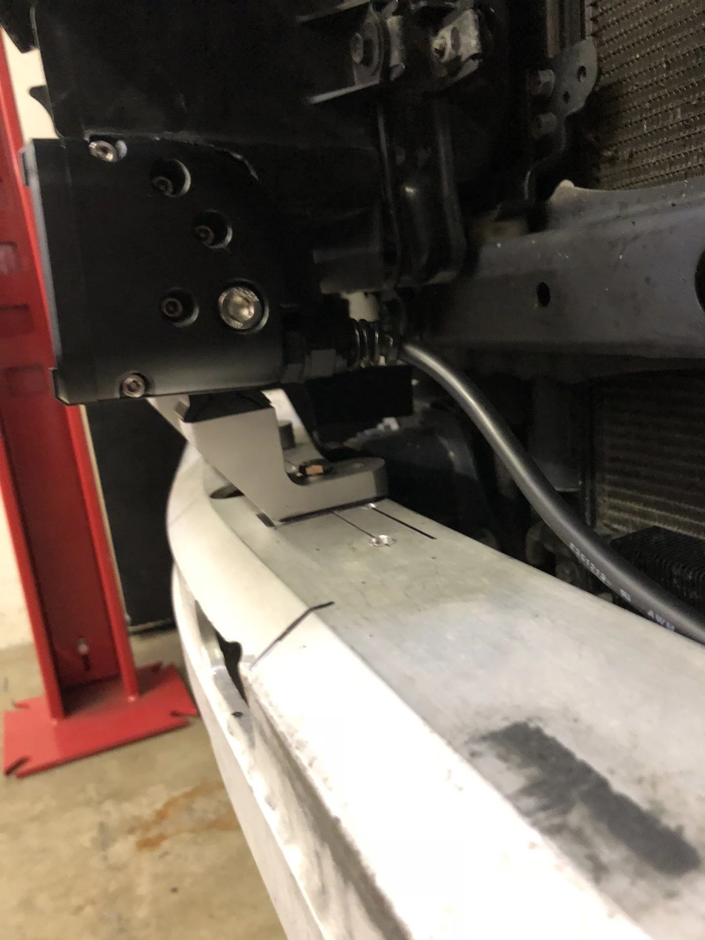

Aluminum stock, found at any hardware is pretty easy to work with to make a custom mount. Basic hand tools or wood tools is all that's needed. Along with some basic taps. Over the years, I've mounted various things on various cars to the crash bar including intercoolers and most recently an OBA compressor.
Don't mount to the foam as it's not structurally sound, even if it might be thick enough right there. There would be some significant vibration as it's just form fitted. Cut the foam where you want to bolt down brackets.
The crash bar is pretty thick right where you'd mount a bracket to on top. Easy enough to drill, with enough meat to tap for machine screws to mount security.
1" or 1.5" aluminum angle stock would be perfect here too. Easy to cut with a hacksaw or fine tooth jigsaw. Then drill through and use machine screws with nylon lock washers to mount.
That's more or less what I had in mind. Al angle should be just fine for what I need. Vertical side to mount to the lightbar, horizontal side to mount to the crash bar.
