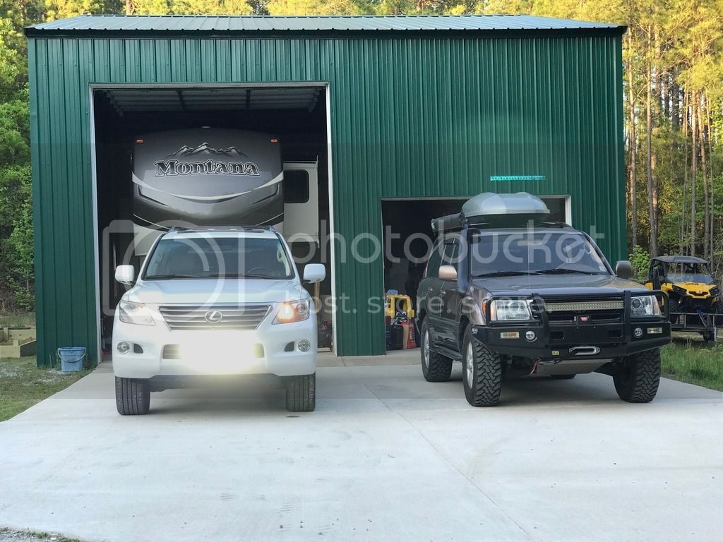

Got a chance to try out the Rigid light bar last night and it seems to throw pretty good for it's size and position. Sure makes those halogens look dingy though. :cautious:
(Angle the pic was taken from makes the DRL's look out of balance but they are fine in real life other than just being ugly.)
The 30" bar on my 100 probably out works this 20" BUT that is 33% more LED's and a higher point the light is being emitted from with zero obstruction so it has a pretty good advantage. All in all the 20" looks to be a good performer. Checked in at a little over 8amps of pull.

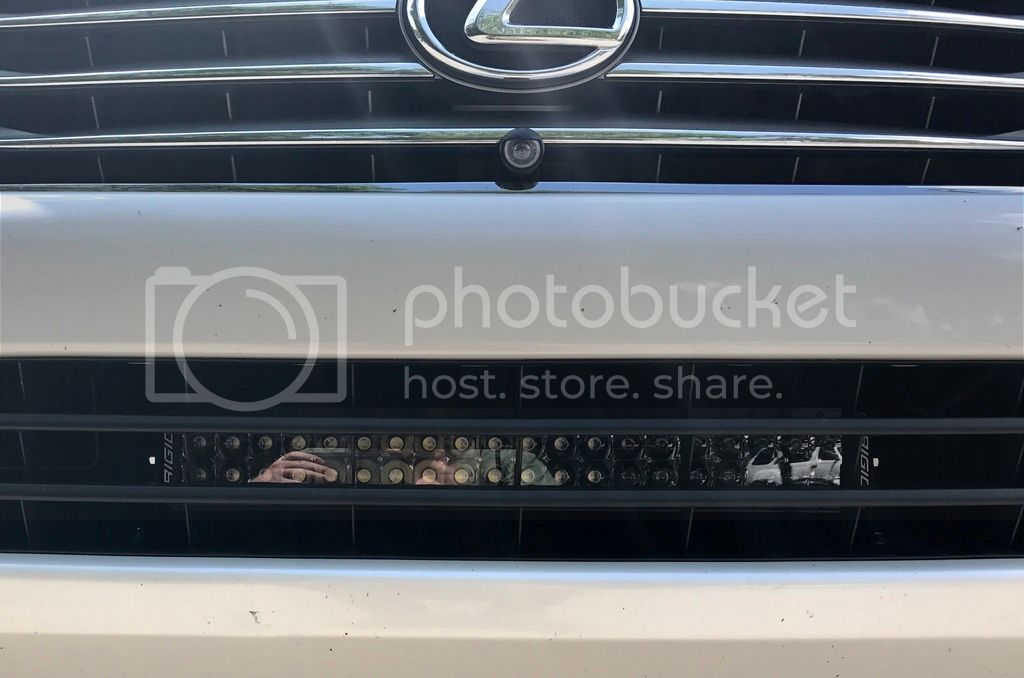

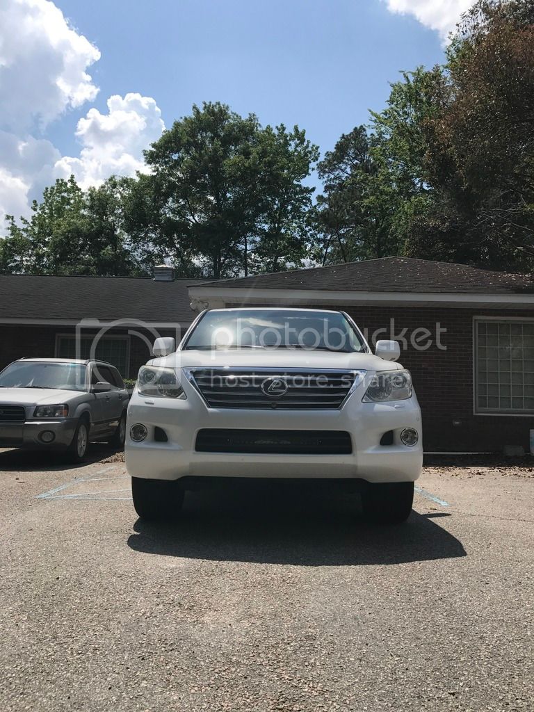

Would you have a pic of the LED bar off from the same distance? It looked pretty inconspicuous from the previous pics, but just wondering what it would look like form a distance in daylight.
OK went out and took a couple more pics.
The main thing that shows are reflections off of the lexan/whatever lens material as it is still glossy. If it had a matte film on it then it would really blend in even more. As it stands now though it is still pretty low key.
This is about as evident as it gets. Point blank, kneeling down in front of the grill range:
(as you can tell again it's the reflections off the lens that are the main tell tale)
That's incredibly subtle, which makes it great match for the LX! Thanks for grabbing those pics.

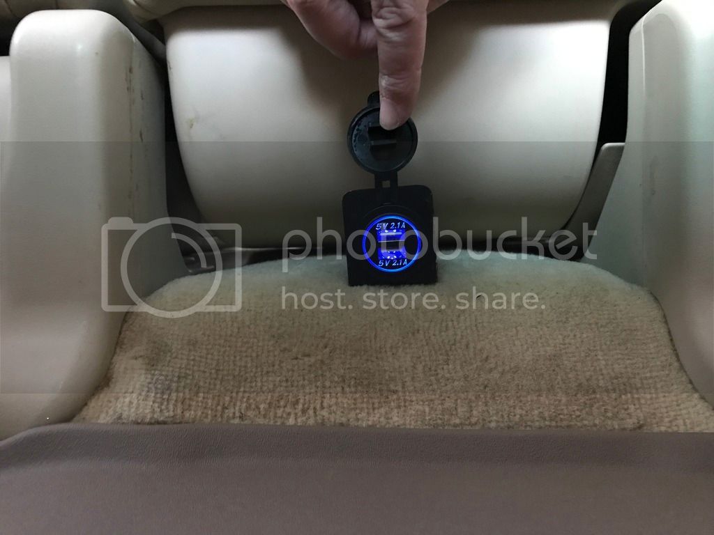

Second row USB outlets. The plan was to mount the outlet below the rear AC controls but there is a steel box right there so we scrapped that. This ended up probably being a better solution. It's tucked under the middle seat area so the lug/fragile cable connectors won't get kicked quite as easily as the AC control spot. Seat still flips forward without hitting them.

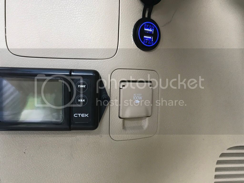

And USB for the cargo area. Decided to put the display for the CTEK back there also. I thought I'd try something different than I had in other vehicles. In the past I've always had the gauges for BMS up front. The thing I've found is that I actually need the gauge more when I'm setup and usually the cargo area is the place I'm accessing more frequently than the front area. If I'm up front 90% of the time the engine is running and of course if that's the case a voltmeter is useless. This way I have an excuse to grab a beer right? "Hey honey I'm going to check on the batteries..."

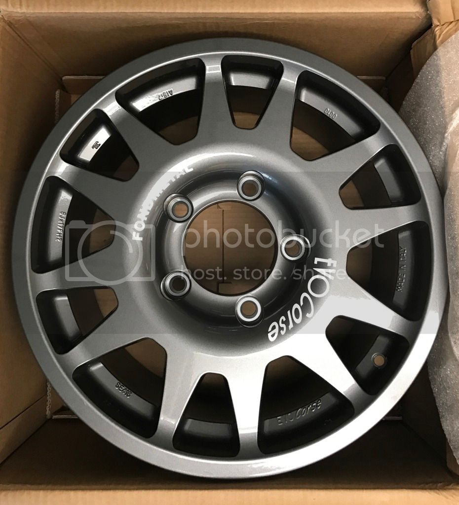

Moving on to more positive news, yesterday these showed up:
They've been MIA for quite some time and honestly if they didn't come in yesterday I'd have been pretty close to hosed b/c I was running out of time to order tires and get them mounted before we head out west. So they came in yesterday, ordered tires which will get mounted tomorrow and I'll post pics of the combo. Going with 285/70R17E Ridge Grapplers. I was down to them or the STT Pros but with me having more aggressive tires on everything else I own (Toyo M/T's, Swampers & Trail Graps) I felt it would be nice to have something milder on the LX.
The wheels are gorgeous and I can't wait to see them mounted up.
