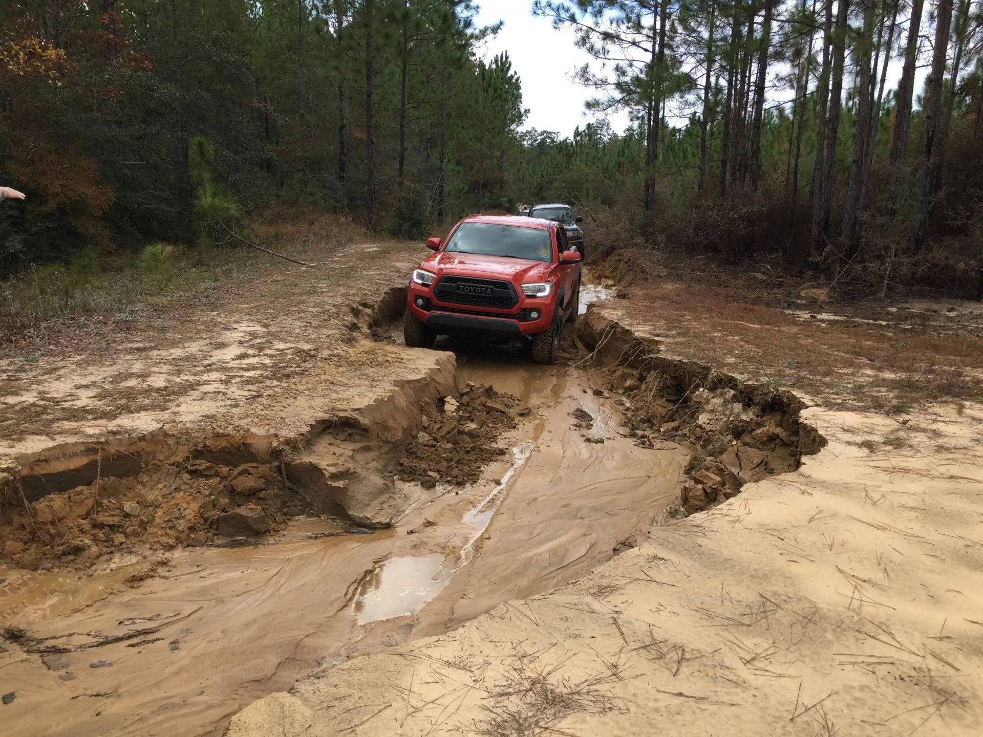

Yes it can be done, yes you can keep your flares! Stock suspension and true 35s went thru the same washout all the Tacoma's did.. daily driving was no issue at all.
