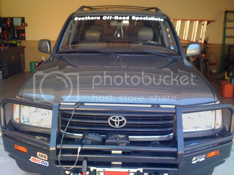

So here is what I started off with
I had my IPFs on my bumper like everybody else. I decided to change that. Here is the bumper "lightless"
Hey! There's a screwdriver in my d ring!

I think you should reverse every mount on the car and start over. I may be a bit harsh but..... you have d-ring shackles on a bumper that's not designed for pulling in those areas. Scrap the bumper and order one that has the provisions. Put the antenna on the ARB so you can see how much the brush is bending it rather than it snapping off the back. Get a new hood and don't mount lights on it, you want them on the bumper because you don't get glare off the hood, and it will actually increase your night vision. Mount the lights on the lower tabs and throw some HID's in there. And there you are off to a speedy start to some sliders and actually offroad tires. I apologize, but if you were to take that on a serious trail, you would probably have some nasty surprises.

which reminds me, I have seen many times a 100 like yours. I also see the Souhern sticker on the front.
