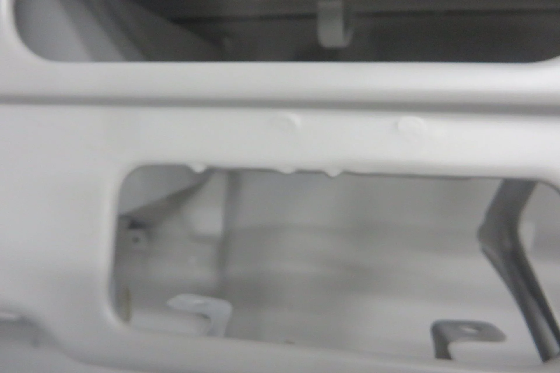

The bad. Spraying the glove box and under the dash and behind the door pillars was bugger of a job. I kept banging the spray gun into things and the hose rubbed on bits I had already painted.

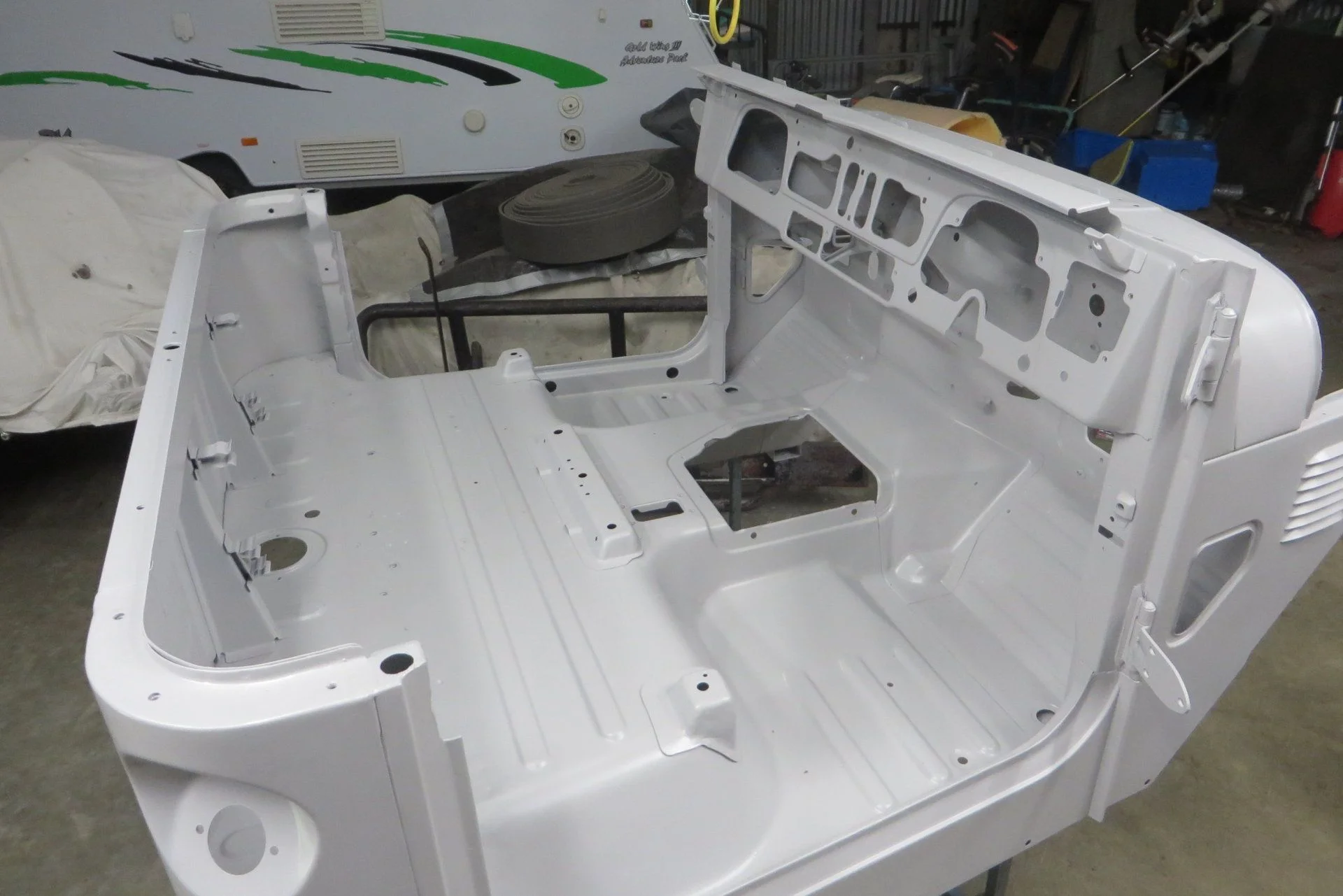

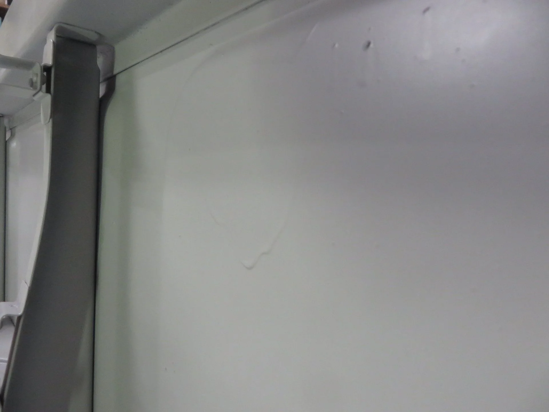

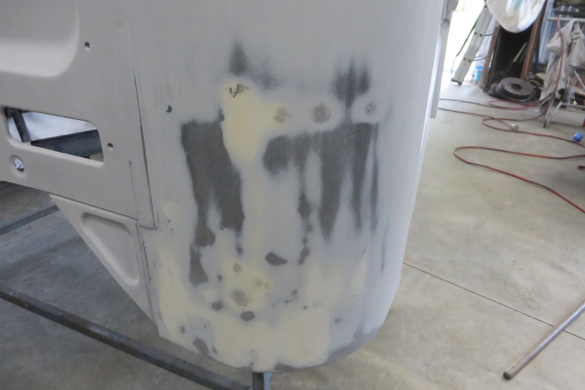

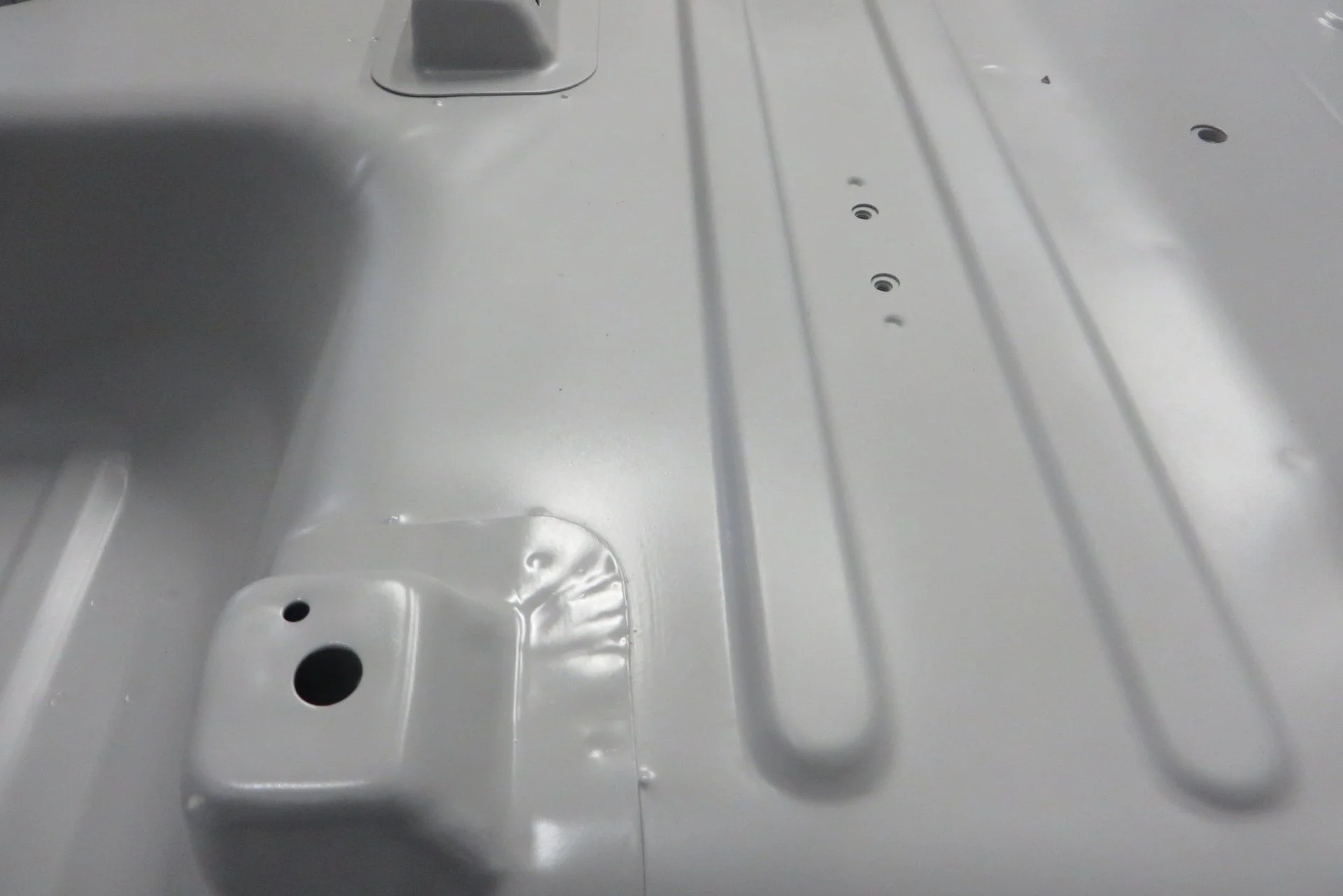

G'day All, I wasn't overly happy with the job I did spraying the epoxy primer. I had a bunch of runs, gun drips and bits of dust. All manner of crap. It wasn't good, so I decided to rub it back and give it another lick of epoxy. If I can get it on by Monday, I should get good chemical and mechanical adhesion. Cheers, Ben P.S. Sanding epoxy sucks.

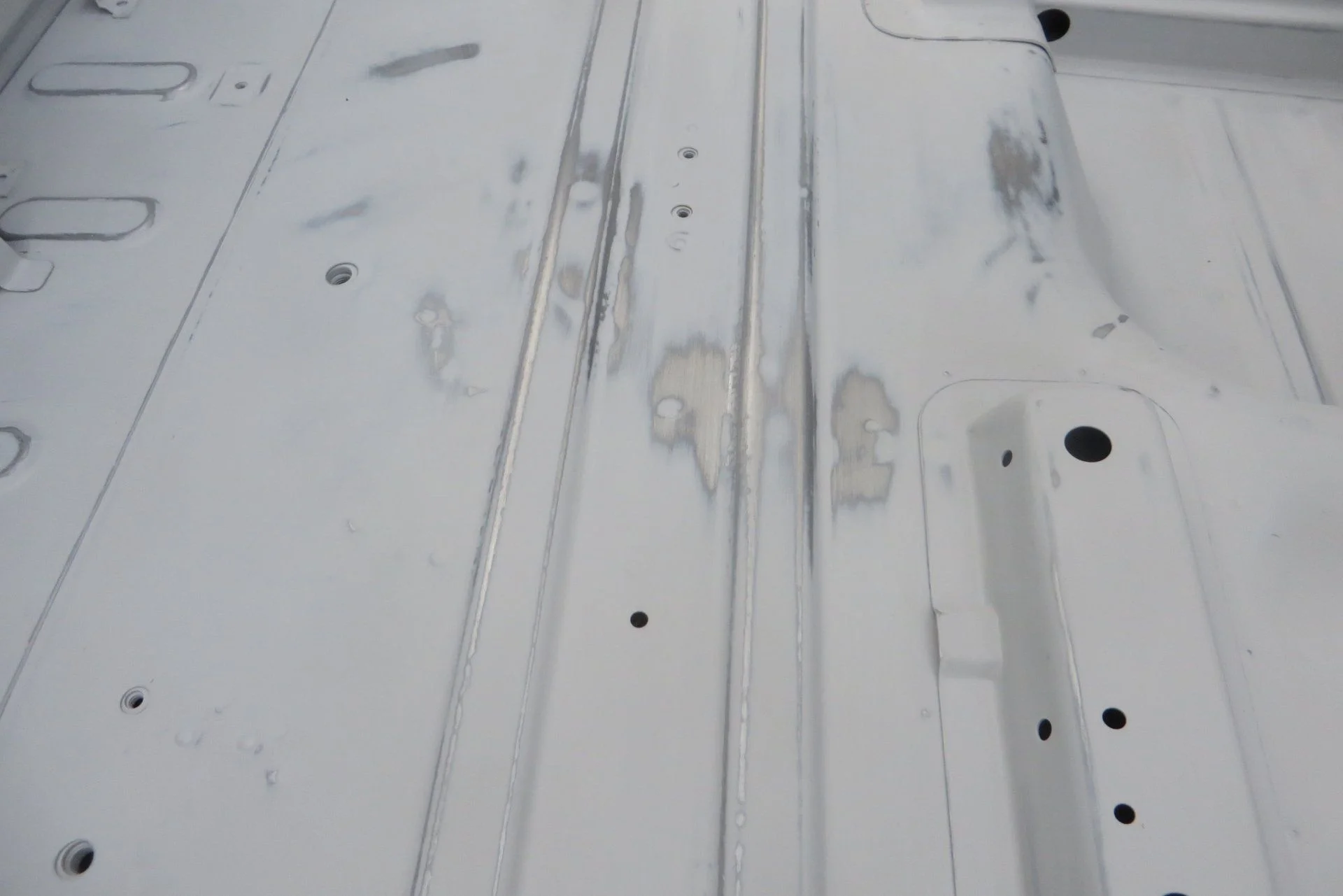

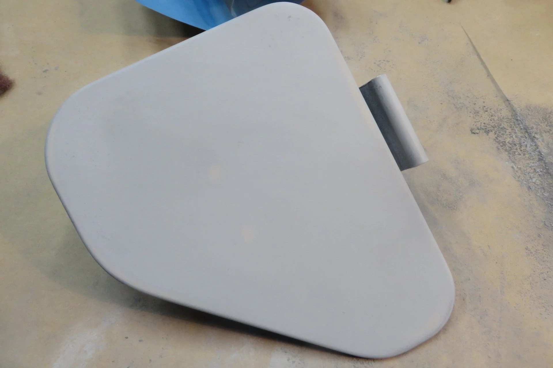

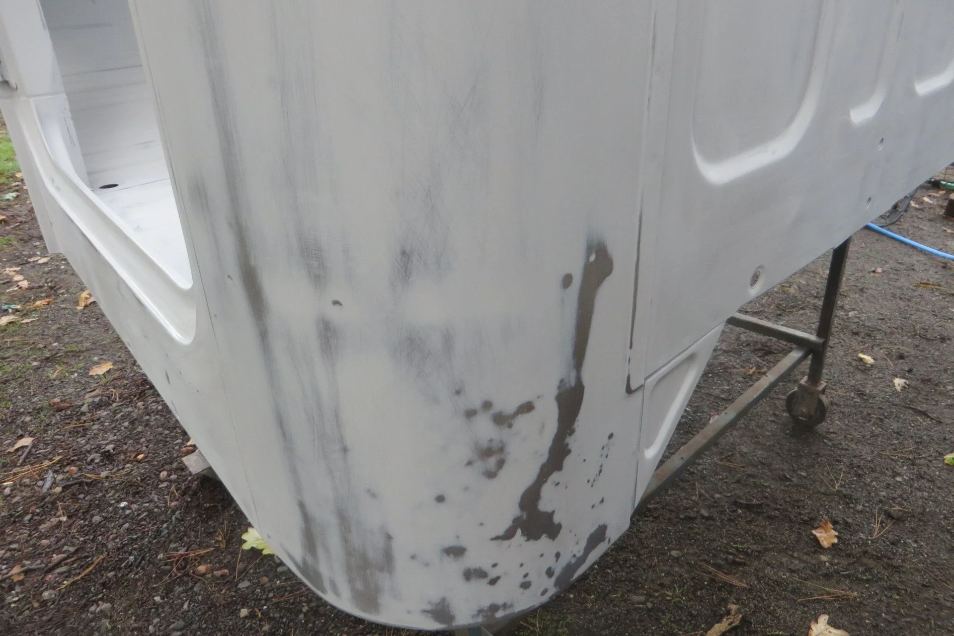

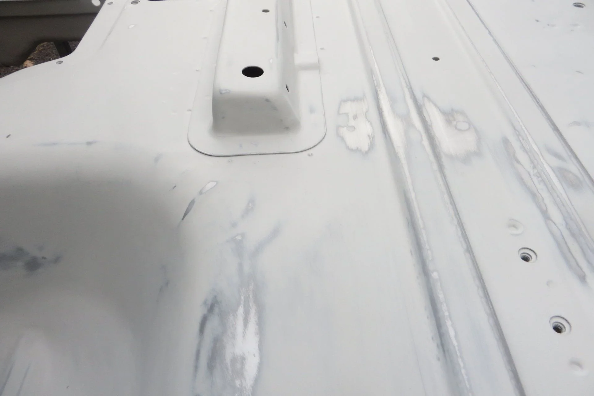

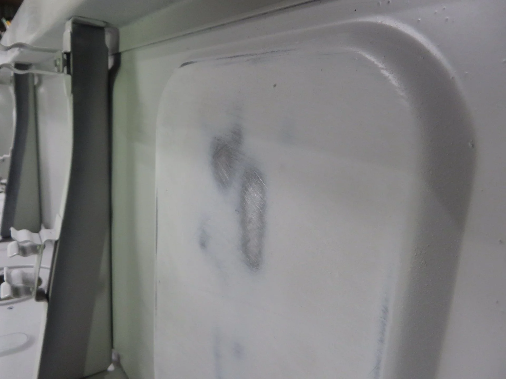

G'day All, Well I have spent the last few nights sanding back the epoxy primer I sprayed last week. Sanding epoxy is bloody difficult and I thoroughly regret not being more thorough the first time around. Here are a couple of pics of the tub sanded out and ready for more epoxy primer.

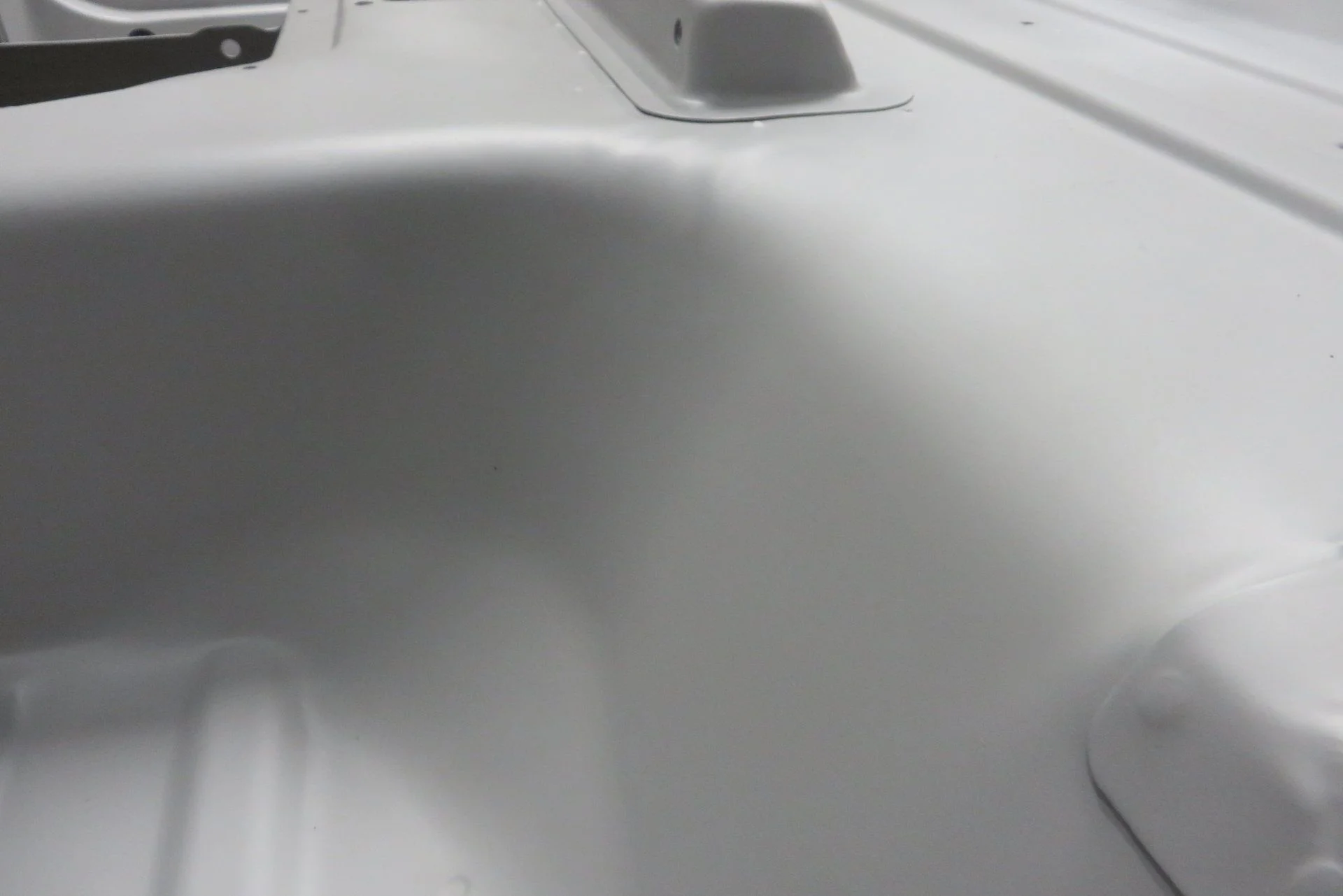

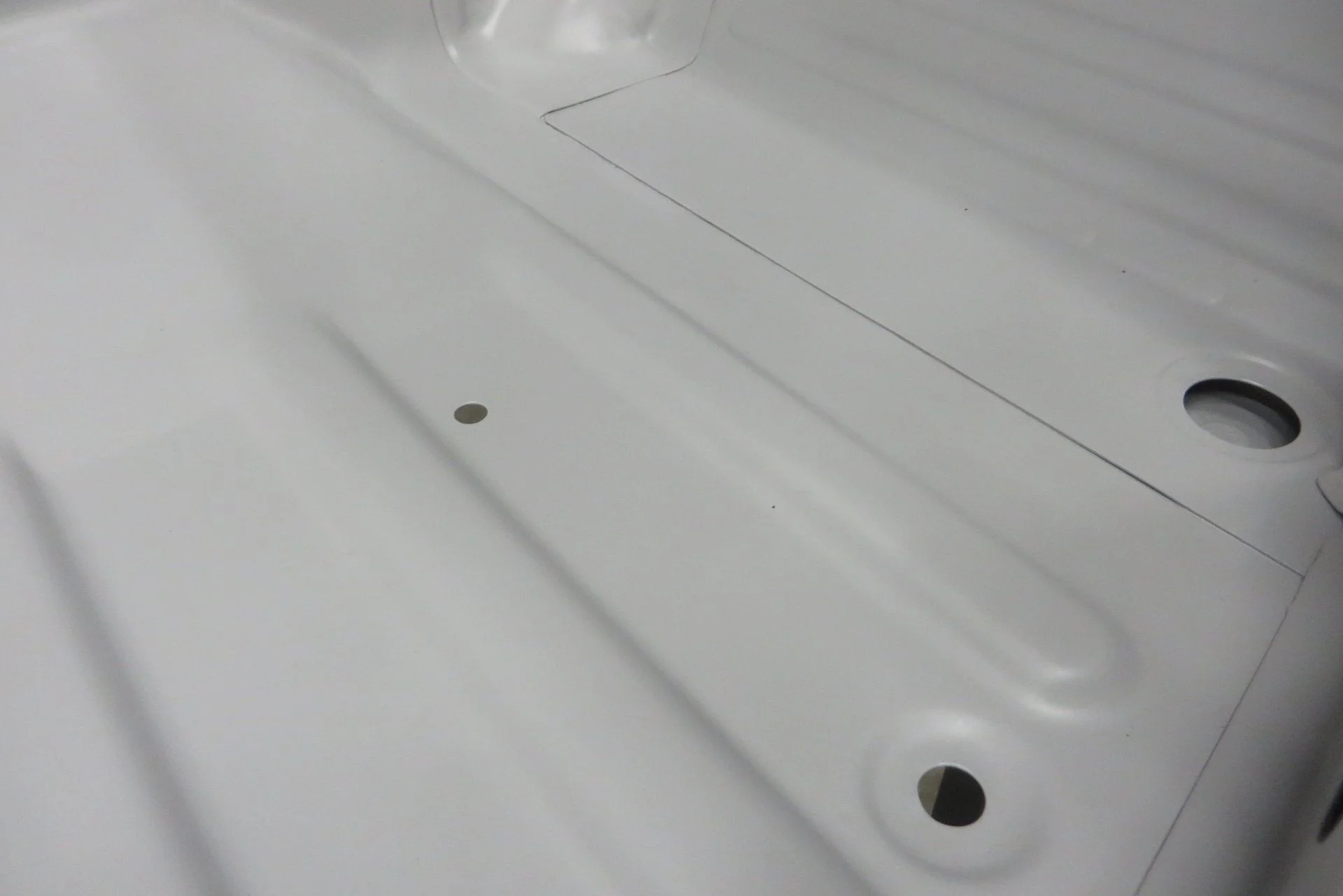

This morning the weather was perfect, so I gave Mario a final clean over. I spent copious amounts of time jamming the air nozzle into nooks and crannies and then rolled it outside and shot some more epoxy. It was around 1 degree celcius when I layed down the first coat. I went much thinner than last week and gave each coat about 45 minutes to an hour to flash off. Usually, this would be 10 - 15 minutes. When I put down the second coat the mercury had risen to 6 degrees. It's far from perfect, but is a 100 percent improvement on last weeks efforts. Still got a couple of minor runs and the occasion bit of dust. But overall much happier.

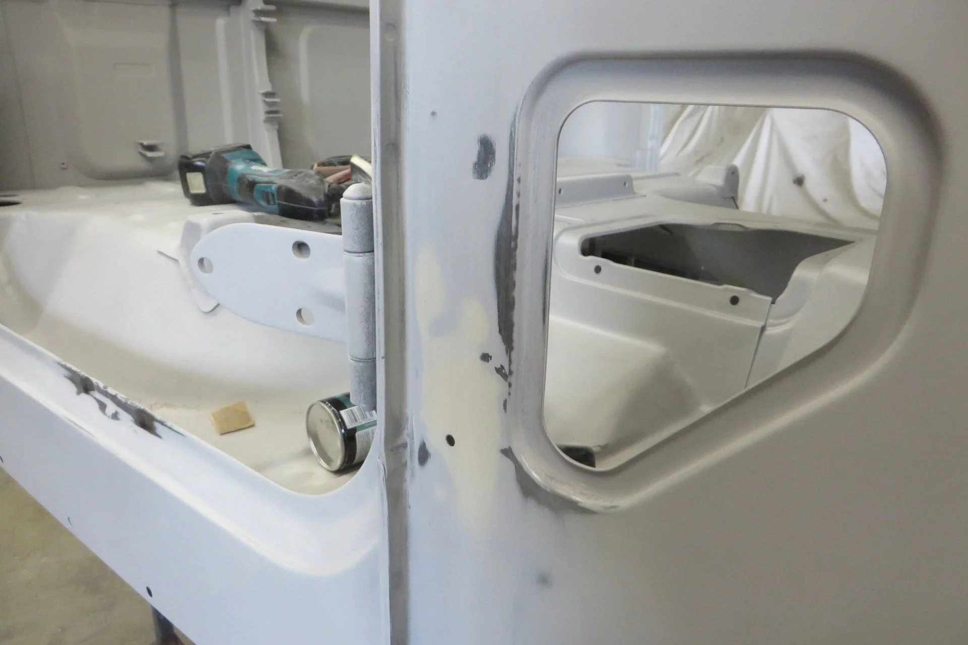

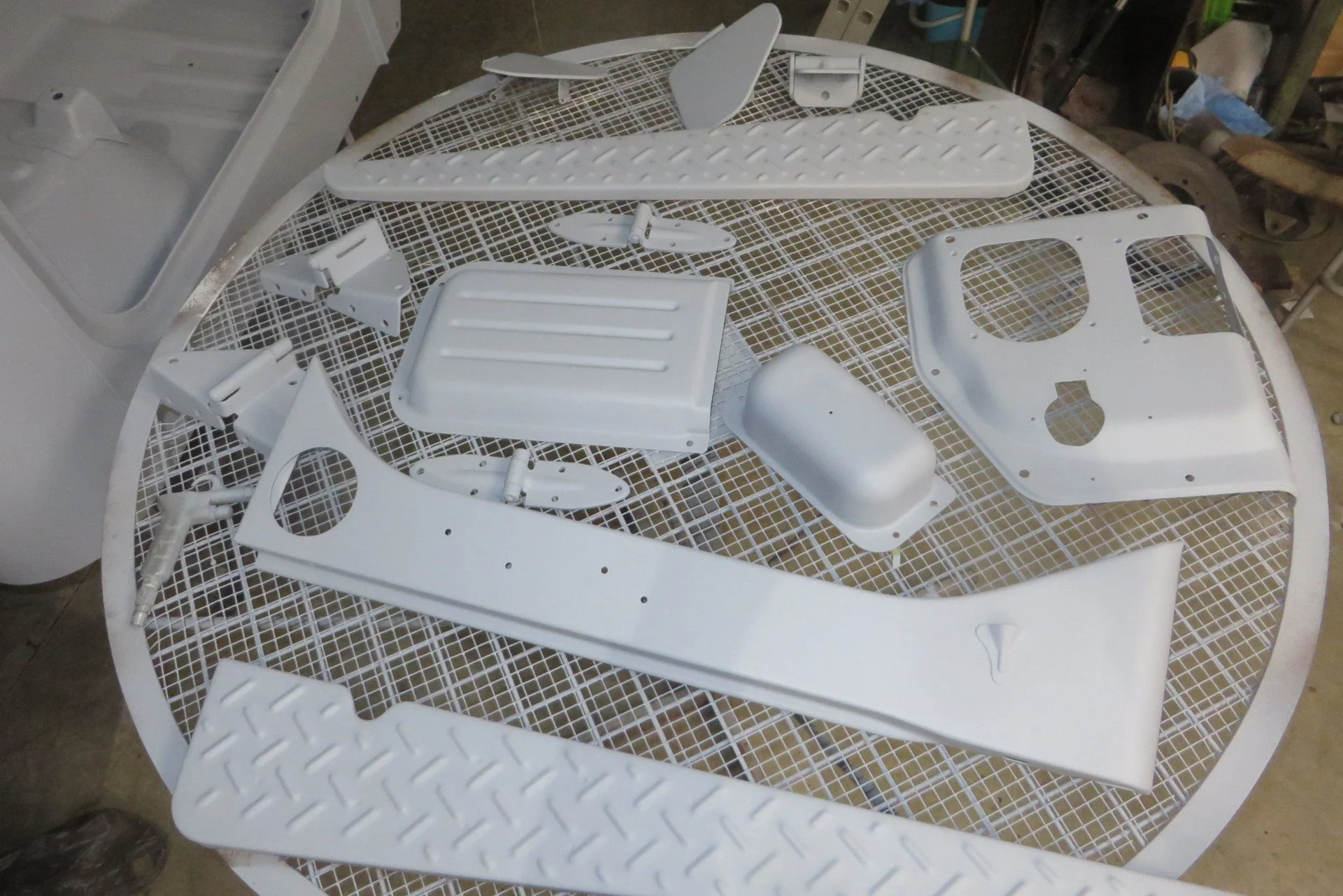

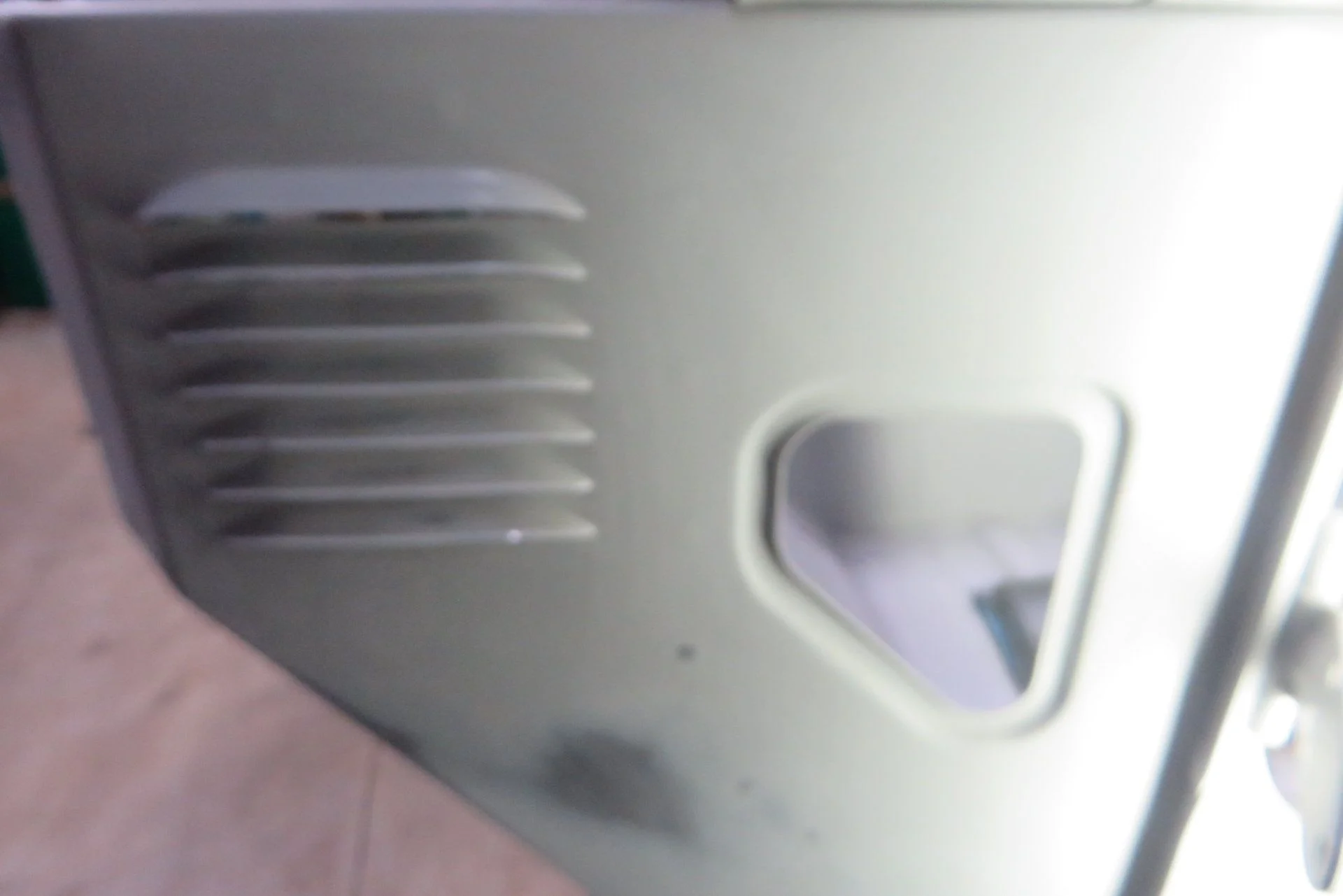

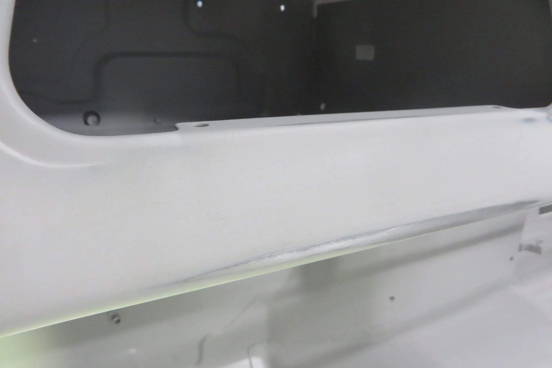

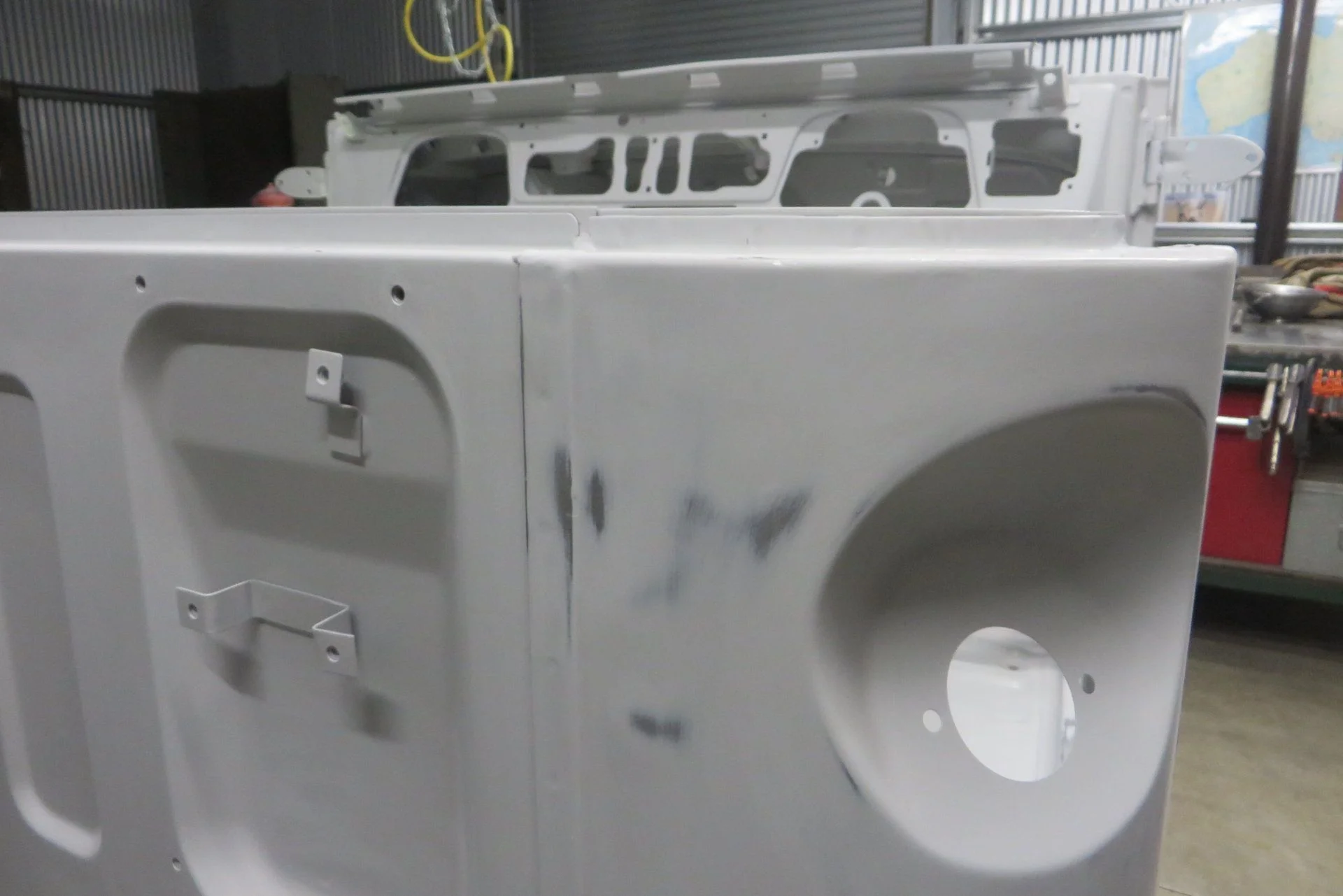

Well it has been about three weeks since I last posted an update. That is because all I have been doing is sanding and as your are aware sanding takes a long time and isn't overly exciting..........unless you happen to be a manufacturer of sand paper I suppose or perhaps have some weird sanding fetish - not entirely out of the question. Pics speak for themselves. After this I rubbed back most of the tub and shot another coat of epoxy primer followed by a couple of coats of high-fill primer.

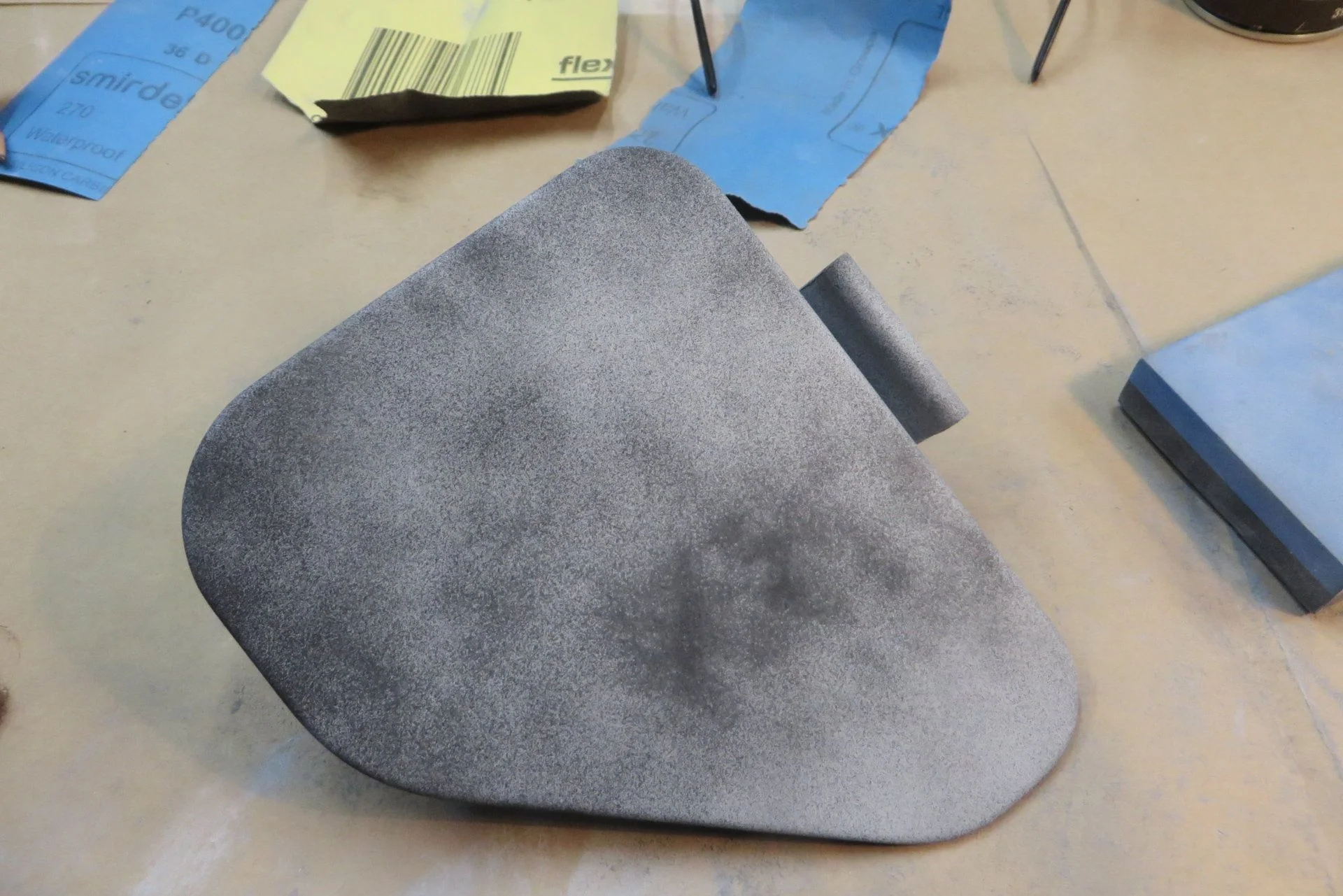

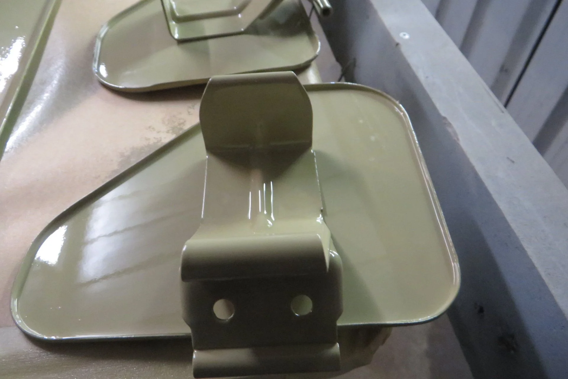

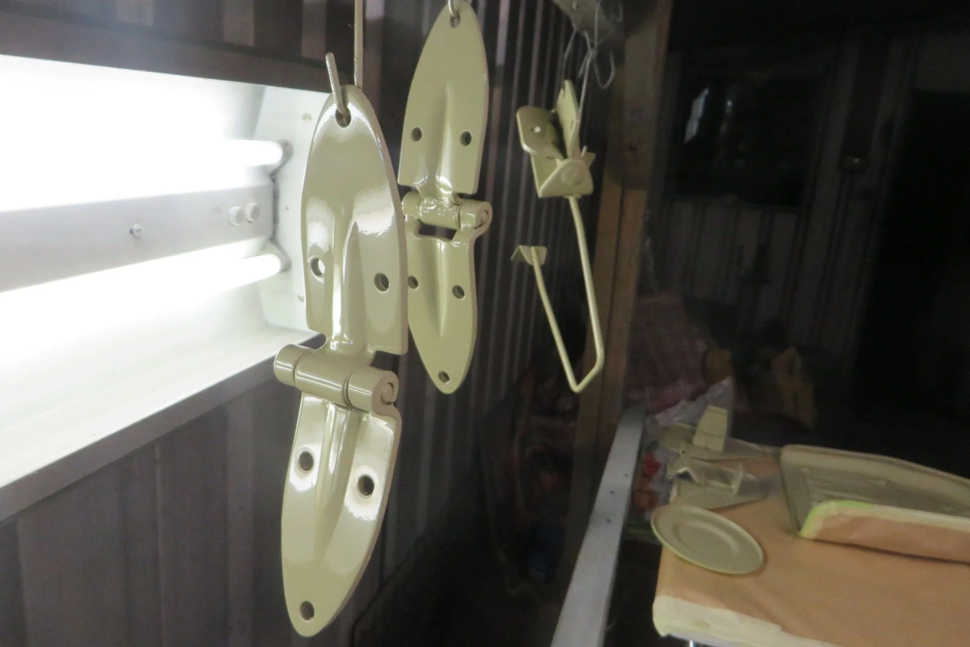

I also got a couple of coats of high-fill primer onto miscellaneous items, such as side steps and door hinges etc. I then guide coated these items and rubbed them back with 240, 320 and 400 grit and also with red scotchbrite pad. I then gave them another coat of high-fill primer. So, I guess it's now time for more sanding.

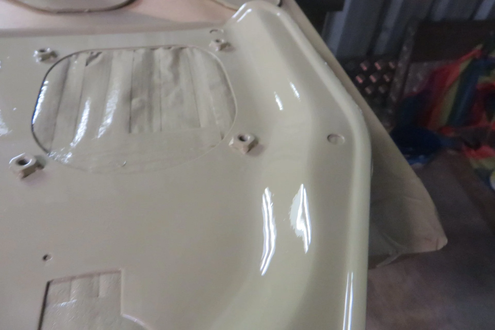

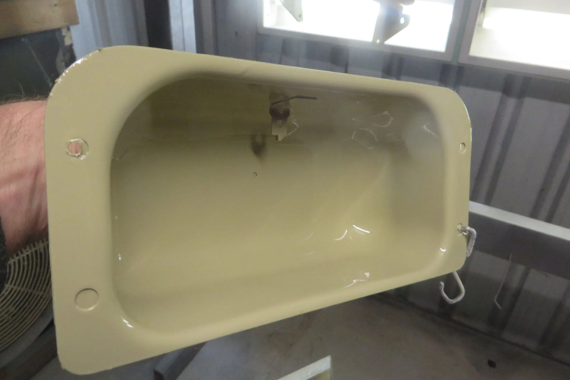

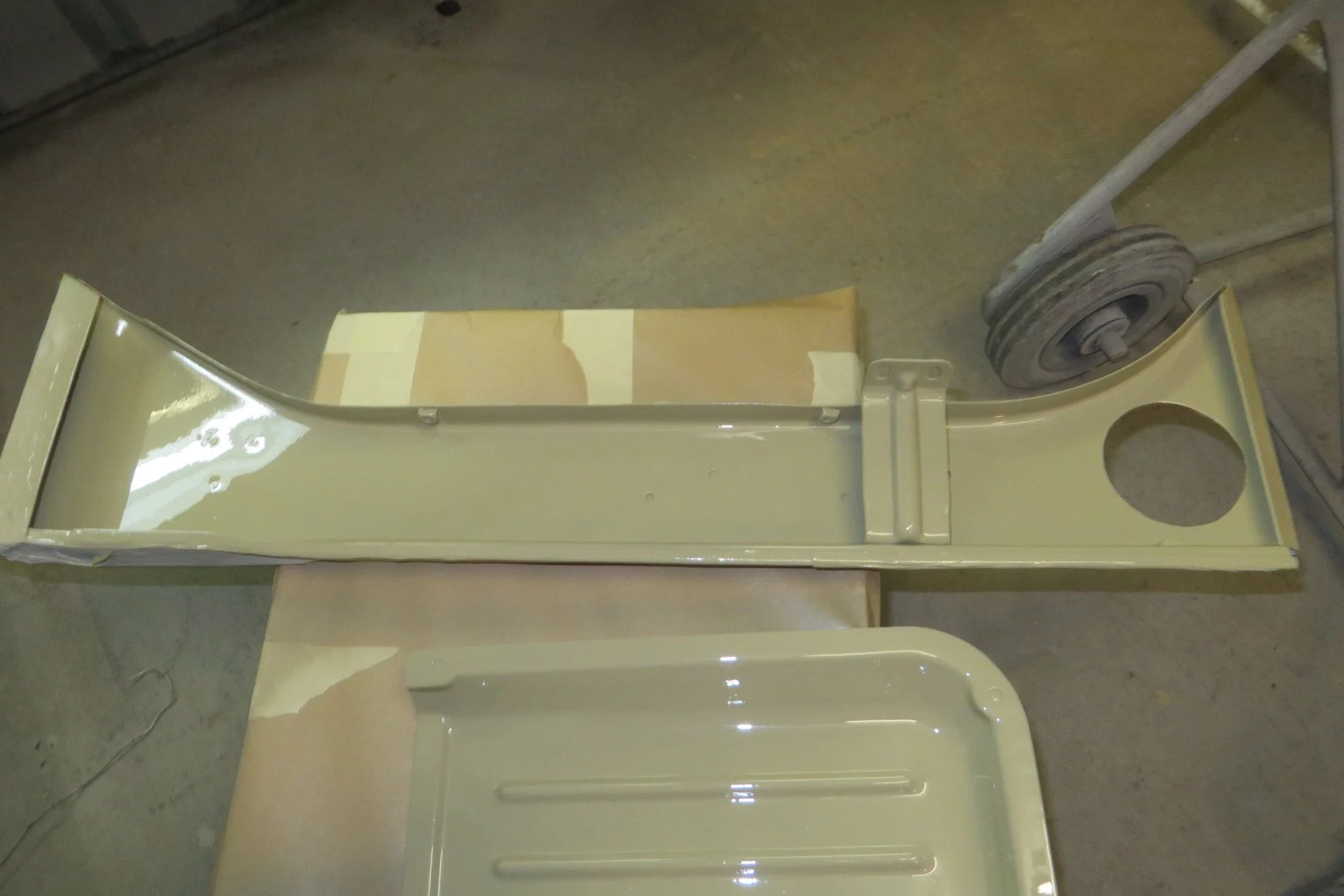

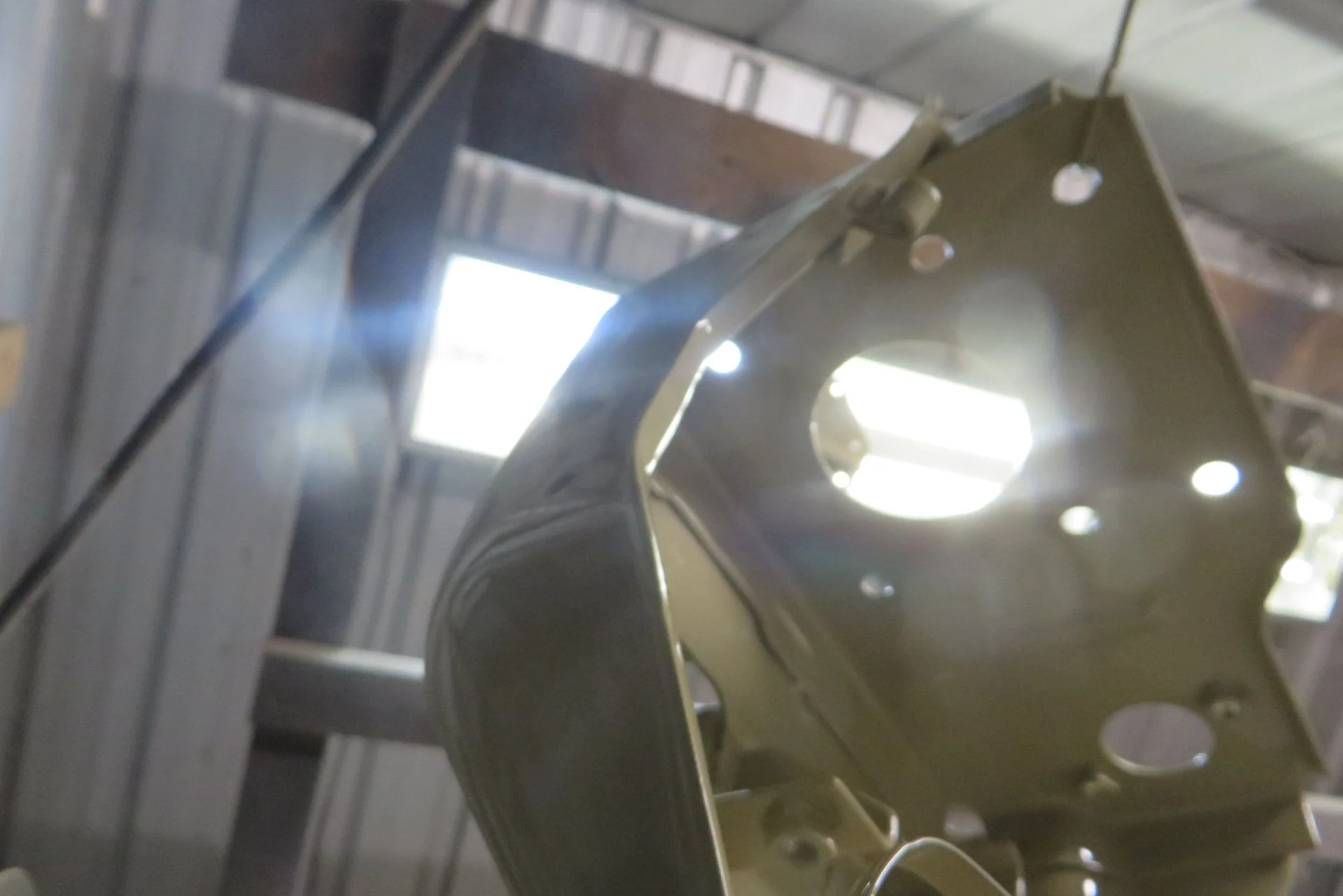

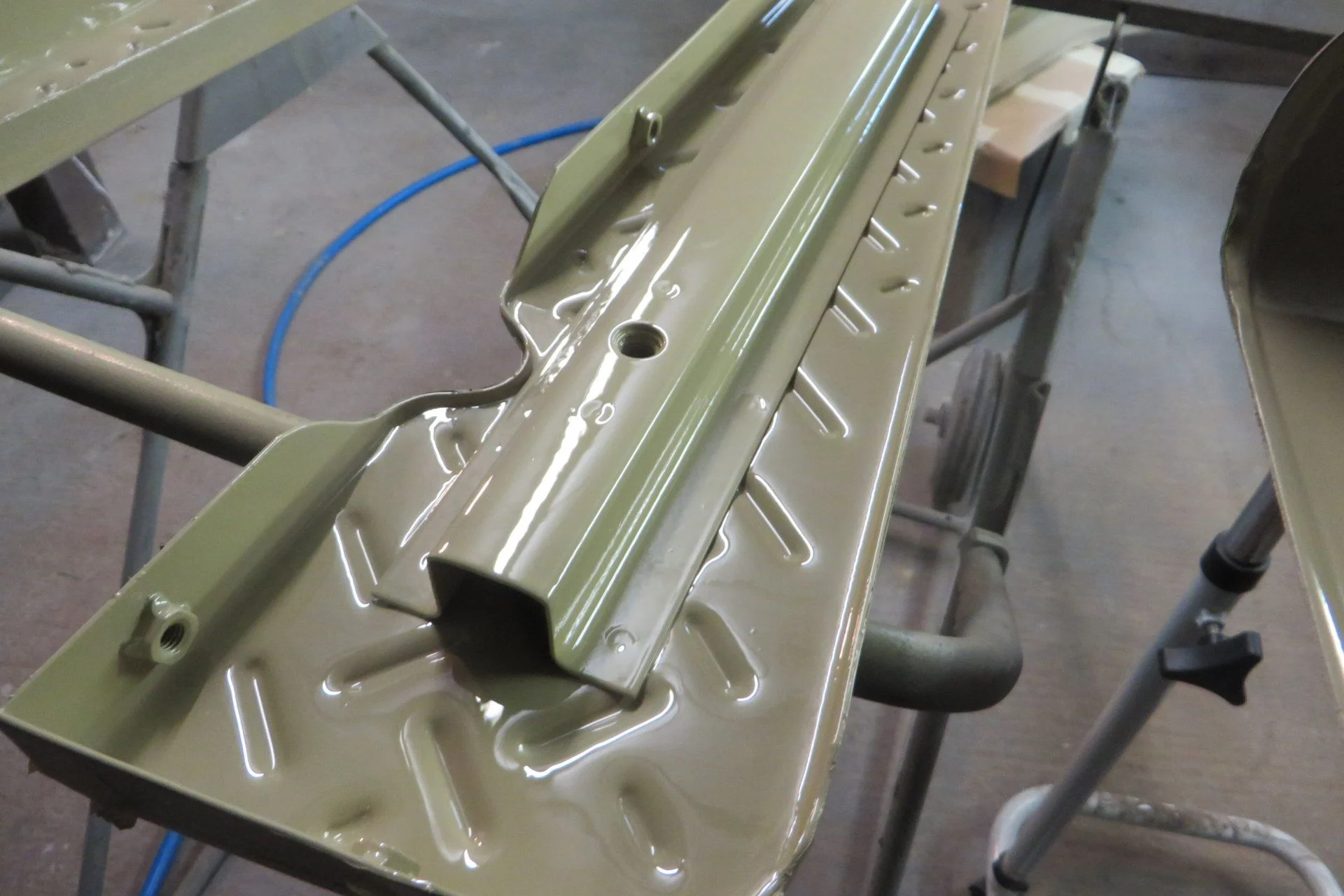

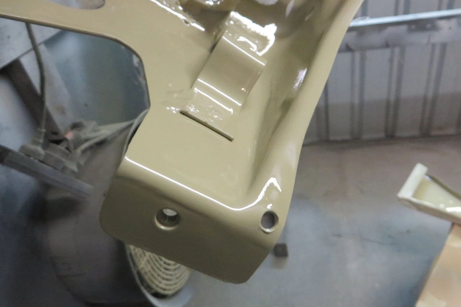

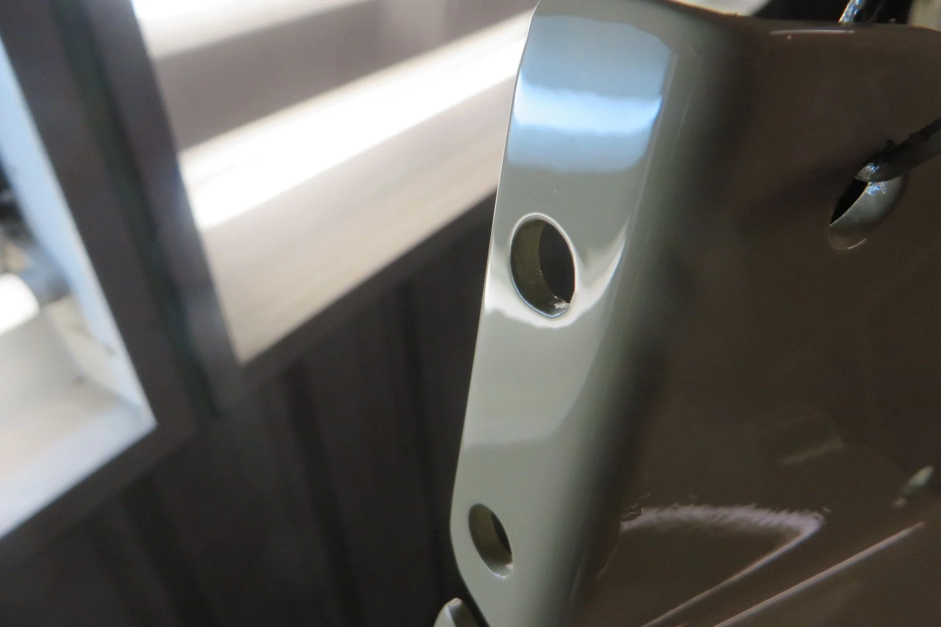

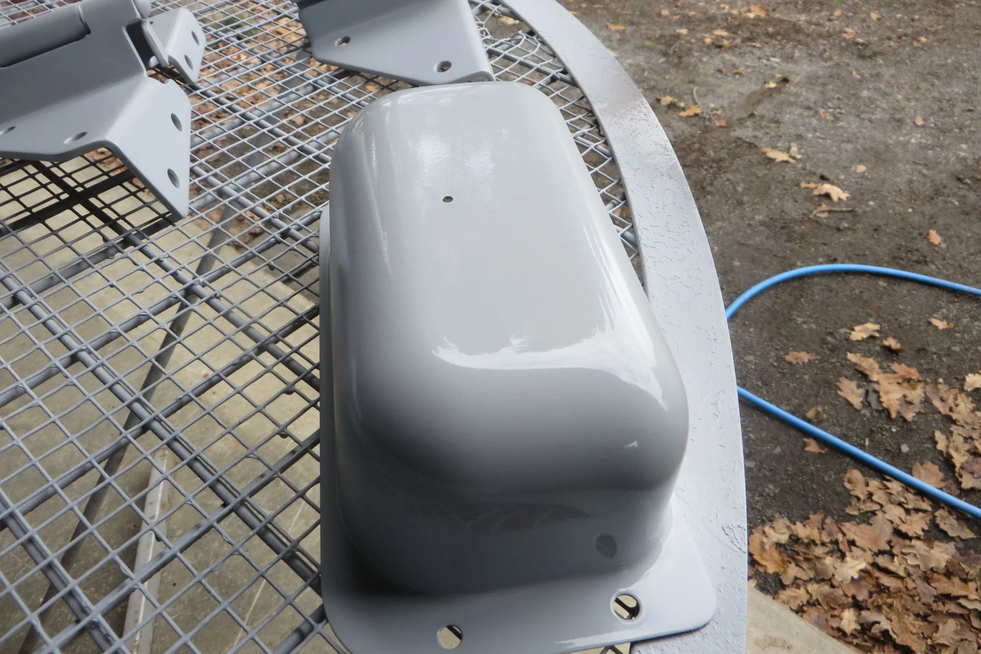

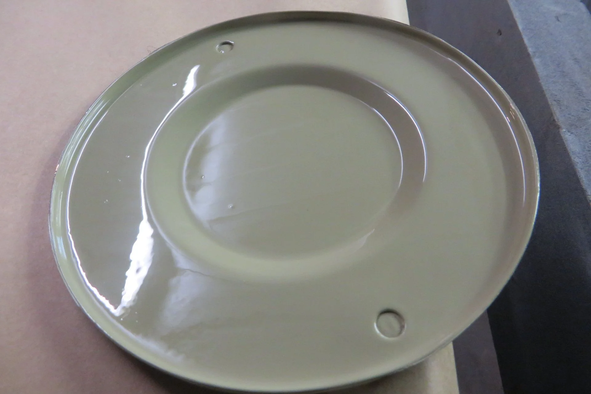

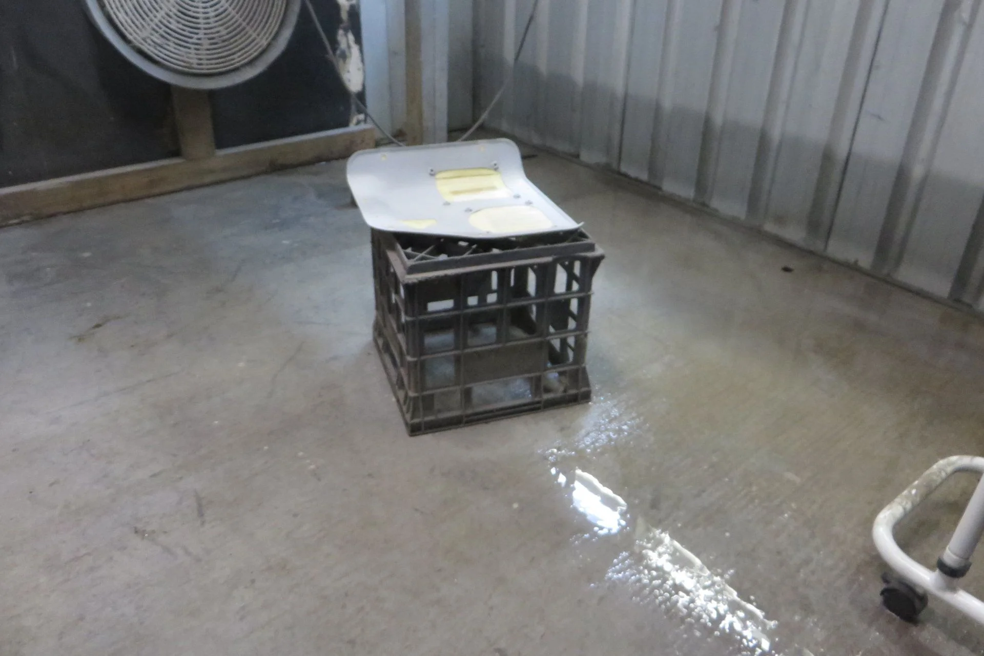

G'day All, I finally sprayed colour tonight. Backmasked a heap of little bits during the week -hinges, tranny cover, jacket holder, side steps and gave them a final light sand. So this afternoon I cleaned out the worlds dodgiest spray booth, slopped some water onto the floor and let rip. It was as cold as a mother-in-laws kiss, so I popped some paint, reducer and hardner into a bucket of hot water.
