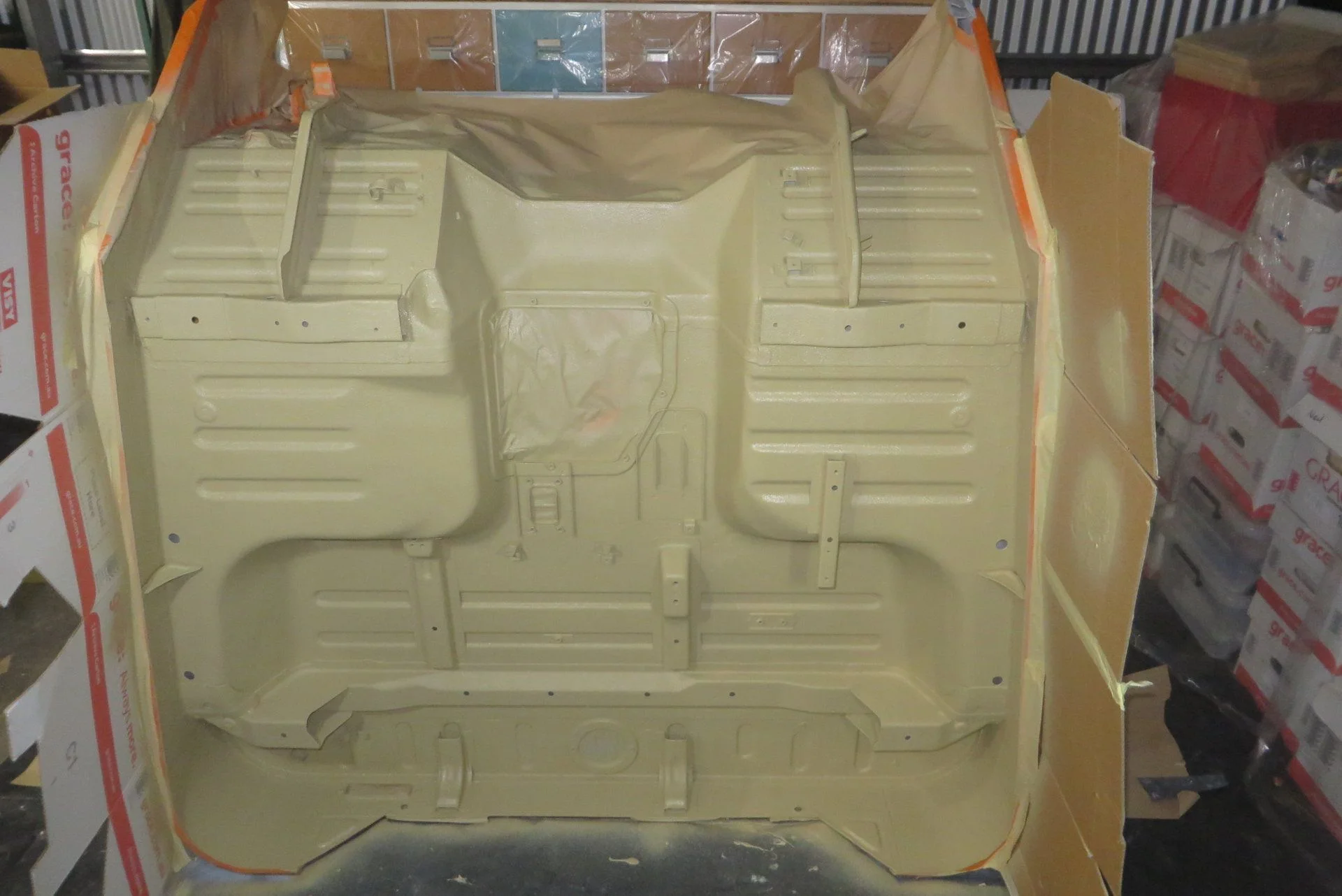

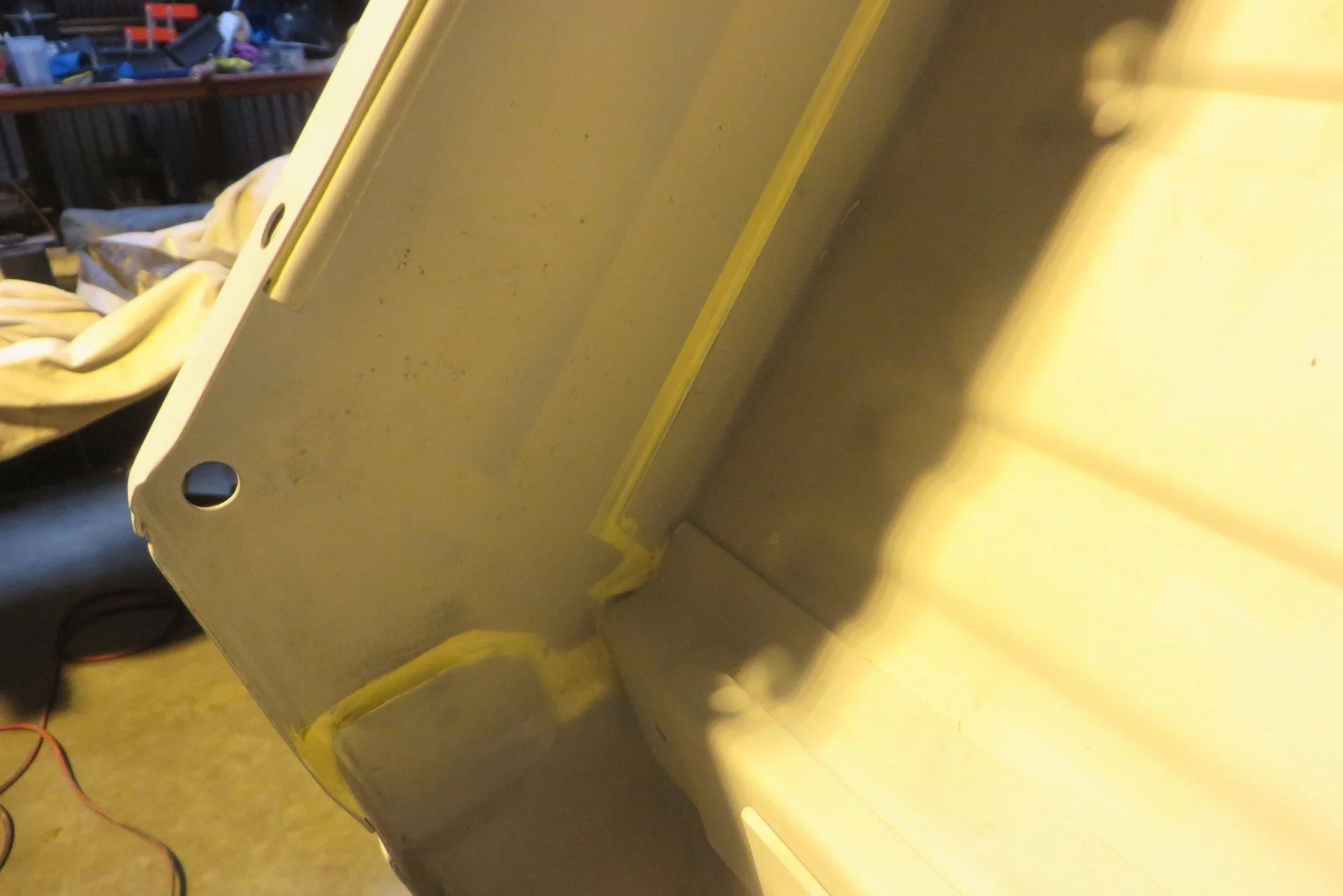

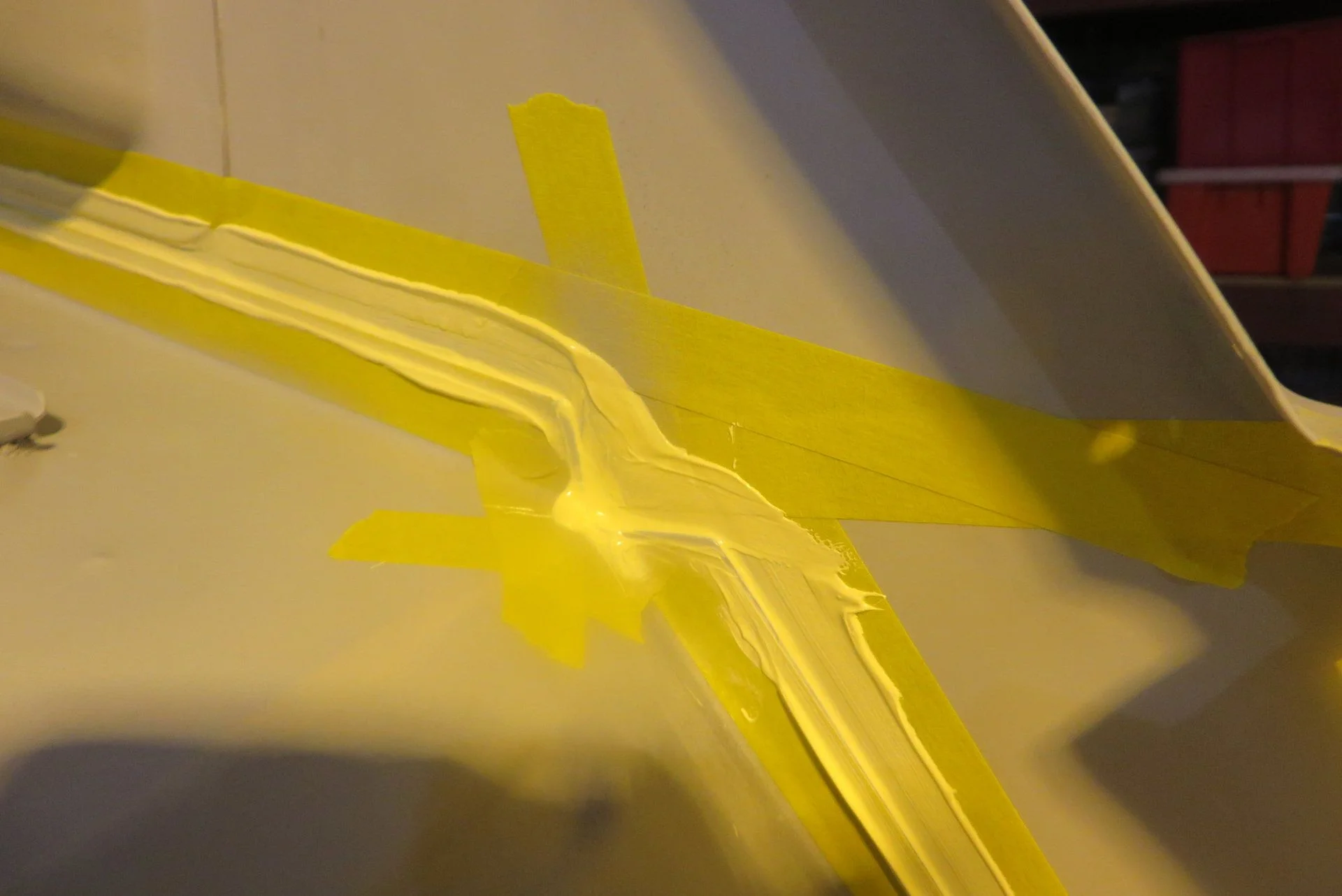

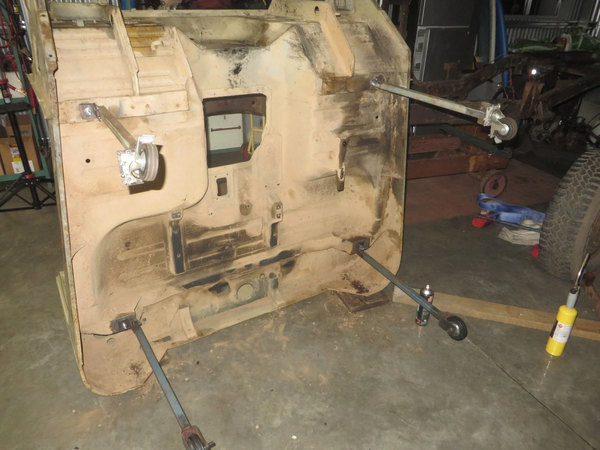

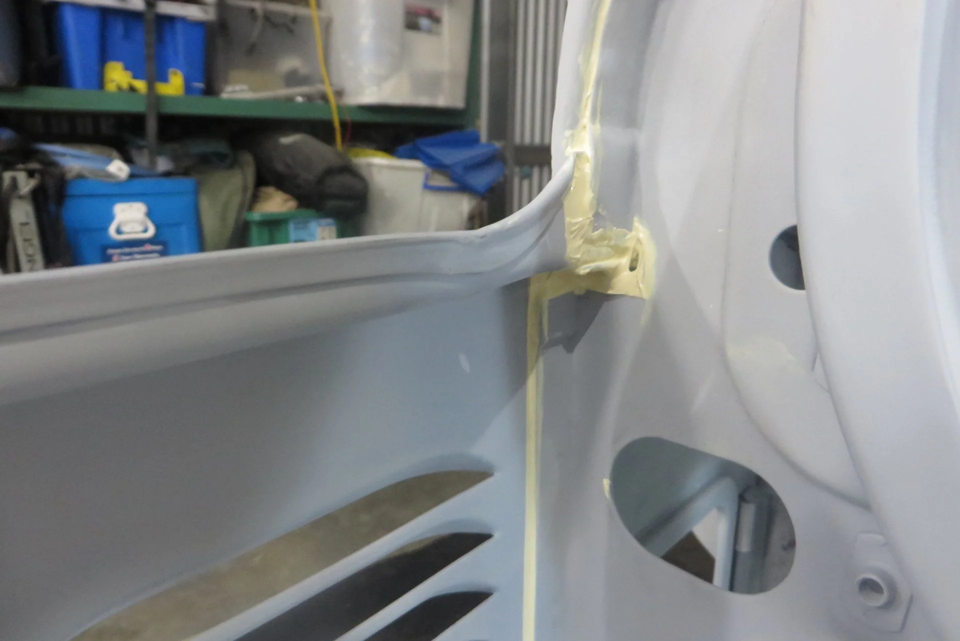

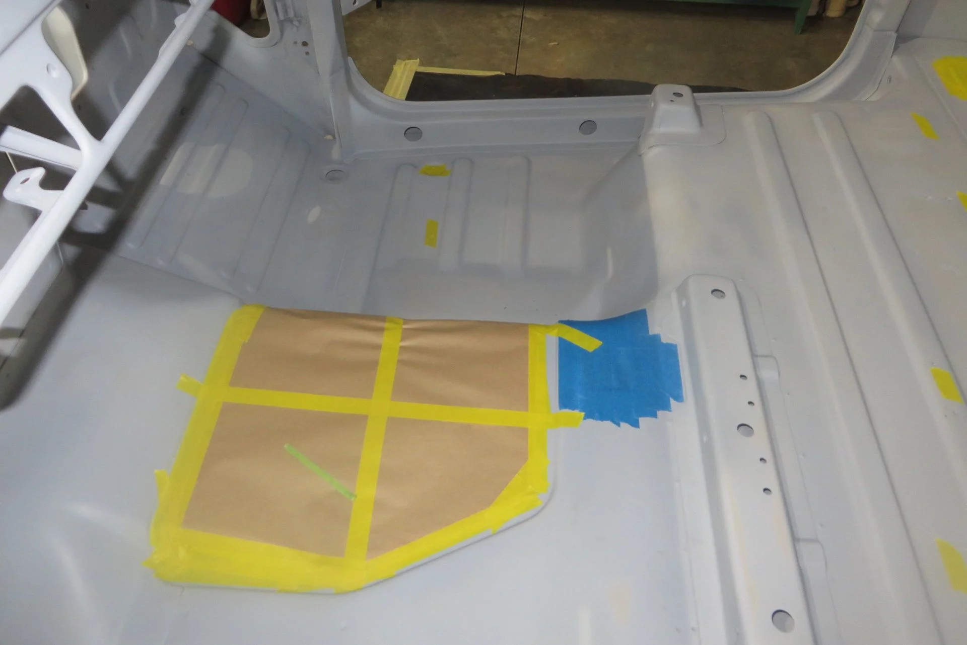

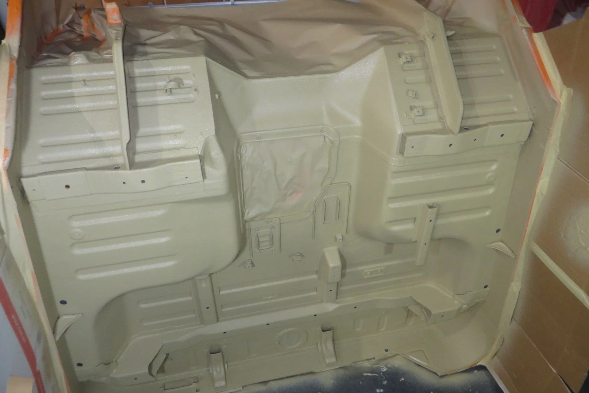

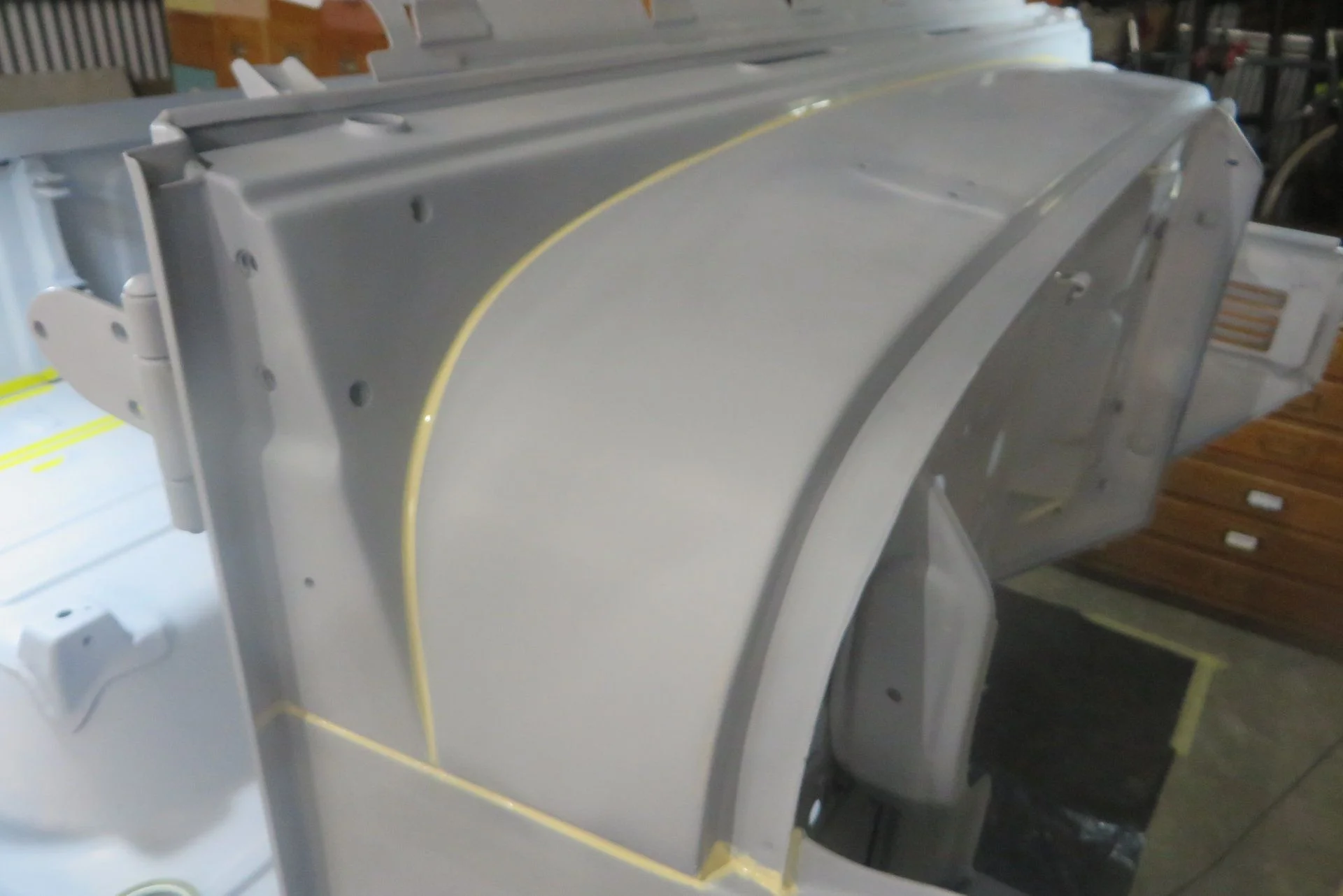

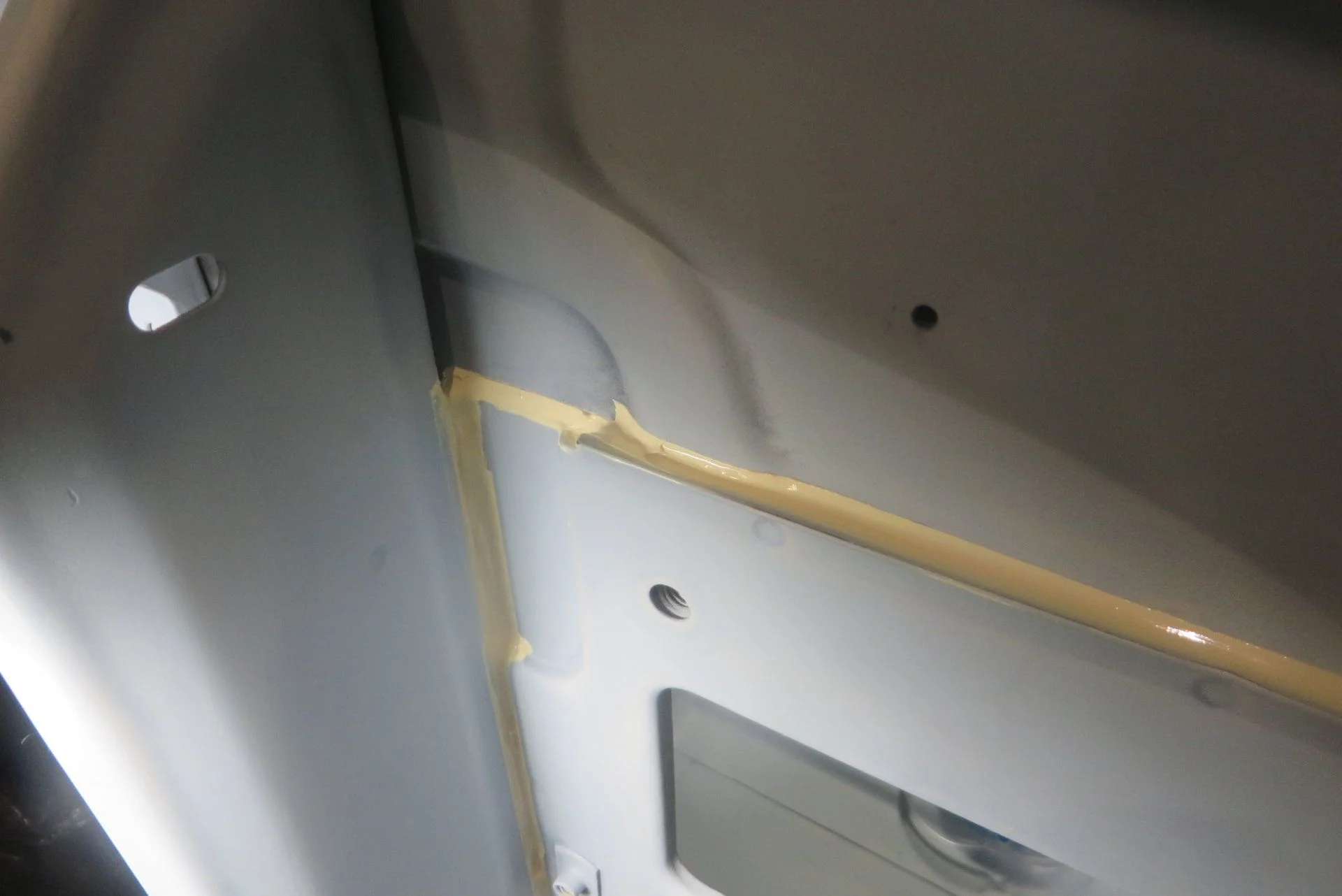

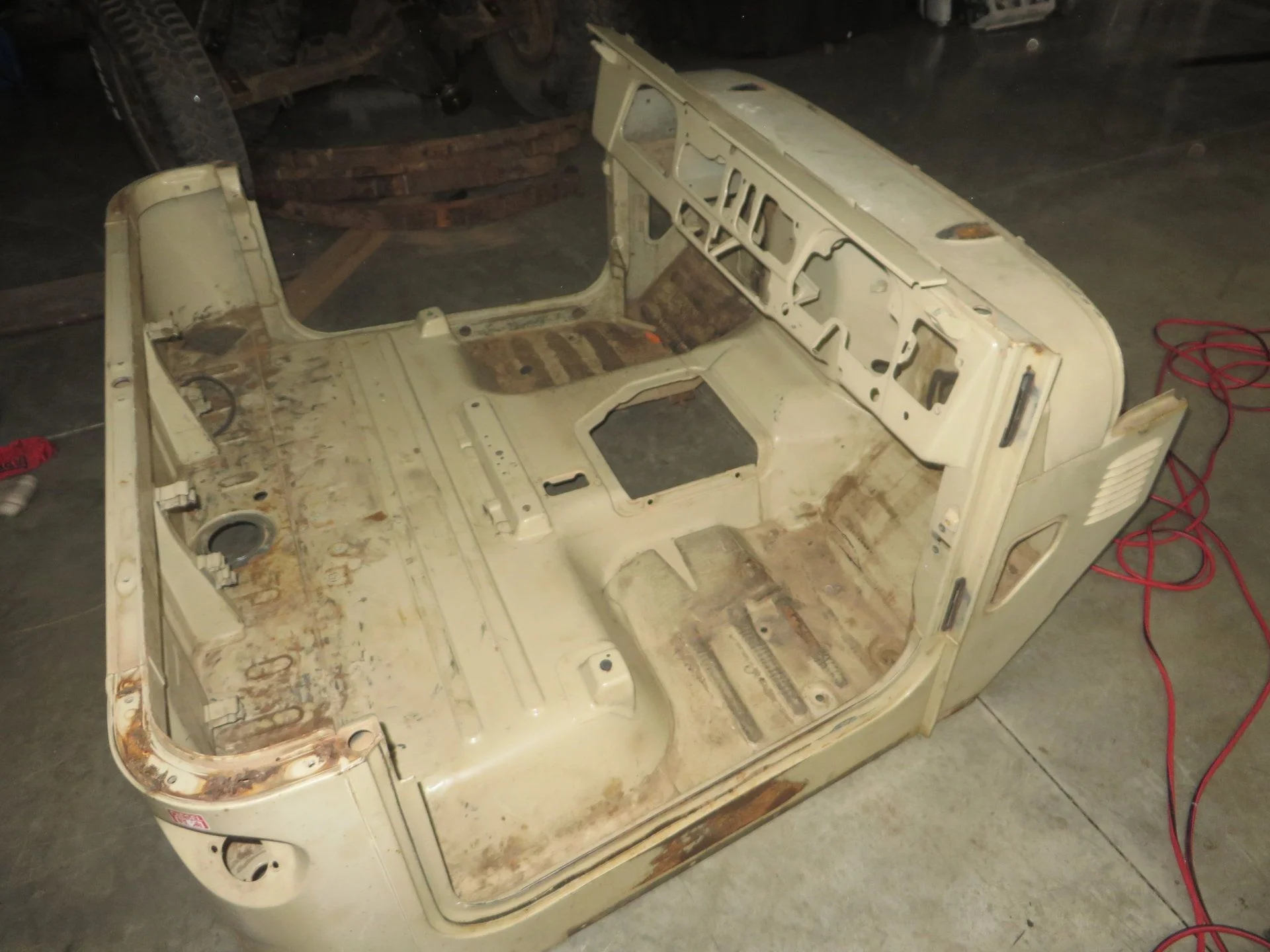

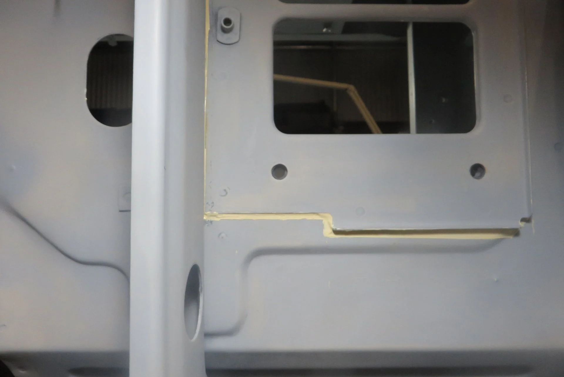

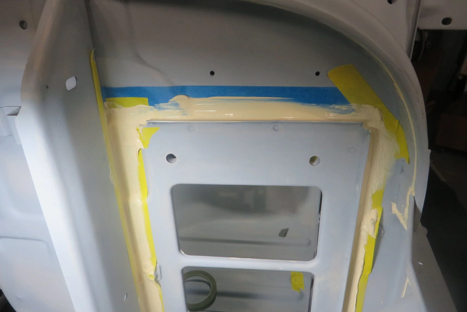

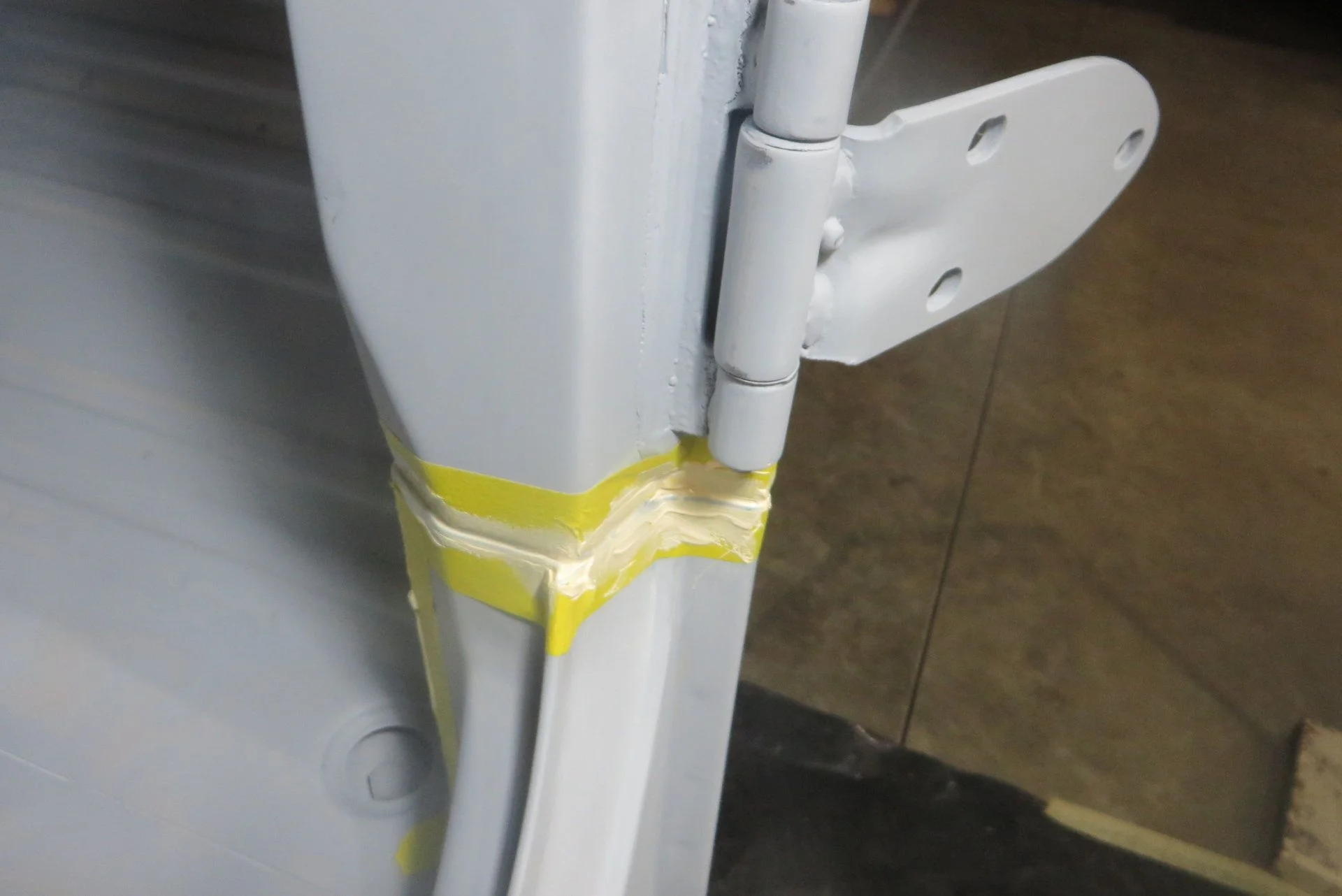

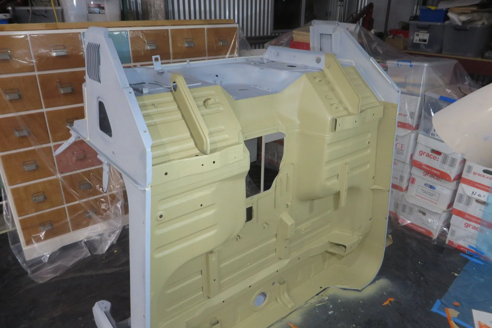

A quick update - I'm getting ready to flip Mario onto his back and spray some Raptor liner. I've also started to do some seam sealing.

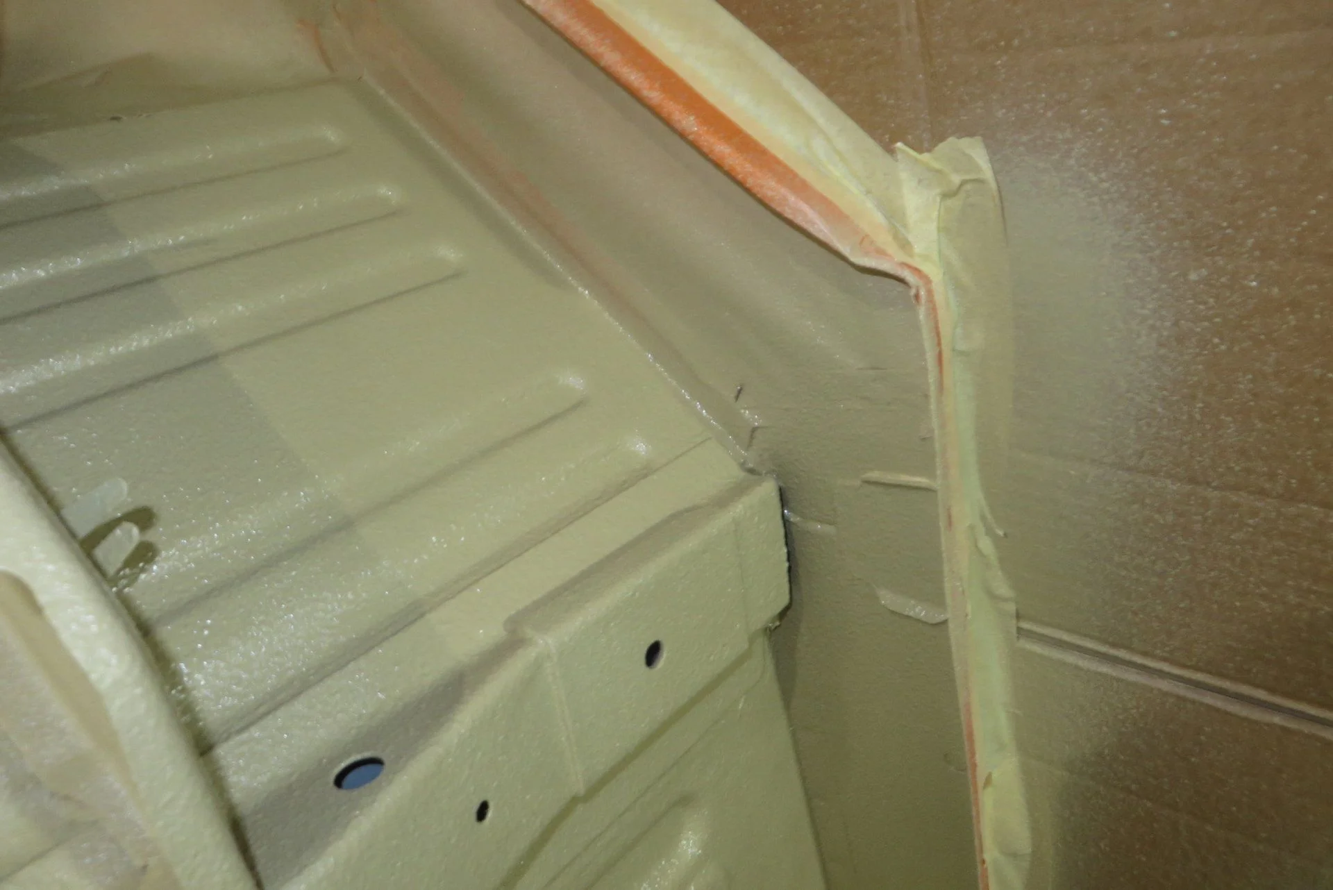

The Raptor Wrap

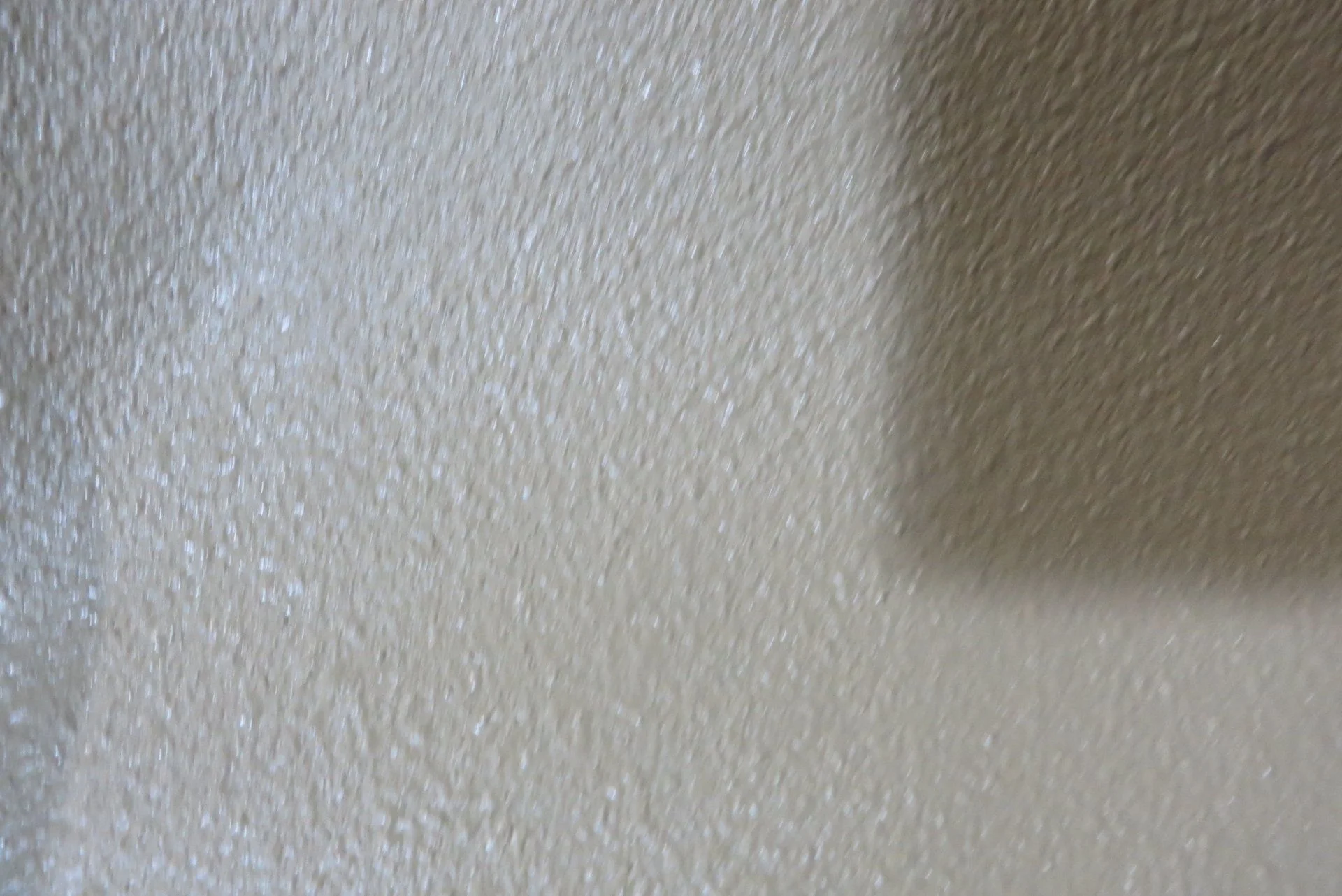

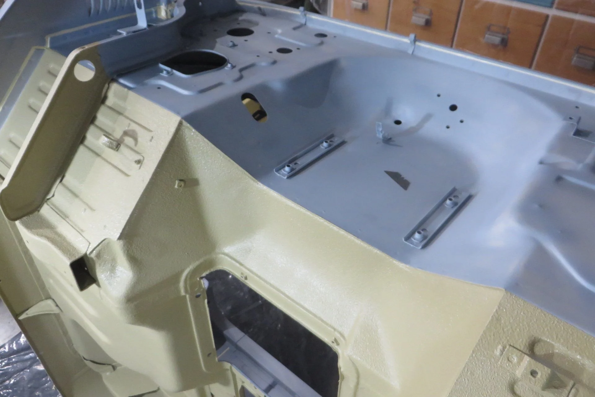

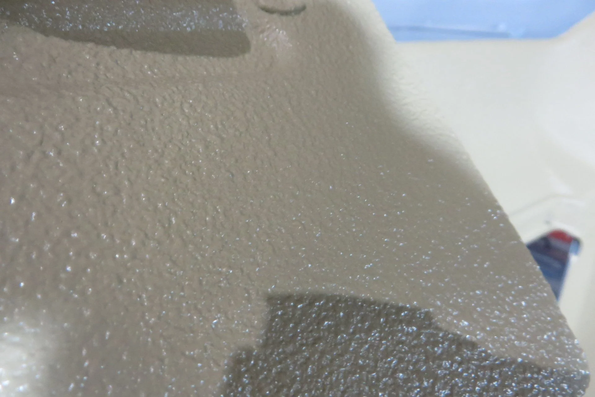

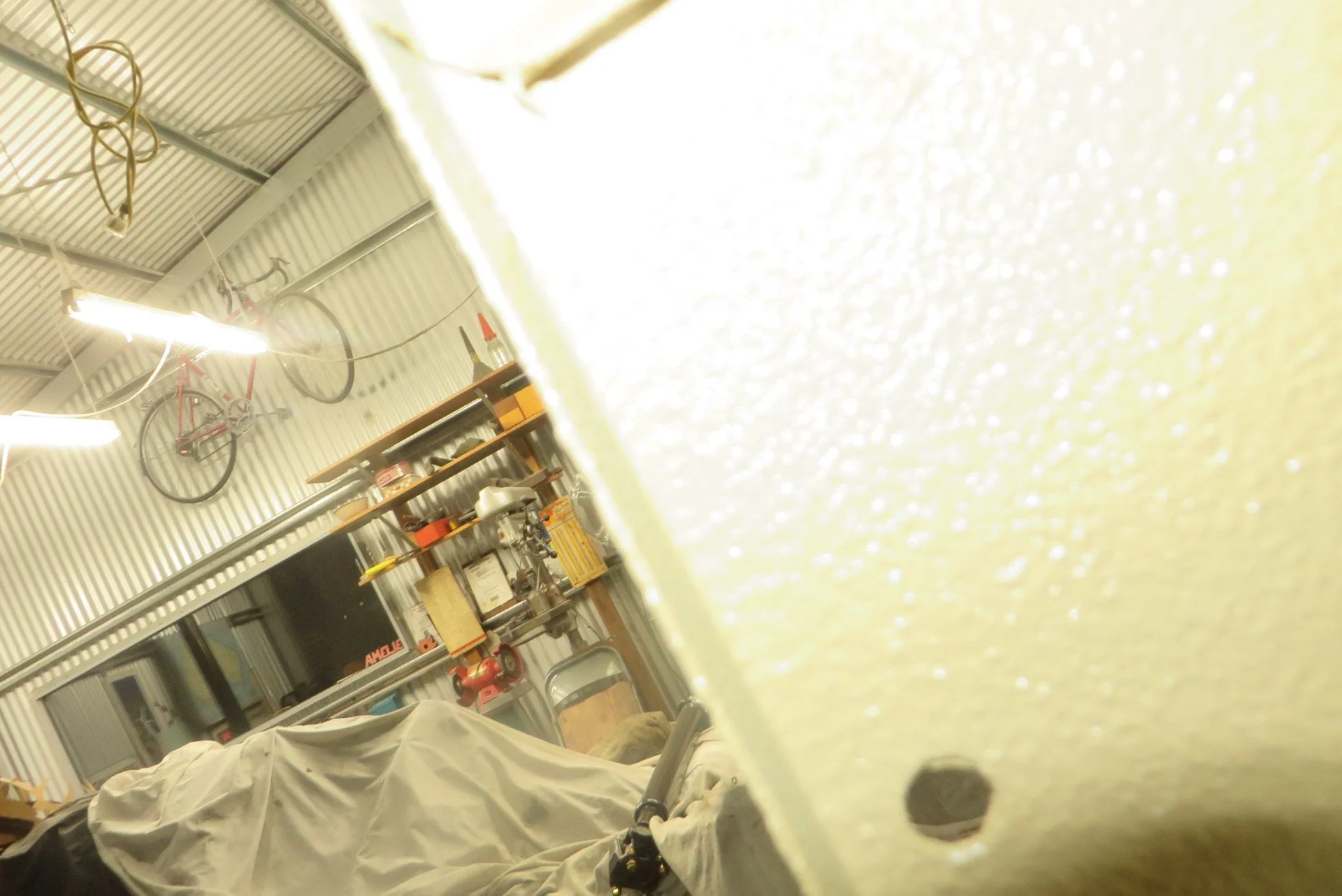

Texture & Air Pressure: I watched a couple of U-Pol videos on Youtube before I started. They suggested that the liner can be sprayed at anywhere from around 40 to 50 psi (3.0 to 3.5 bar) up to around 70 psi (@5 bar) and that if you want a smoother less textured finish, spray at a lower pressure. So the higher the pressure the more textured the finish. I wanted a reasonably smooth finish and set my regulator to 3.5 bar and it is still pretty textured.
Mixing tip: I mixed three products - liner, hardener and colour, in a separate container and then poured this back into the bottle (The bottles are designed to screw straight onto the bottom of the shutz gun) . This was a little messy, but I don't think you could adequately mix them together if you tried to mix the products together by pouring the hardener and colour into the bottle and shaking. This was also a U-Pol tip and worked pretty well.
Overall reasonable happy.
