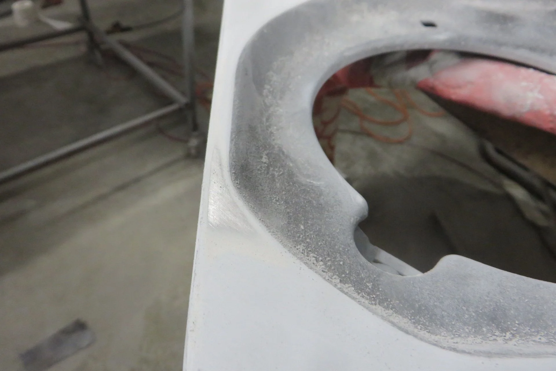

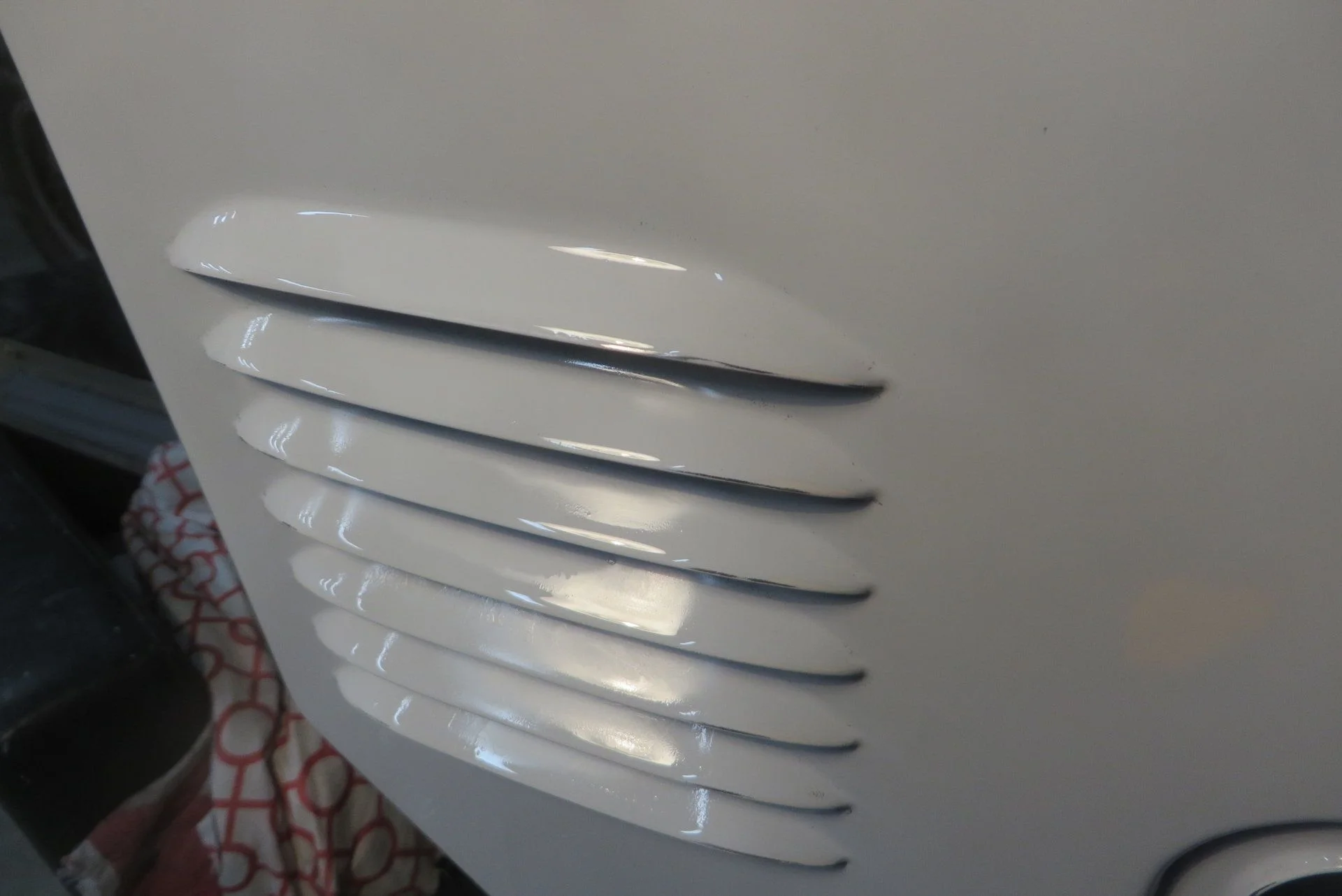

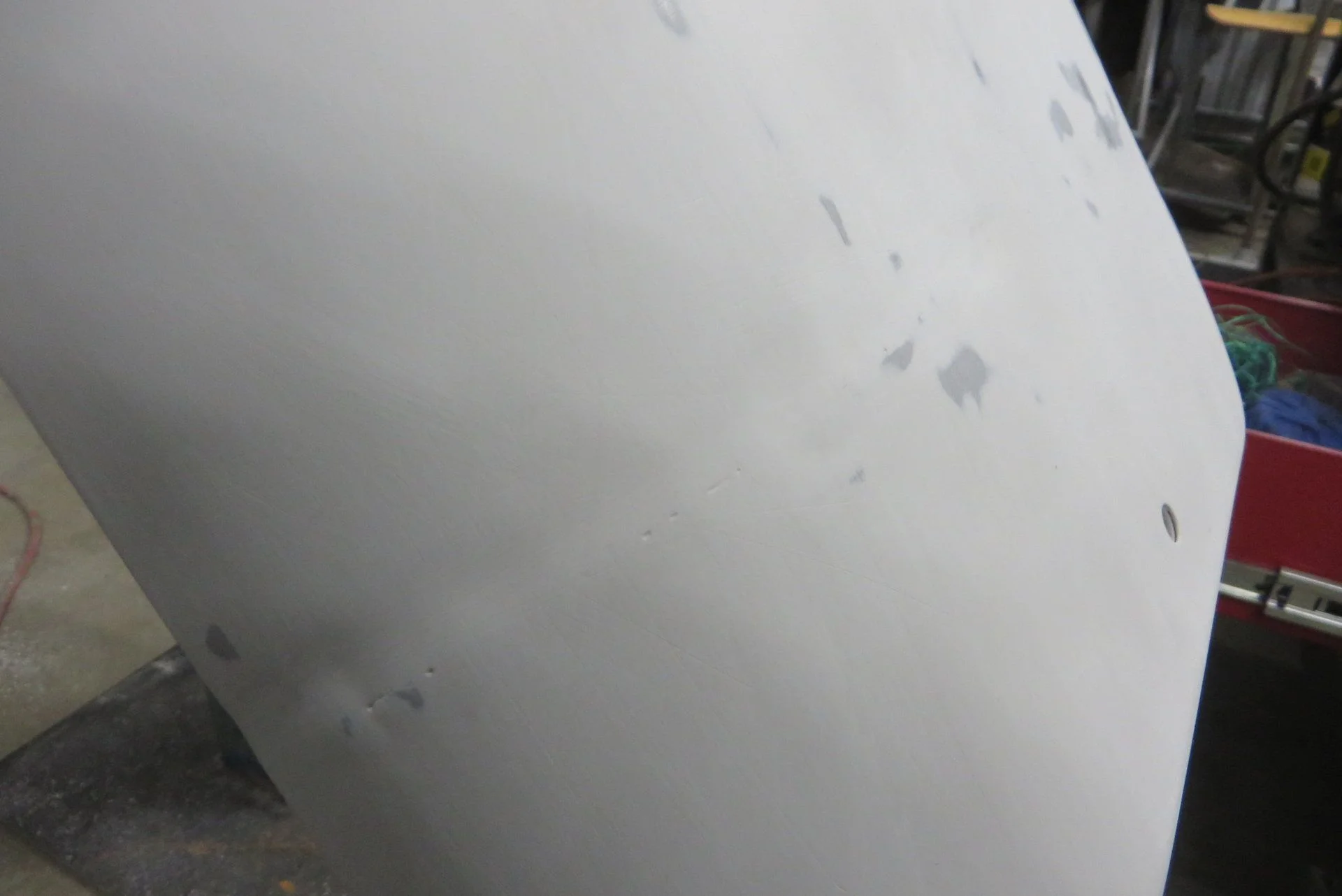

Well guys, It has been a while since I updated this thread. This is what I have discovered. There seems to be a general rule of thumb that if you are painting a car using a 'solid' or 'direct gloss' 2-pac paint system (so the gloss and colour are paint are one product ) as opposed to using a 'clear over base' paint system (you paint the colour and then spray a 2-pac clear coat over the top) then you dry sand to 400 grit.

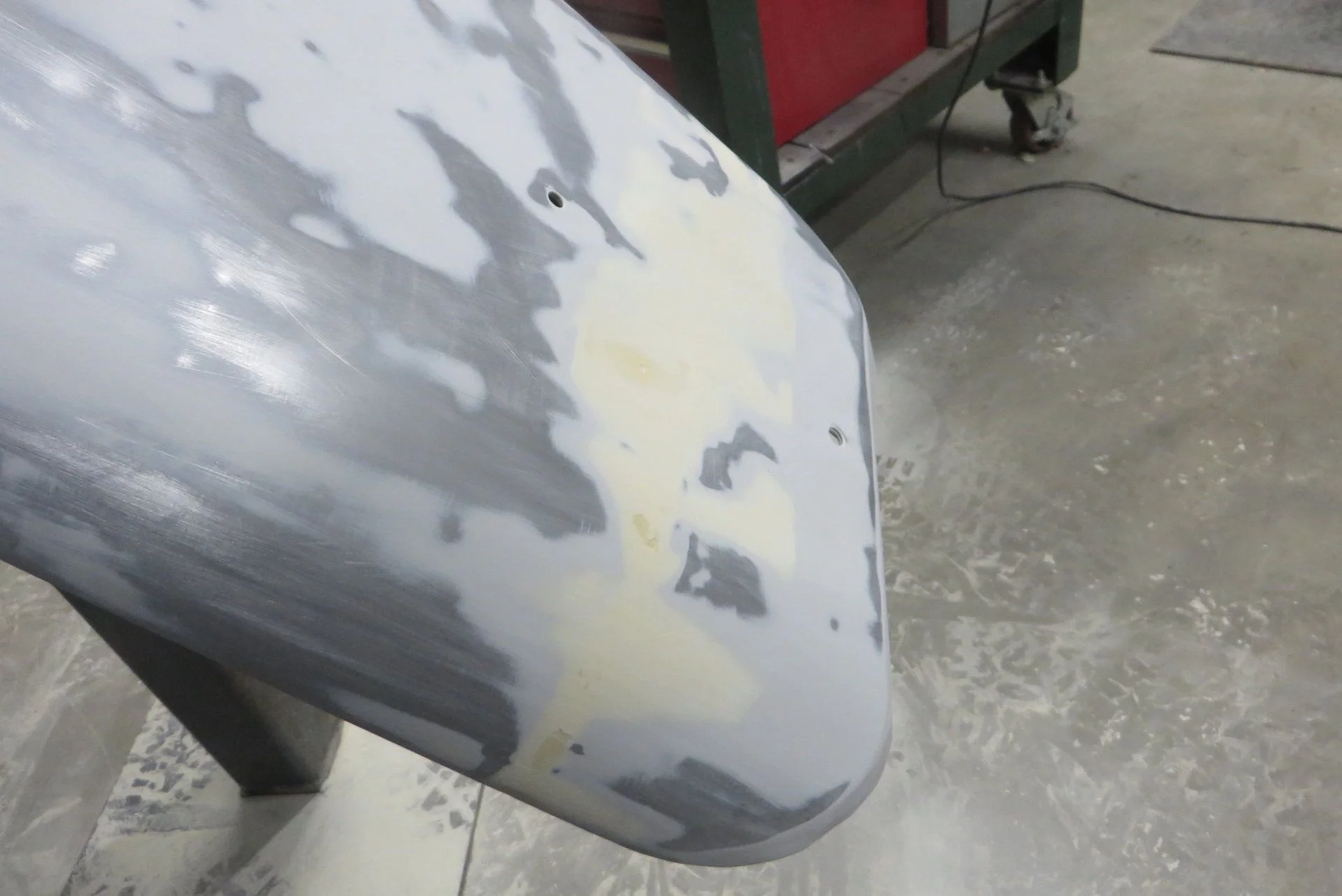

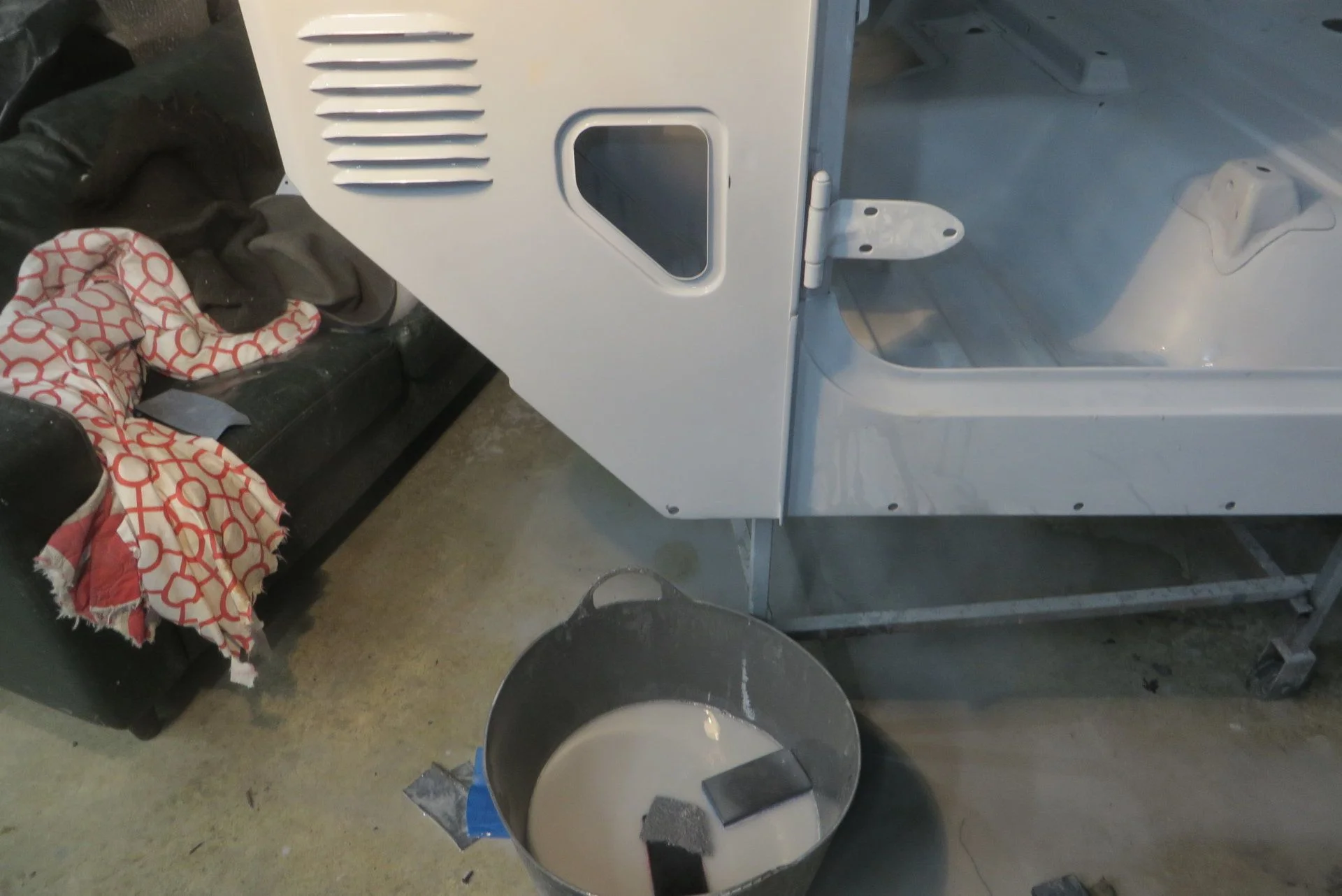

This is cool, if you have a state of the art sanding system. I don't - just a crappy old orbital sander! I dry-sanded the cab, guards, bibs, and front panel to 400 and wasn't overly happy. So I thought bugger it, and gave everything another coat of high-fill primer and wet sanded to 800 grit. It feels smoother.

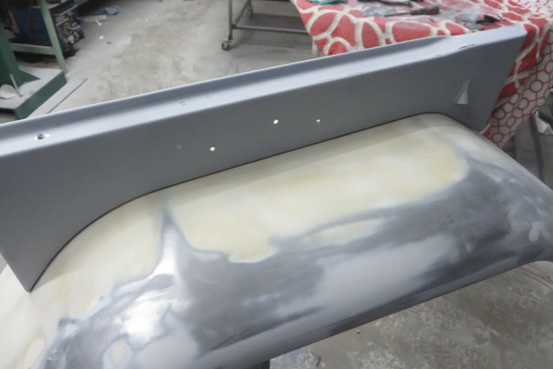

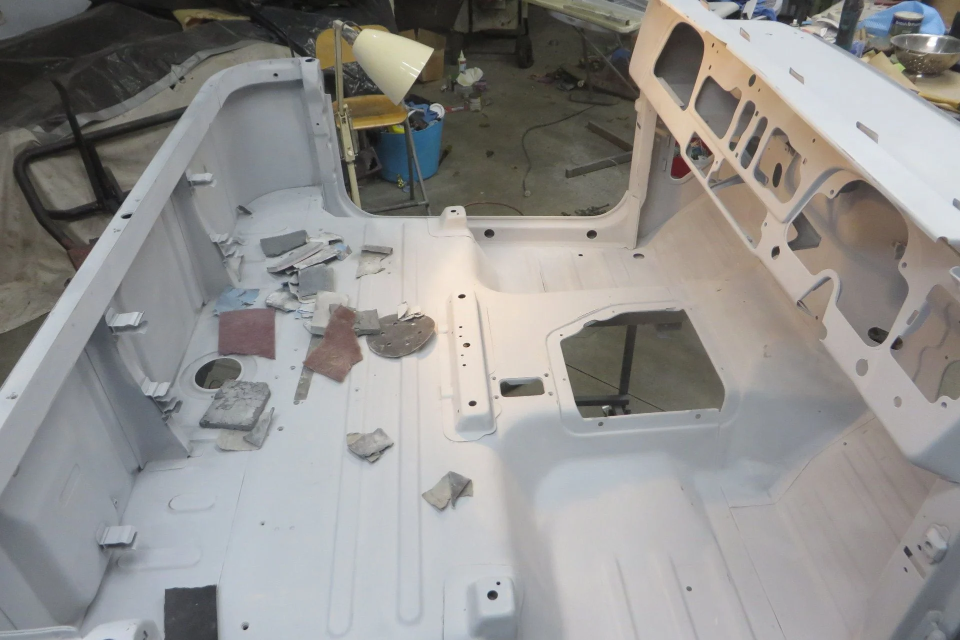

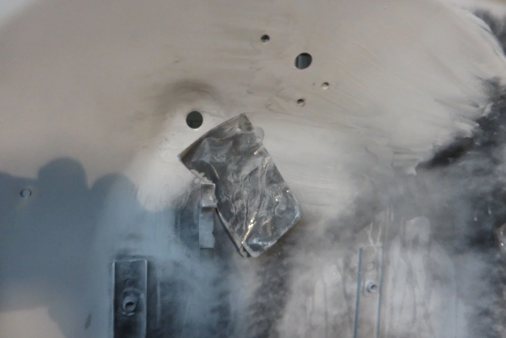

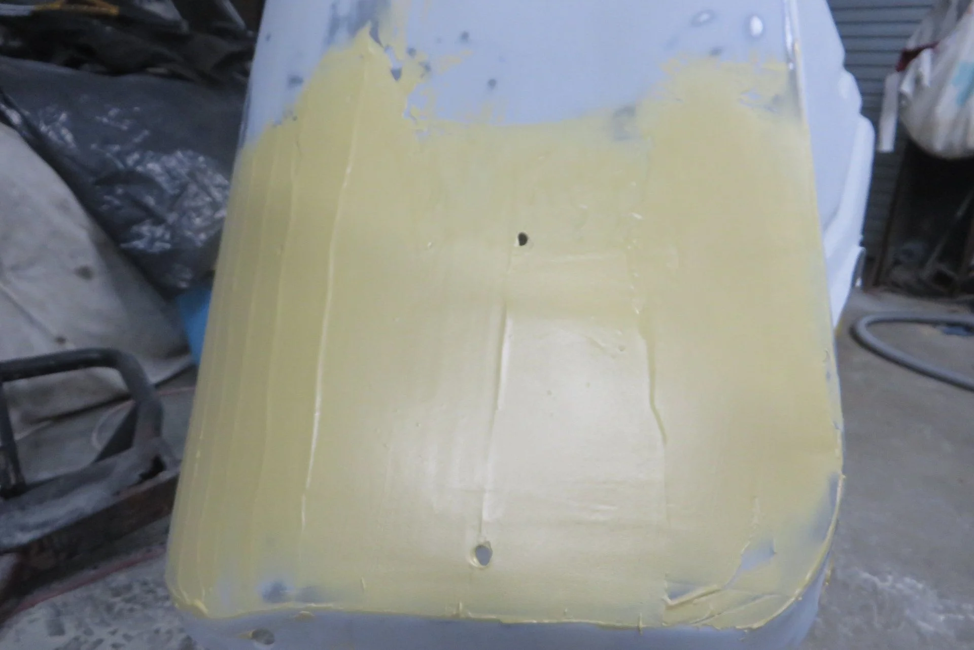

Here are couple of pics to bring you up to speed.

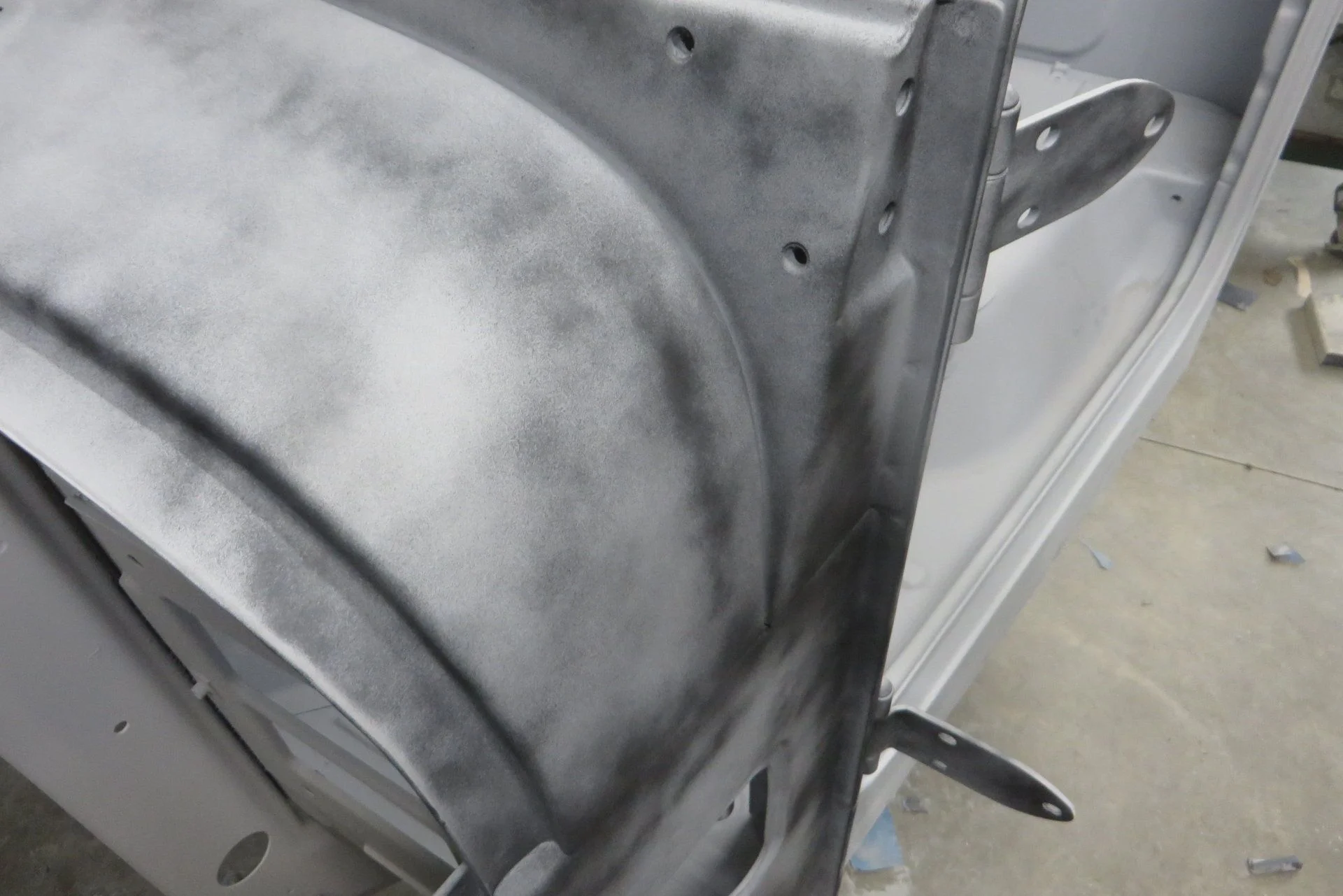

I then gave everything another coat of high-fill primer and started wet sanding. Wet sanding is a much nicer process, zen-like, wax-on wax off sort of process. Put on some tunes, no dust, no noise. Just a bit messy. The black stuff is a guide coat so you can tell where you have sanded. Some people just you a rattle can of paint for guide coat, but I found it gummed up the sand paper.
