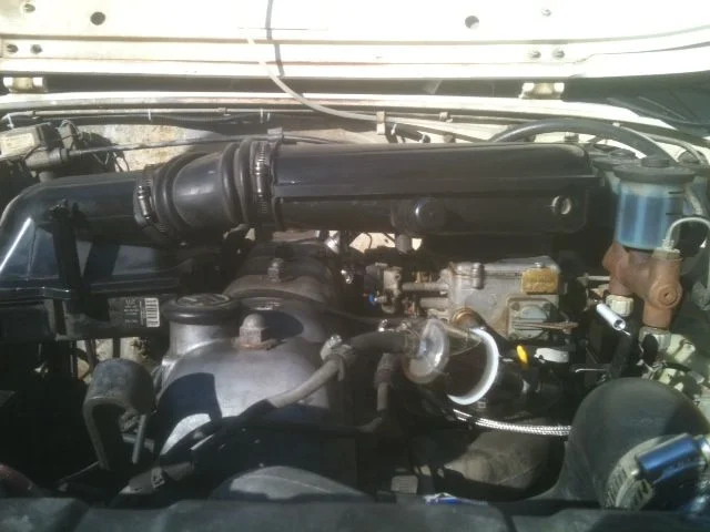

After doing a Motorcraft 2100 on my other 76' sbc 305 with great results and major simplicity I tried it on my second 76' 2f. So far it it runs great with no stumble and starts easily. I will post up mpg and a road test as soon as I register it.
1. Motorcraft 2100 2bbl with 1.08 Venturis,

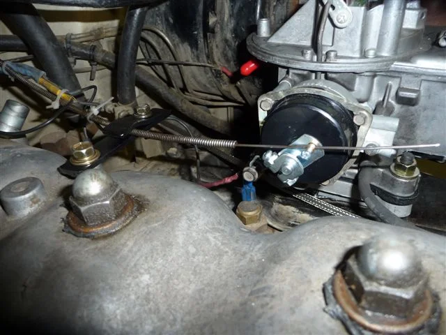

2. Stripped all auto choke parts off and went used the stock manual cruiser choke. Simple and straightforward.

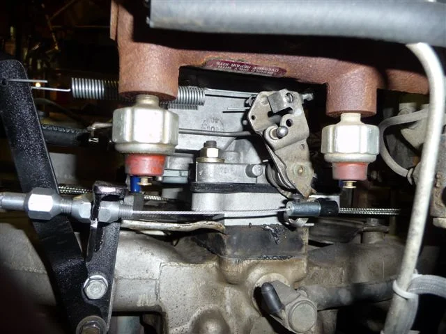

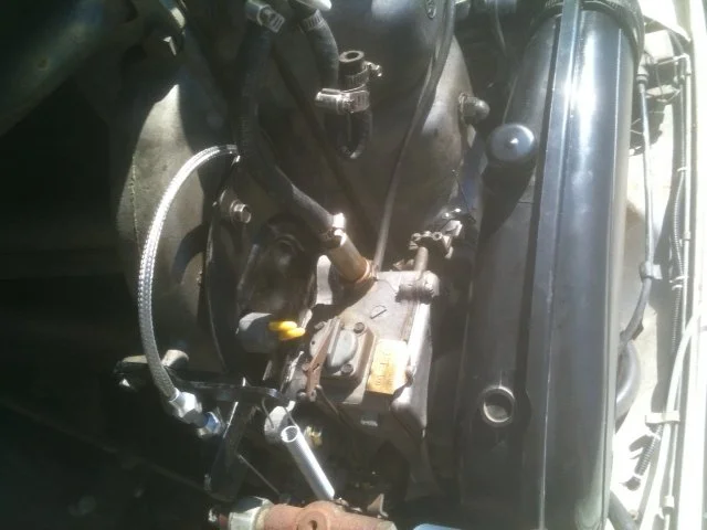

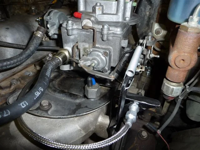

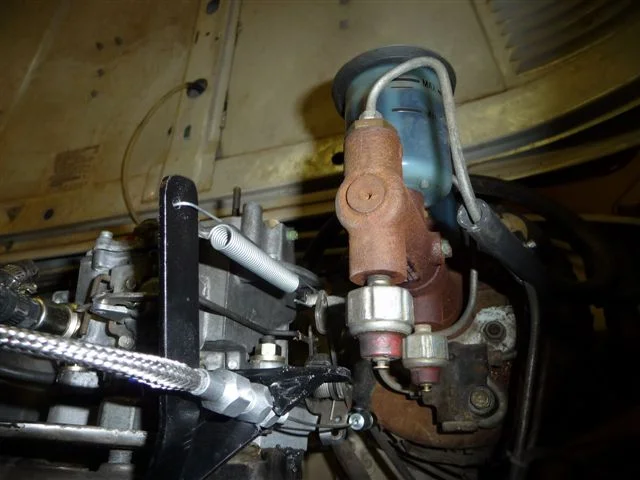

3. Removed all rod linkage from the 2f and drilled one 5/16 hole in the firewall and use a hot rod braided cable assemble. Very simple.( saved all oem stuff and can go back if needed) I postioned the braided cable in the front of the carb for a front pull and easy asccess and adjustment.
4. Motorcraft sits about the same height as Aisin so I used a 92'
Caddicalla Deville air cleaner. Simple to attach and gives plenty
of hood clearance.
5. Rebuilt the Motorcraft ( very easy with good instructions) and settled on using #47 jets ( I may drop down back to one #45 and #one 46 to lean it a bit. I will test with a Innovate 4wire
O2 sensor Air Fuel Ratio tester after I weld a bung into the header collector.

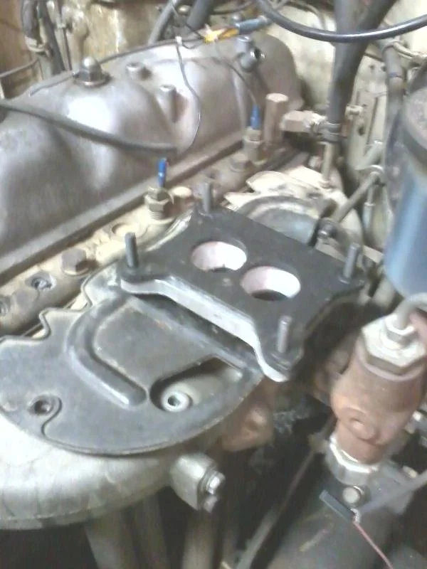

Holley adapter $30 Ebay

So far I'm pleased and have driven a few miles close to home with
Excellent throttle response and easy starts on cold days. ( I feel like I can pass someone now)

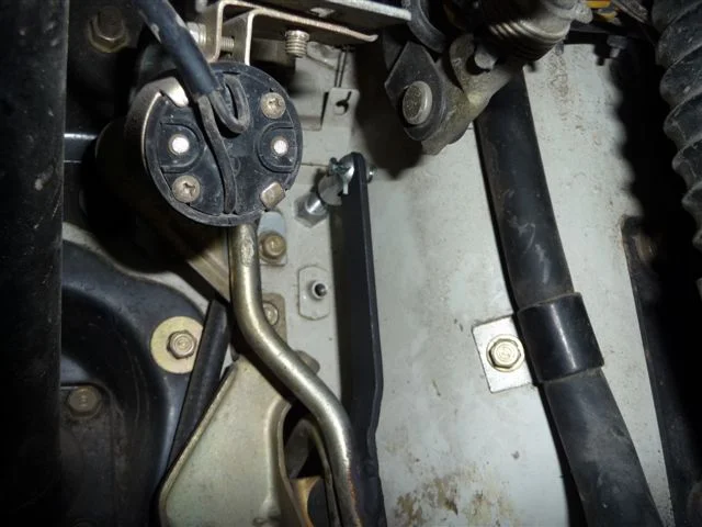

I welded a small arm to the existing pedal in the pic below and attached the cable to the arm.

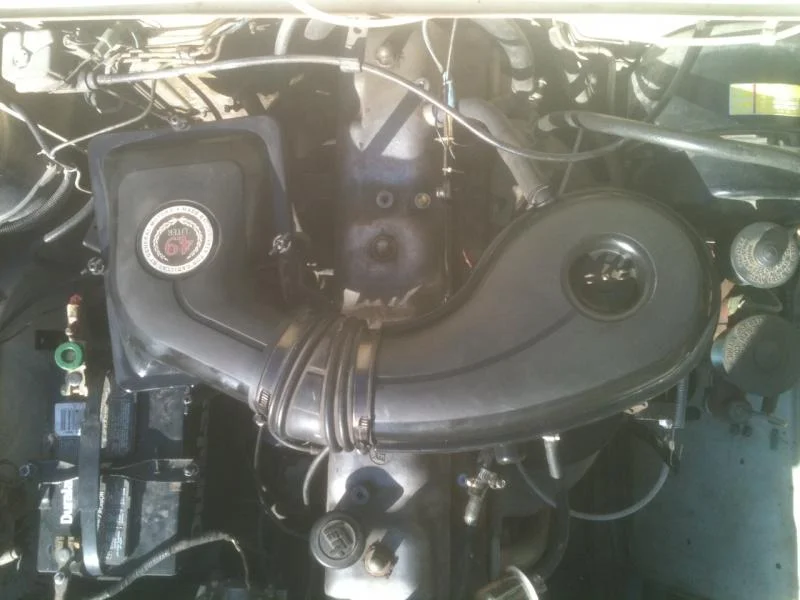

Id ran a shorter breather tube from the rocker cover to the airbox
and got rid of the longer one coming from the front of the air box( under hood pic last in series)

My buddy just dug one of these out of his parts stash for me. Is the adapter you used one of the trans-dapt ones with the slotted holes where it mounts to the manifold? I saw that summit carried those and was wondering if that's what you used.
