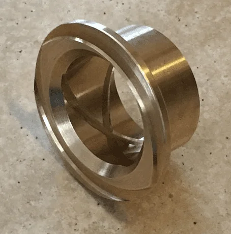

I was having the same issue and determined that the bronze bushings on the back of the spindle that makes the axle ride in the center were badly worn.
I have one side disassembled. I will take some pictures and we can talk about it at tomorrows meeting because I am not sure where that bronze bushing is at, and hopefully I can just reassemble it only once.
The bushing is pressed into the back side of the spindle:
The actual part looks something like this:
Those grooves in the bore should be about 0.080" deep. The ones in the face should be a little shallower. The groove's in Bush's were almost gone. Yours are probably similar.
Got it! I will bring those piece with me tomorrow.

Did you get it figured out? I ran the MC seals too, and they also did leak. If you're still apart, check the wear on the axle shaft. If It's grooved, its worth offsetting the inner axle seal. Also, that brass bushing has been superseded by a half brass bushing half bearing setup (I don't like the thought of tiny bearings, so I ordered replacement bushings from Cruiser outfitters.)
I haven't been driving it much, but I haven't noticed any leaks with my Toyota seals I installed. It was easy to offset using just a but socket to tap it in. Also I saw no grove worn into the shaft in the area it mates with the seal.
