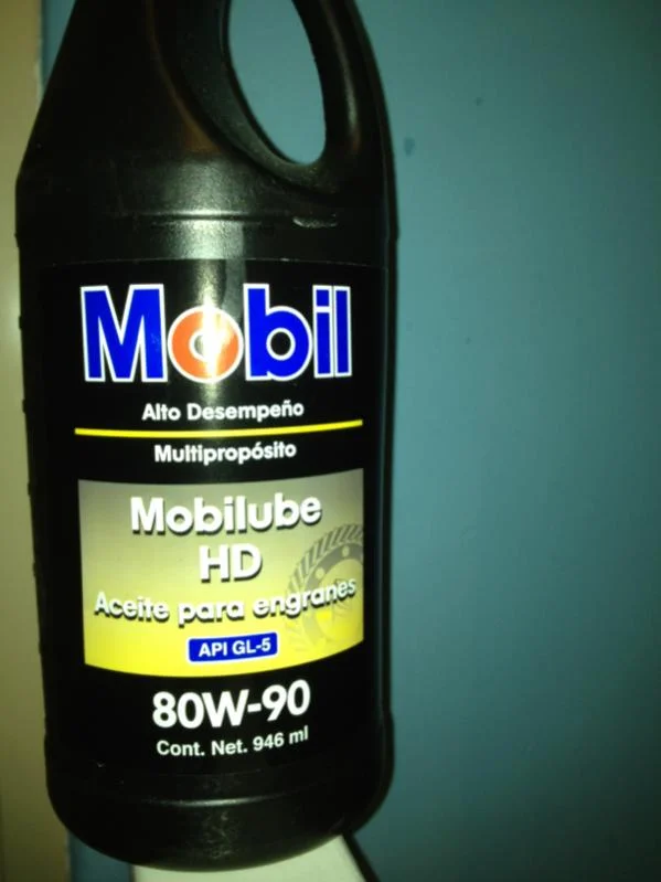

In my market I can only get Mobil 1 in dino.... no synthetic :frown:

Mobil 1 75-90 here is dino oil. (non-syn)

This is Mobil 1 dino
Sent from my phon
Looks like "Mobil" to me. Where do you see the 1?
Good point

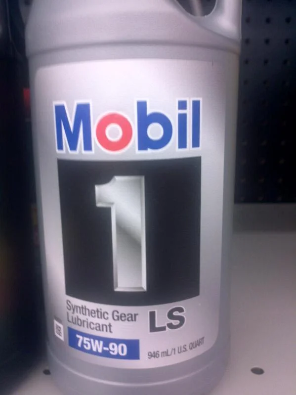

This is mobil 1 and it's hard to beat.

The mobil 1 contains a limited slip additve:
"Mobil 1 Synthetic Gear Lube LS 75W-90 contains special friction modifiers designed for limited slip-type differentials. In most applications, the addition of special LS (limited slip) additives is not required. For axles requiring the highest level of limited-slip performance, OEM specific LS additives can be added to this fluid."
