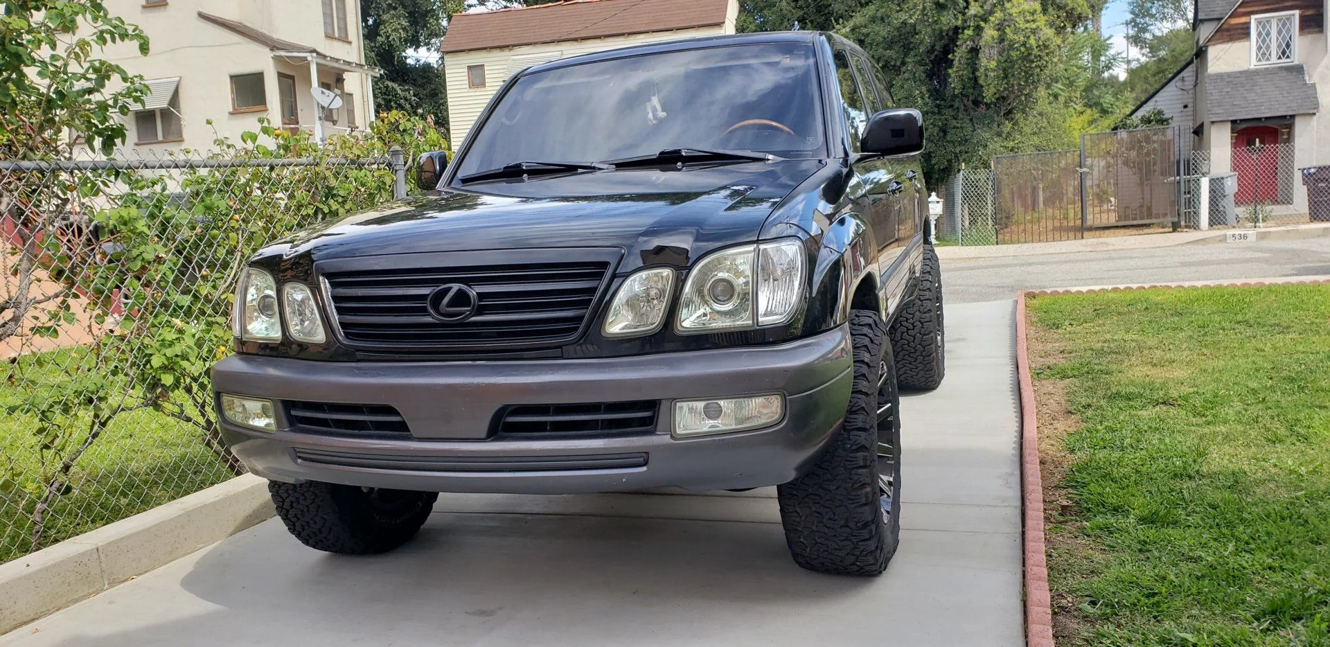

Hey guys so I'm curious if any of the 100 series guys cut their front bumper to gain more clearance. Here is what I am talking about, I got the idea from this 4runner:
So I did a little photoshop with the before and after of an idea on my LX470
What do you guys think?

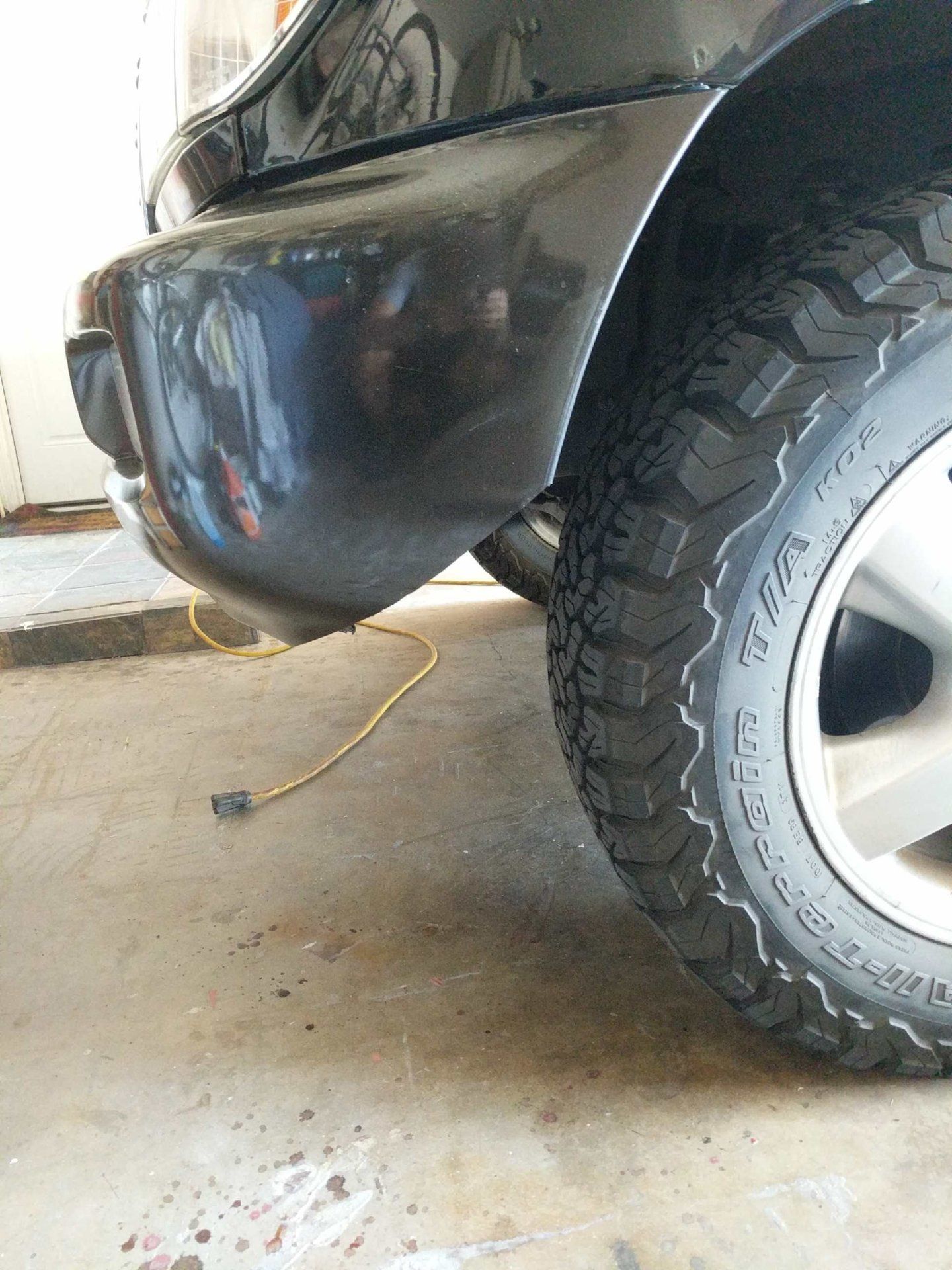

Yeah I'm slowly cutting to clear my new wheels and eventually I'll get there with the whole bumper. It needs to be repainted anyway. Let's see if I trust my cutting skills 🤔
When I trimmed mine I used a combo of a razor and a dremel with a (annular cutter?) I think. If I wanted clean lines I think I would tape some thin gauge metal to the bumper To use as a edge guide and just repeatedly go over The bumper with a razor.
I used a dremel to make the cuts and then a metal filer to file it clean. I also has a reciprocating saw that I just bought today.

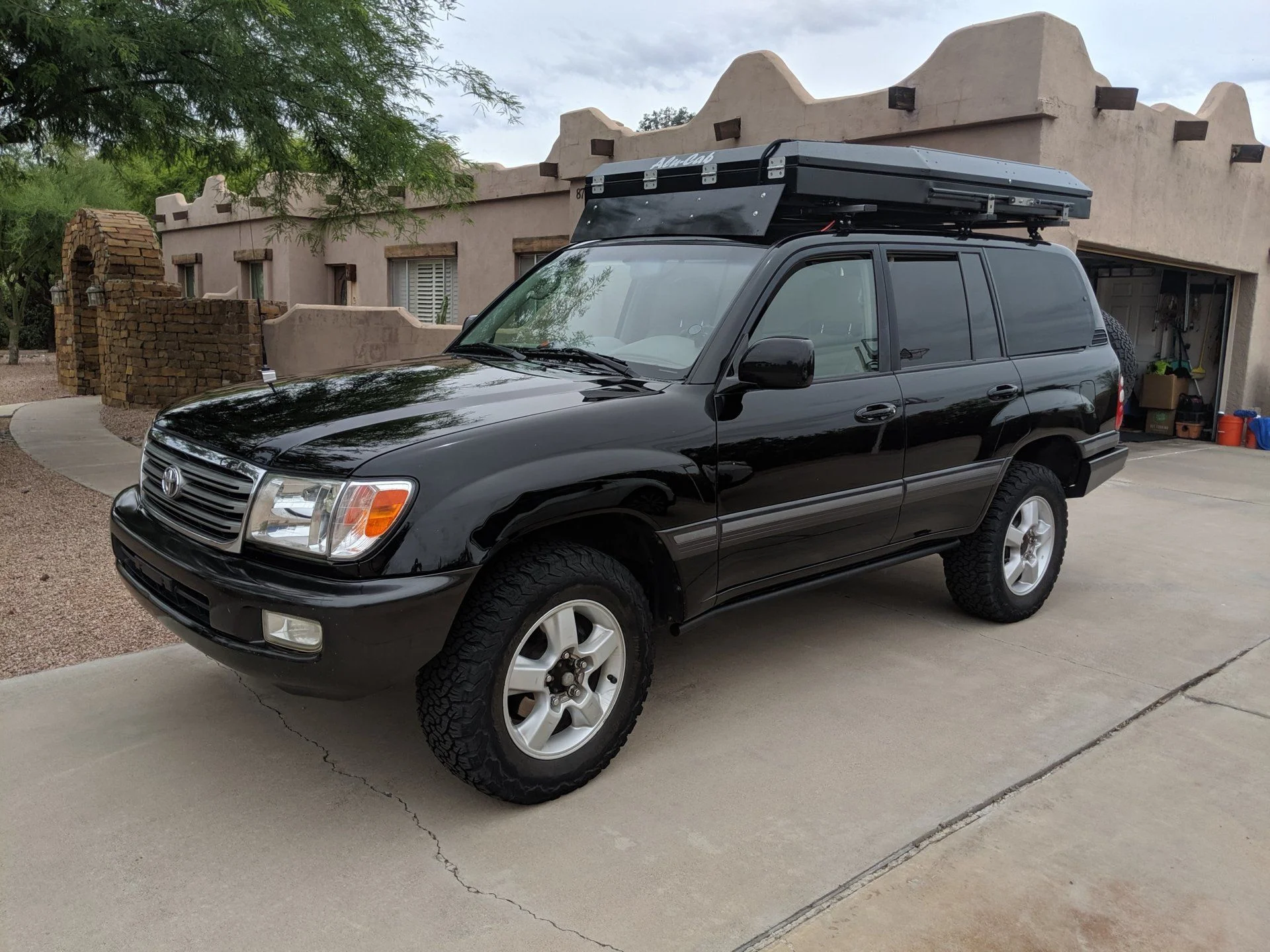

I used blue tape to cover the bumper and draw my line. I think I used a jig saw and filed the cuts smooth. It came out clean enough. I could've probably taken more off, but this seemed like a good natural line.
great job! I been wanting to do this since I got 285s. Nice to actually see what it looks like when it is done. How's the strength of the bumper after the cut?
Doesn't change the strength at all. It's just plastic. If anything, it's more rigid since there's less unsupported plastic.
