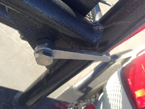

Thought I would post how I resolved this. I realize I'm probably the only one with an issue on how the basket mounts but might give someone else an idea.
Bought a stainless bolt that was 1/2 longer than supplied. My neighbor has a water jet shop and is my go to guru when I need oddball stuff. He came up with this idea and it works great. Cut out a handle and tapped it, and backed it up with a nut. Tightens down hard and can be removed at will. I realize this is not the cheapest route to go, but I like clean and finished looking stuff.
