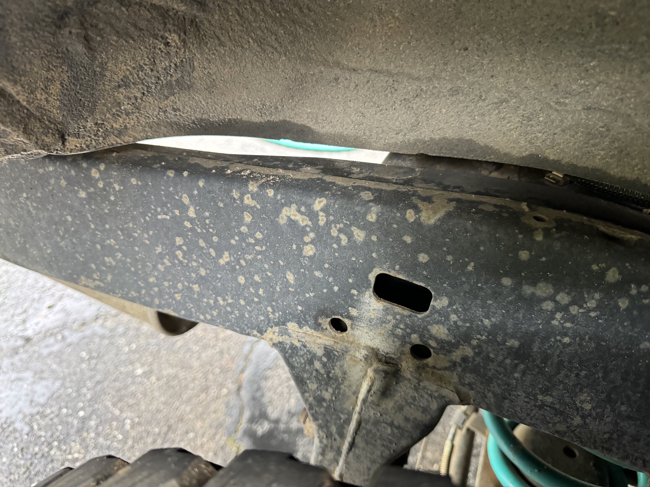

Here‘s a pic of the frame behind the rear passenger tire after cleaning.
I‘m kind of tempted to not do anything to it…
1999, 280k miles in CA…
I have found Por 15 to be excellent and extremely durable. Painted the frame of my 40 sometime in the late ‘90’s & it has held up very well.
@GerLC100 your frame picture in post 10 looks excellent, depending on what/where your future plans are, it doesn’t really need a coat of anything. But a coat can’t hurt…mine?? I’d put some Por 15 on…personal choice.

Yep, I think this is what I'll do. Just stay in the POR system with metal prep and then coat a layer... it will surely not make it worse and the frame looks like it's keeping up another 25 years :)
