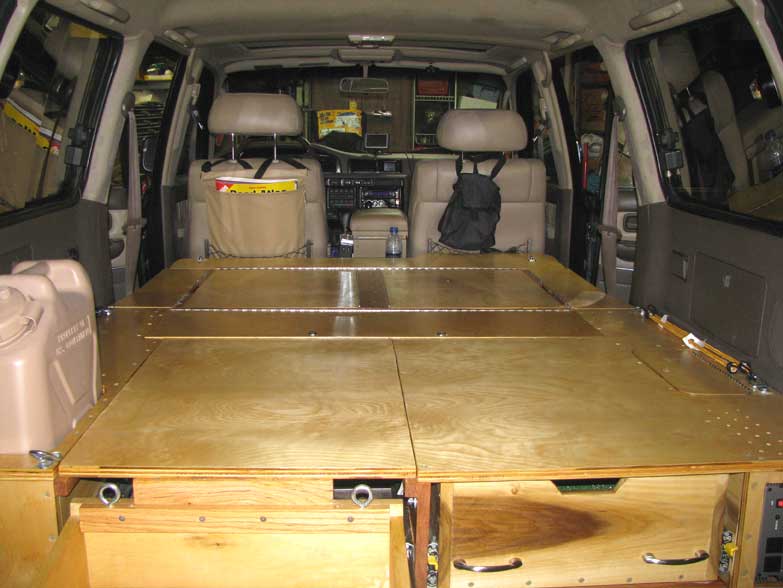

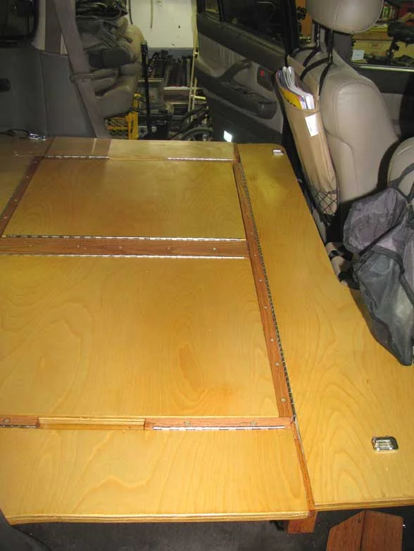

I'm 6'2" and can sleep comfortably in our truck with the drawer/sleeper conversion I built. The left drawer show here actually carries the fridge when in use. The drawer slides back to the tailgate and the panel you see over the space it occupies in the drawer fills in the hole it leaves, which is handy to use when dressing or otherwise stuck inside due to weather. We also use a tailgate tent and it covers things well.
The pic above here show the front of the sleeper. I made the front flap longer on the PS so that I can fit better, it's 6'3" in length to the front lip when down like this. This is with the PS front back where my wife is comfortable riding. You may need a couple of more inches, which can be obtained by sliding the seat forward all the way, so you should fit.
The pic above shows how the front and side flaps fold to act as a bulkhead when on the trail, very handy for when you go places like Colorado.
The last pic shows the fridge slid back as it would be when the sleeper is in use.

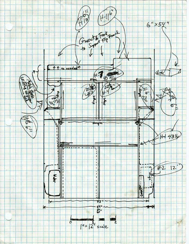

It's a plan, maybe more like a conceptual sketch, but here's what I went by when I built ours.
This was built in two sections, the one that goes in the second row and then everything behind. I used on of my drawers for a fridge slide, as seen in pics above.
If you plan on using it seriously, consider your deck height carefully. You taller than me, but not by much. Note how low my deck height is, 9.5". This is the height in the rear cargo area and, the surface being level of course, is deeper in the 2nd row area. You do lose some storage if you go lower. We have a trailer, so doesn't matter so much. If you don't have a trailer, then you likely need more underdeck storage, but too cramped above everything make a poor camper/

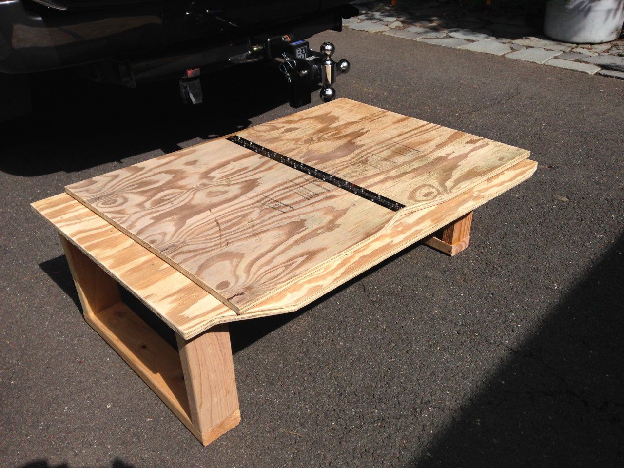

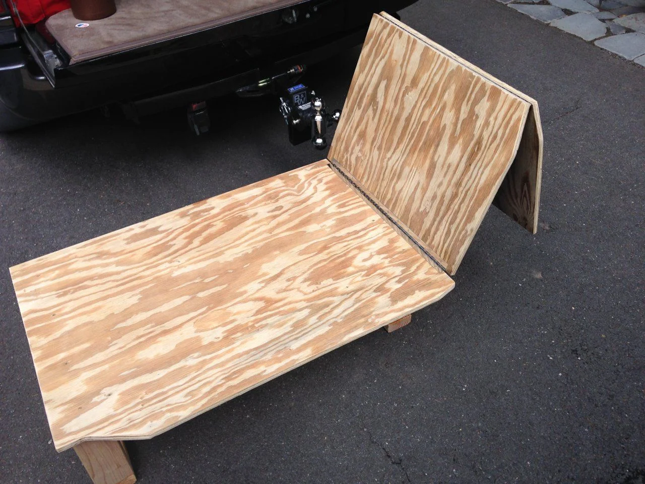

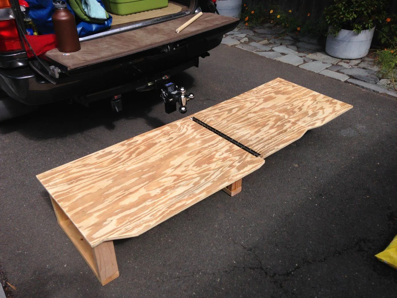

This is my five minute install sleeping platform. It is great for car camping, pulling over for a few hours sleep on an all night drive, and comes out easily if I need to haul cargo or put the third row seats back in.
  1. Converts to bed in just a few minutes. Just fold middle row pass. seat over and the platform extends and rests on the folded seat.
  2. 78" long with hatch closed.
  3. End by front seat is supported by single leg support to floor. Anchors to floor using existing cargo hooks in floor (still working out the design).
  4. Mattress is full length chaise lounge cushion I found at end of season clearance at Lowes for $20. Finished wood sleeping surface is carpeted.
  5. A good nights sleep is only minutes away :). The above suggestion for screens and magnets works GREAT!
