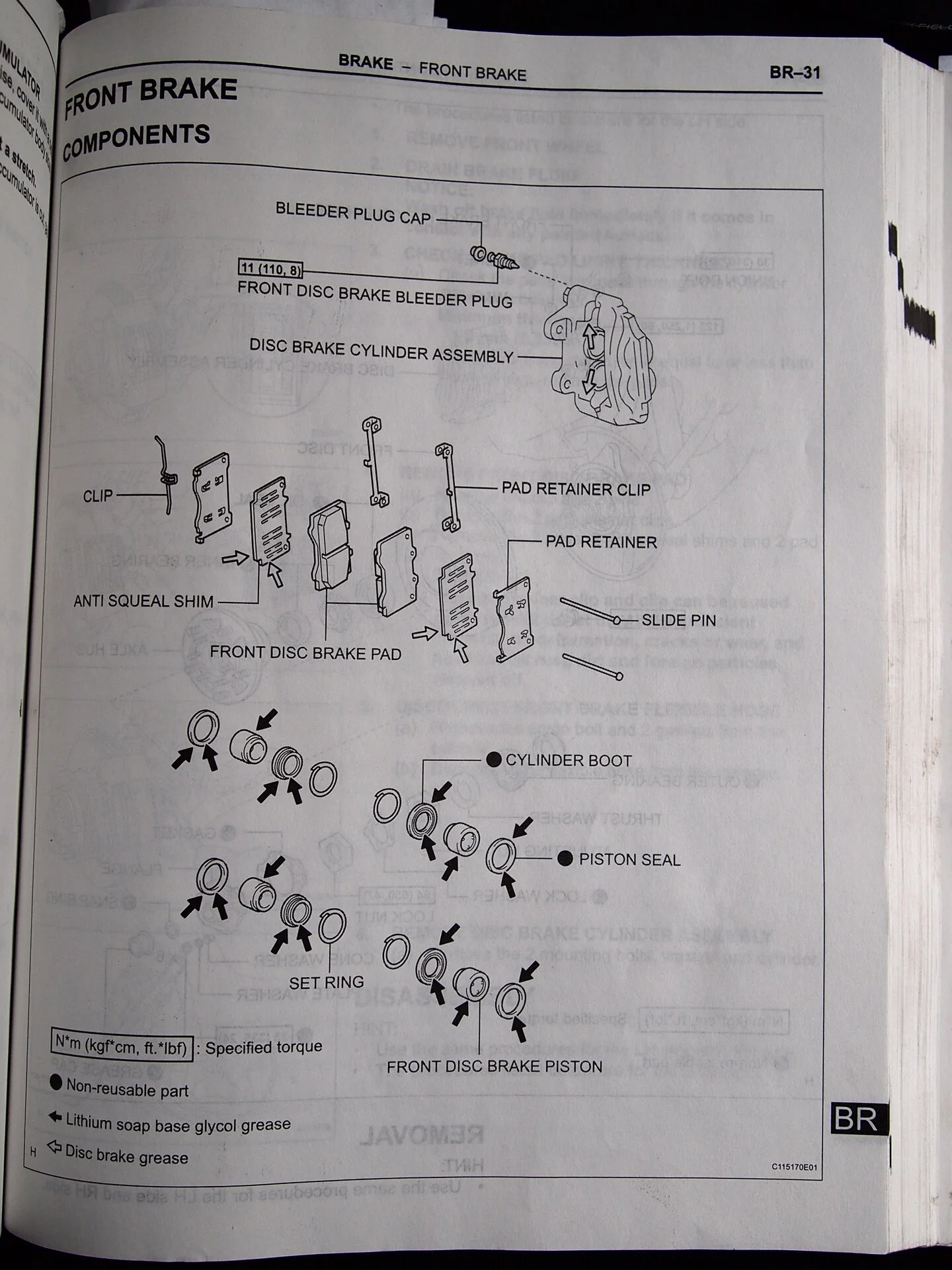

Since "I thought was the pads rattling, maybe I put an anti-rattle clip in wrong or something" . I give some frt brake assembly info.
While looking at pads. Make sure the Pad retainer, clip into pistons snugly. Be mindfully 100 series have two different anti squeal shim kit sizes. 98-02 (smaller caliper piston) and 03-07 (larger).
I clean the caliper, where pads fit at bottom and top (ends of metal backing of pads, almost touches caliper). I use a metal brush and file to clean those points. The anti squeal shims, should be greased (disk brake grease) on both side and hooked to pads. The Pad Retainer then clips into the caliper pistons. I like to use a degreaser soaked shop towel on rotor at this point. As it is last chance to clean inner rotor disk of grim, that I may have smeared on while installing pad retainer. The pad with anti squeal shim affixed, is then slipped into caliper and clips of Pad retainer at the bottom (inner side). Pad, anti squeal shim and pad retainer are held/sandwiched together, by pad retainer clip at top (outside). Then anti rattle spring goes between pads, held in by bottom slide pin.

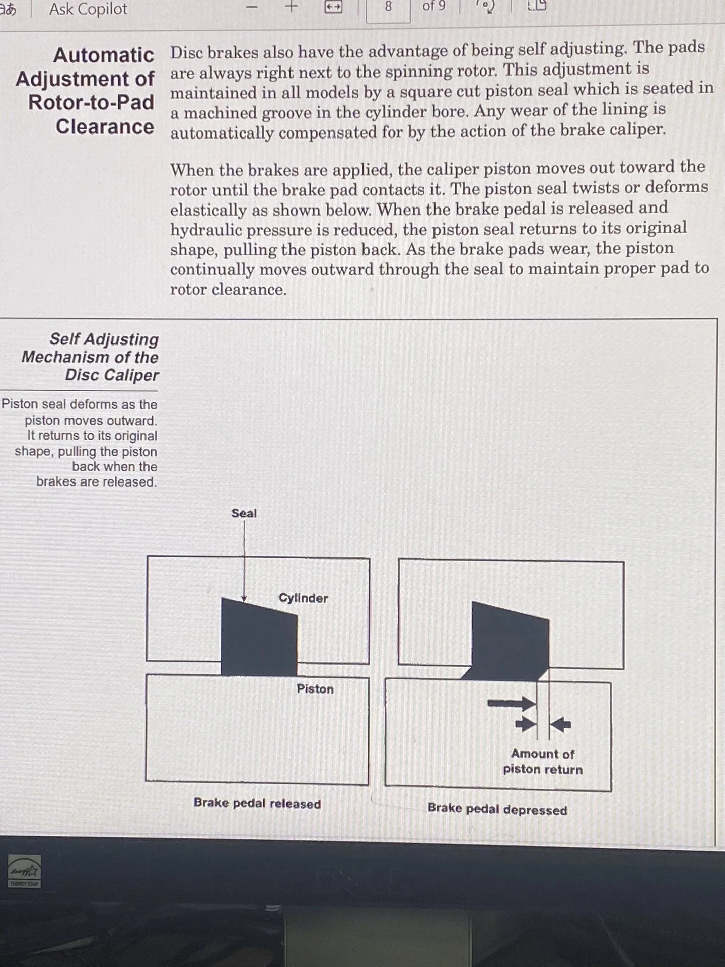

Note:. The piston seal, pulls piston back when brake pedal released. As such pulls pads off the rotor via the pad retainer clipping into piston.

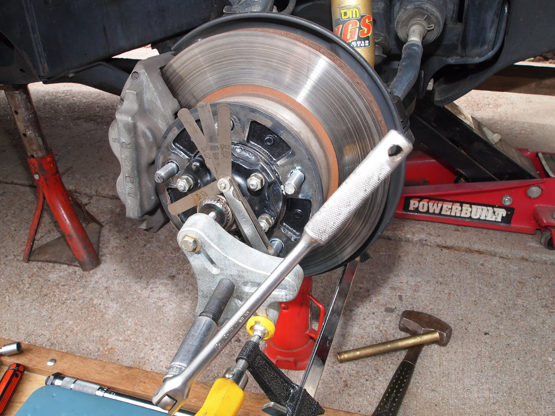

Additionally the wheel bearings must be tight. You can not have "ANY PLAY" (12 & 6 o'clock test)

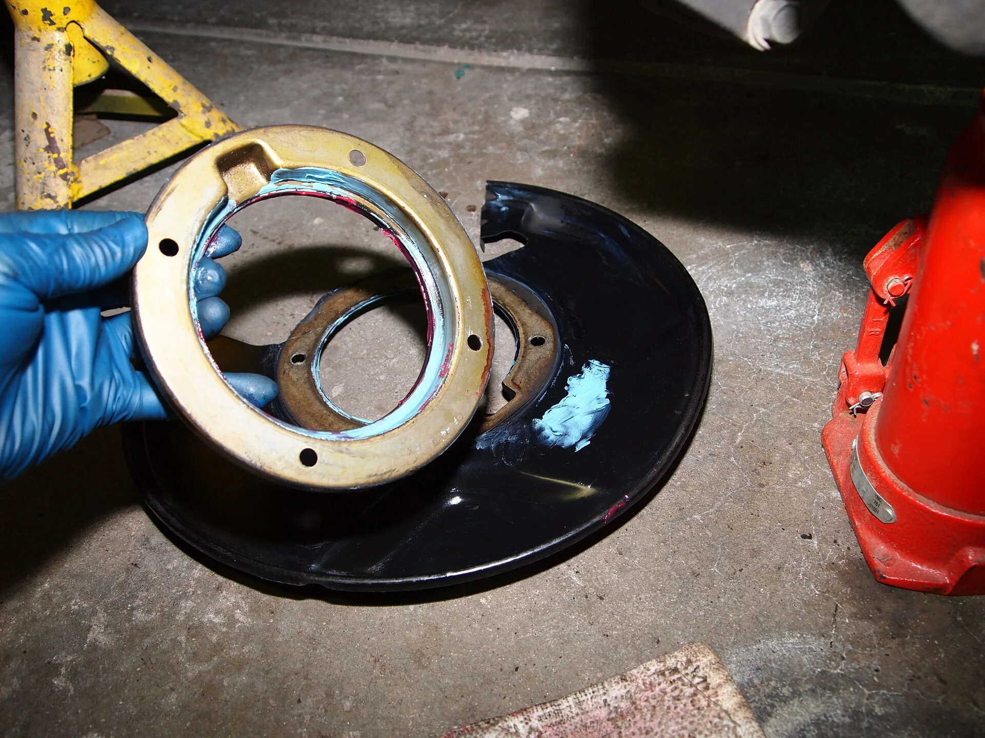

FDS inner and outer dust shields, must not be bent. The outside dust shield is very easily bend in shipping or from touching LCA when steering knuckle is off.

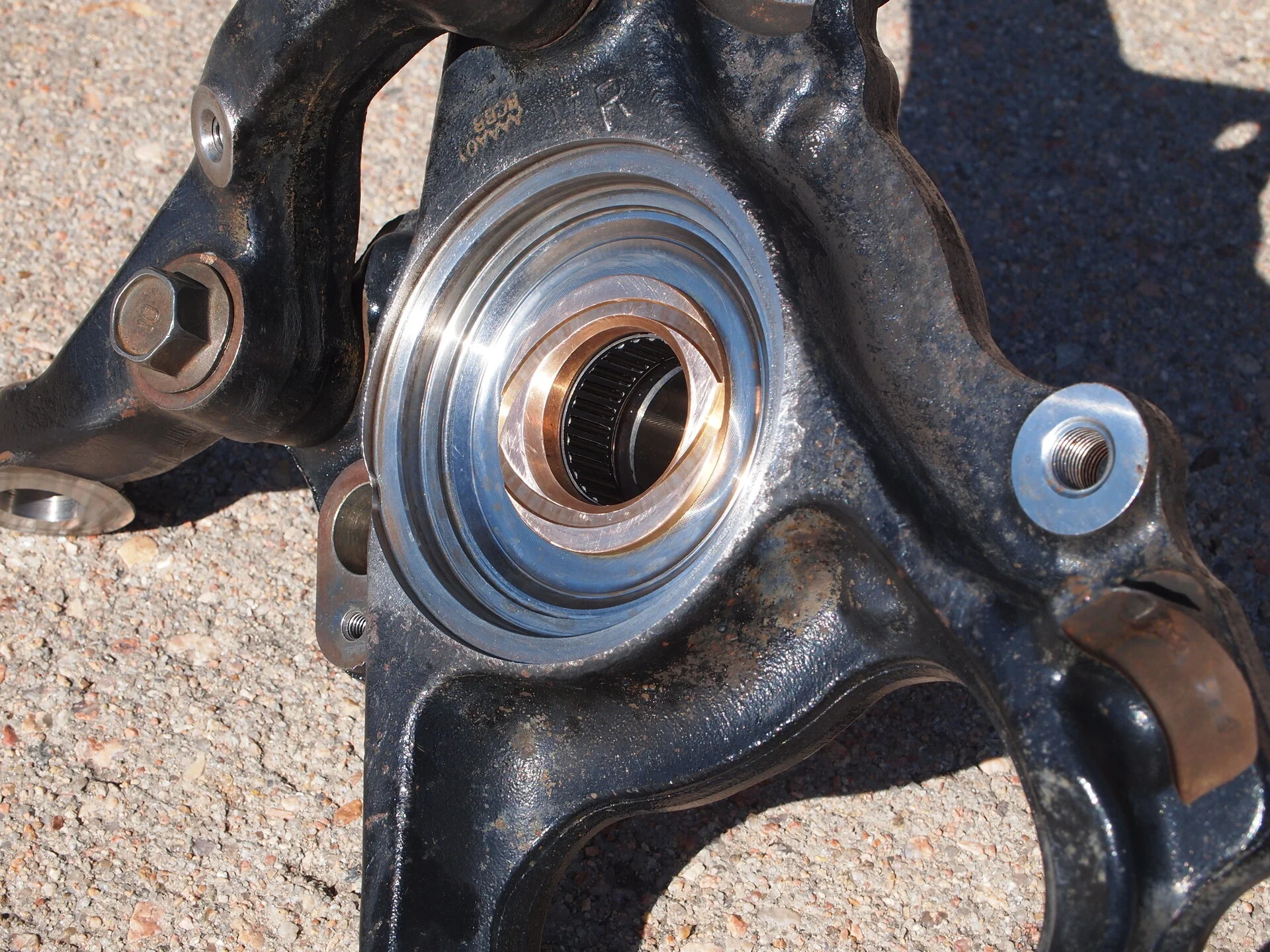

Needle bearing and brass bushing need lubing every 30K miles.

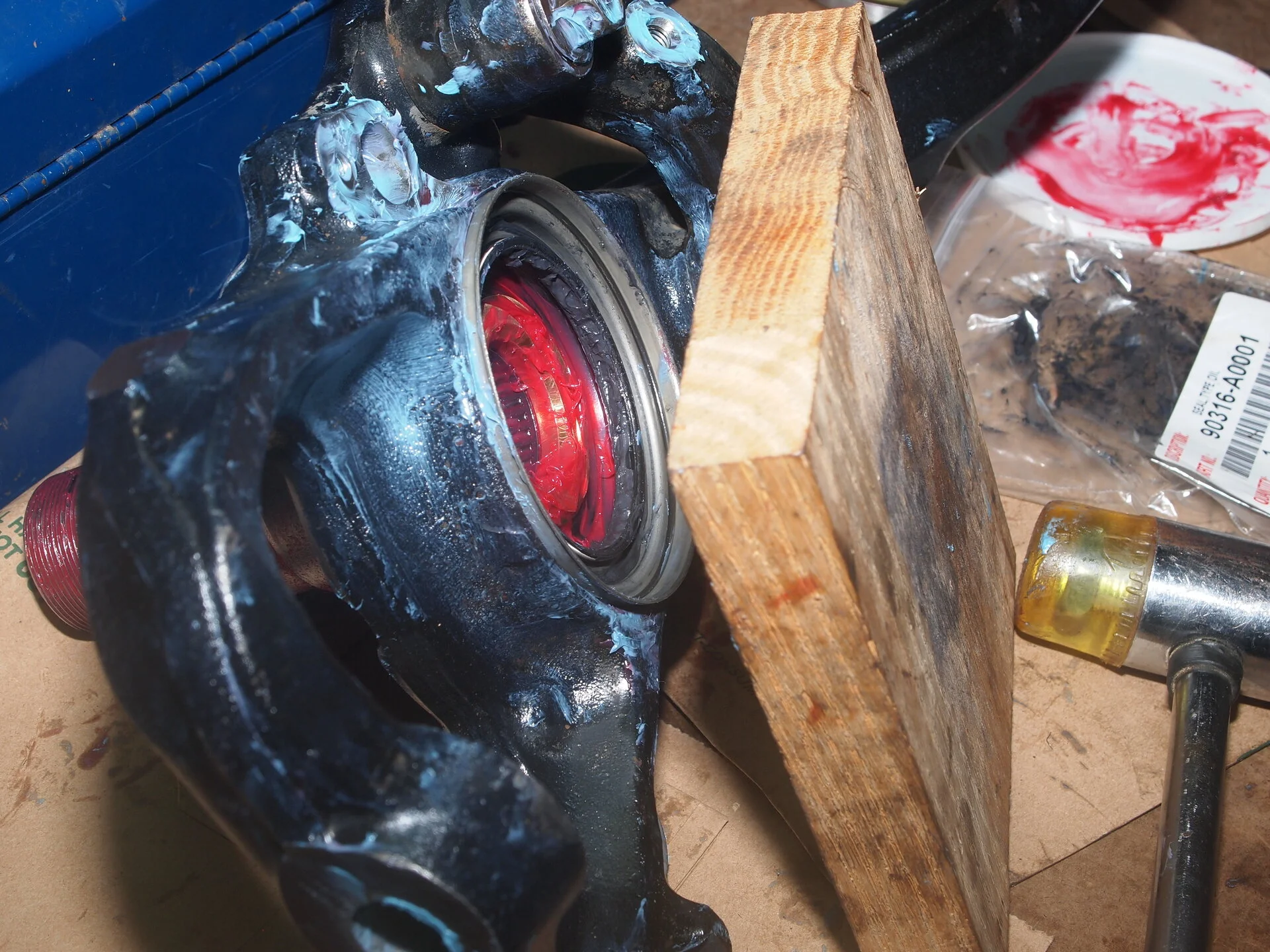

Kunkle oil seal must be seated and also not bent.

Brake dust shield and it's hub seal must also be in okay condition and not bent.
