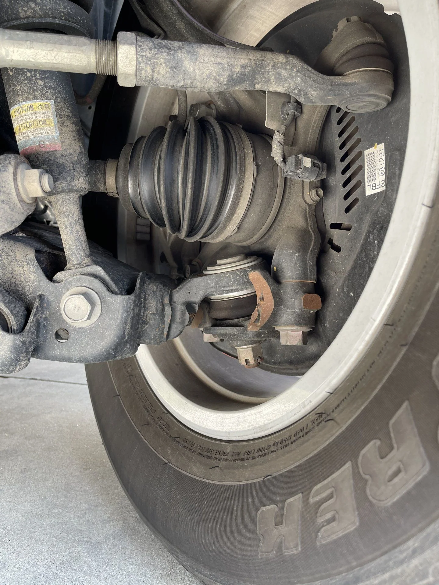

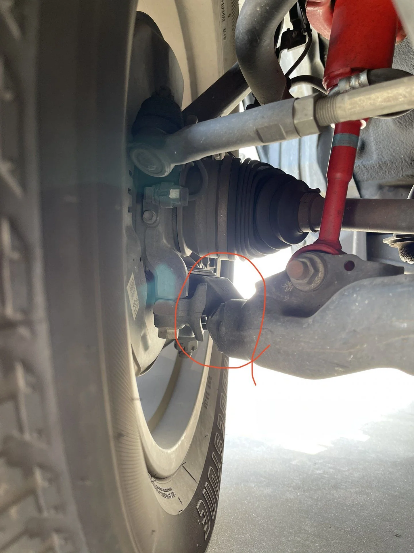

2019 LC makes a clunking noise when making a tight turn (wheels are fully turned) and going over a bump or pothole.

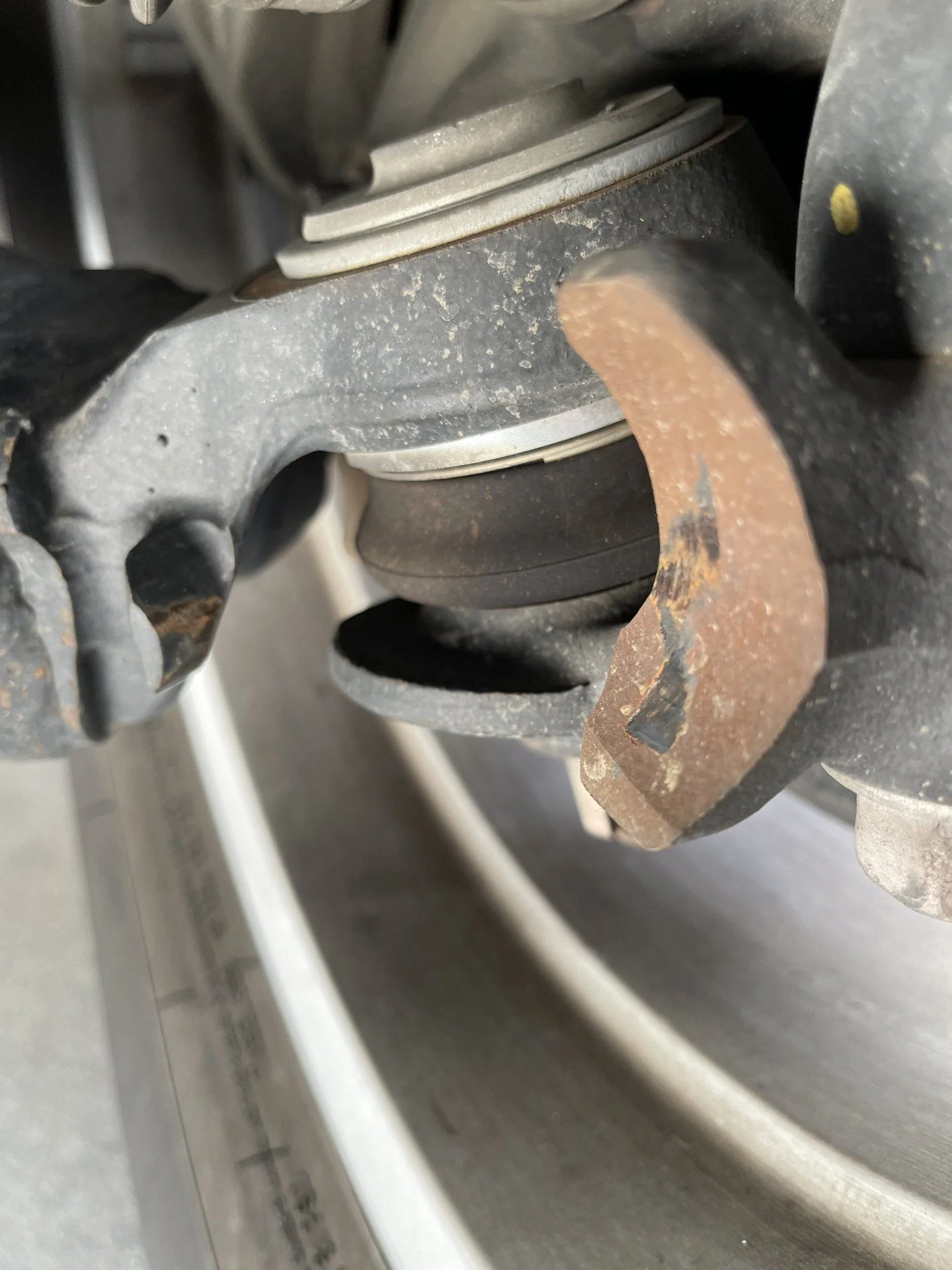

I figured out that the noise comes from the metal stop as the suspension moves up/down.
Picture attached, showing the scratch.
Is this normal?
Yep, you can put a little grease there as well. Also common for it to creak at full lock when hitting a bump.
I checked my 4Runner at full lock and the metal stops don’t make contact. I wonder why it’s different between LC and 4Runner.
Slightly different adjustments. Toss some grease on there and smear it around to cover the surface on the knuckle and you’ll have no more issues.
