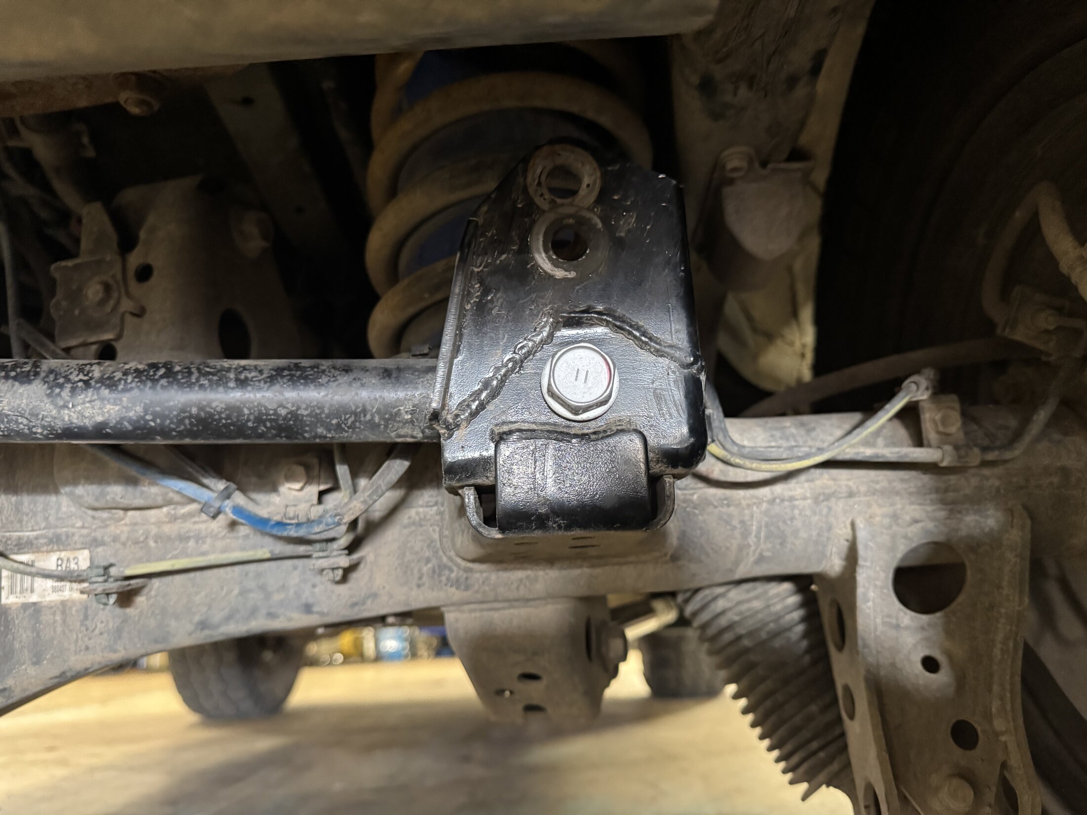

LX570 feels unstable on freeway and clunking noise
Tek. I’m running a low lift. Probably 1.5” 35-12.5-17s
I put mine back together stock location tonight and on the drive home it feels like it always did.
I know the pck is a common mod. However if yours isn’t broke don’t fix it. I’m back to the original location and it’s perfect again.
Edit - also the PCK caused my panhard/ track bar to contact the LRA fuel tank mounting bolts enough it might have bent it. Definitely gouged it
Thanks for the feedback and I think you're right. If it feels good, it is good and probably doesn't need "fixing".
Or should I push the lift to 2". :)
Hi folks, I did the same, went to a Dr KDS and also did a adjustable panhard bar. Ended up with the sagita bad. Replaced back to normal. No
Change, replace rear shocks and globes, still have it but a bit less with the occasional clunk too. Any ideas. Mine comes in around 57-65 once it gets going can be a bit dicy too.
For posterity have you checked your sway bar links?
