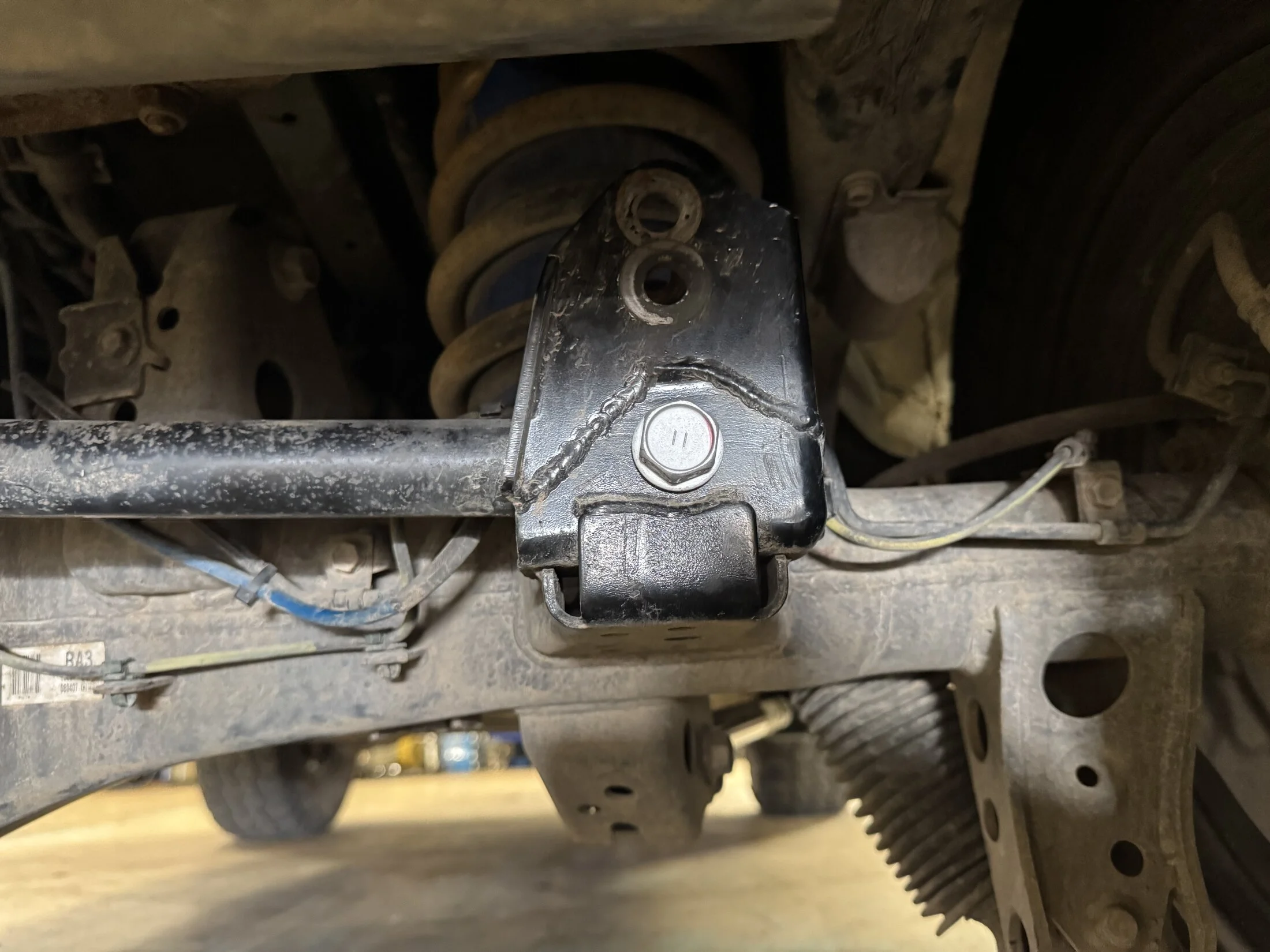

Hi all,
My 2013 Lx570 feels unstable on the highway. Feels like the rear end is loose. Any thoughts?
There is also a clunk sound going over speed bumps almost like the spare is hitting something. I removed the spare but same issue.
Sensor lift with spacers in all 4 corners and panhard bar correction installed.
Thanks!

Did the symptom start after the PCK install? Which PCK do you have, Eimkeith or DrKDSS? And which bolt position are you running?
How much total rear lift (sensor and techstream offset) do you have?
Max AHC sensor lift in the rear with full sensor slot adjustment and techstream adjustment is ~1.5". The minimum PCK relocation is ~2". So the PCK will generally overshoot the amount of correction even at max AHC sensor lift.
If you're much less total lift sensor, the relocation might create more sagitta / side to side motions than it solves. If you're running the top bolt position (~3"), that will be much much more correction than necessary and definitely create issues.

Yes. Even moved down to the middle hole and it helped “some”
Good info in the post below the one I’m quoting.
Mine is the weld on bracket that’s pictured In teks post.
I tried the top hole first, terrible. On lower hole now and it still drives less than good.
Going back to the factory location soon.
I’m on a very small lift. Maybe 2”. I’ve made an effort to keep mine very low.

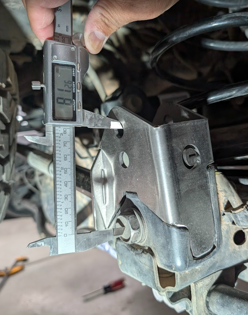

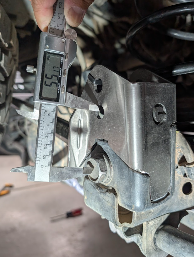

Curious how much lift you had?
Asking as I'm about to install mine. With a 1.5" sensor lift, I'll be overcorrecting by .5" and wondering if that's going to create more issues than it solves.
A little history, when I previously lifted 1", I still had great side to side stability. Once I bumped that up to 1.5" sensor lift, I could tell the stock geometry had more sagitta, with more side to side motion on big bumps. Still not bad, but if really paying attention, it was there. More-so when towing with 1200 lb tongue weight as that uses more suspension travel on the same bump.
Interestingly, as I go up in tire size with more sidewall, the lateral movement is no longer there as the sidewall absorbs all the sagitta.
So back to my question, my rig handles really well at the moment, so wondering if I really want to do this.
Ok update:
I took out the dr kdss kit and put it back to factory. Good news is that that issue went away. Bad news is I now have a terrible noise but only on low and normal, not on high mode.
I did drive it like 15 feet to a flat area with everything disconnected. Hopefully didn’t mess anything up.
Tek. I’m running a low lift. Probably 1.5” 35-12.5-17s
I put mine back together stock location tonight and on the drive home it feels like it always did.
I know the pck is a common mod. However if yours isn’t broke don’t fix it. I’m back to the original location and it’s perfect again.
Edit - also the PCK caused my panhard/ track bar to contact the LRA fuel tank mounting bolts enough it might have bent it. Definitely gouged it
