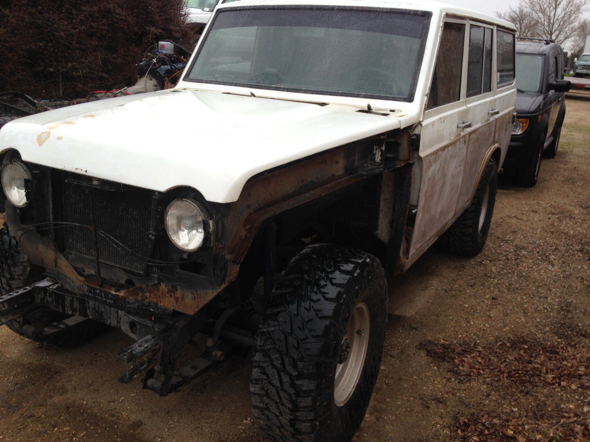

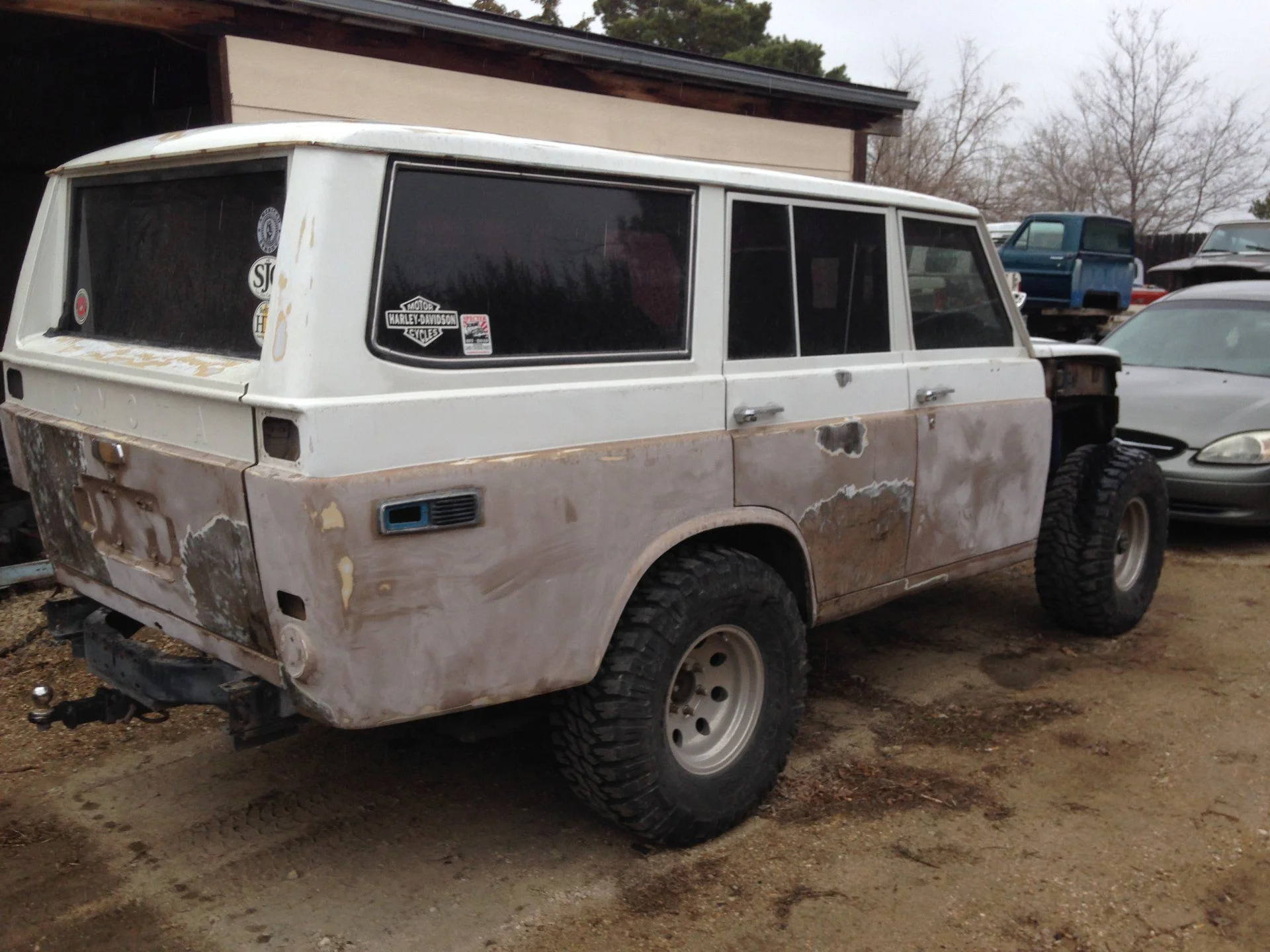

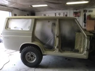

In 2015 Kaleb and I decided to do a freshen on Marv - thought it would t6ake about 90 days. However project creep began almost immediately "If your gonna do it might as well do it right"
I had a OEM set of front fenders, and thanks to the talent of Bob M was able to get rear corners done right.

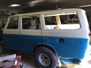

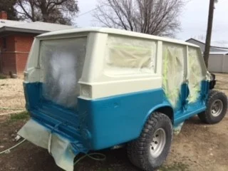

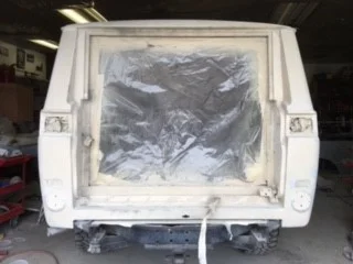

We decided to return Marv to his original smurf blue color - all metal was replaced not bondoed.

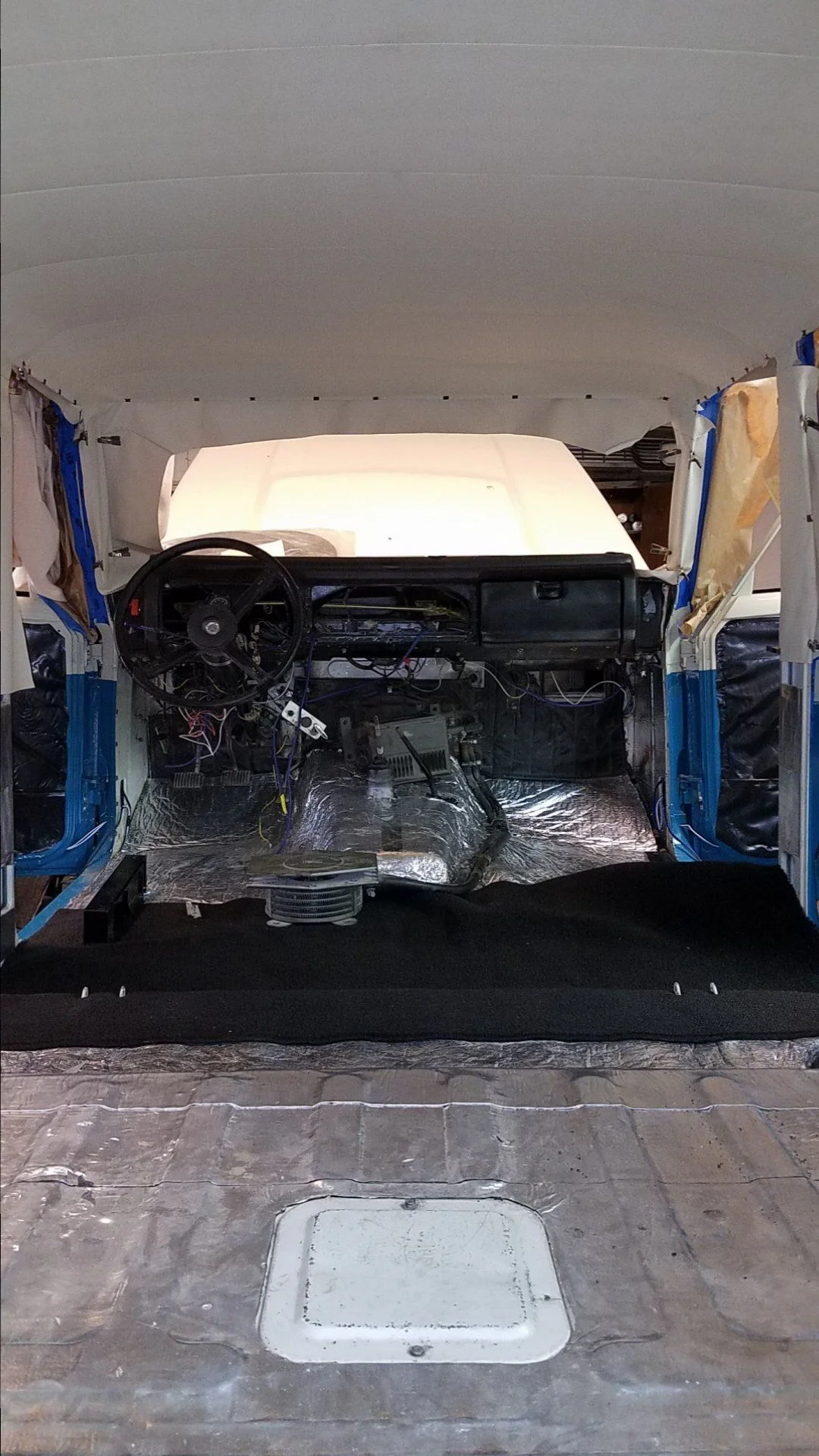

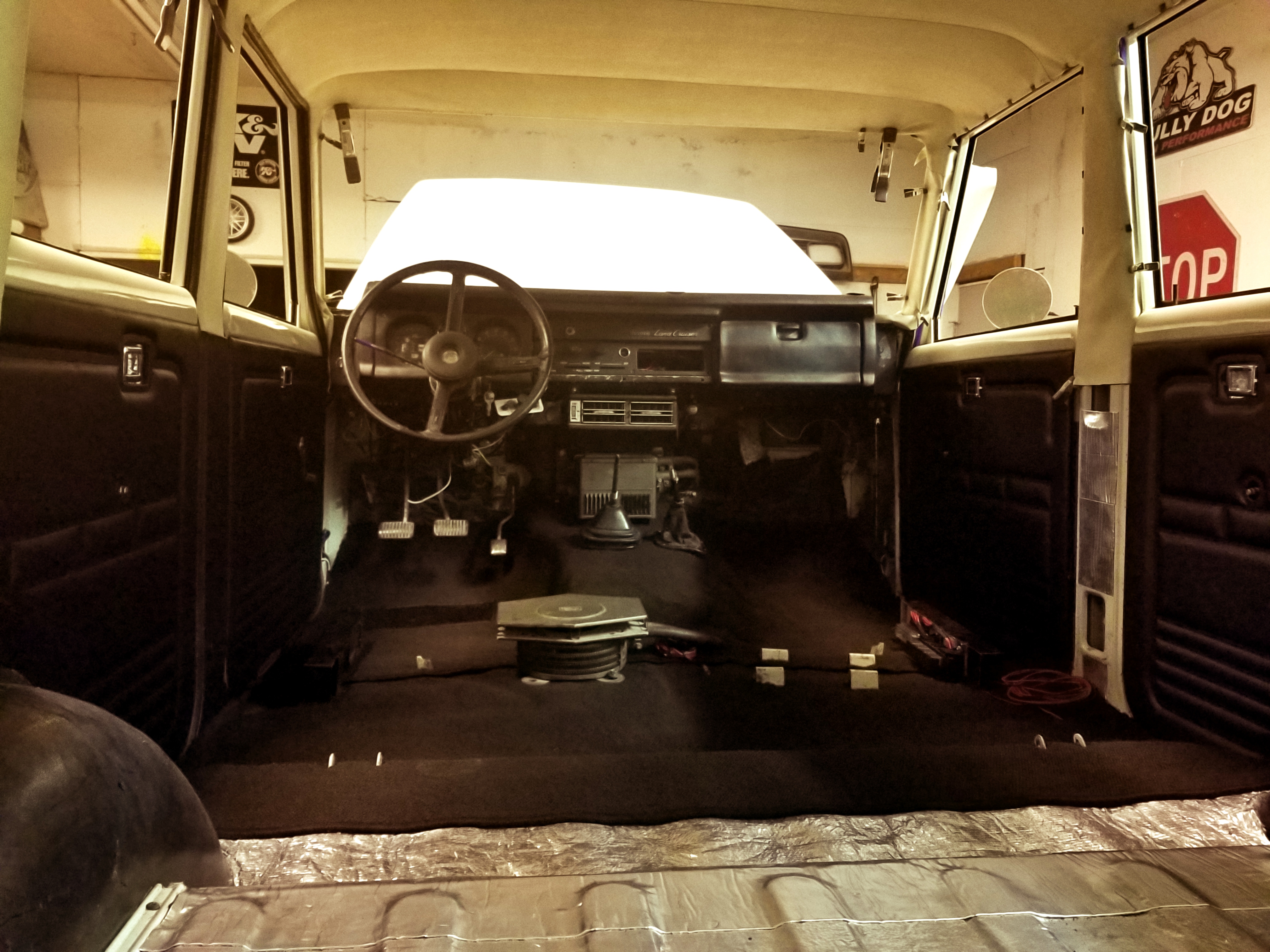

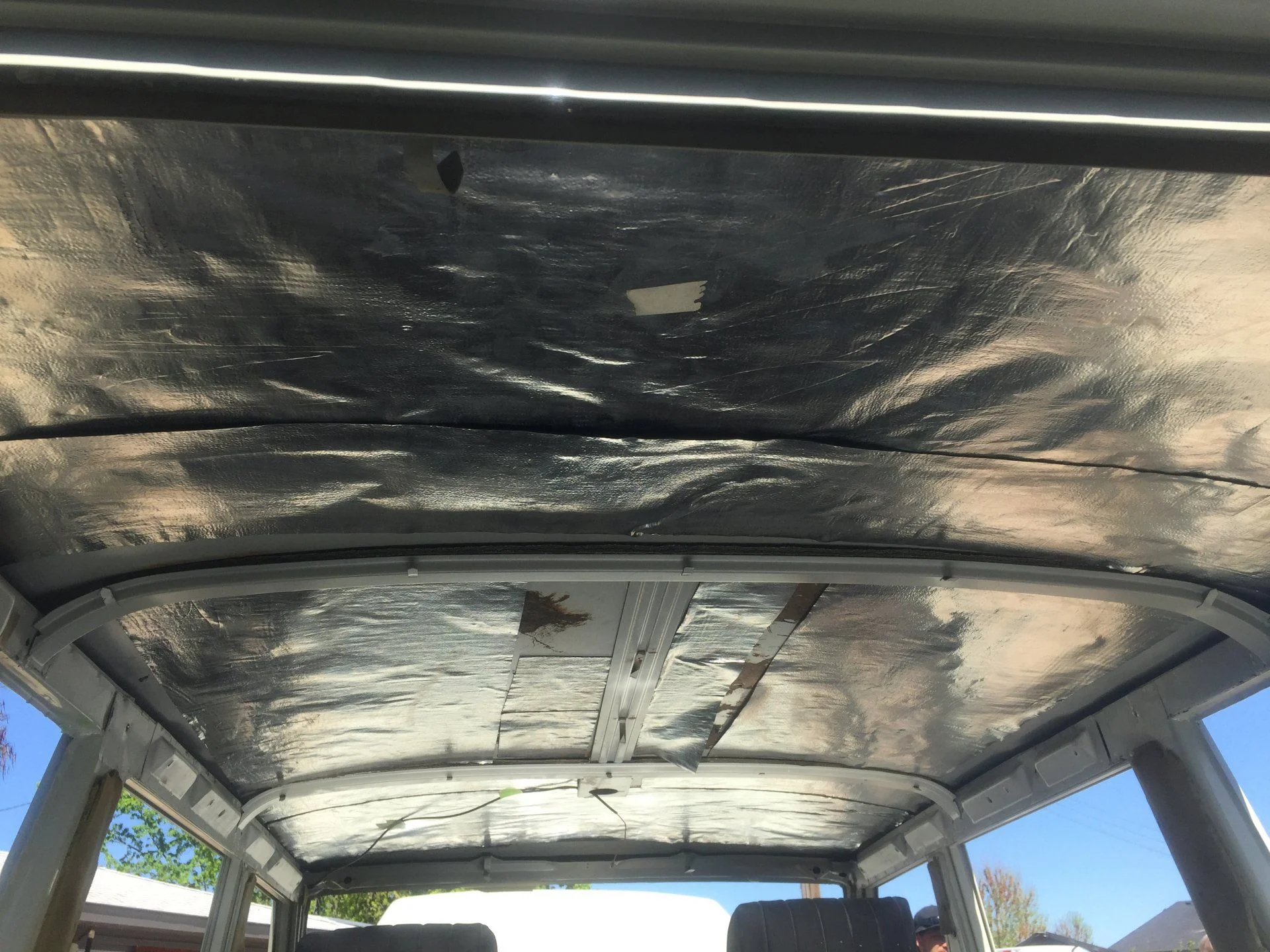

Because of suggestions by my :princess: that Marv was not as quiet and comfortable as her expectations required - we tried to add extra sound deadener, and insulation. Doors, roof, floor were all covered. Discovered that Marv had electric door locks added sometime before coming into my care. New door panels and carpet from Trail Taylors.

Dynomat inside doors and rear body, under headliner, and over entire floor. Insulated headliner and floor with exception to the cargo area with 1/2" automotive heavy insulation. Added additional thin dynomat to doors just under where the door panel will sit. Installed new dust shields.

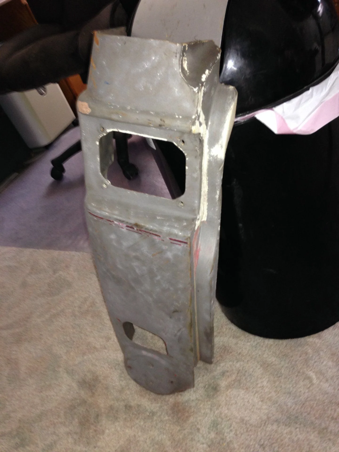

Driver front door latch assembly. I did a picture by picture repair of cutting off the end and welding in a custom made replacement (I made extras so if you need to rebuild yours, get with Bob and he will get you taken care of)
Carpet by trail tailor - awesome stuff. Happy with the quality.
Door panels and rear cargo panels by sms headliners.
Headliner by specter off road.
