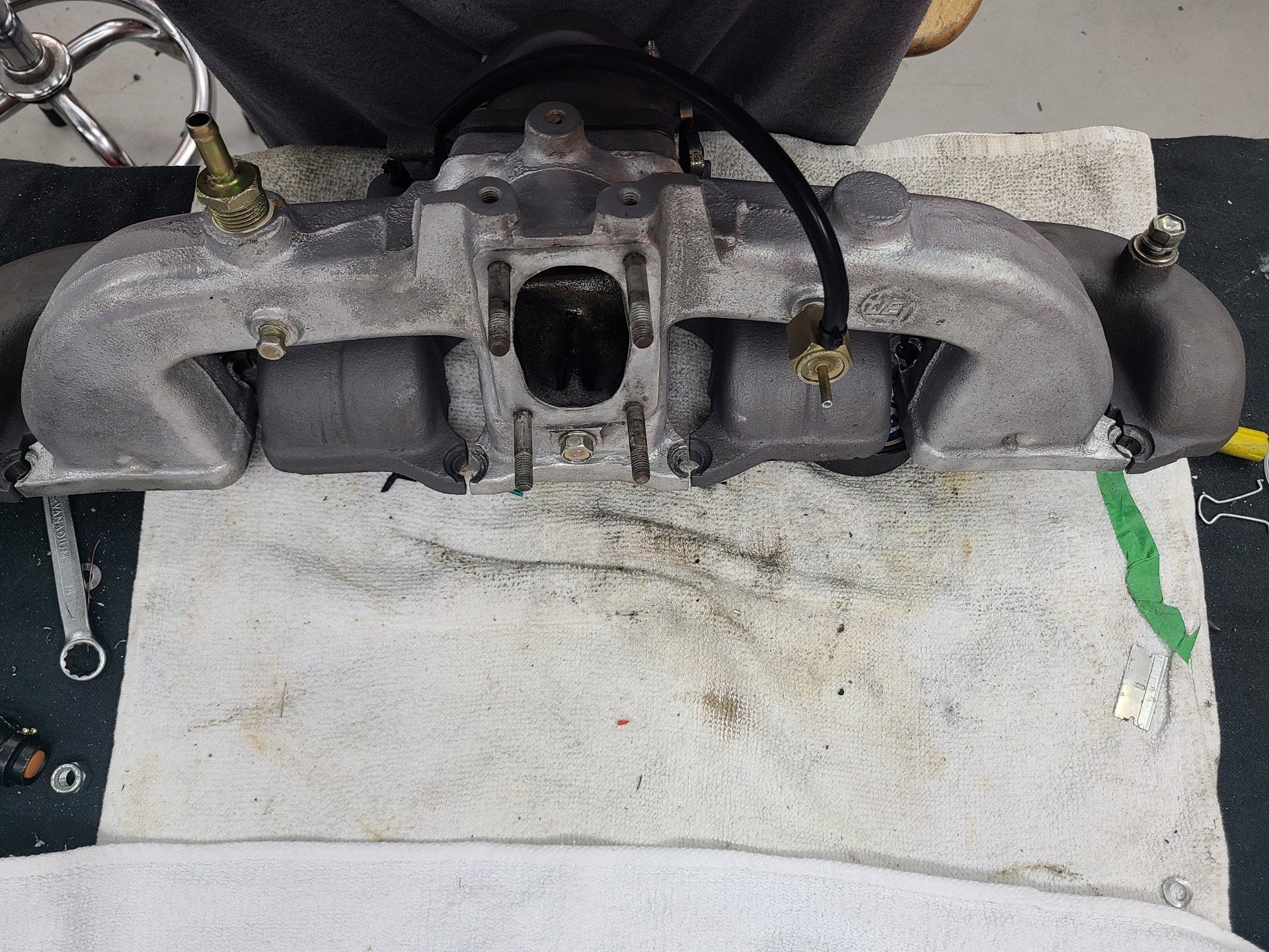

I found an intake manifold leak around the 5-6 intake. The motor was barely pulling vacuum and the engine revved when starter fluid was squirted around the intake manifold there.
This was a recently-assembled motor with new factory gaskets.
I noticed using a straightedge across the manifolds that there are a few high and low spots, and in particular the intake at 5-6 is low relative to the 6 exhaust surface. Here is a pic with the "high" spots marked in yellow.
The intake overall is lower (set back) from the block on average more than the exhaust manifold. The variance is quite small, I cant get my smallest feeler underneath the straightedge but I can see daylight in spots.
I ordered a Remflex gasket, I understand from threads here that has worked for some.
When I had a similar issue on another car the shop I was volunteering in had what I think was called a "lapper?" It had an abrasive drum spinning on-plane with a work surface you passed the surface to be flattened across that until it was perfect. Well, I dont have one of those and we are all locked down...
I dont want to have to take the manifolds back off again so I am interested in advice on how to make the fix the first time. Should I just put on the Remflex gasket and be done with it? That cast iron exhaust manifold would be a bear to sand using a pane of glass behind sandpaper by hand but is that advisable? I also thought of 2 other ideas?
1 - Loosen up the 3 bolts holding the intake and exhaust manifold together, then while still loose bolt the manifolds up to the motor without a gasket, then tighten up the 3 manifold bolts again. Would this perhaps better align the surfaces of the 2 manifolds for a final install with the Remflex gasket?
2 - Has anyone used thin half-moon washers for the manifold nuts so they press on the "lower" sections of the manifold surface, effectively drawing them tighter to the block that the high sections?
