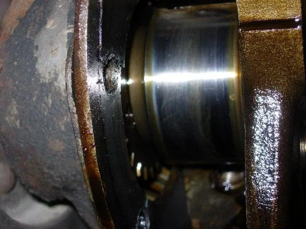

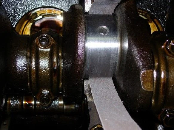

Oh...and sanding the crank....
First pic is #1 that did not need attention
Second pic is #2 that needed the most, but was really not that big of a deal compared to other that I have dressed...
Third pic is #4, which only had two very small 'spots' that you could catch your nail on, and would not even show up on the camera. #2 was the same way...I could not get the rough spot to turn out worth a s***..#3 main was like #1...no issues.hope to have it running this weekend.

When you say that it "would not turn out worth a xxxx", do you mean that you could not get a photograph of it or you could not get it to polish out with the emery cloth? What grit are you using? I wish I had know about this back in 1978 -- I might not have spent the entire summer on foot, but rather in my '75 FJ40. Cool stuff.

I could not get the picture to turn out....sorry about that.
There is no way that I know of that you could symmetrically refinish the crank with emery cloth to make an oversized bearing fit a crank that needed to be cut .010”...and even if you could you would age years doing it.
I have dressed some pretty bad crankshafts in some Cummins 855, 1710 and Caterpillar 3406, 342 and 353 engines where the crank costs more than the piece of equipment or truck is worth to replace, be dresses like this, and it works fine for many years/multiple in-frames later.
240 quickly around it, and then 320, and will finish it off with a piece of crocus cloth which is around 1000.
