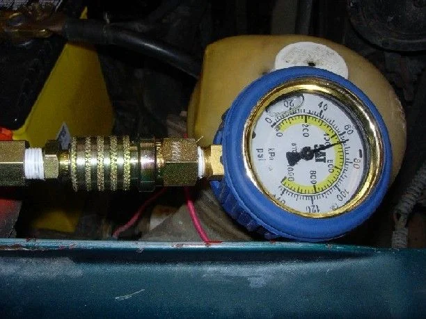

In picture one, this is a mechanical gauge tapped into the port where the sending unit would originally be, this is the oil pressure at startup, and 1800rpm's....15w40 engine oil....same stuff I run in all my junk year 'round....

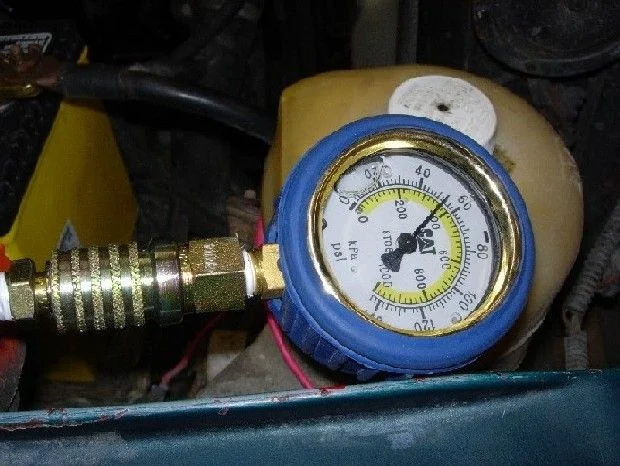

The second pic is the oil pressure at idle after 20 minutes of operation at 1800 rpm's.

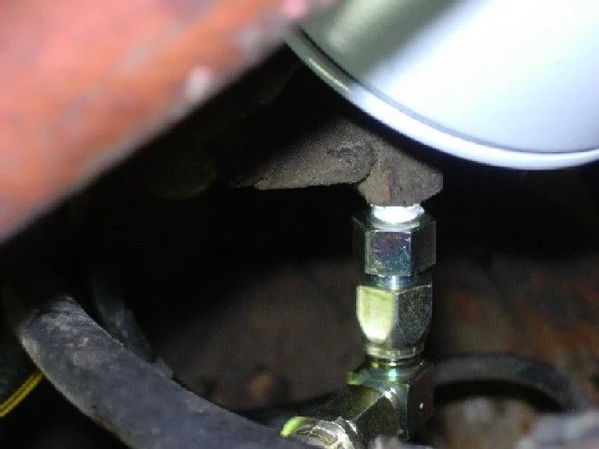

The third pic is the adapter fitting from -2, 1/8"-28 BSP to a -4 JIC male. There is then a 90 degree -4 JIC adapter connected to a hose going to the gauge.
So with this truck at least....

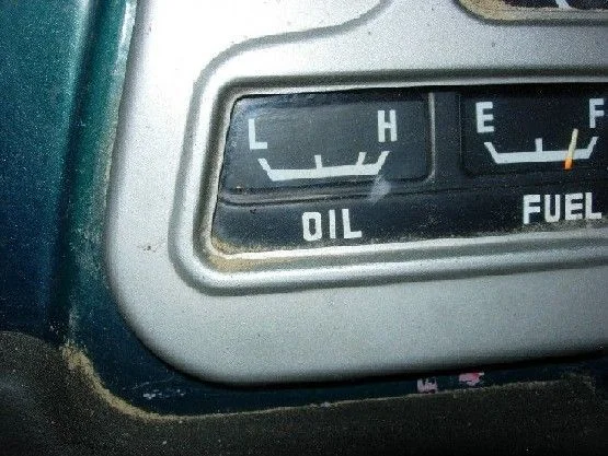

When the needle is on the first mark from the left on the stock oil pressure gauge, (effectively, right in the middle) it is reading right around 60 psi of oil pressure....
The engine has been running for a little over an hour or so, and seems to be fine. I am going to drop the oil and cut open the filter and see what, if anything is going on.
rgentry said:
What is the pressure at idle, warm?
" The second pic is the oil pressure at idle after 20 minutes of operation at 1800 rpm's. "
I would say that the engine was pleanty warm after running for 20 minutes at 1800 rpm...the second picture of the pressure gauge in post #54 is at idle...
:beer:
rgentry said:
I'm depressed. My F makes 28 psi at idle, warm and 60 psi at 2000 r.p.m.
warm. Mayble I'll switch to 90 wt. oil.
What weight oil are you using? 10-30 or 40?? I can understand those #'s if it is one of them, or a synthetic.....
I really do not think that those numbers are all that bad....It is certianly not something that I would be losing my mind over.....You have stong oil pressure when the engine is at load, that is all you can ask for really....
Anyone know what min. oil pressure warm is? I have heard single digits...but cannot remember from who...
