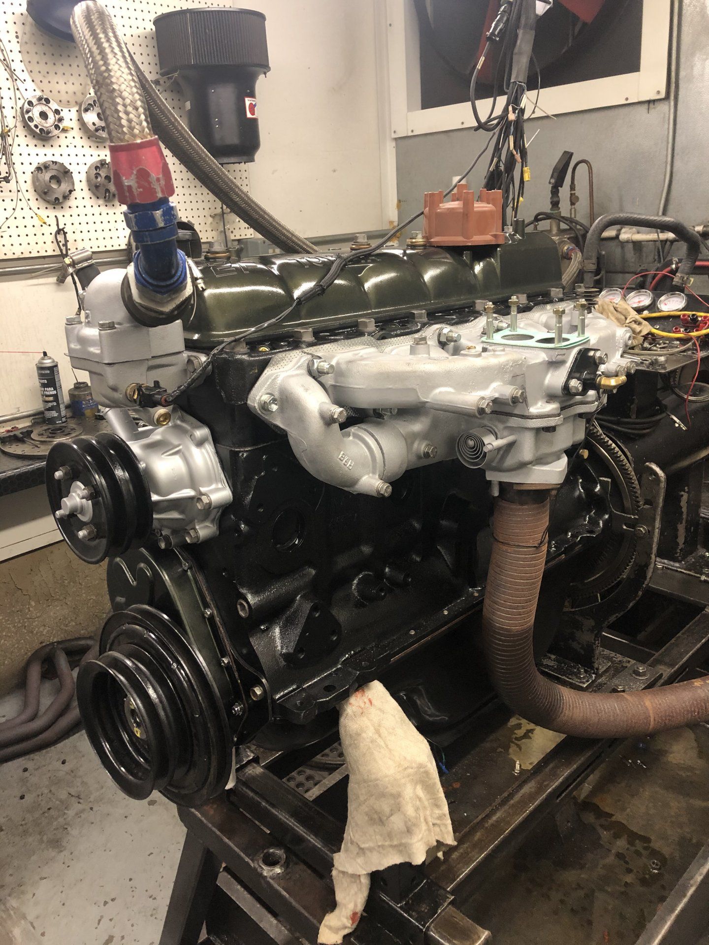

Precision Machine Service gets two thumbs up for me. They have a pretty big backlog so it would take a few weeks. Picked my engine up last week. Top notch guys, took a personal interest in the engine and had the biggest grin while it was being tested on the dyno!

If you are interested is a shorter drive, Goza Machine shop in Acworth did the machine and assembly on a 2F for me 4'ish years ago and one of my 3Bs this spring. Most of his work is high end / high power motors for the hotrod and exotic sports car market, but Tommy enjoys the traditional motors too and the 2F/3B fit that role for him.

140hp at 3300
250 torque at 2200
the dyno was part of the build package so was fun to see what a 2F would do on a dyno run
as to the build, intent was more reliability than performance so stayed away from “hi-po” stuff.
.030 shave on head
New ITM .040 pistons
New valve springs
New camshaft (stock duration)
New lifters
Chromium Rings
Polished crank, no turning
Black paint (the silver and green were me)
