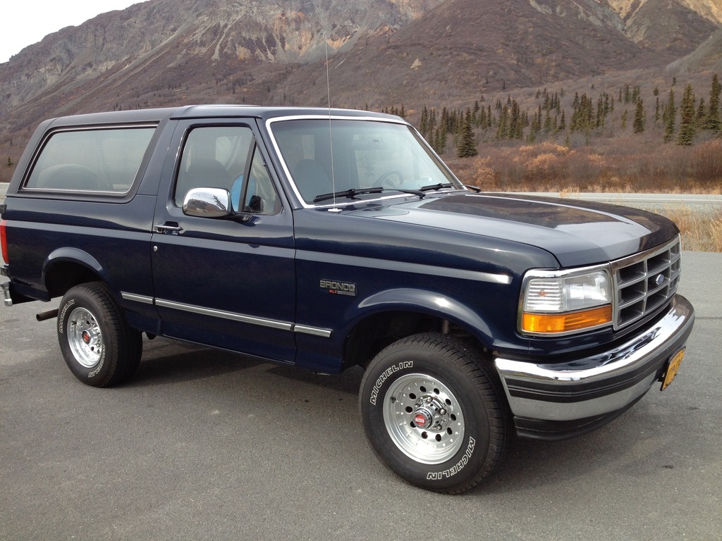

Do the work yourself. Read up on paint prep and watch a few youtube videos - there's a wealth of great info on the internet. Buy a good HVLP gun, air compressor and buffer, then get after it! I did just that for my old Bronco when the paint on the front fenders and hood began flaking badly. I built a paint booth in the driveway and shot it one afternoon. Sounds like you have the difficult prep work already done, so invest a few hundred dollars in the extra equipment you'll need and have fun. My Bronco was my first paint work and it turned out pretty nice - it still needs a little more wet sanding to get all of the peel out of the paint but I was really happy with it!
