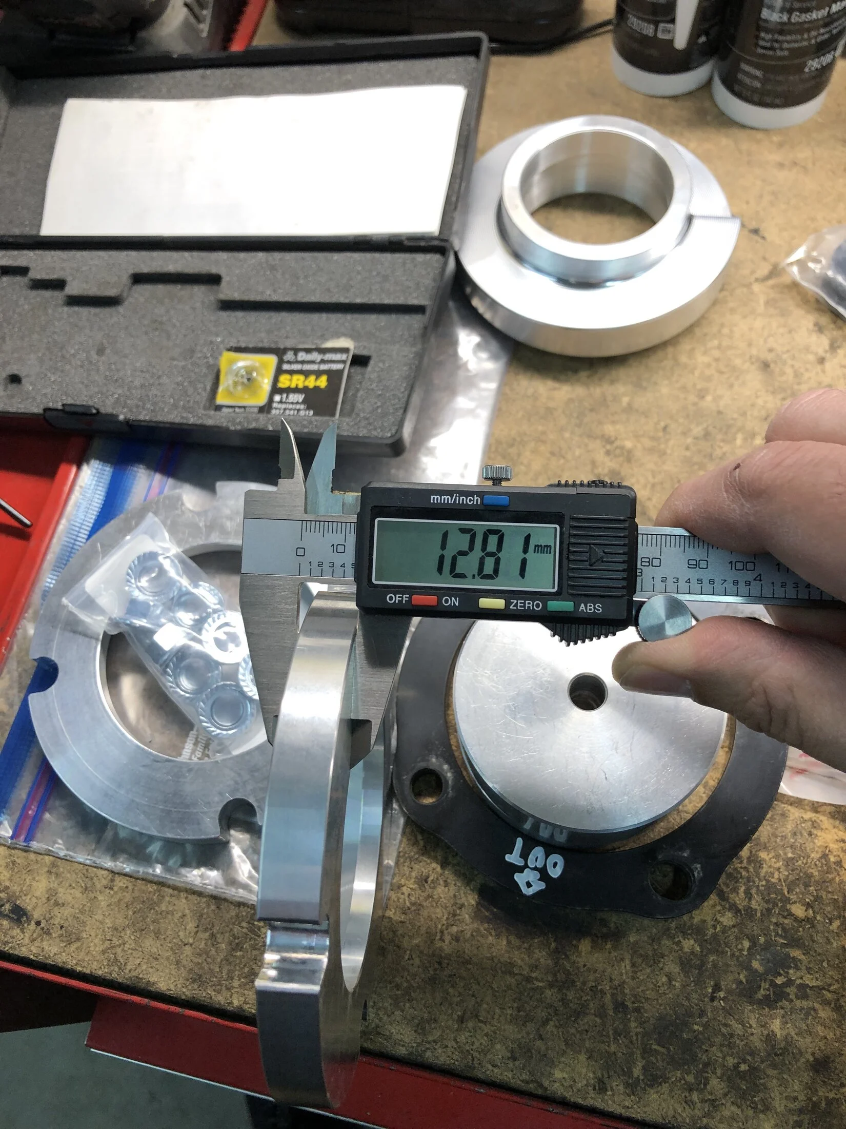

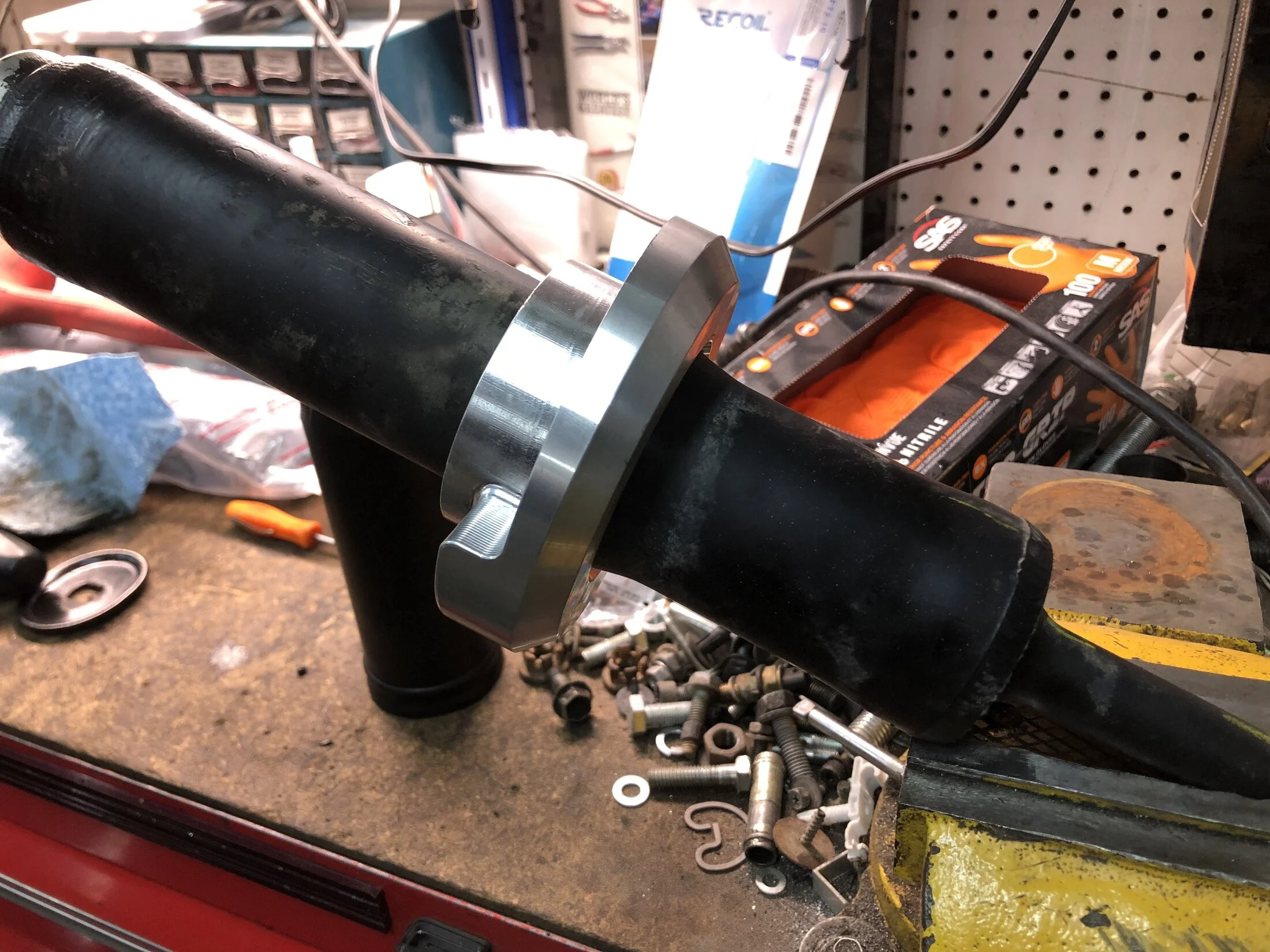

The Westcott kit does fit the AHC shock. I do have it installed. It’s certainly a lot more effort than some of the coil spring spacers/helpers that slide into the coil but it does seem to work well for me, and I’m glad I did it.

I did only instal the front kit and yes, it is a direct fit as their installation video shows. I do have pictures but it does not lift the front because the AHC pressure lifts to the vehicle height the sensor calls for. I installed it to increase the coil preload and reduce AHC pressures after the sensor lift. And in the back I used the 100 series Terrain Tamer AHC coil with a coil spacer on top.

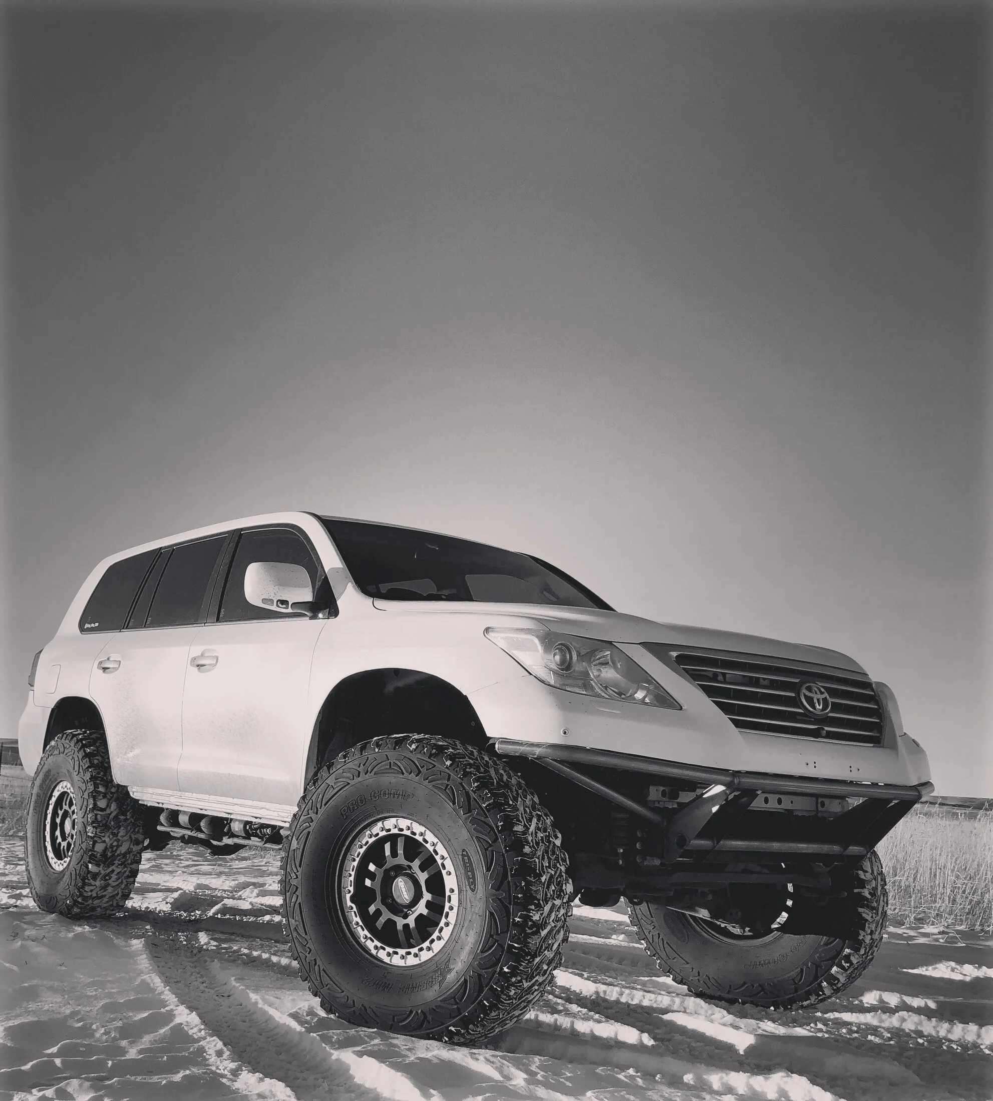

And just an old picture everyone has already seen…
