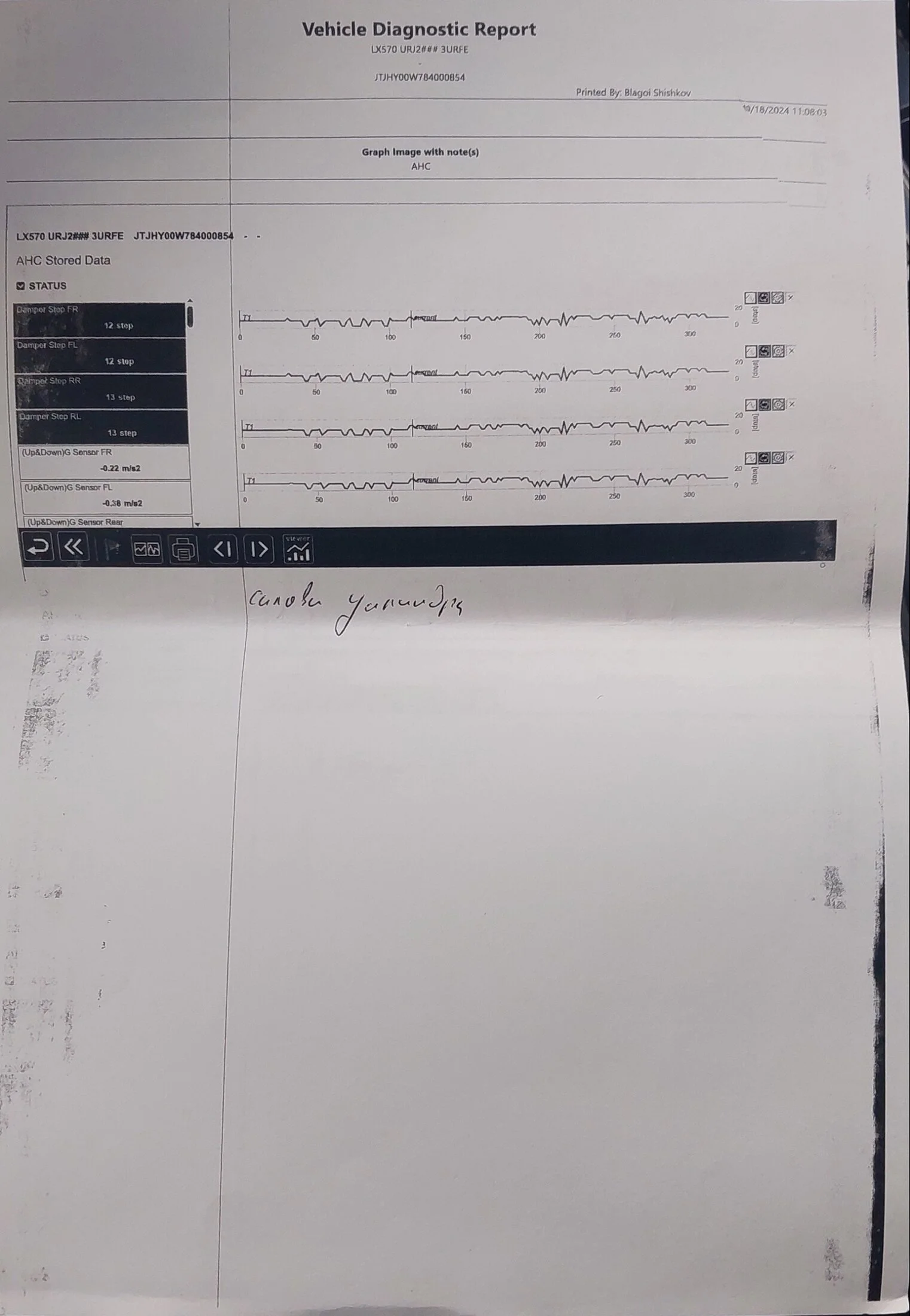

The suspension was inspected by a local dealer using the FSM tests , but no issues were found. Personally checked oil level and sensors . When fully loaded, the rear end feels like it has excessive spring travel and lacks proper shock absorption. Any thoughts?

Doesn't appear to be anything abnormal about your techstream output. Has your truck been "Sensor lifted". If so, the unsettled feeling could be your panhard angle. There are correction kits for this if you have it lifted.

Also, it appears you have a lot of height difference between left and right rear. Might want to measure that and check you AHC sensor arms to see where they are adjusted. Adjustments can also be made via the height offset utility in Techstream.

Can the truck go into low mode? I see from your printouts that it went into high, but doesn't look like low was tested, or it doesn't get there. If you can get into low mode, then you most likely have the correct LX springs.

Well, then that brings more questions than it answers. Do you have the sensor values from when in low? That will tell you if the rear is actually dropping. If you bleed the rear globes the rear should drop as well. That would be another way to test. If it was sitting on non AHC springs, they would hold the weight of the truck up rather than letting it fall when the hydraulic system is depressed. You'd still be able to lift because the hydraulic system would come back into play.
