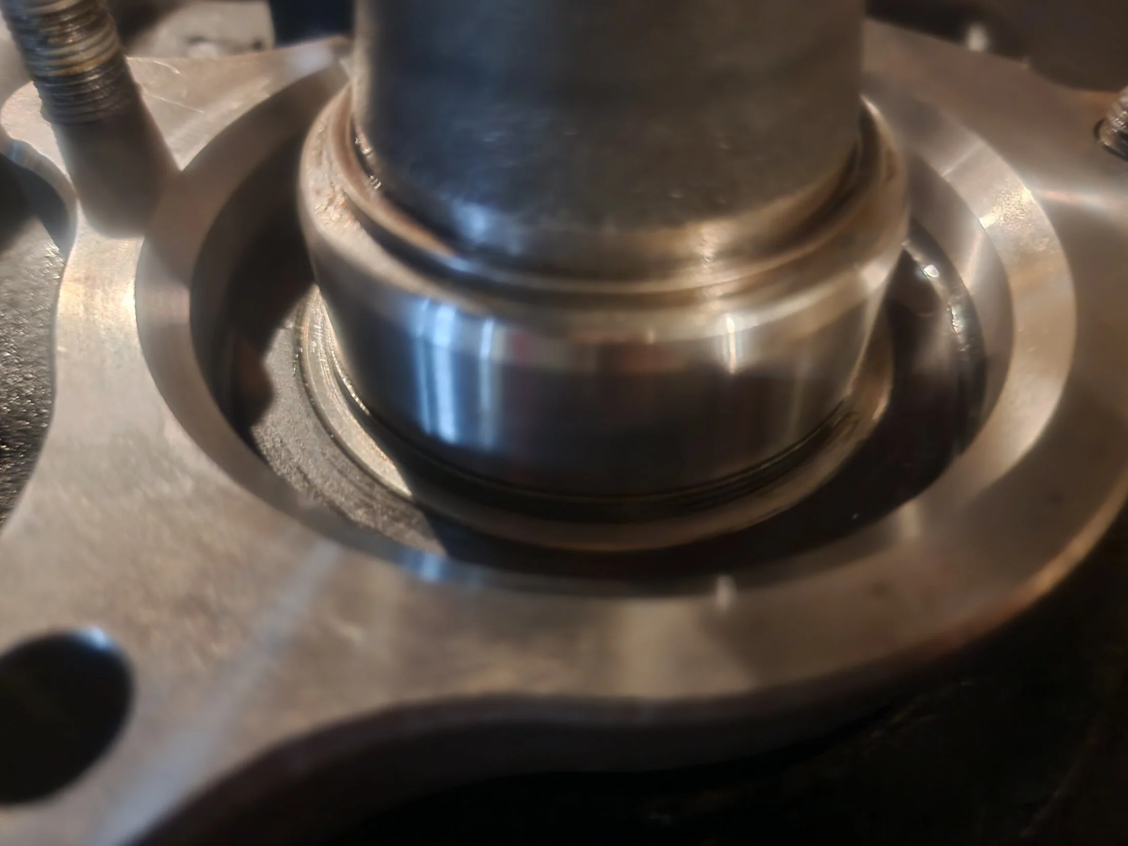

I know it's hard to see, but there is the c clip on it and it won't go inside. It's enough room to fit fingernail but not the c clip.
Yeah, you’re supposed to press the bearing first then the retainer. Very likely your press is just stalling trying to handle all three components at once. You could try bringing it to a shop with a larger press.
Also when I said inspect for damage I meant with the bearing removed. I get that you’re trying to avoid that though.
My bearings were “firm” after assembly but not gritty at all.. very fluid/smooth like a new bearing should be.

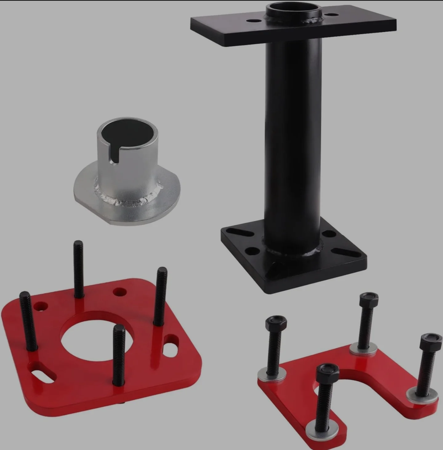

I did pretty much everything as in your guide and bunch of videos I found on YouTube. The only difference is in tool that I've used to pull the bearing (like on the picture). Probably I'm just stupid to fix my own car.
Do you think I should get a new axle shaft? Can I reuse washer and retainer or better to buy new? In order to press in just bearing I will need some sort of pipe or a cylinder to put under the inner race, otherwise it won't reach or won't be even. I have spent so much time and money and just ruined everything. Why they can't just sell axle shaft with bearing on it like they do for some other cars.
You have the tools to pull the bearing so there’s no reason to replace the shaft without at least pulling yours apart and inspecting it first.
I would recommend new spring washer and retaining collar, yes. You actually can use the current collar to press the new bearing in… just use a grinding stone to open up the inner diameter so it can slide freely over the larger area of the axle shaft. That way it a) doesn’t add to the force your press must produce, and b) can be removed once the bearing is pressed all the way in.
