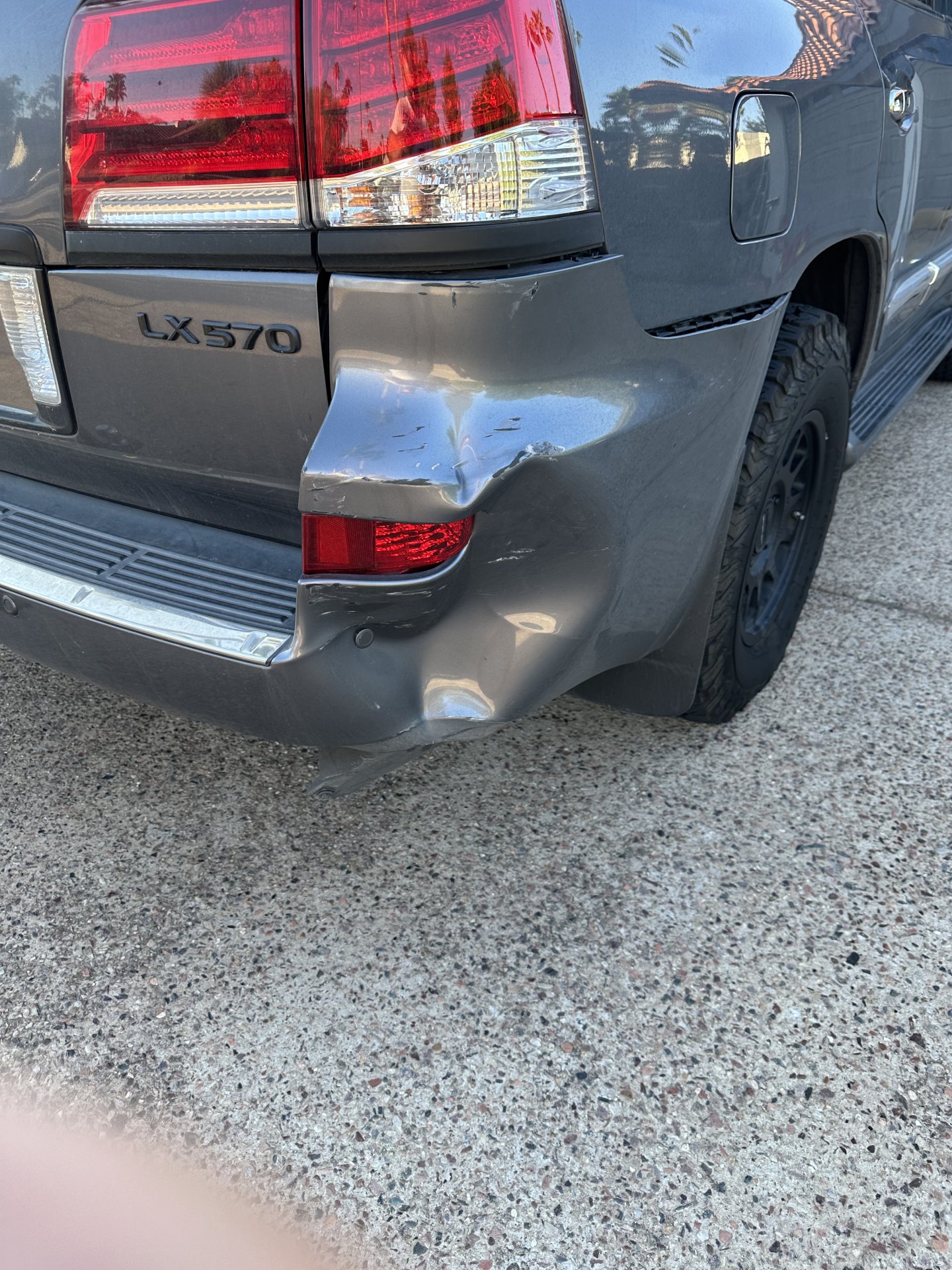

A few weeks ago I had a minor fender bender where somebody crushed the rear part of my bumper. It’s not terribly bad but insurance gave me $2000 to repair it. The question I have is based on the photos could I replace the bumper with an off-road aftermarket bumper? I’m not sure how much of the existing bumper would need to remain when installing some of these aftermarket ones. It be great to take the $2000 and put it towards something I really want opposed to just replacing the plastic.
You need from the bottom of the tail light to the top of the reflector for most bumpers. I would try heating that up with some boiling water and popping it back out and then cut it up when you decide on a bumper.
You can probably get access to the back side without removing the whole skin.

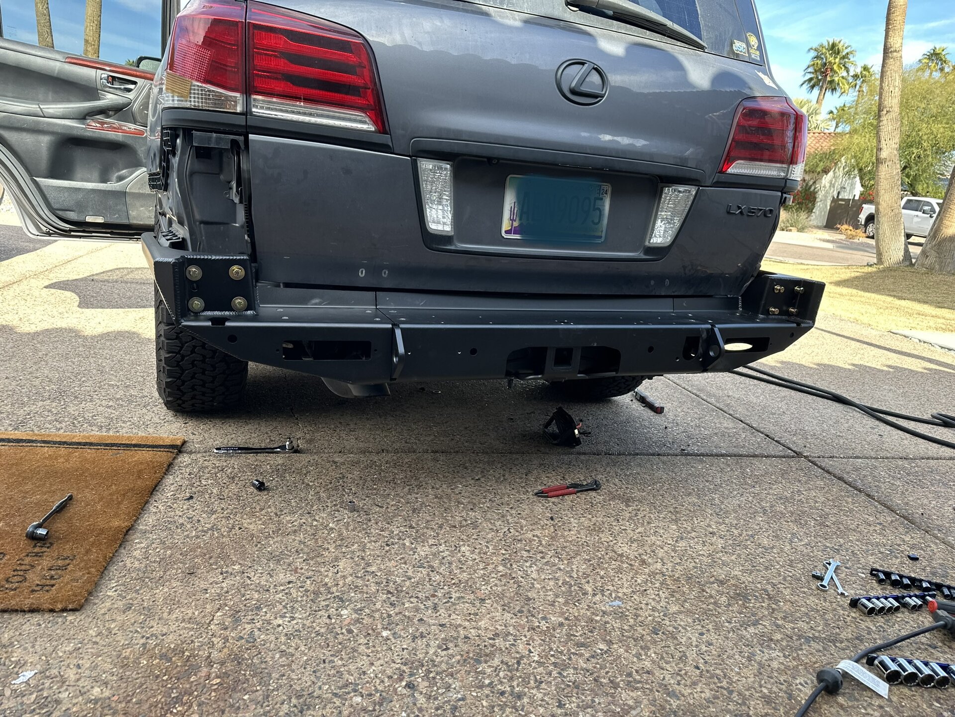

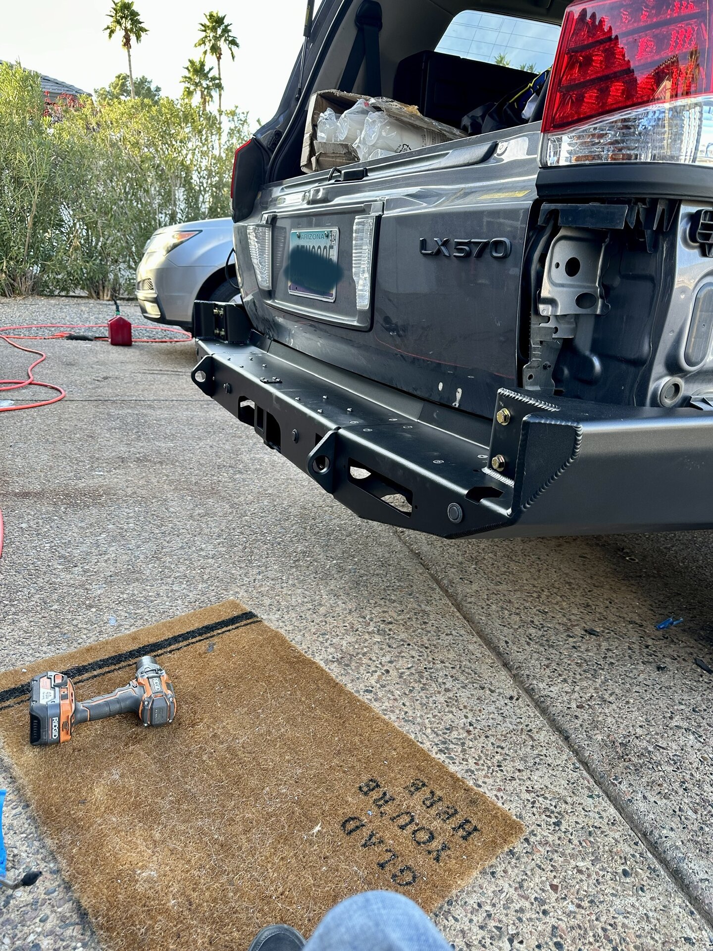

Thanks your photos were very helpful. I ordered the dissent bumper shipped and powder coated. It was more than what my insurance paid me but less than if I just bought it out right

I took it off. Not hard at all. And just used a heat gun and pushed it out with a wooden handle of A mallet.
It’s like 87% perfect.
Also I busted the bracket for the reflector attachment. A little…actually a big wad of bondo epoxy on the inside of the bumper fixed it right up.
If you can turn a screwdriver you can do this repair.

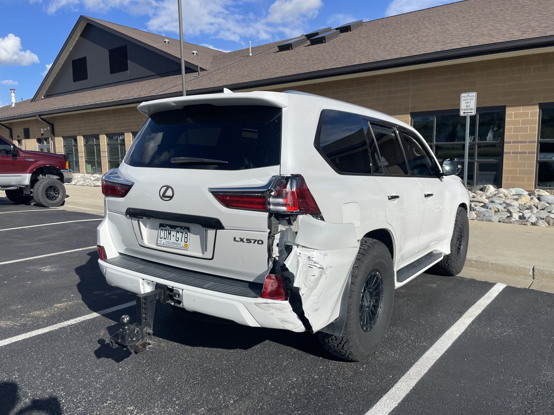

Happened over a month ago. Only Lexus certified shop said it’s a 3+ month wait and 6-8 weeks to repair. $15-20k+ in damage.
Wow. My whole Lx cost less than $20k. What is the damage? A rear bumper cover and a rear corner light?
From first glance yes, but the damage goes deeper.
I also got quotes for $5-7k. Problem is that the quarter panel is damaged and the blind spot monitoring/crash detection may not work correctly if the QP isn't replaced with a new one. Apparently that involves removing both passenger side doors, front bumper, and headliner etc. And Toyota says the QP glass is a one time use piece so the shops that have cheap quotes aren't repairing to manufacturer spec. Since it's not on my dime I'd rather get it fixed at the approved place that won't cut any corners.

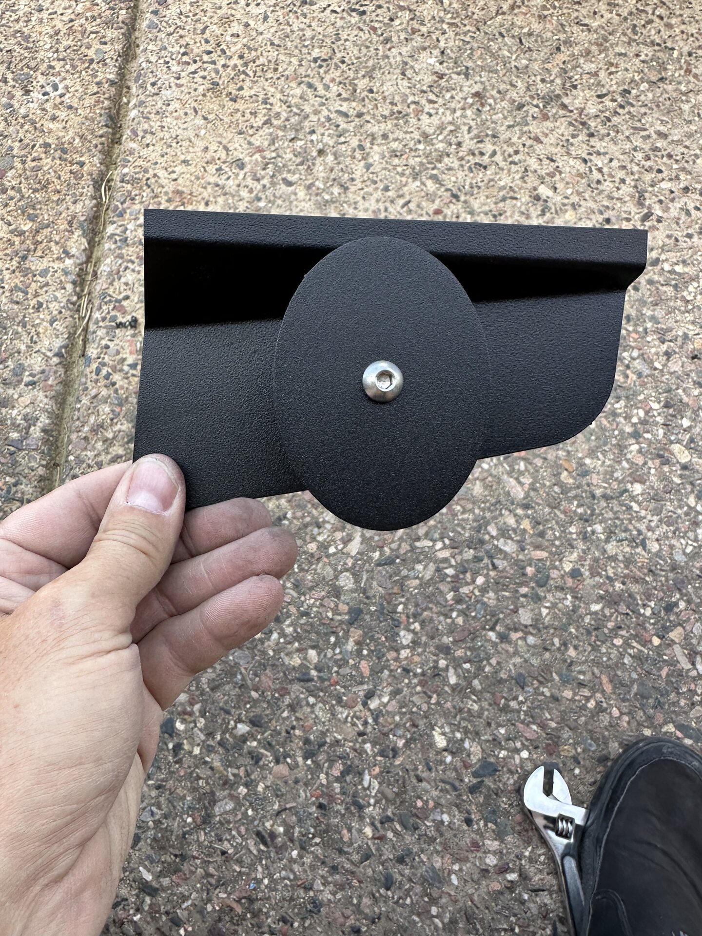

I finish this bumper a ways back, but I had two extra parts and I’ve never been able to figure it out I have a pair of these that both look identical,
out where they’re supposed to go. Any ideas
